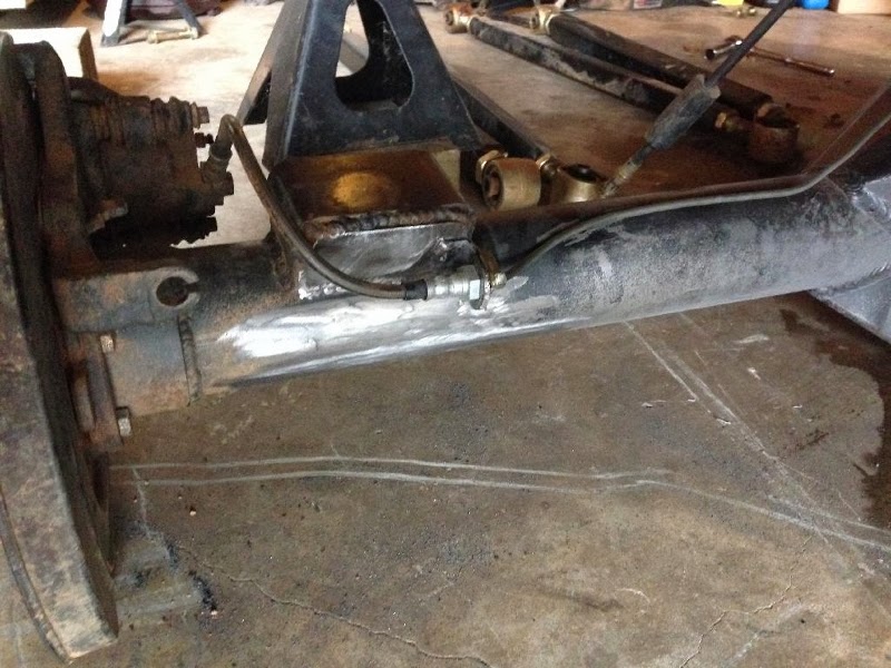

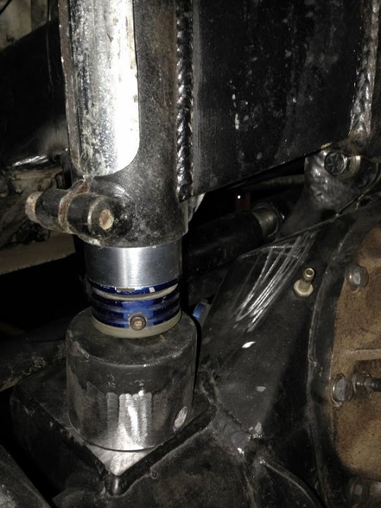

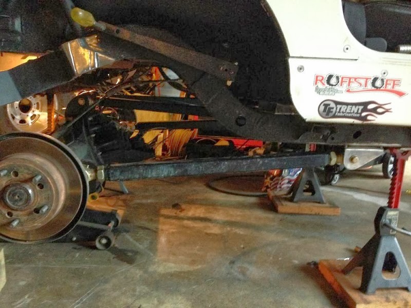

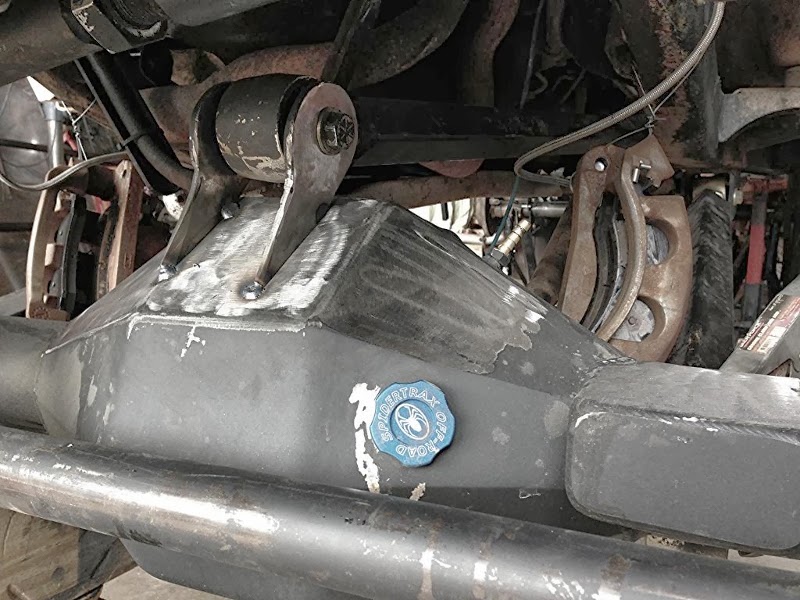

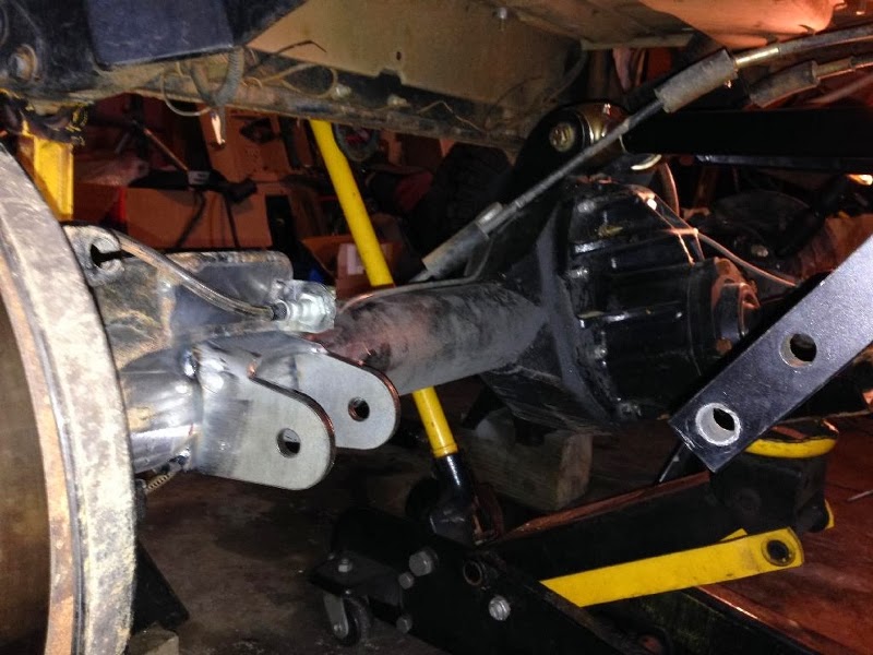

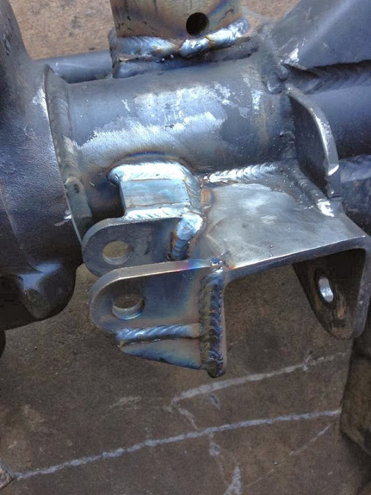

So Mike (MO2500) has been shifting the axle around at full bump to squeeze out maximum clearance. My wife reported some metal clanging when she was curb hopping down town- so that in addition to the banging I felt coming off of a few jumps last race led to some repositioning.

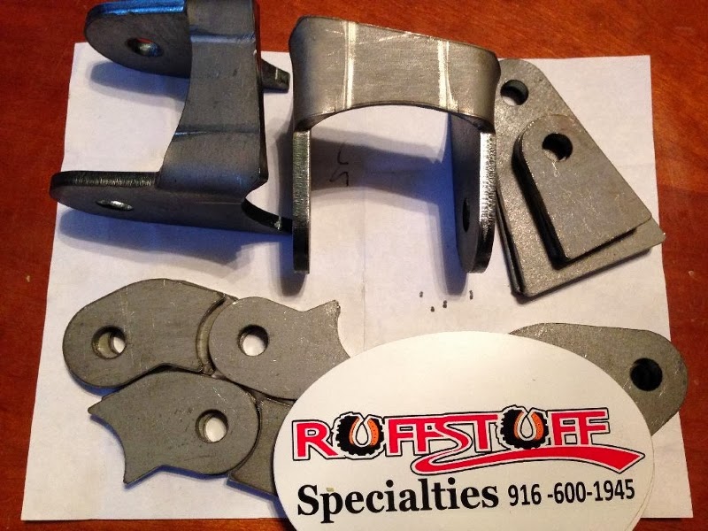

Shout out to Ruff Stuff Specialties, I ordered on Thursday and the parts were here (cross country) on Monday. Always top level service from those guys.
The axle is going another inch or so forward, so the track bar mount had to come off-
alh3.googleusercontent.com__9g5Dxm1xzbY_UpYBCbG72EI_AAAAAAAAD779cdfdb342feb36510504673db521d76.jpg

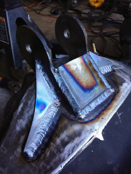

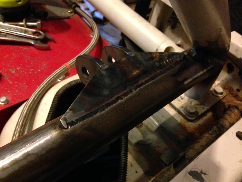

Here is the new 3 link mount tacked up-
alh5.googleusercontent.com__XztkjiDjWbA_UqIVv_53tOI_AAAAAAAAD_07ee44e25153bf01563269591bdade8b.jpg

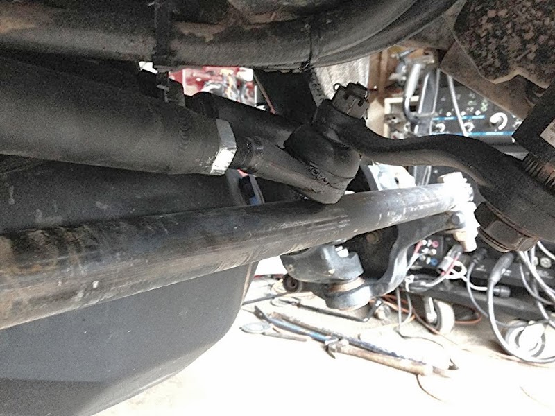

Steering clearing everything nice-

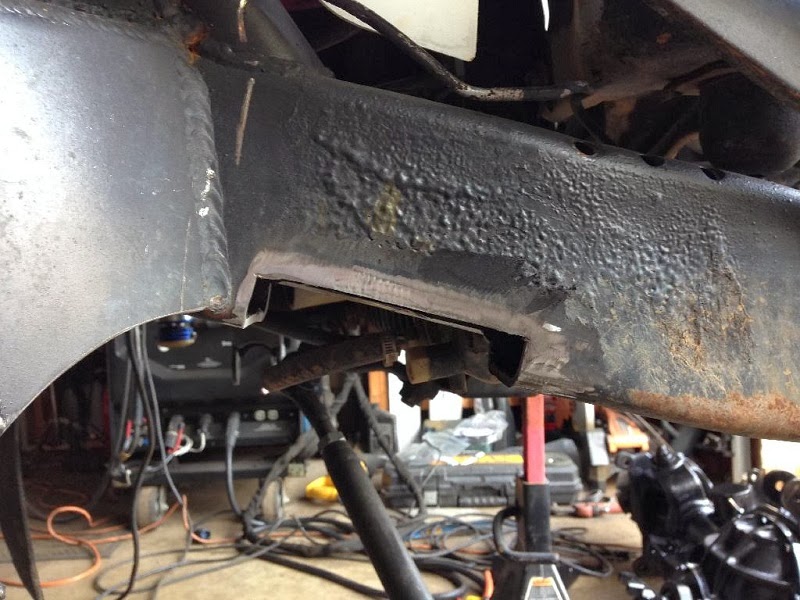

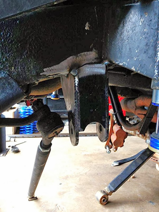

Passenger side frame is going to need a notch for the new up-
alh3.googleusercontent.com__dXX2Fw59ZwE_UqIVxQEDs7I_AAAAAAAAD_3df13c68c1d2e02102a1ebe1be09f5ed.jpg

In the mean time, Mike keeps operating on the 4550-
Frame notched with some new steel going back in:

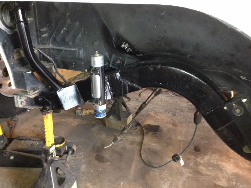

Coilover mount getting beefed up for maximum speed bump landings:
alh3.googleusercontent.com__wKK7OaMSY5M_UqjVcT4x6gI_AAAAAAAAEBY_e_l1wPgpym8_s720_mikey3.jpg

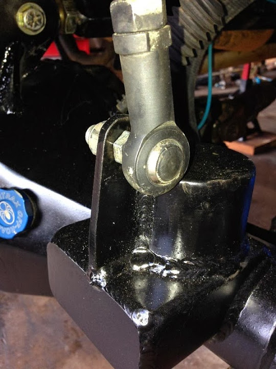

Swaybar mount re-positioned for better angle:
alh6.googleusercontent.com__5PjRO3QwJEY_UqjHk_UWU2I_AAAAAAAAEA8_p_XfVNvPVNM_s720_mofr5.jpg

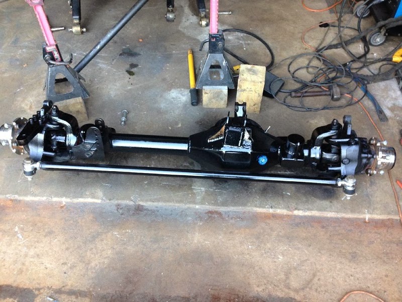

Axle removed for final paint:
alh3.googleusercontent.com__Y1s2nqOMWfA_UqjVdXuJlCI_AAAAAAAAEBw_G6P8gmKCJ8s_s800_mikey4.jpg

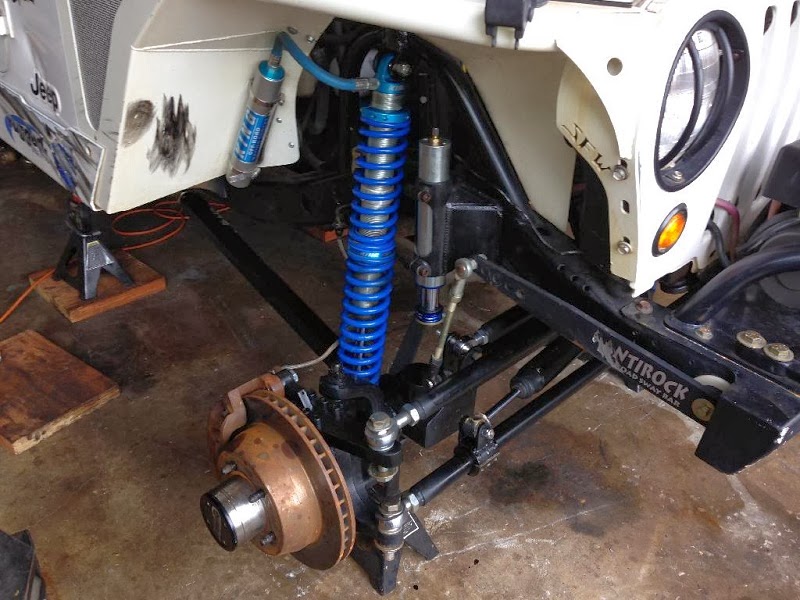

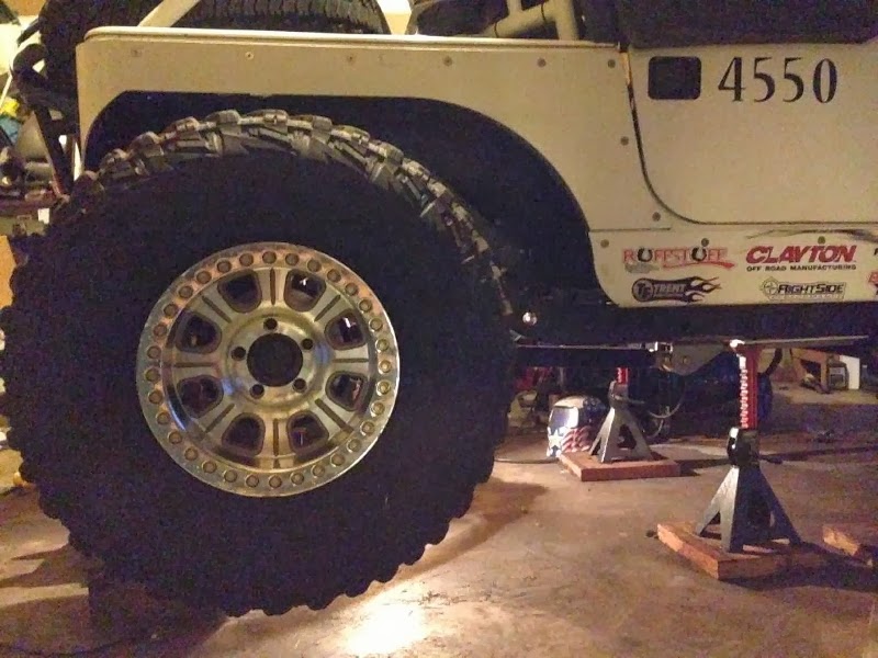

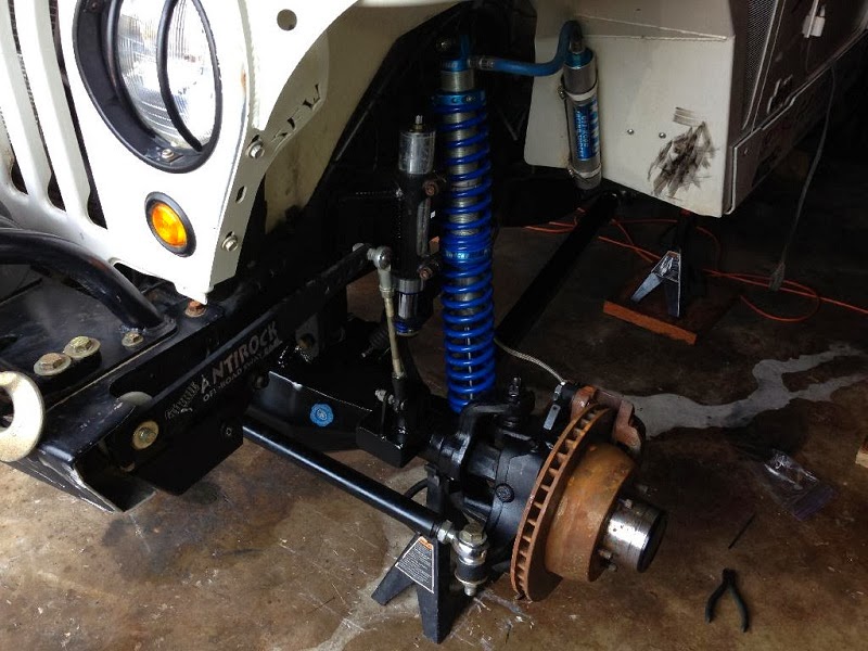

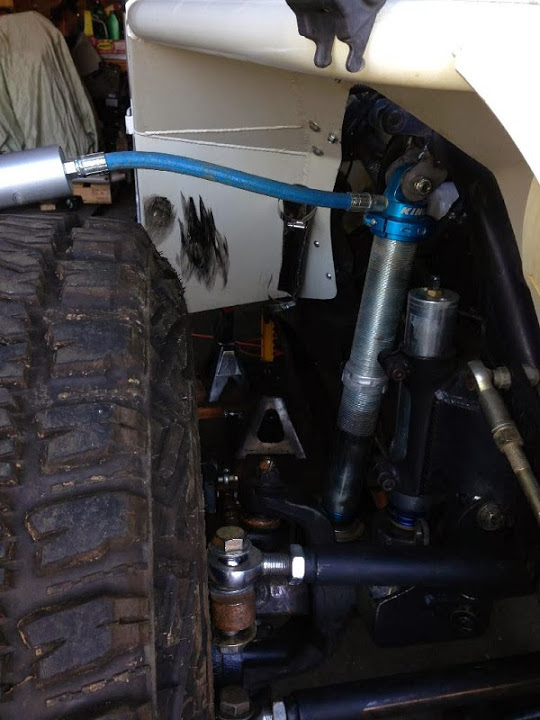

Front all buttoned up. 6" of up travel and 6" of down travel achieved:
alh5.googleusercontent.com__0e5w_kQ_Ou0_UqjHj9Xd4tI_AAAAAAAAEAk_Gu5AtS1yZxw_s800_mofr3.jpg
alh5.googleusercontent.com__5YhIOtcUMS8_UqjHkujSgNI_AAAAAAAAEA0_EiDw7yTQg_I_s800_mofr4.jpg
Looking good. Is there not enough room up front to have a separate coil over mount. Having them tied into the lower control arm mount creates a lot of forces working in different directions on one bracket. I wouldn't even mention it if I didn't know you were going to be jumping some big speed bumps at hyper speed.
Good question. It came down to room and if I wanted to incorporate the inner C's. The mount we went with is similar to some of the Jeepspeed setups I've seen, so hopefully it will hold up.

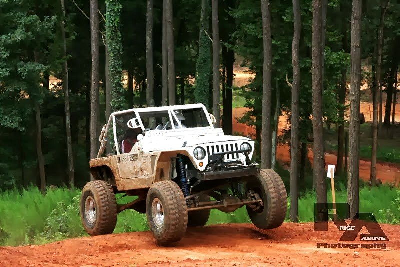

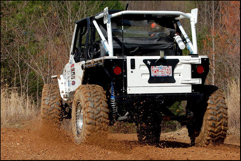

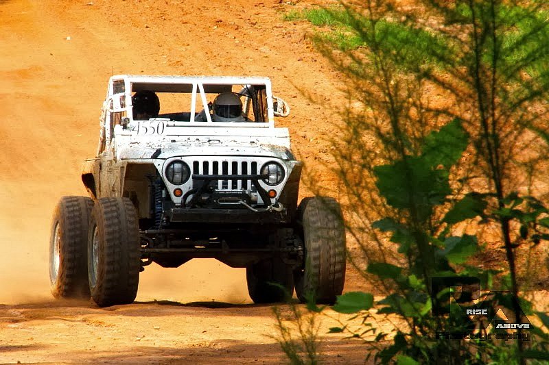

I saw a few old school shots of the rig that got me motivated to put a little evolution timeline together-
Racing the TJ through the last 3 years:

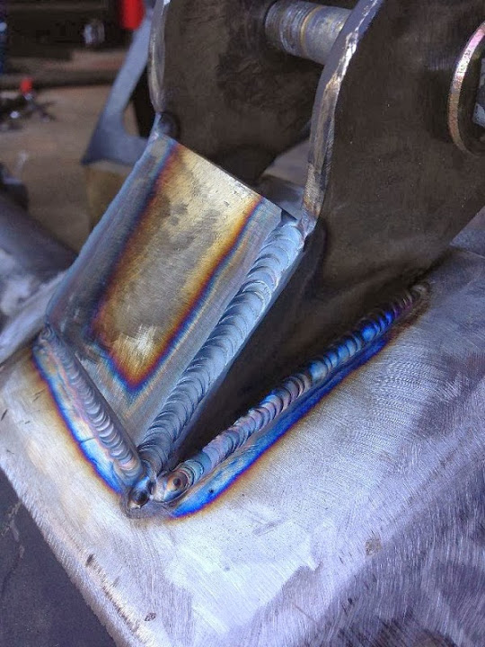

Getting tacked up much higher than before. This should help with clearance and the AS numbers too-
alh4.googleusercontent.com__bc1G1AzMSsg_UrHfmfFFxYI_AAAAAAAAEG210ed9d782225ad39e3534b0162c3a15.jpg

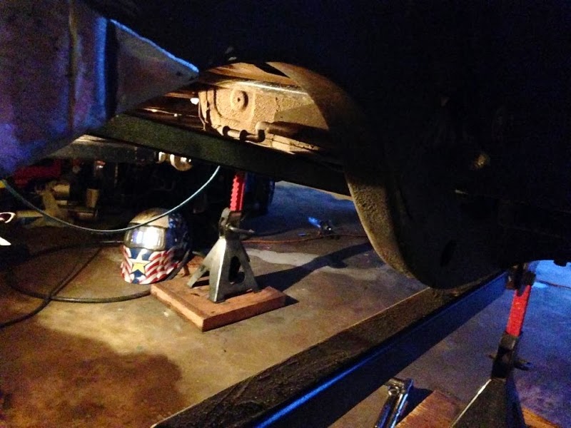

Moving the axle back 5 to 6 inches from the previous stretch-

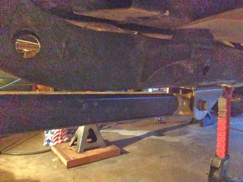

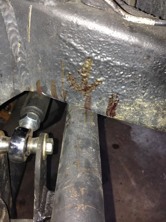

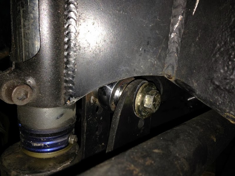

At full bump, just clears the frame-
alh6.googleusercontent.com__2FQMpjC6G5c_UrHfnoUuOwI_AAAAAAAAEG129cf8832731fedd72f5b7e8549efc9c.jpg
Even closer on the uppers, but still clears the tub. It hit here before, so this should big a big clearance improvement-
alh5.googleusercontent.com__U9xmoPqUHTo_UrHfoD5bAxI_AAAAAAAAEGba582b95ed3101fd4315dc19c61e9e25.jpg

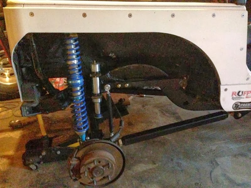

Getting the rear end buttoned up-

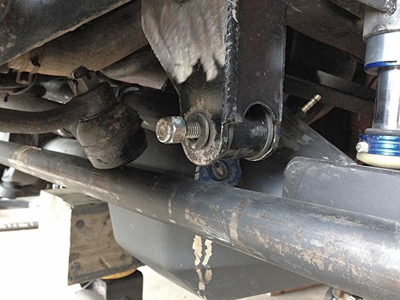

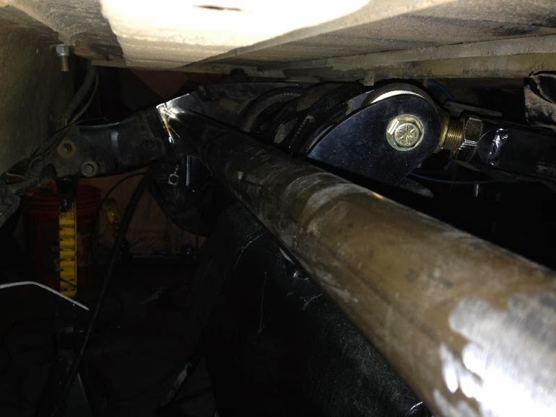

New B to C bars added for internal coilover mount:
alh6.googleusercontent.com__CJfIs3jSKp0_UrHfiWbDqsI_AAAAAAAAEF9b70096c06ec6c6e469f54e9a662a53d.jpg
Mount and brace:
alh4.googleusercontent.com__eQMQtnxDrPQ_UrHfjQlpK4I_AAAAAAAAEFd3f3b04073a73aea3a6519743410ee2d.jpg
Airbumps and C pillar cage to frames re-done:
alh5.googleusercontent.com__iyNYlnJ9GA0_UrHfkD_jcZI_AAAAAAAAEFa51dfa7758b935209cfc7358e758ed82.jpg
Rear coilovers mounted, rear sway bar mounted (late night cell phone pic):
alh6.googleusercontent.com__t7aUuxJHG8U_UrHfljCOrhI_AAAAAAAAEG9ff101ea573031524efb0f9438913a26.jpg
Now comes the cycle of clearance checks at full bump:
alh3.googleusercontent.com__TEYH9Y_WMcA_UrHfjvXX32I_AAAAAAAAEF83d05c3eebad751cbef688bf9a52fdf7.jpg
alh4.googleusercontent.com__ogeo2xFgrKI_UrHfo4_vFkI_AAAAAAAAEGd6d9aa03dba206f42749f5da62b4e801.jpg
alh5.googleusercontent.com__iUm_NoASZDI_UrHfis11rTI_AAAAAAAAEF339ea8bfb5843f937f53cbc8758f19d8.jpg
All clear and for the first time in 10 years of owning this rig- no rubbing, bumping, or grinding. 7" of up travel should make that curb jump from Tommy Hilfiger to Baby Gap like butter.

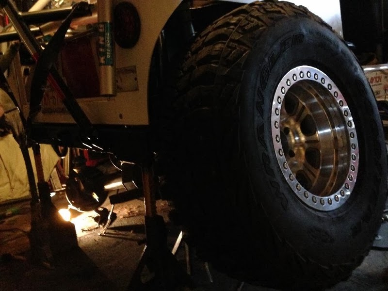

So next up is a new rear driveshaft, but I went ahead and rolled out the rig, threw it in 4WD (front wheel drive), and took off for some last minute Christmas shopping at the mall (seriously). The new wheelbase came out to 105" and it is certainly a noticable difference. This thing is going to fly through the parking decks.
alh4.googleusercontent.com__DFTfYHxNRtQ_UqtwTmHacUI_AAAAAAAAEE896e1d0df91d700777b155e65340fa1c.jpg

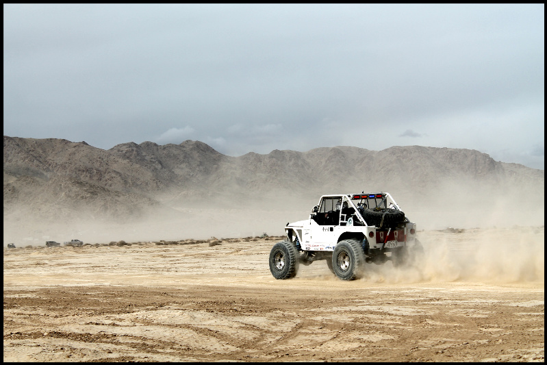

REDLYNER Racing and the 4550 car is back to prove that hair products, cherry scented car wax, and an amazing sense of fashion is really what it takes to be competitive in Ultra4 racing. Registered and ready to pose-
