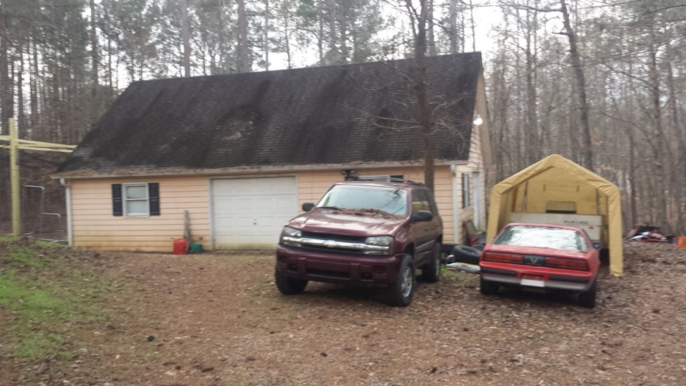

I talked about it, but we never could find a way to make it work comfortably structurally. Fuller might disagree.
But yeah, I have totally thought maybe doing that. Raising the roof and doing new trusses. The shop is ridiculous as it is. :lol:
For reference, before I built the lean-to and moved all the crap behind it. Also before I added the garage door right there behind the TB.
