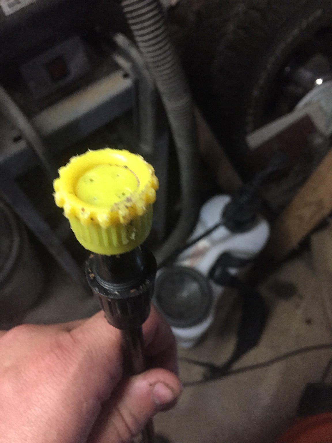

I can't say for sure. I bought the backpack sprayer from harbor freight and use the yellow mist tip below. I can't remember if the tip came with it or if I bought it separate somewhere else. It will put out a very fine mist/cloud that I can mist shrubs and the yard. I can tell a huge difference the day after I spray. The sprayer is uncomfortable as heck, but it's 30 bucks and dedicated for talstarP. So 30-45 minutes every month or two is all I have to wear it. I've got .5 acre with plenty of shrubs azaleas, boxwoods nandina and rhododendron. I can mist up in the Leland cypress about 10-12 feet with this setup. I mist the yard and bushes, and stick the wand in the bushes to mist inside the foliage. (Mosquitos like the underside of leaves) I mix 4 gallons at 1 oz per in the sprayer. Avoid flowering bushes unless they are getting eaten up by June bugs, and I can do the yard and perimeter of the house with 1-2 tankfulls depending on how pissed I am at the bugs.

4 gal. Backpack Sprayer
one review for this sprayer said it came with extra nozzles , hopefully has a mist one included.

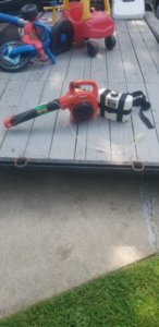

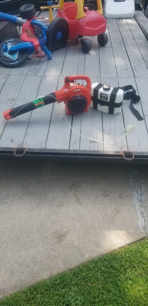

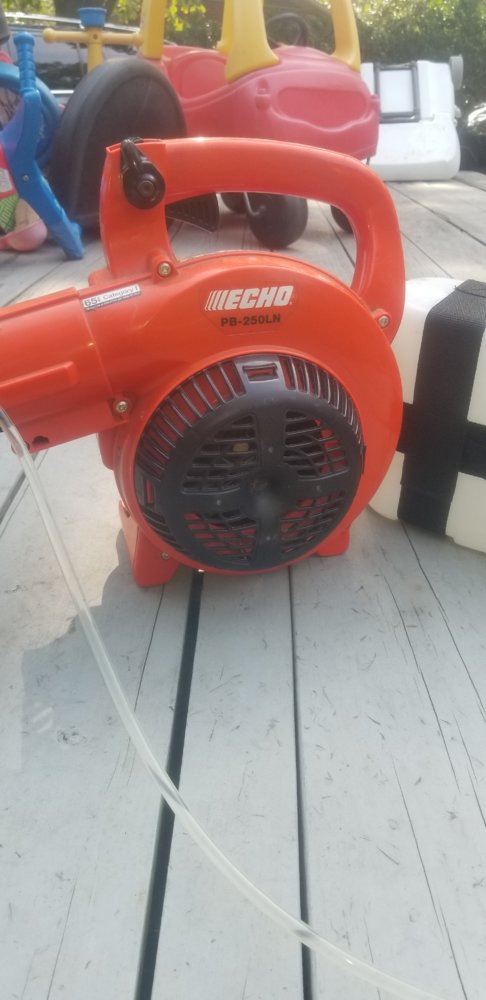

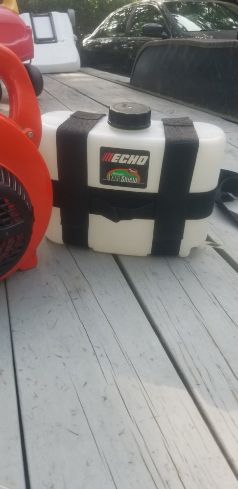

I have struggled to bite the bullet on that backpack sprayer as well for a while but I'm finally fed up with having to deal with bug spray every time we go outside. I actually am more of an Echo fan than Stihl so I did some looking around on the ol' interweb and found something similar that I can use on my handheld blower (Echo Mosquito Yard Shield For Hand Held Blowers Pt # 99944200300 - Free Ship 99944200300 | eBay). On it's way now so we'll see how it works. For the price, I'm hoping it will suffice just fine.
That's pretty cool. I toyed with the idea of rigging up something on my makita backpack blower. I bet this echo attachment will work well. It'll save a bit of time over the sprayer method too.

Circling back on this thread. Got the Echo backpack sprayer in a few weeks ago and sprayed my 2nd application of Bifen this morning. The Bifen works great - huge difference in the skeeters! I live on the NW side of Charlotte but they're pretty bad in our neck of the woods. Normally couldn't go outside without them being all over us and the kids. The Echo sprayer works pretty good...ultimately, ya get what you pay for I reckon but at ~$40 I'd definitely buy this again over purchasing one of those larger dedicated sprayers like the Stihl I referenced in my OP. Kit came with the tank you strap on your back and the black tube you can see in the pictures where the liquid travels down the hose and to the orange nozzle at the end. Biggest knock on it would be since it's gravity fed you can't get the end of the blower much higher than around belly height or the liquid stops flowing good. Also, I've noticed it gets a bit of a vapor lock (there's a breather in the cap but I guess it isn't quite enough). Today, I unscrewed the top slightly and it definitely helped with the vapor lock, and I noticed I was able to get the end of the sprayer up a littler higher (maybe around my chest-ish). All-in-all, I'm pleased with how this has solved the problem around the house. Don't have to bathe the kids with bug spray or worry about folks being carried off whatsoever.
