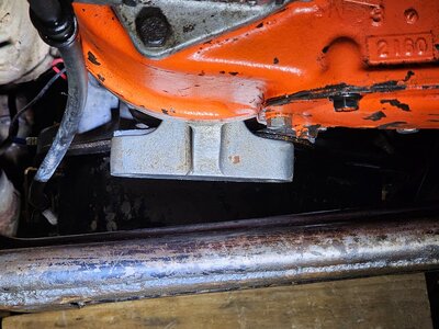

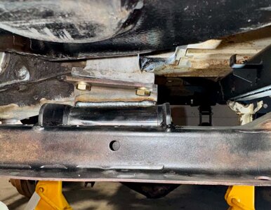

Post studding the trans, it was apparent the OE tranny mount was not happy, basically angular shenanigans ...

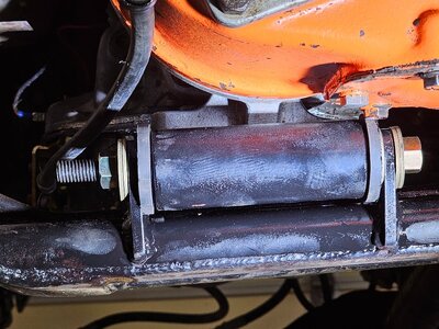

so whipped this up from some *rubber* (to match the rubber engine mounts) builder bushings, 1.75" DOM, and a (too long) hardened stud...
Front view
Rear vantage:
And thought it was "ready"...

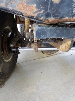

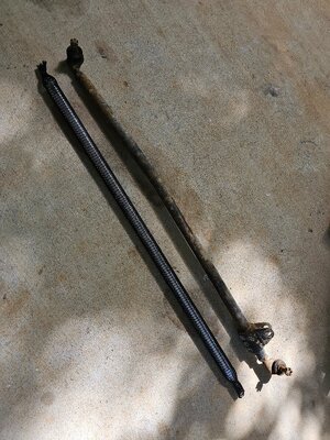

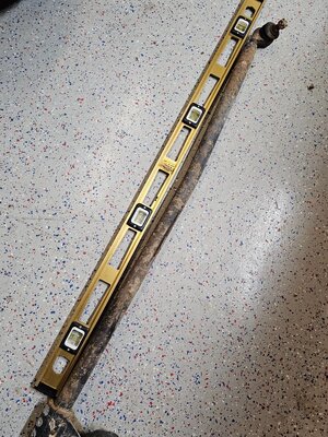

Only to notice the 1.5"FOM tie-rod basically formed around and grating against the diff ...20260531_162512.jpg
I called @Ironman, had stock, but none short enough (requiring additional work) and immediately said call Julieene @ SummitMachine. 2 calls to spec/confirm and it was at my door!
