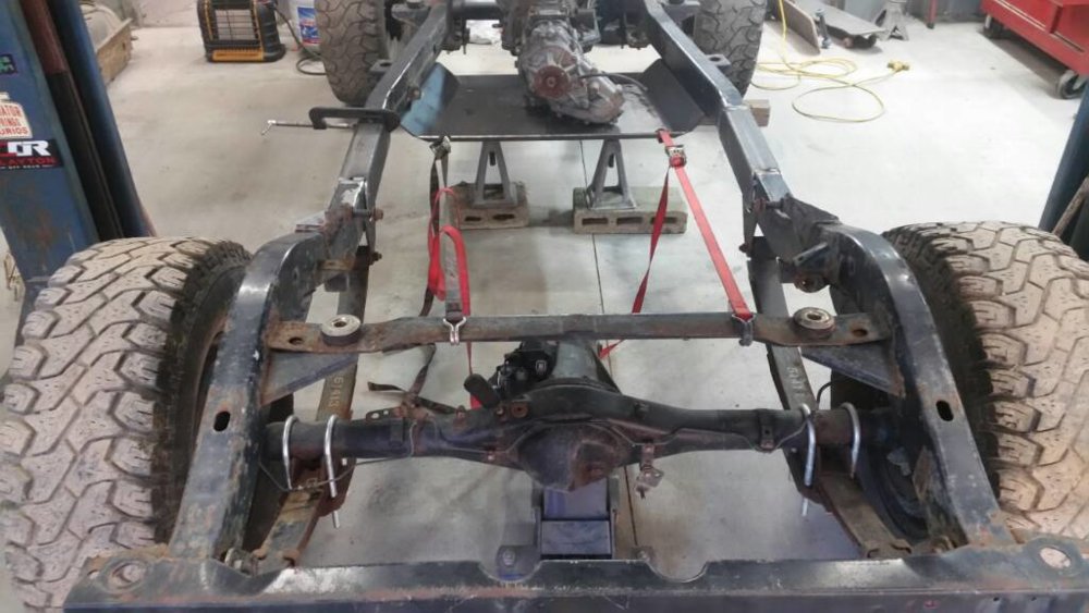

Been hit or miss for time the past few weeks, rolled the frame out and pressure washed it Saturday. I then had some time this afternoon. I will let the pictures tell the story.
Sent from my SM-G860P using Tapatalk

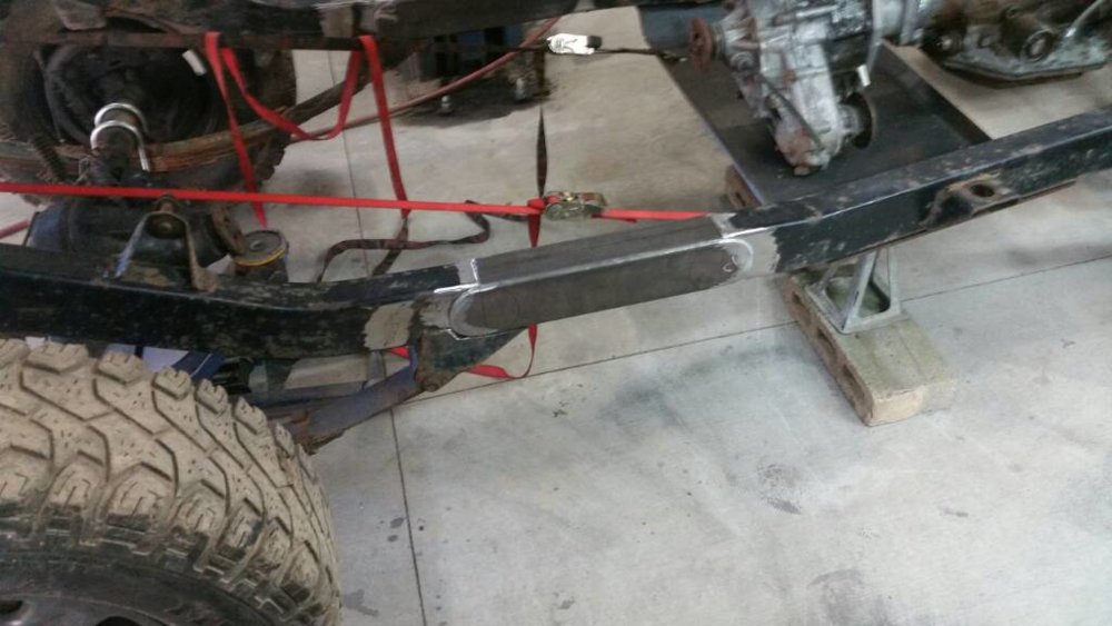

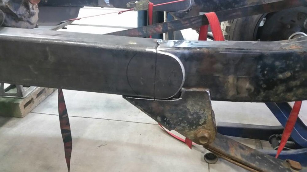

The leaf spring hangers will be fully removed to weld the bottom of the frame after everything else is welded. Going to also push the hangers back 3/4 to 1 inch to produce a better shackle angle on the rear.

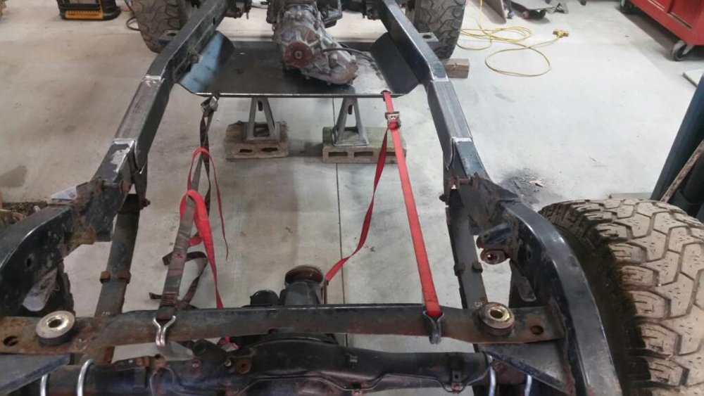

Nick @stinkbomb came over last night, melted some metal and gave me a hand last night. We got the frame fully welded and the spring hangers relocated for a much better rear shackle angle.
Set the body down for a look at things. Rear axle will most likely get moved forward 1" from the spring perches. They are 3 hole and in the rear most hole, so i could move it up to 2" forward. More pictures to come later
