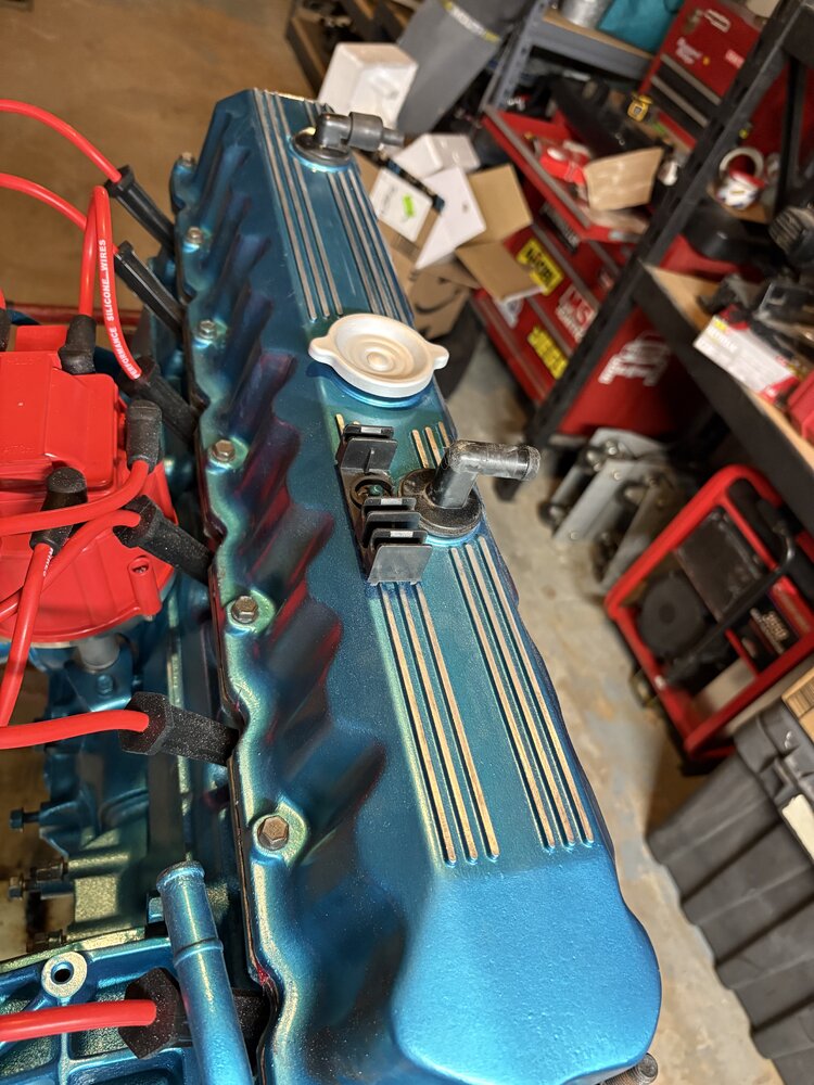

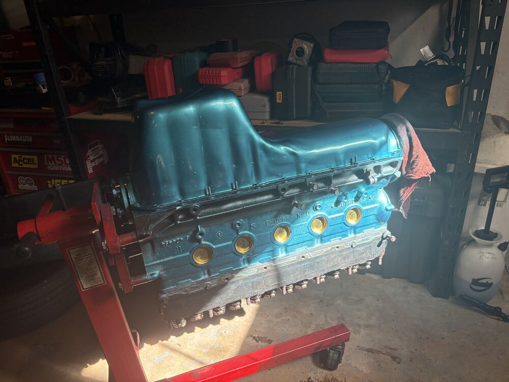

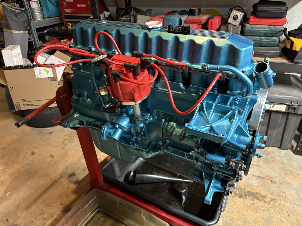

Starting to clean up nicely!
Some might say sacrilege on the color, but it looks damn nice up next to the copper color of the jeep. After all it’s an ‘87 so it’s still AMC. Poetic freedom I say.
Well, forgot to post any progress, but here’s where we are.
At this point it has really been clean up. Even filed and sanded the aluminum brackets casting marks.
Tried cleaning the alternator after having it tested with a “Pass”. But DAMN! I don’t know if it’s something about the electromagnetic field, but the dirt and grease are embedded in the housing and I’d rather buy a new one than spend anymore time on that fawker!
And some elbow grease bling on the valve cover.

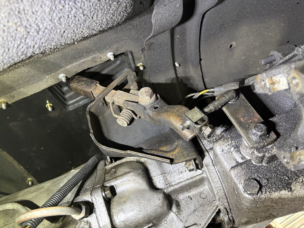

I have a line on an AW4 and 231 out of a ‘98 XJ. I was wondering about the shift linkage and mating it to my column shifter. Having not seen or messed with either my set up or the AW4 set up, I have fingers crossed that it wouldn’t be too bad to make it work. Anyone down this?
You should be able to mate them up, but might need to make a custom arm to get it to work. Really depends if you want the indicator to be correct, and be able to shift all the way down to 1.

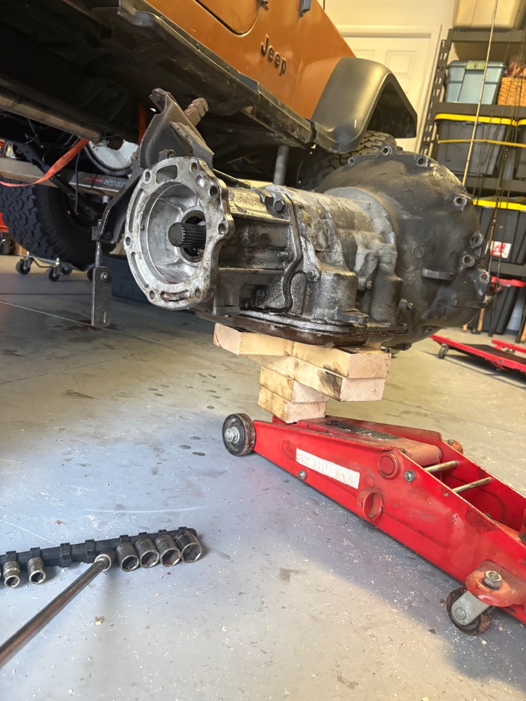

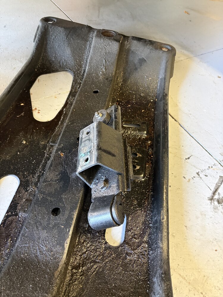

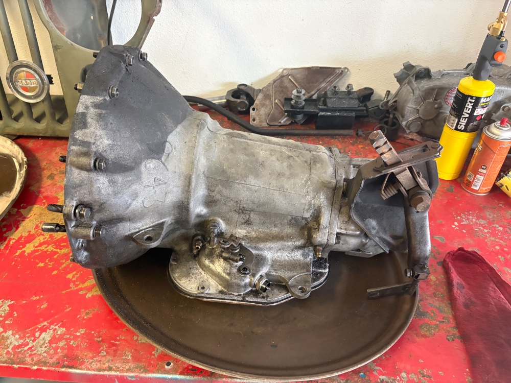

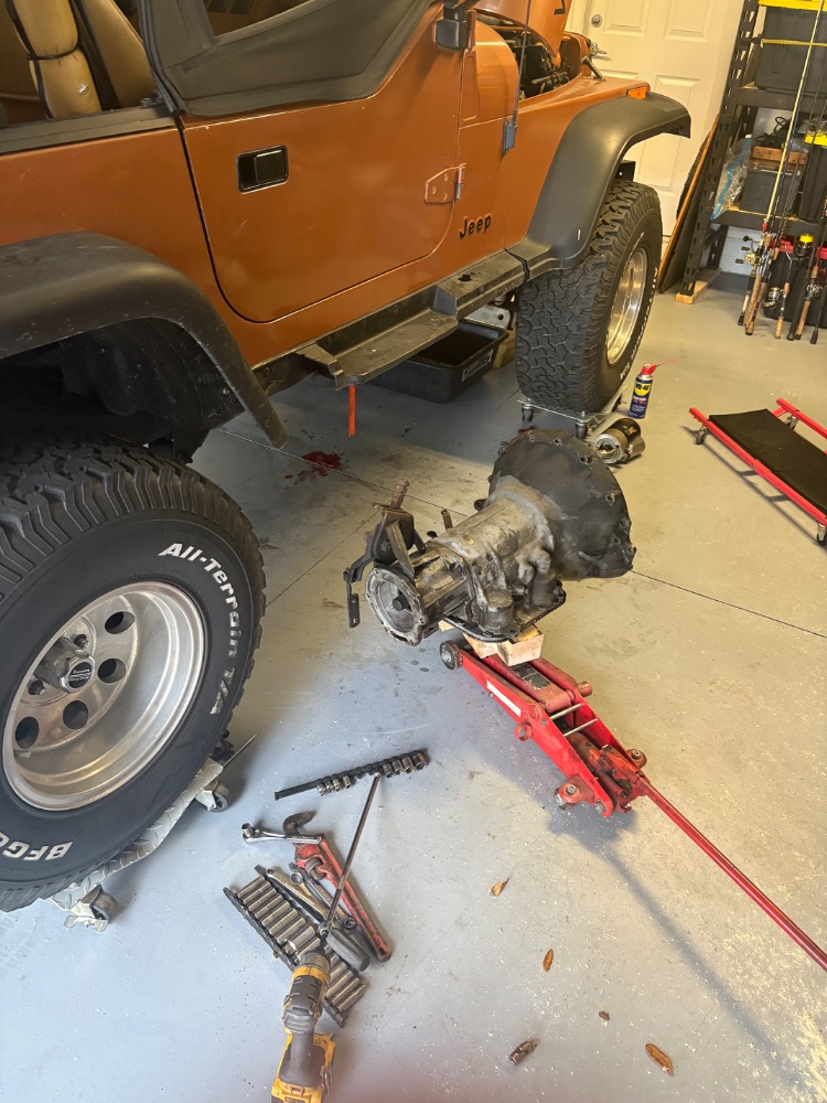

So I removed the nuts on the bottom of the skid plate the hold the tranny mount and stabilizer, then dropped the skid plate and the mount came down with gravity and the skid plate. No bolts holding the mount to the transmission. That’s kewl…
Not to mention the 2 loose nuts holding the tcase to the tail housing and and the shifter.
But, Tcase is out, trans is next.
