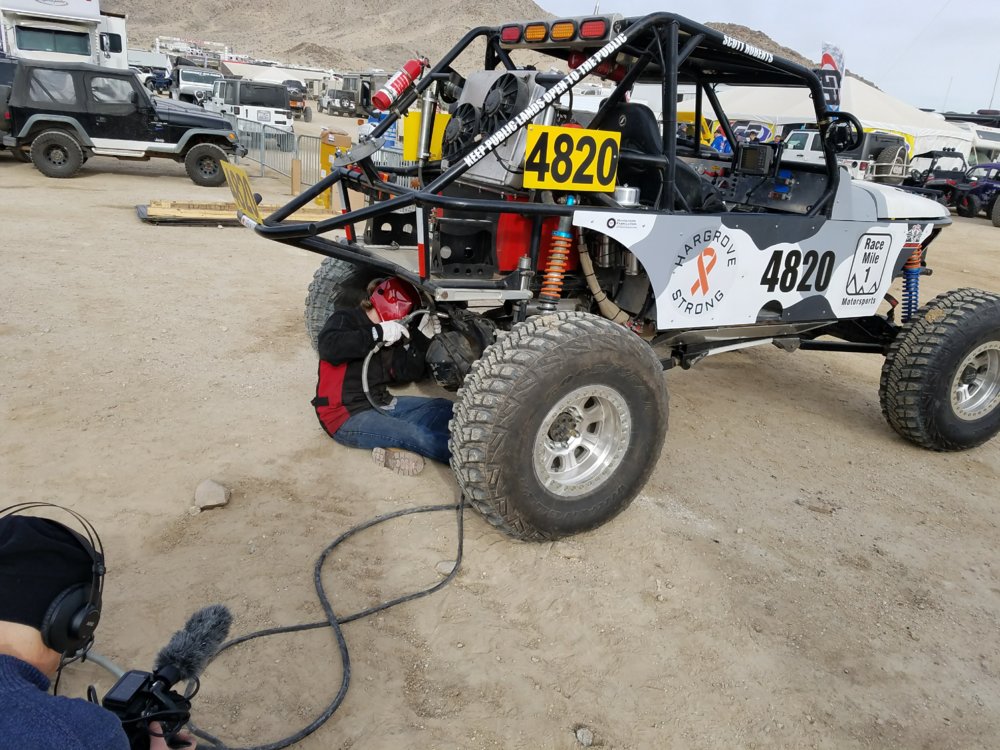

Following inspection, we sought out Phil Licciardi of Liberty Mountain Fabrication, who I had scheduled shock tuning with. Finding tuners who could work on Profender shocks proved somewhat difficult but Phil would end up helping us big time later on. We made one tuning pass which beat us to death and ran back to pull the shocks for the first time. We repeated this process about 3 times the first day getting a little better each time but the limit strap we had to put on to protect the driveshaft was severely hurting the rear, preventing the shocks from being able to fully cycle.
Mid shock tuning pass

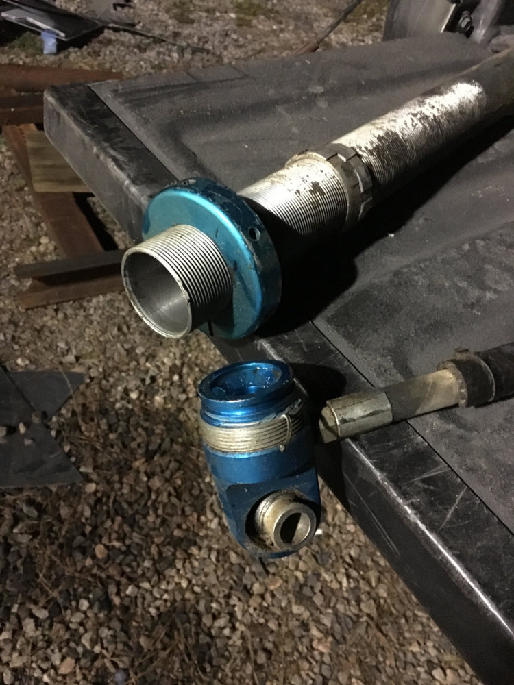

At some point I remembered Phil mentioning that he had a set of Radflo shocks new in the box. We get in touch with Ken and send him over to check it out. We bought the new shocks and with them, a new purpose to get this thing going again. Never easy, the Radflo shocks had a different size mounting bolt and different lengths than the Profenders. Back at camp, we head over to the ESAB booth in Hammertown and have them plasma cut some new shock tabs for us. Back at home base, we go to work cutting all of the rear shock tabs off, upper and lower. We also send a couple guys into town to buy the correct size bolts for the new shocks. After some grinding and drilling, we have new shock tabs but again no way to weld them on. With all of the tabs and gussets mocked up, we call it a night at 12:30 Tuesday.

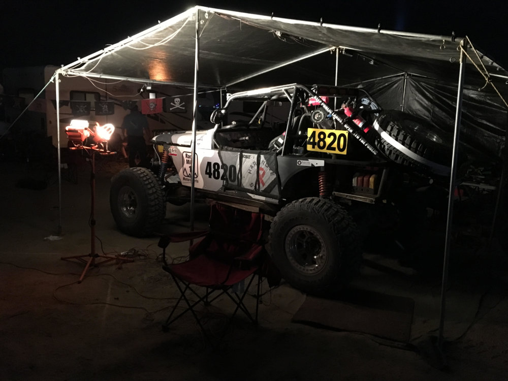

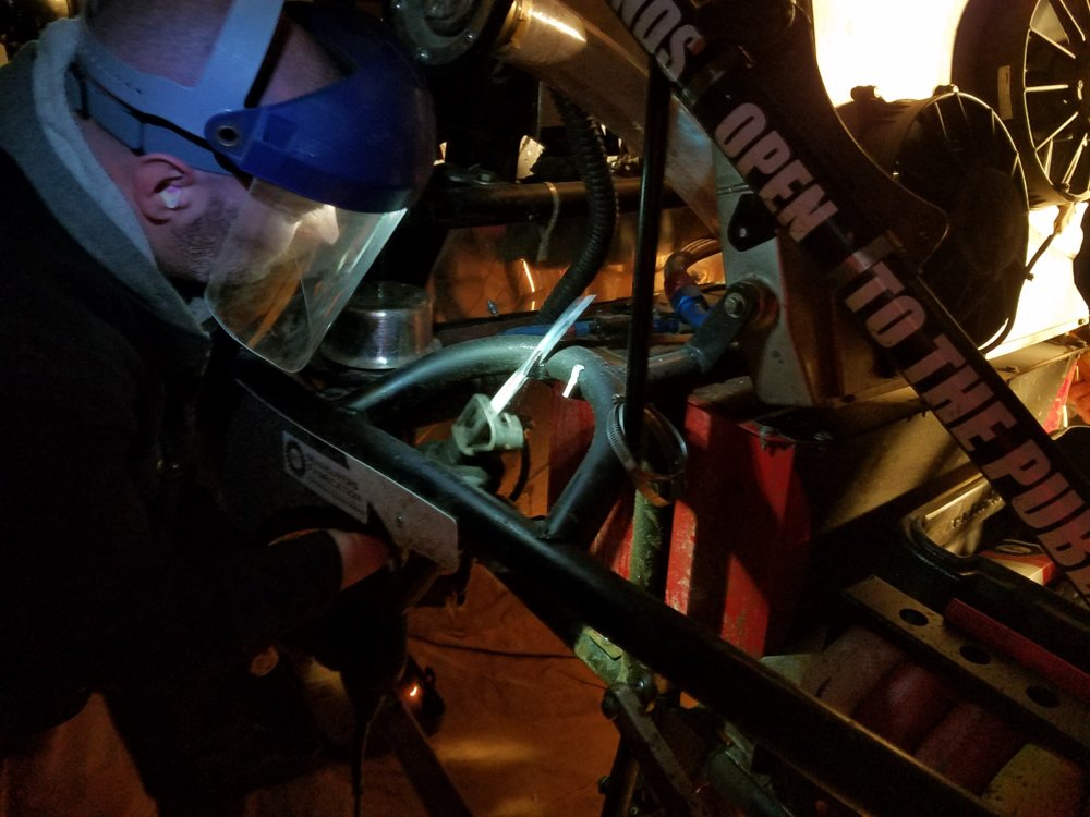

We are up early Wednesday morning and head over to the Ruff Stuff booth to get the tabs welded on. With the front shocks on and the rear sitting on the bump stops, I’m sure we got some weird looks driving in. We arrive before the Ruff Stuff crew is out but only have to wait about 10 minutes. Shock tabs welded on, we go back, install the new Radflo’s and take about 3 runs through the desert near our camp. With my confidence at an extreme low, we park the rig at camp and start prepping it for the race in less than 24 hours.

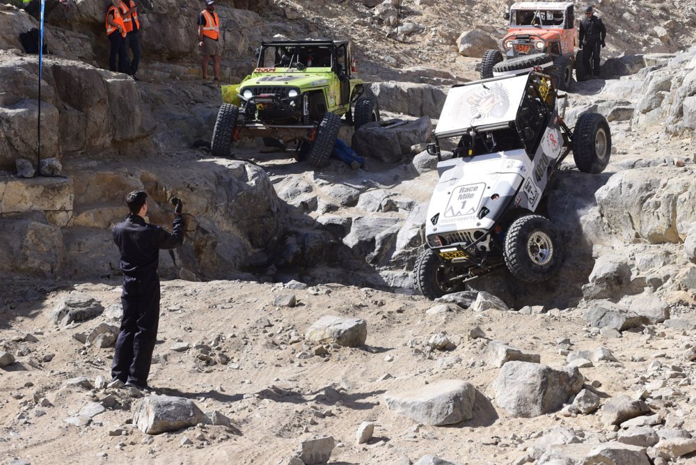

Next up was Sledgehammer which we would go down with no issues and then over to Chocolate Thunder, a big spectator spot. At the bottom leading into Chocolate Thunder, the course had been gated off funneling us through a short section of rocks that we hadn’t pre-run previously. We got hung up a couple times before hugging the passenger side and popping over. We proceeded up the left side of Chocolate Thunder, crested the top, then dropped into the valley leading over to Wrecking Ball. Once again, we would catch the faster cars in the rocks. At one point, Lindsay Gilstrap had broken and Shelby Gilstrap was hung up in the line we wanted to take. Another car had tried to pass on the right and got hung up as well. Lindsay abandoned her own car to help Shelby through, then spotted us through the same section. A great show of sportsmanship as she could have easily left and gone back to her car, and also to give Shelby more of a lead on us. We worked our way up to the waterfall. Having wheeled at Johnson Valley twice before now, I was familiar with this area and we didn’t hesitate to take the bypass up and around the waterfall. The climb was easy with a slight off camber section at the top that would lean you back toward the bottom of the waterfall. Just past this, the trail would split again and again we’d hit traffic. I knew the left line was preferred as the right line could easily put you on your lid if you aren’t careful.

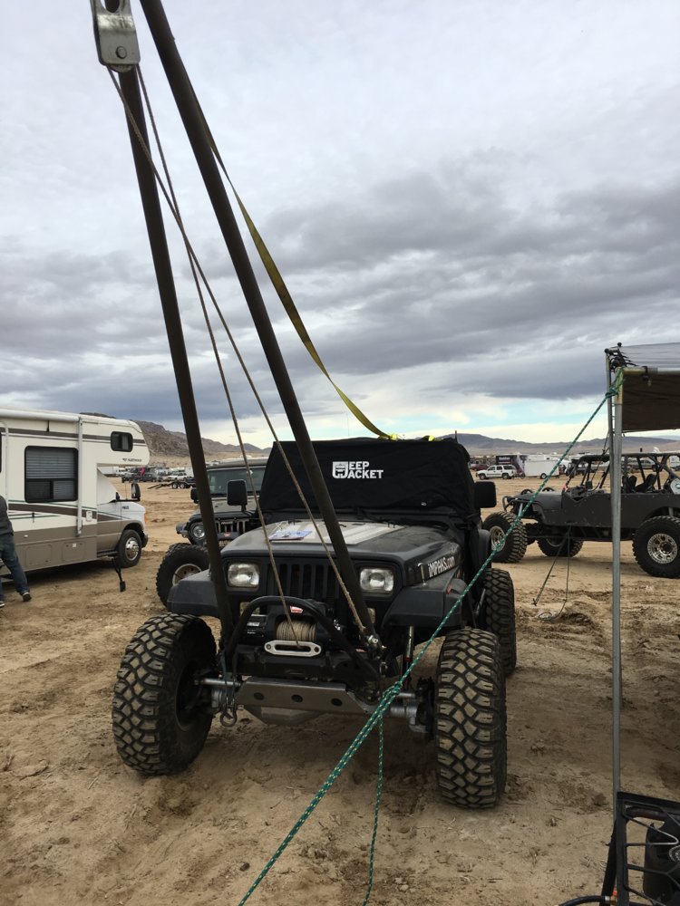

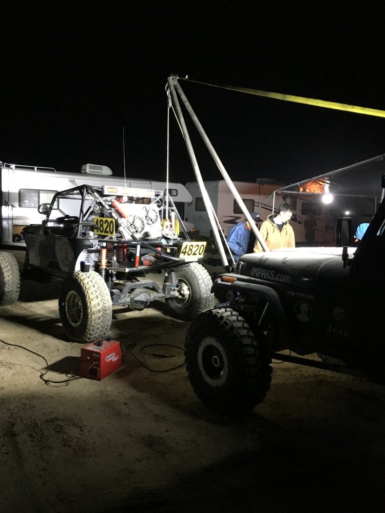

we used the jeep crane way more then we ever thought we would.. but it ended up being a life saver when we had to change the shocks etc..

jeep crane
The crane definitely made pulling the shocks faster, considering we did it 4 or 5 times.
