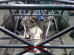

Just saw this...
Sammy Wingnut himself is responsible for that. I didn't notch that junk.:flipoff2:
