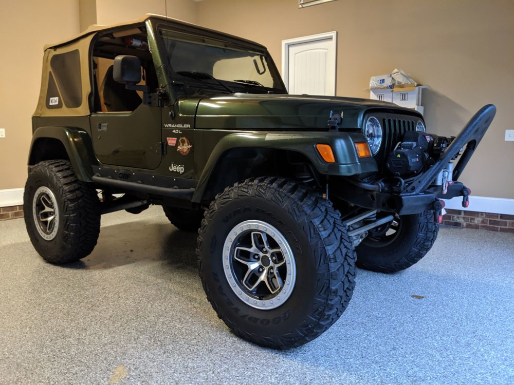

Yep, lifted my last two trucks and spent way to much money on my JK to ever wanna damage it. This time i made the smart move to let someone else invest the money but get all the benefits for pennies on the dollar.

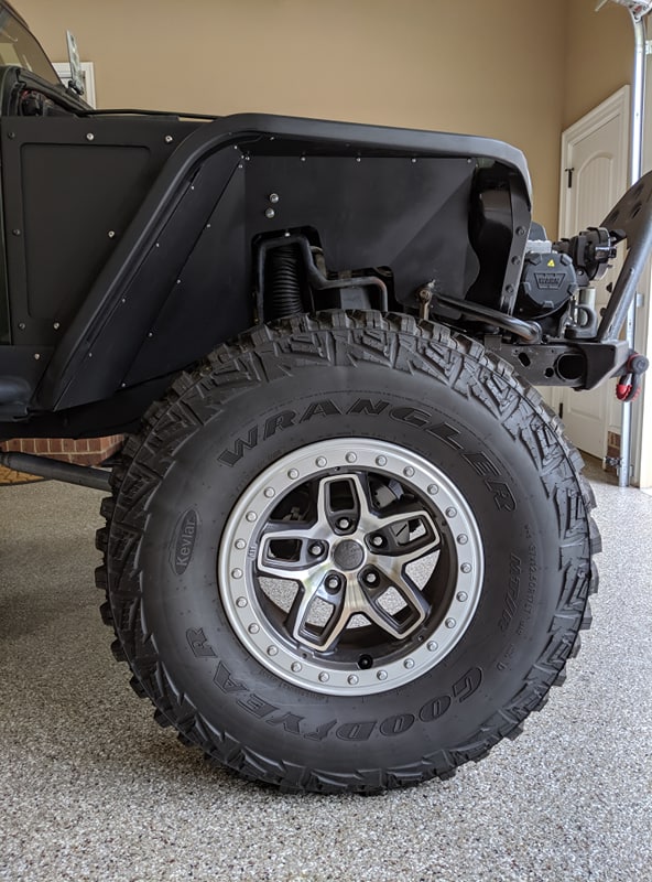

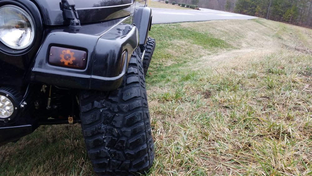

@Jason W. lower it meaning remove the coil spacer ? You think it will still clear the 37's to flex or are you recommending drop it and go down to 35's ?
I am recommending ditch the spacers, do something with your fenders to clear your tires, useable flex and useable are two totally different things, if you cant keep the tires planted and shiny side up it will do you no good. 4.5 inch of lift on a tj is allready tall, 6.5 is way to tall. Your center of gravity on that short wheel base will be a pain in the ass and very tippy on the trail.

There are a lot ou f fender options out there that give more tire clearance,, @obullfish @CasterTroy @Chris_Keziah , pic reference please
Look at metal cloak fenders, Jcr etc

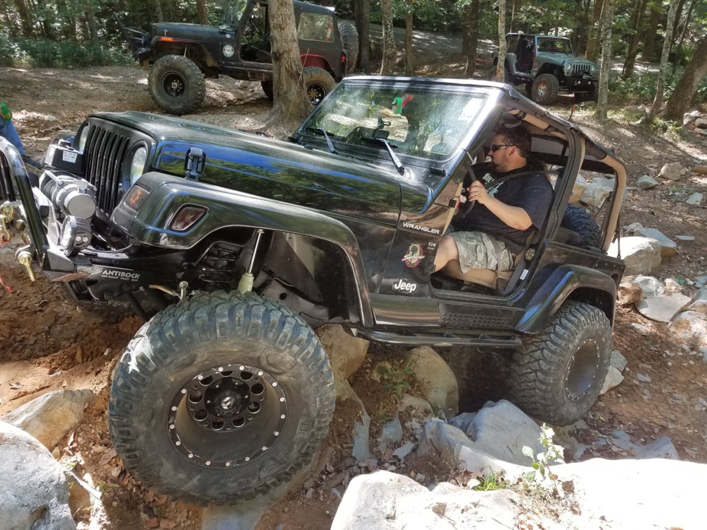

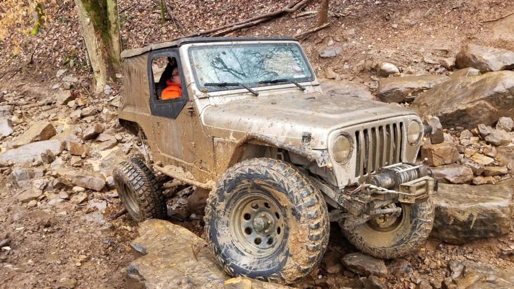

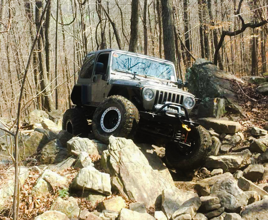

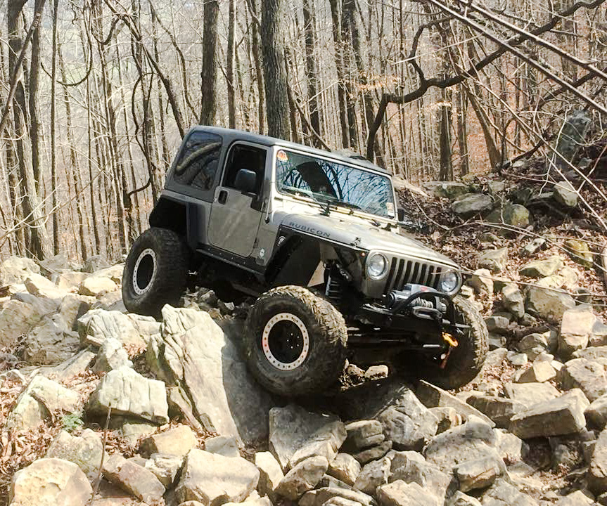

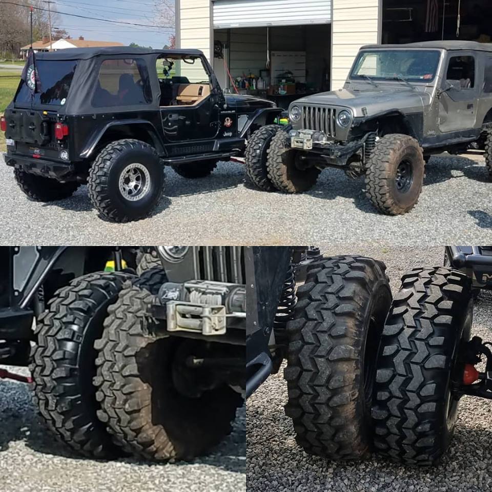

I started on 33's with a 1.25" body lift (so I could run a 1" barnes skid and tuck the transfer case) and 2" springs with stock length Ironman4x4offroad links.
When I stepped up to 35's I also stepped up to 3" springs.
I did extensive research and cycled my suspension 50million times with my stock fenders and 35's to get as much travel as I could WITHOUT having to change fenders. But I DID realize I had to do some cutting if I wanted to really wheel this thing
I figured out exactly how much to cut off
And it worked beautifully for 35's
But 35's just weren't cutting it for the wheeling I do.
I LOVE my CoG and didn't want to compromise that, but wanted more clearance for suspension, PLUS...I've wanted a set of TSL's since I was kid. And seeing how skinny/small Clay's 35 TSL's were, I couldn't justify the step from my VERY capable STTPro's to something that MAY be slightly smaller. So I decided to go 36" TSL's. But those are close to the size of a 37" MTR, so I HAD to make room.
I knew to get this bad boys under my Jeep and NOT make suspension changes I had to get front fenders and do some cutting on the rear.
I didn't have time/skilz to cut my hood and fold/crease it to my standards, and it would cost a fortune to have someone DO IT to my standards in order to use Genright or JCR fenders. So I had 2 options for non-cut; Metalcloak and Poison Spyder. I went with metalcloak to piss off the arrogant know-it-all's like Blaine Johnson with Savvy who LOATHES metalcloak, and believes anyone that buys from them to be douchebags. There's nothing I like more than making guys like Blaine seethe with disdain over something as trivial as a purchase made by a stranger :driver:
They work. Despite how critical many seem to be of them, they just DO.
Any critics can show up in their TJ 3 weeks to the above location and park their rig on the same rock and I'll be glad to listen to your schtick :flipoff2:
For a comparison, I'm parked next to Chris and his 38's with my 36's with 3" springs, and 1.25" body

Thanks for all the info. Well looks like I will be pulling the spacers and saving up my pennies for fenders.

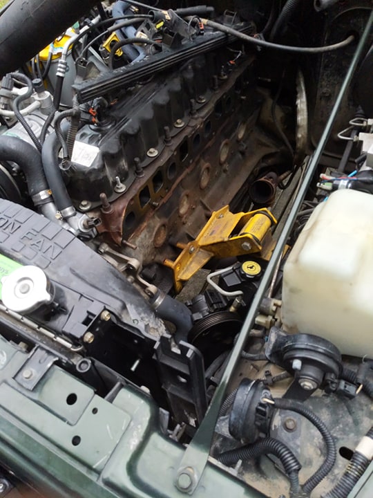

Put my new fuel pump in last weekend due to the drain valve causing it to loose fuel pressure while sitting and have an extended crank.
Tonight disassembled everything due to a cracked exhaust manifold. Got a new one and going to finish it first thing in the morning.
Mine started doing the same thing a few months ago. Just wish it would've done it before I had put the fuel cell in.
completed the exhaust manifold and dad said mines well keep going.

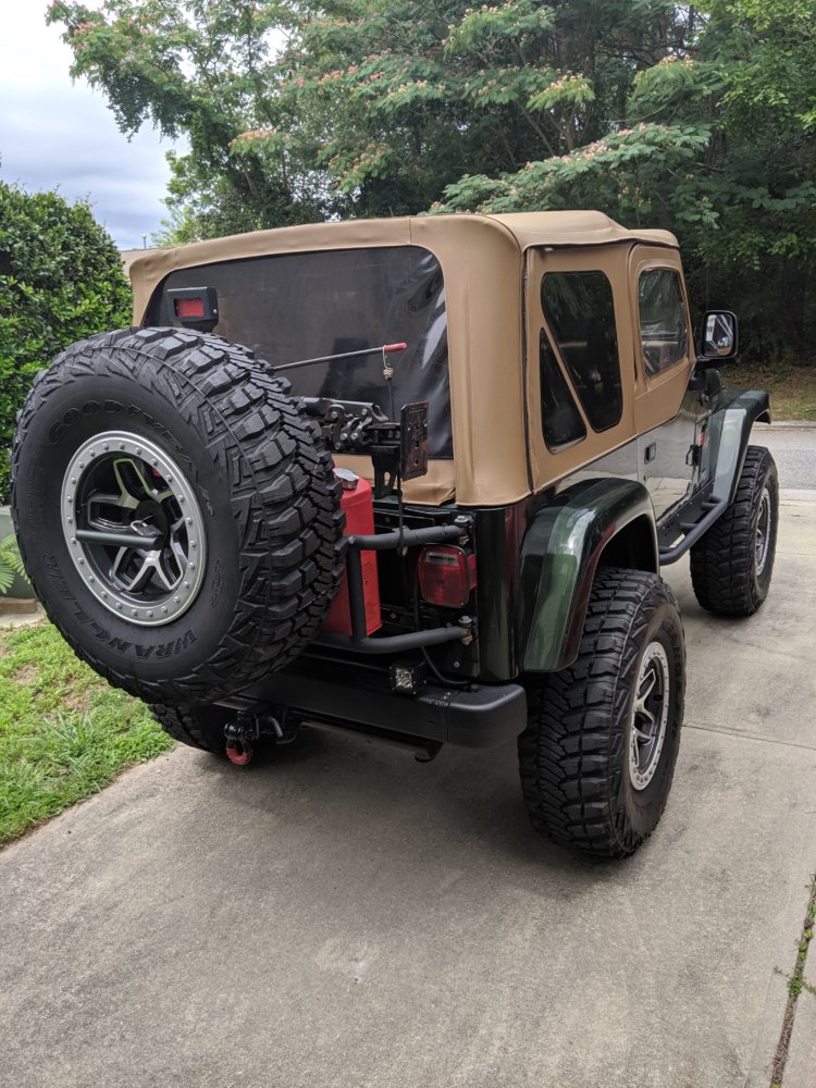

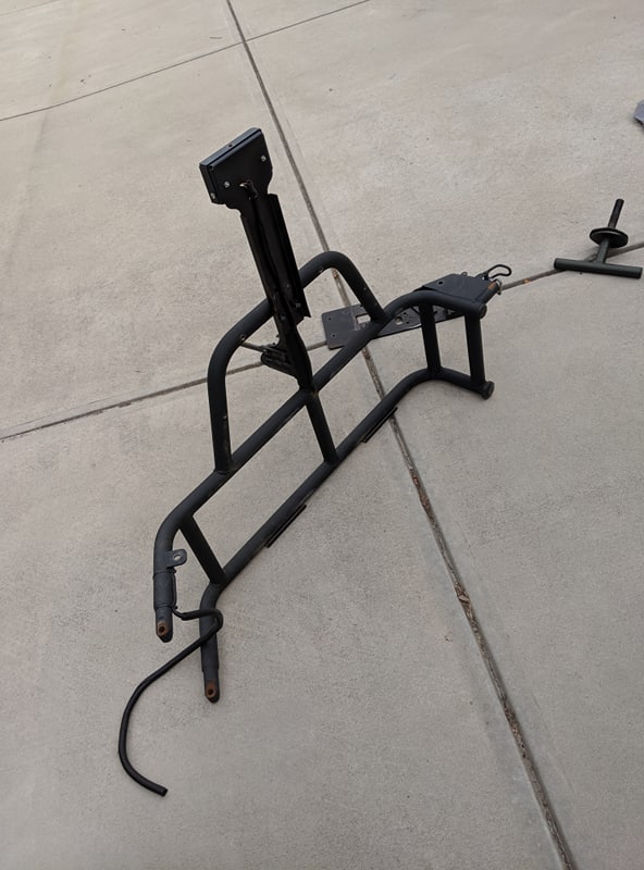

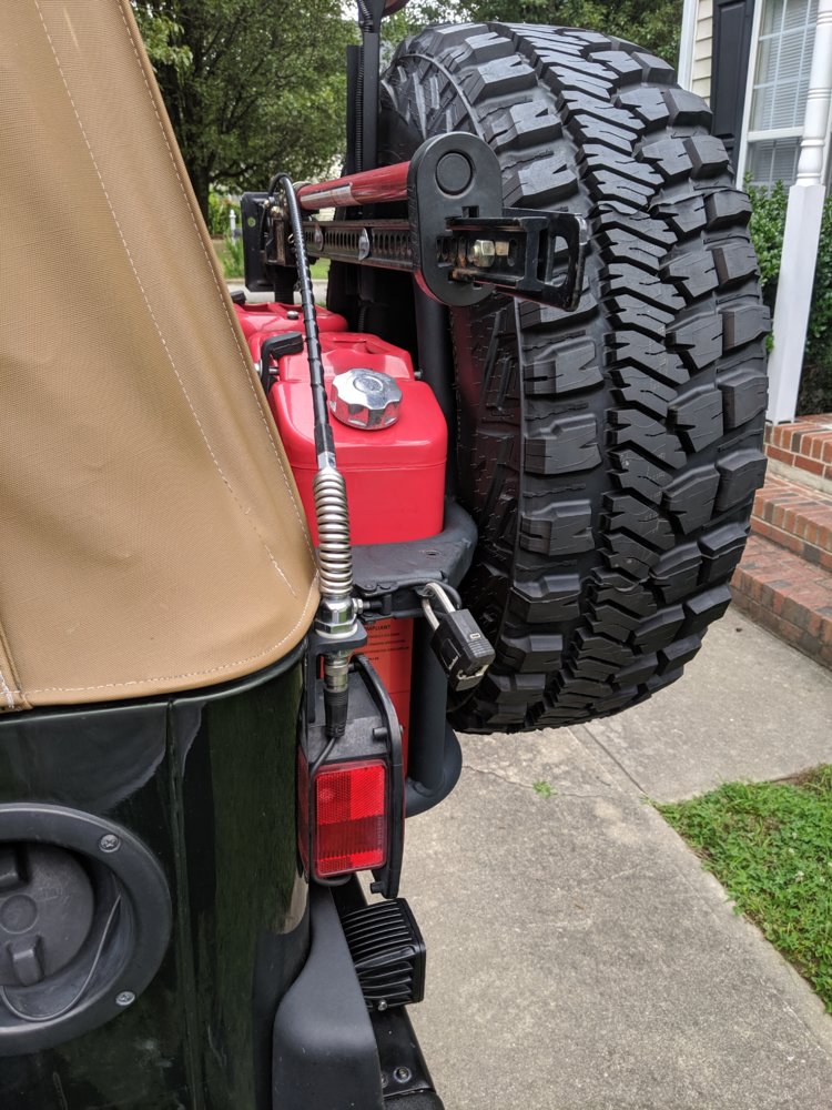

removed the spare tire carrier and have the spare in the rear behind the front seats now (questioning leaving it out and just carrying plug/patch kit. would like to know yalls take on that)

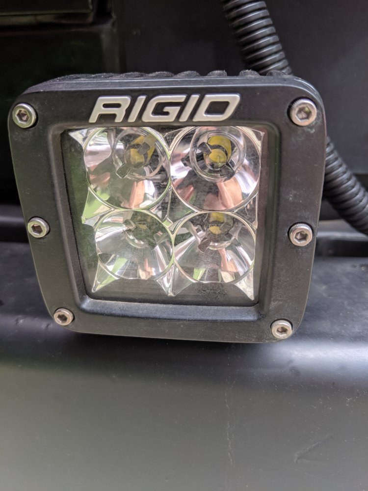

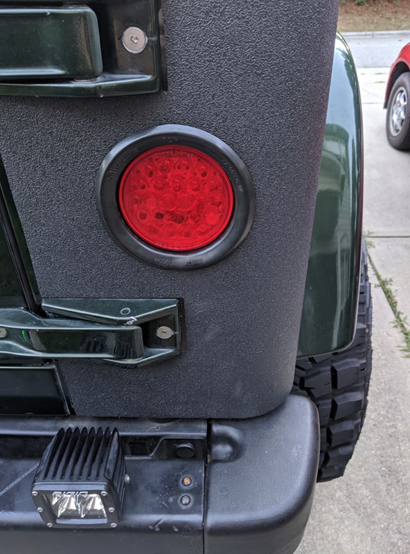

installed poison spyder rear lights and kept the rigid's as back up lights.

^^Agreed!^^
I've carried a spare for the past 19 years and only needed it when ONCE! (was running radials and cut one on Daniel).
Current front bias TSLs have chunks missing from the sidewalls deeper than a radial sidewall, but still carry a spare.
I figure the day I take it out will be THE DAY I need it...

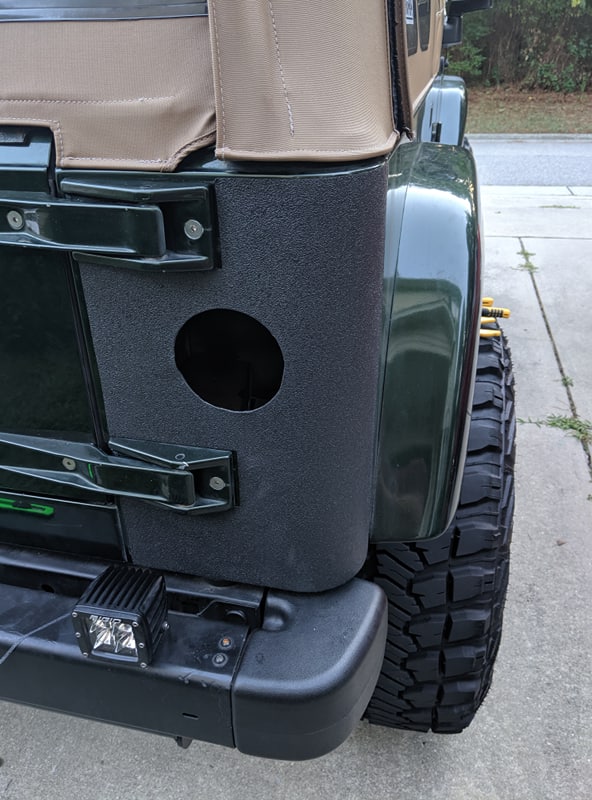

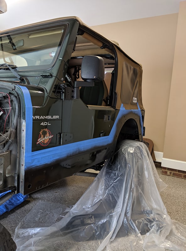

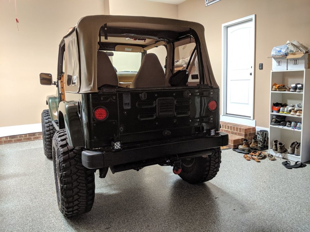

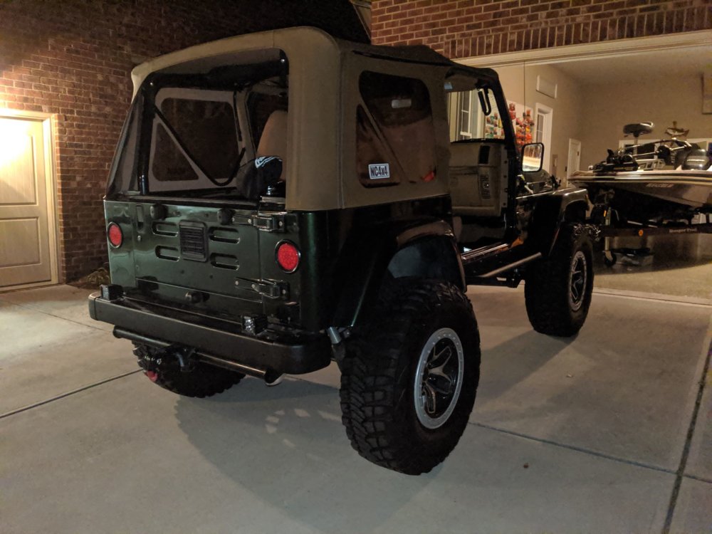

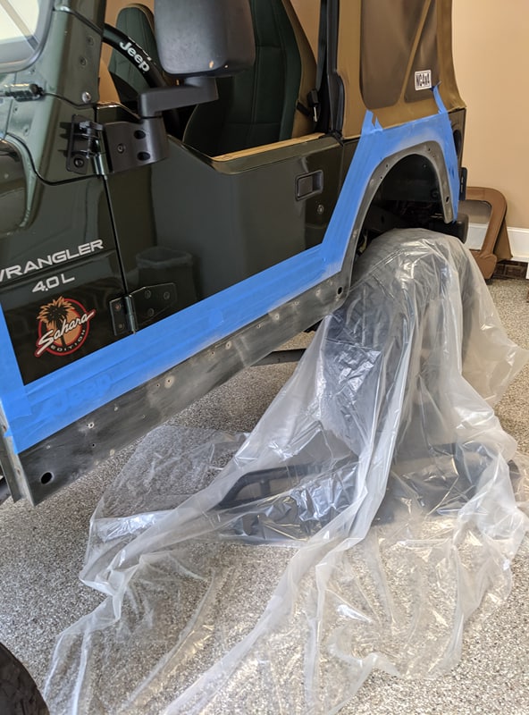

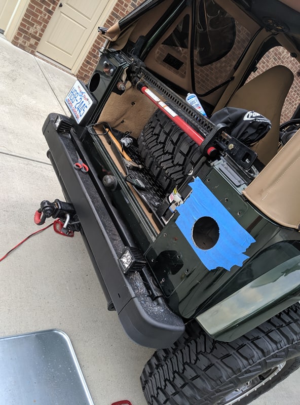

Used some thick precut to cover up all the bolt holes from the tire carrier and to wrap around the bare metal from where i cut the holes for my poison spyder led tail lights. reassembled and finally got my rigids on the rear wired up as my fog lights and cleaned up all the wiring from the previous installs not done by myself.

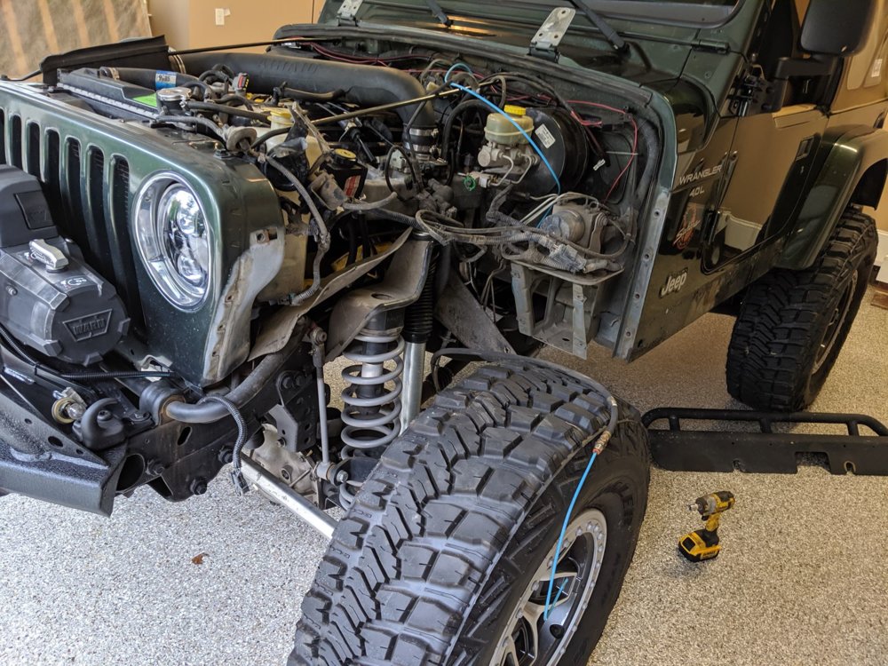

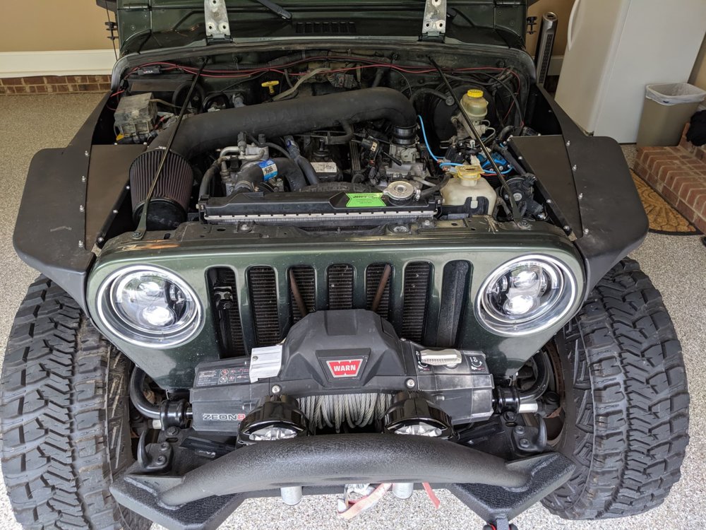

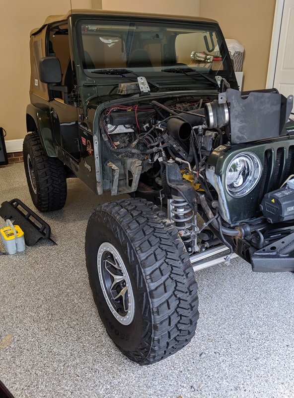

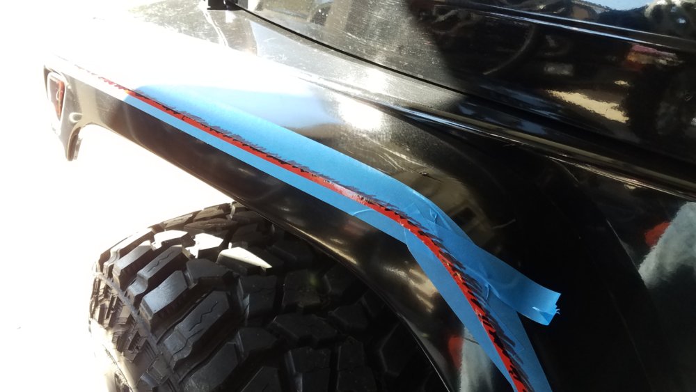

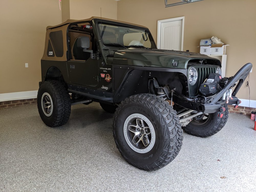

So this weekend put in a ton of hours, dismantling the front end, moding all the brackets / making new ones to hold everything to the new inner fender liners, mounting up poison spyder fenders and modifying the hood for louvers for when i get it. Only thing left to do is cut the hood and install the hood pins.
mounting all the factory stuff back into the limited space after high lines was quite a task but completed it and stoked with how it all turned out.
Once all that is done going to remove the coil spacers and replace the sway bar end links with ones of the correct size (as they are too long and adjusted incorrectly as it sits)
