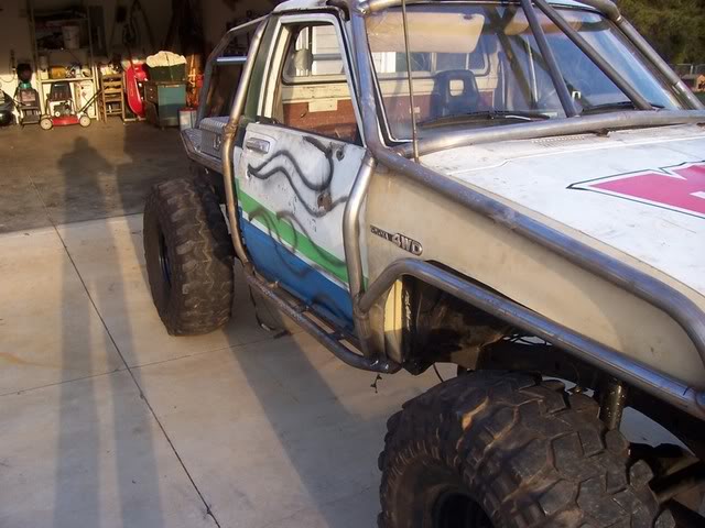

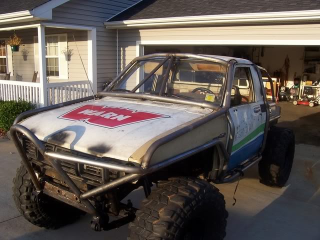

Andy at CRS finished up my front end and did my high steer.
Couple of pics

Anytime, Its pretty much finished now. I took it to uwharrie this weekend and it did pretty well. Trannies rocked. I've got some final tinkering to do and It needs ifs finished paint. But its wheelable.
