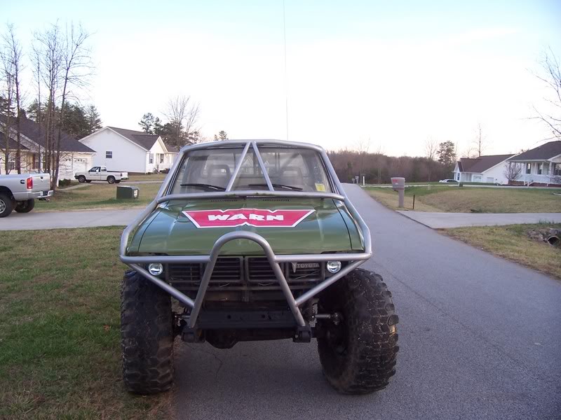

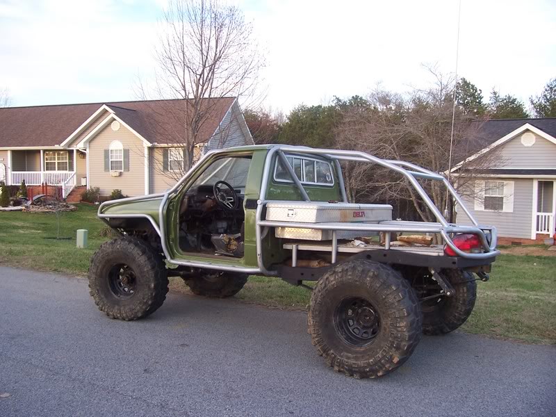

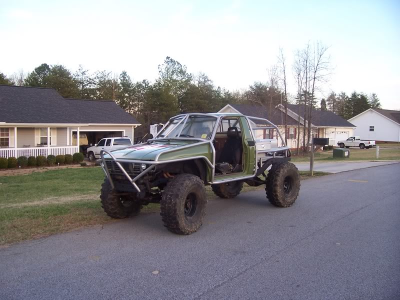

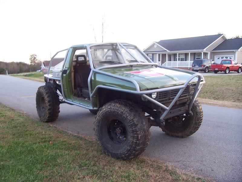

Finally got a coat of paint on it.

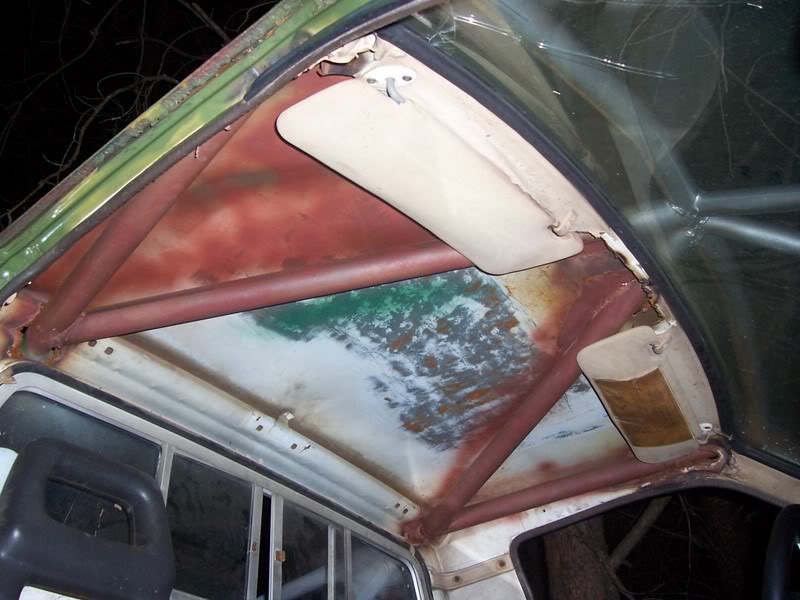

I LOVE the tube going into the cab above the a-pillar... take a shot of the inside looking up? :beer:
how much do you think it'd cost to get a flatbed and exo like yours fabbed up for?
Depending on who you go to, I'd say 700-2000. Really varies, Andy at CRS did the front half for 1100. That also included setting up my high steer, high steer links, and several other parts. I'd say 6-700 went into money for the actual front half.
Do you plan on supporting the rear part of the cage any more? Like bringing another couple tubes down to tie in the top ones over the bed.
Thought about it, nope. I think the'll be fine in a roll over, if they do crush. There easy enough to replace. They would make it a pain in the ass to get things in and out of the bed area. I want to to be functional space.

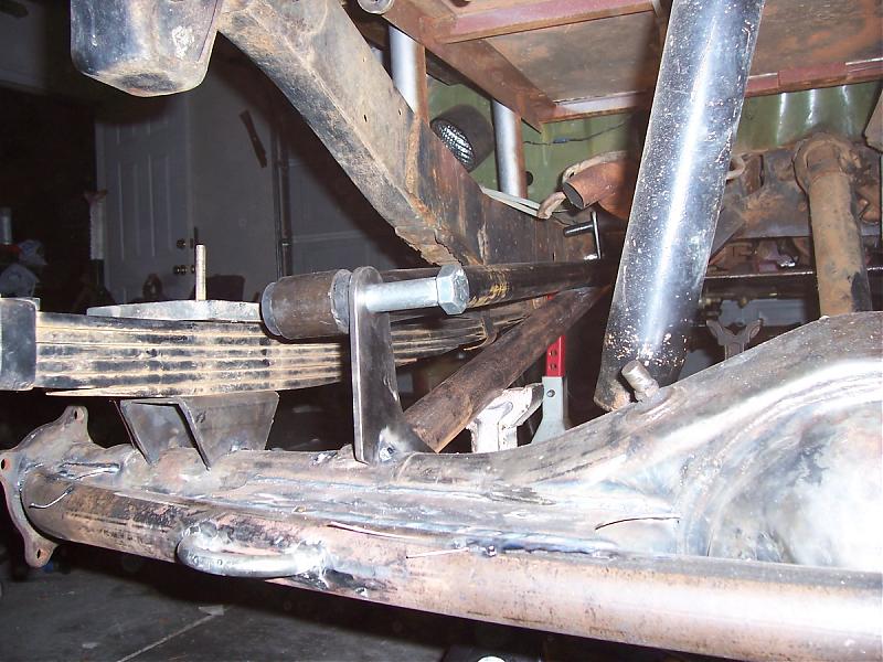

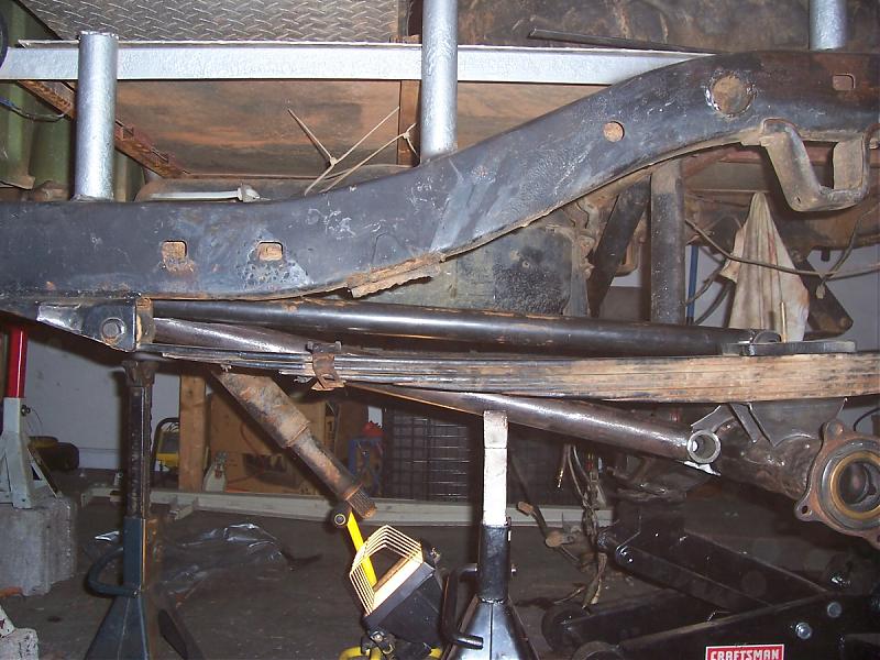

Ok, this is my attempt at a antiwrap bar. I have about 3" of lift, so the upper link sits flat pretty much. My understanding is that this will improve my antisquat numbers.
Opinions before I weld everything in.
You can also sorta see my rear axle truss.
