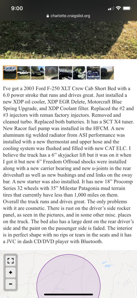

So there’s a potential career change happening soon for me where I’ll need a truck to pull a trailer 5 days a week, the trailer is a 20’ trailer and will be loaded with bread, doesnt seem like much but apparently bread gets heavy....anyways, found this truck it’s an 03 6.0 with all the stuff done in the pic (supposedly). Looks like it’s got everything done but studs, a friend of mine that once had a 6.0 thinks it would be good to go...I think stud it just to be safe, what’s y’all’s opinion?

A guy I work with has a 6.0 that has been "bulletproof'd" 3 times. Final time he purchased a set of aftermarket heads that are supposed to have thicker sections in clamping areas. The horror stories of the truck blowing up while towing a trailer are enough to keep me away from any 6.0l (bulletproof or not)
I am ALWAYS a fan of older paid for trucks, but if I were using said truck to tow heavy every single work day, I’d either have a backup handy at all times, or I’d buy a new truck since it would be a write off and expense for work.
If the truck lays down, do you have a backup, also, will you be able to make money without the truck?
That’s not anything towards the 6.0, I actually love them. Once fixed they’re great trucks. I would feel this way about any truck that old being used to tow daily to make a living. I trust my truck anywhere with well over 500K on the clock, but I would want a backup or newer truck if I had to tow with it daily.
Just something to consider. Good luck with your new venture!

I'd never buy a pre-05 superduty because the ride sucks, the turning radius sucks, and the transmission is not nearly as strong and reliable. The 05+ have a coil spring front end, and beefier axles and transmission.
