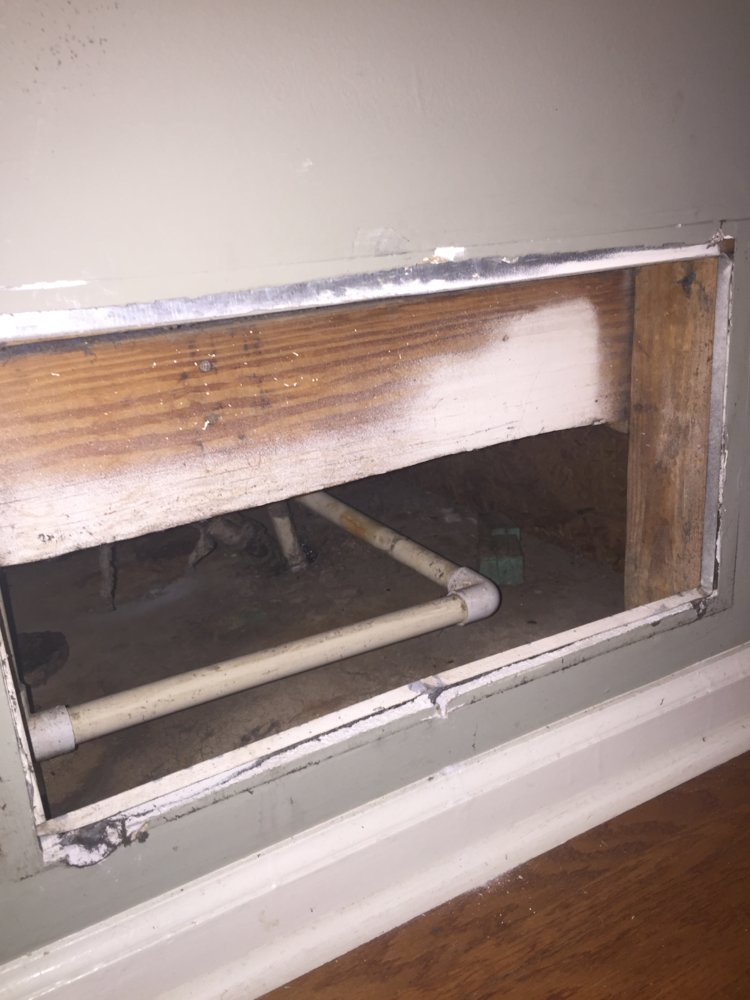

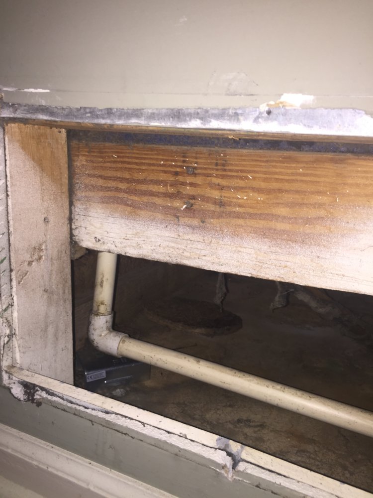

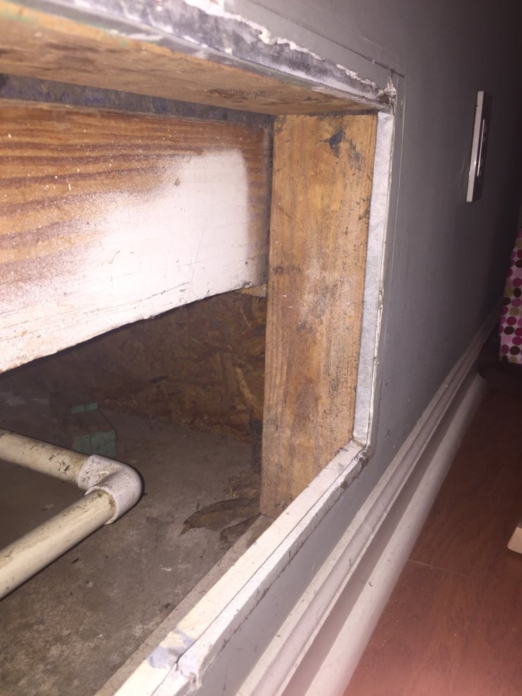

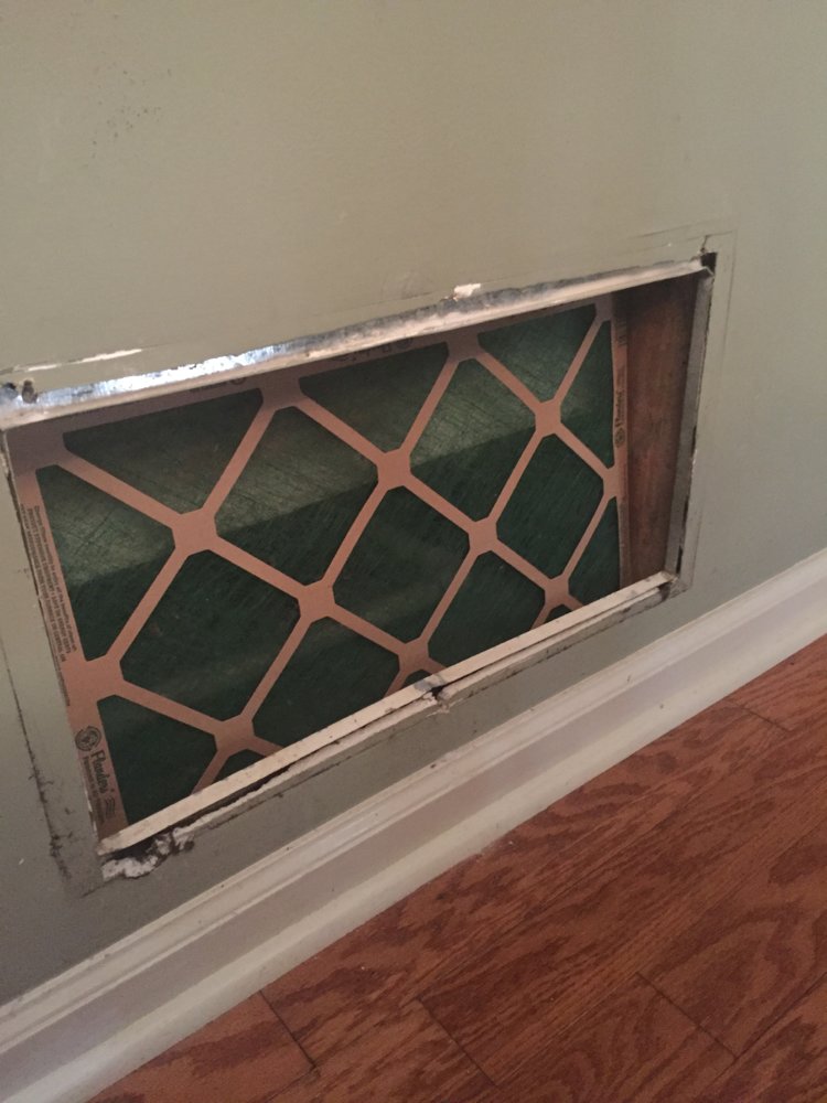

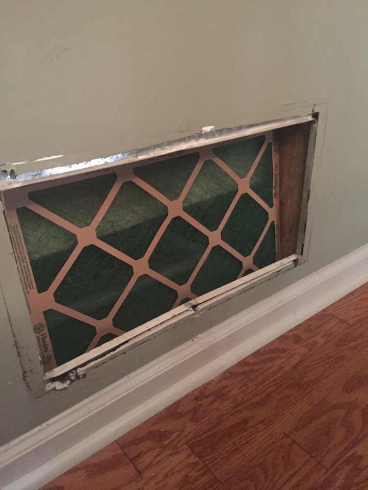

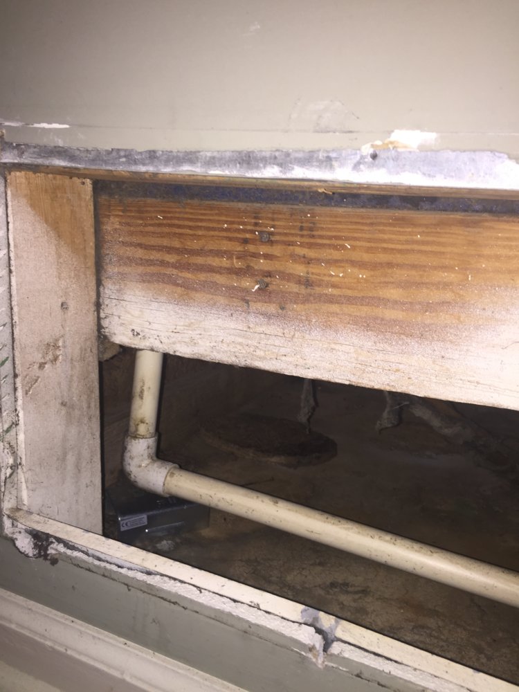

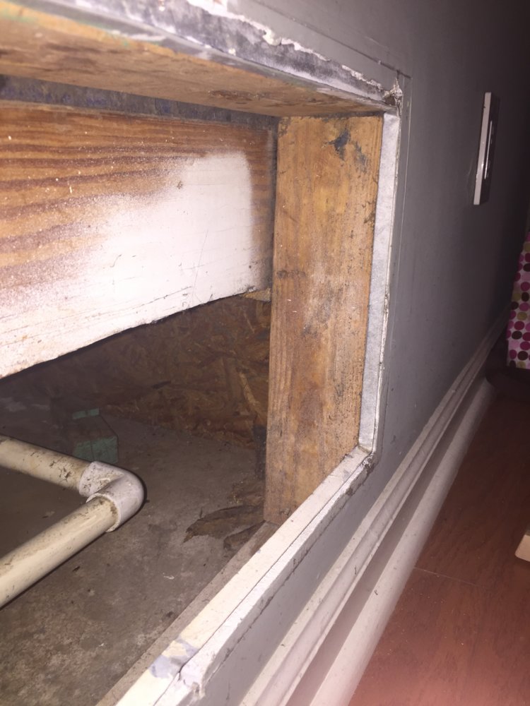

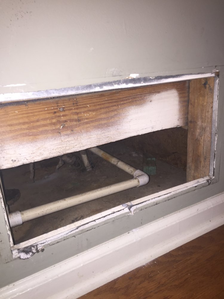

Alright, New HVAC system is in and man! It is so nice to have nice cool air circulating through the house! Outdoor unit is super quiet and indoor unit is quieter than our old one, just not quiet enough for us...Now, I know a lot of the noise is through our tiny return... its a 10x20. I thought that I could upgrade to say a 20x20 return, but the return needs to be smaller than the box the Handler sits on. I could probably upgrade to a 14x20 or maybe a 16x20. It just seems a lot of the noise is coming from the air being forced in such a small return. Also, the closet that the handler sits in is not a sealed, full closing door. So just wondering if upgrading the size of the return would help enough and if there is anything I can do to make the handler less noticeable while inside?
Current opening for return. Options?

At least remove that board that is blocking the opening and open the opening even closer to the floor as much as possible.
I was thinking the same thing. I can tell that the majority of the noise is coming from the return. Is there anything I can do to help eliminate the noise produced by the handler itself? Does the closet door need to be open so it can breathe or can I insulate it a little better?
You want all your air flowing through the return so it’s filtered. It looks like your return isn’t ducted but a simple return grill in your wall.
I’d seal the door up as best as I could. I’d also open up the existing return as much as possible and keep a normal size filter.
So no issue with having an 80% furnace and sealing the door?
The openings on the furnace door are for your combustion air. You can not seal that off unless the furnace has other options for combustion air.
our furnace door has no openings in it, just a regular closet door. The door does have gaps, that i used weatherstripping on to seal it better once its closed to reduce the noise heard. i do have a pipe that comes down that is open that allows fresh air in the closet (im guessing that is what this pipe does) would that be for combustion air?
That pipe is probably for exhaust.
Unless I’m missing something, it sounds like your furnace is drawing air from the closet and using that air for combustion as well. And by the looks of your return, it is not ducted and allows air into the closet via the hole in the wall with the filter?
