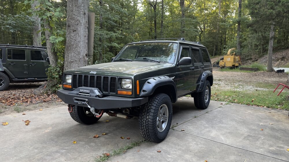

should be good to go after dumping about $2k in parts and labor :D

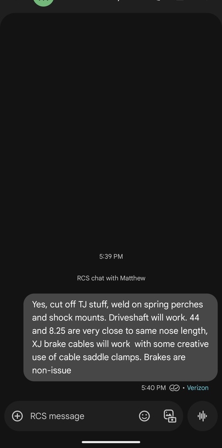

Hopefully not! Plan is to cut the brackets off the rear, weld some perches and shock mounts on, and bolt them in. They are TJ Rubicon axles in good condition from a running driving Jeep. I do need to figure out the locker pumps, but I assume a couple hundred bucks on eBay will get that done.
