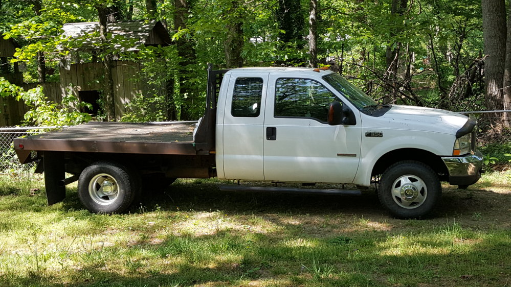

if you look like a Commercial Vehicle
Guilty... but despite having to be run under a "commercial" insurance policy (the C&C VIN is different than pickups w/ beds) is 100% personally owned, not for business/Commerce, and has a regular16k# weighted NC tag...

I have a Ford F38 , at least that's what the title says , My insurance company said it has a commercial VIN , and were charging me commercial insurance rates , I worked up a deal with them , slapped "not for hire" on the doors and got the truck insured as a "recreational vehicle " . Insurance went from $350 every six months to $147 every six months .
I think that's a mid-90's C&C truck, right? :D
That's exactly what my insurance writer told me about the VIN on my C&C, and that it's have to be written on a separate "commercial policy" from the others.
