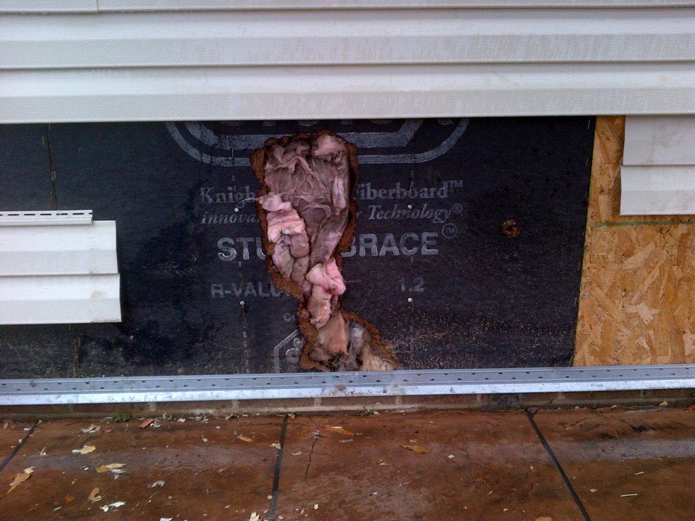

Our kitchen sink is on an outside wall and always freezes up if the temperatures gets down into the teens. I finally decided this past Sunday to figure out why. I thought maybe there was insulation missing. To my surprise, when I pulled the vinyl siding off, part of the wall was missing! I removed what was left of the fiber board and the ruined insulation, added pipe insulation, replaced the wall insulation, and installed OSB. Pipes did not freeze last night or this morning!!View attachment 112460
I'm guessing your house was probably built probably mid '06 to mid '07 when osb was $20 a sheet and contractors were using the fiber board between OSB corners.
Bad thing is someone can kick the whole wall in easily.
Close! It was built in 2005.

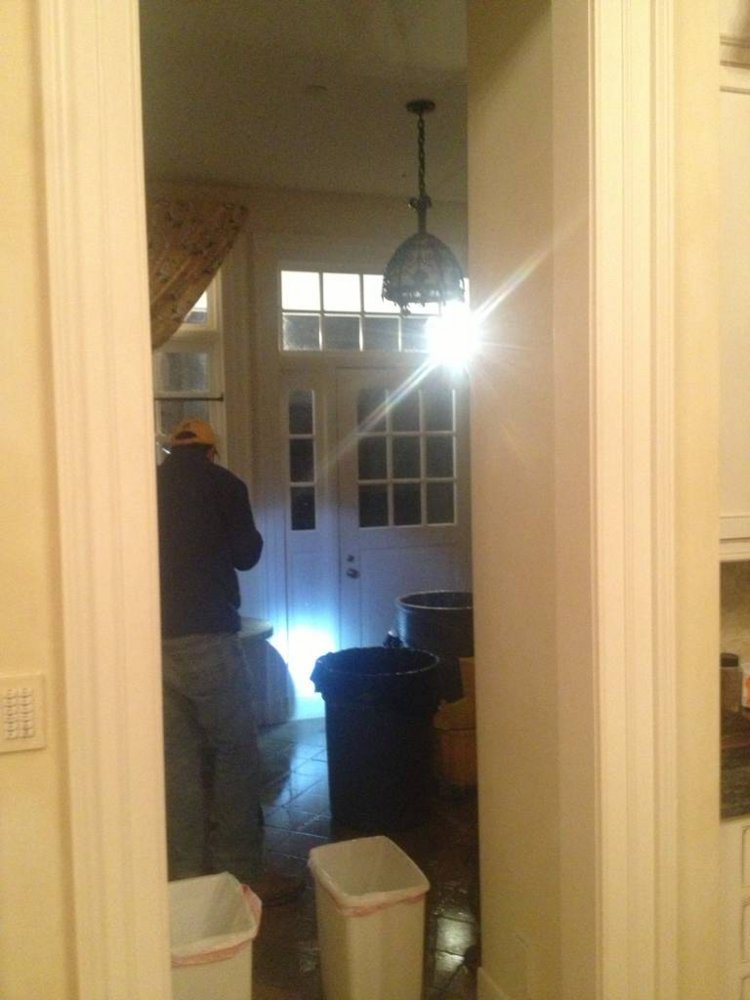

My phones been ringing off the hook. Just finished up a flood job in a million dollar home in Irving Park Greensboro. Steam unit in the attic for a steam shower busted. Flooded the attic, master bath, down into the living room. Now on the way to the next job in Eden at Willow Oaks Plantation. Downtown Marriott in greensboro had main water lines on the roof burst and flood about 8 floors. Didn't get that job though. Sucks cause thats about 100k job. Crazy. Ill be working all night between job sites. I will try to get pics when time allows.

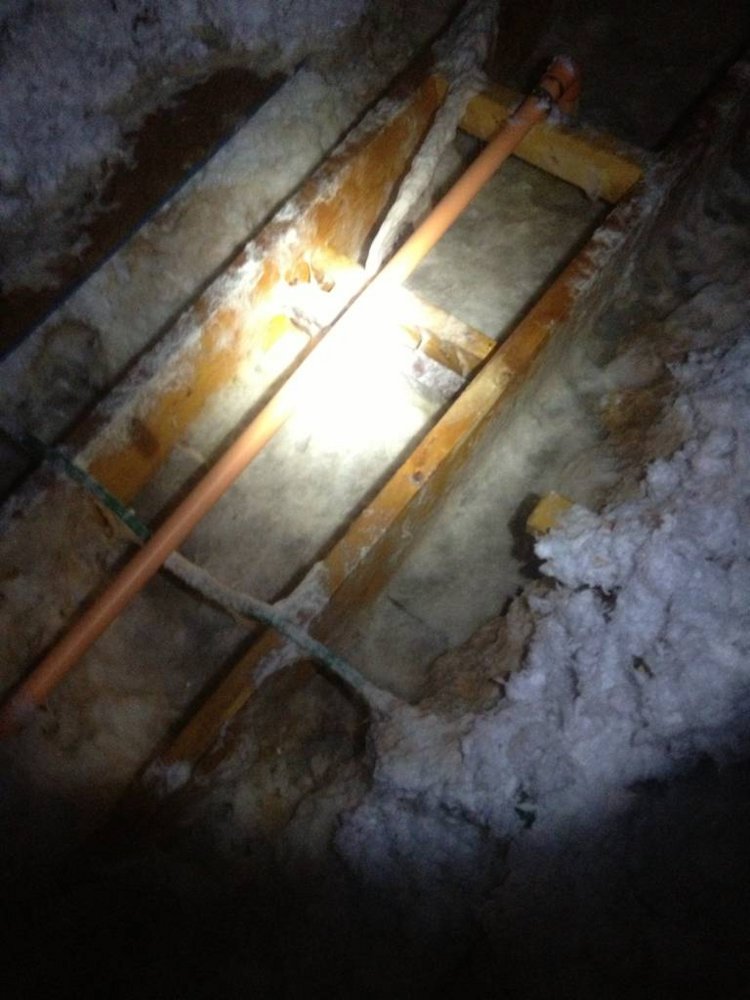

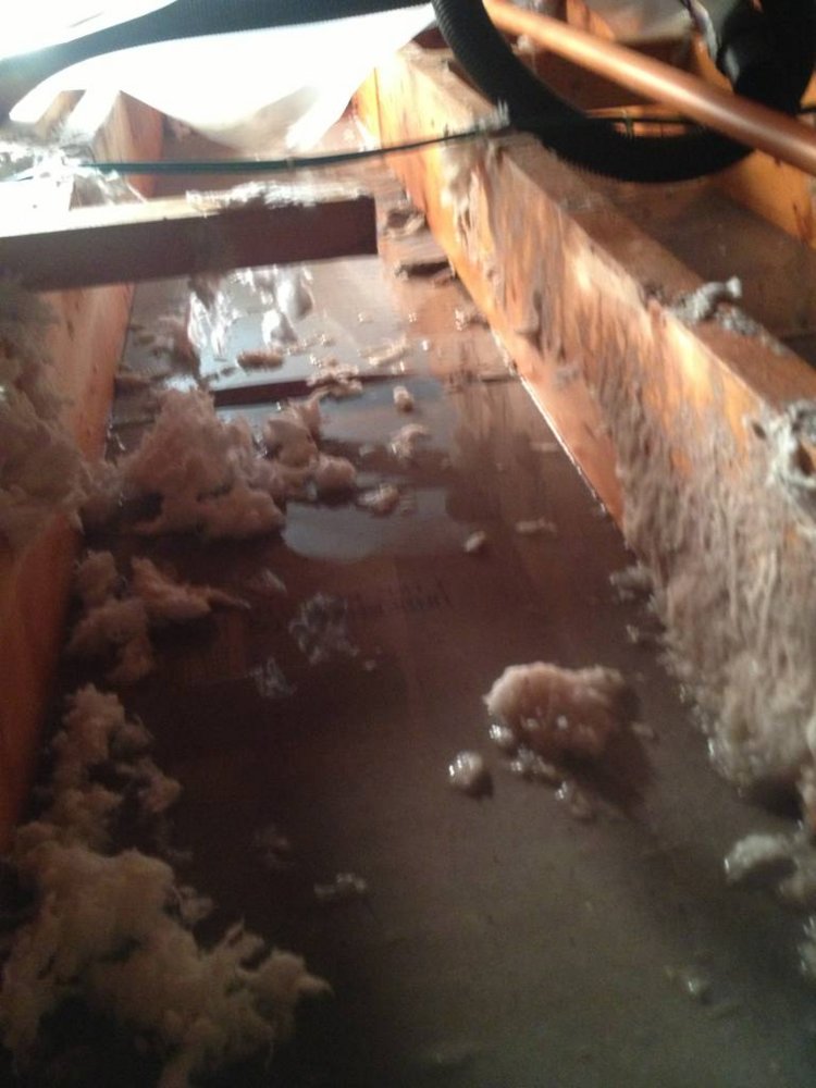

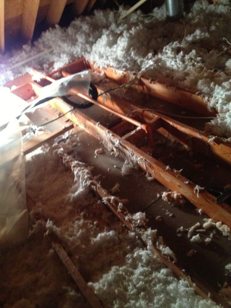

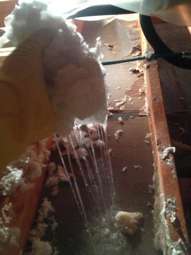

Well I worked till about 2am last night cleaning up flooded homes. The pics I took don't really show what's going on or how bad it actually is. I have a few pics from in the attic. This house had a sprinkler system and the line above the foyer as you enter had flooded the attic. Right around the break its visibly soaked, but the water ran all thru the attic and only the top layer of blown insulation was dry. It all had to be bagged and come out. It ran down and into the duct work for the HVAC system, flooding that too. Water will travel south and keep going and going! And let me tell you, a small amount of blown insulation in a plastic bag is very very heavy!
