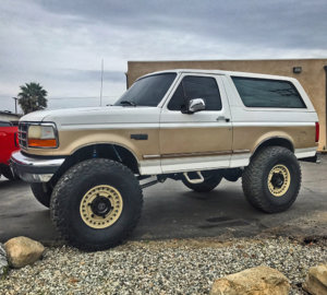

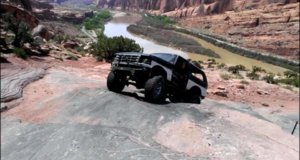

Well I'm moving on from the yj and settling onto a fullsize bronco. End goal that I can think of atm is going to be running my 40s and superduty axles. Doing some comfort mods, soft top and fiberglass fenders. But Still trying to pick out the right bronco. Going to look at an 86,(302/aod/bw1356?) that hasn't run since spring supposedly due to a fuel pump, this weekend. Eventually plan is to run a c6 and doubler, engine is tbd, more or less will be based on what I find. Should make for some entertainment for anybody who wants a good laugh I suppose. I'll post up a few pictures of some of the inspiration I've found.

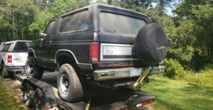

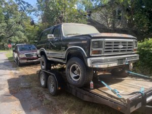

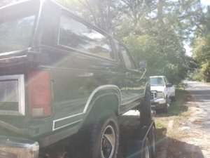

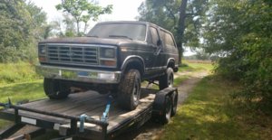

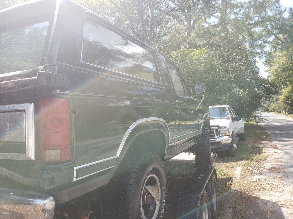

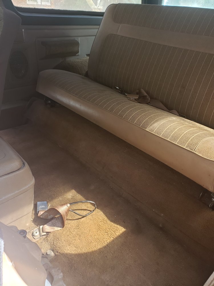

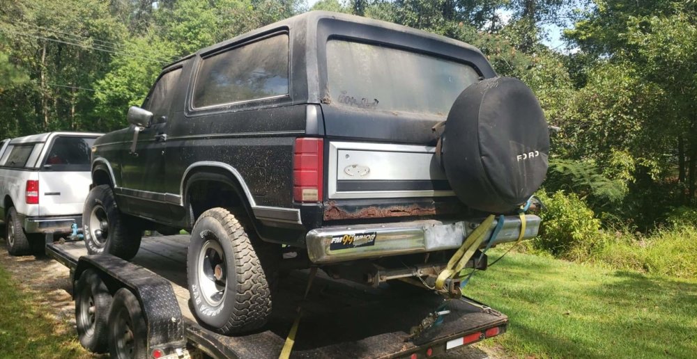

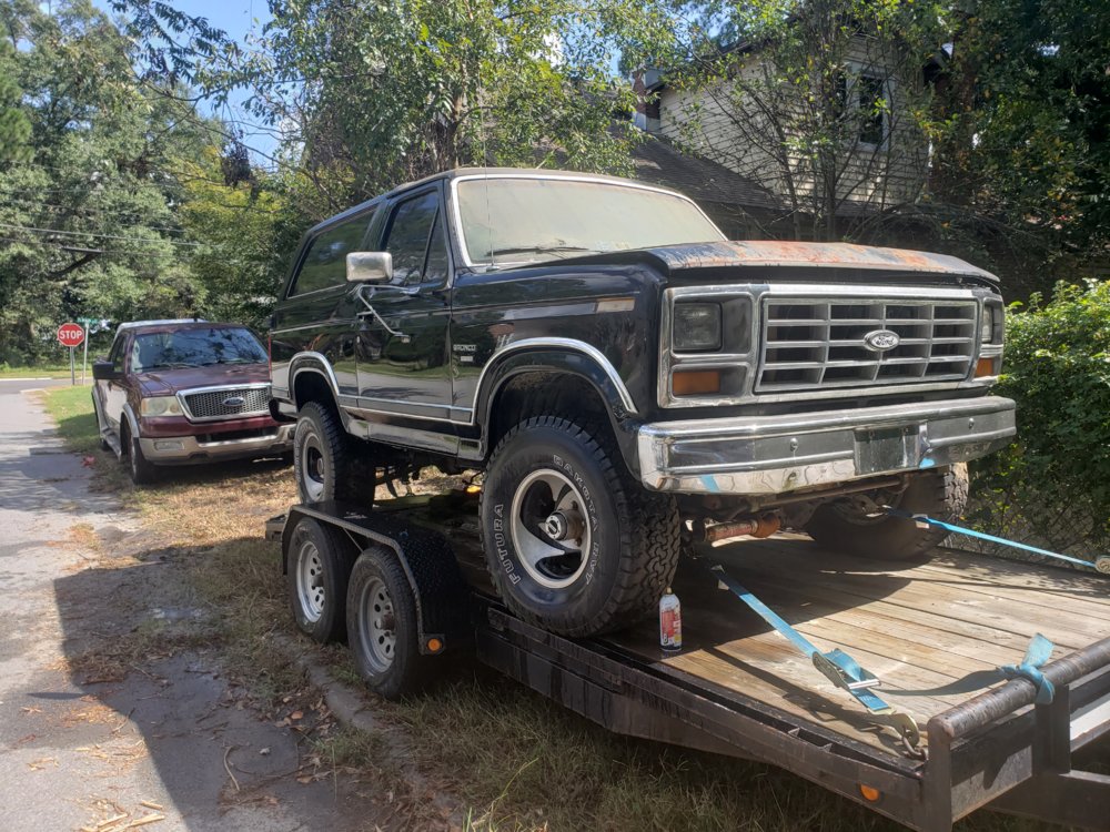

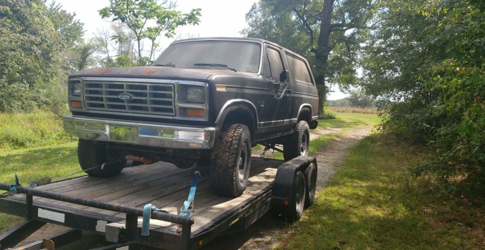

Went and picked up a project bronco today rust isnt too bad besides the tailgate and a little above the wheel arches. For $1,000 it was hard to pass on a relatively rust free chassis in the body style I wanted. The floor pans are all solid and so are the doors, rockers and drip rails. Engine isnt running, needs a new fuel tank and pump and we will see where we are at. Interior is what you'd expect from a 30 year old truck torn seats and slightly cracked dash. All the rear plastics seem to be in good shape though and the back seat is in good shape. Once the engine is running and the tv cable is adjusted ill move on to putting my superduty axles under it. Excited to get started. Worse case the engine is junk and I move on to a better engine and a c6 like I eventually want.

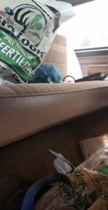

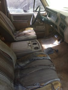

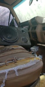

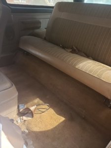

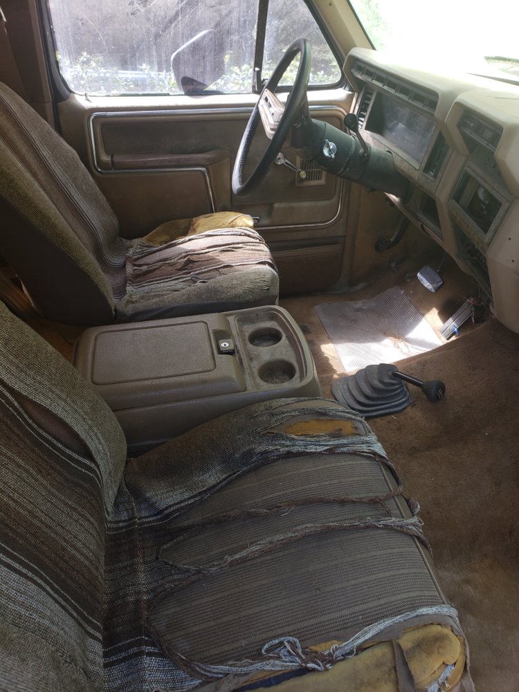

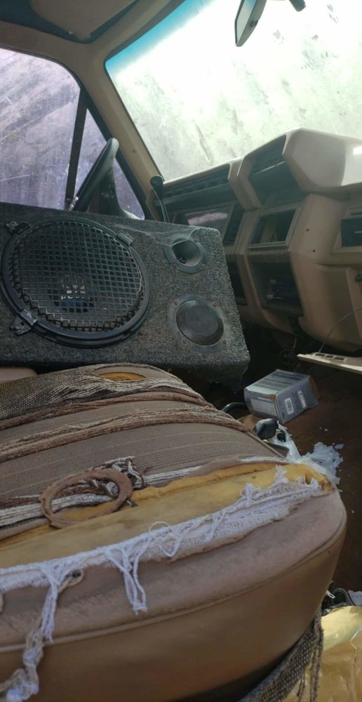

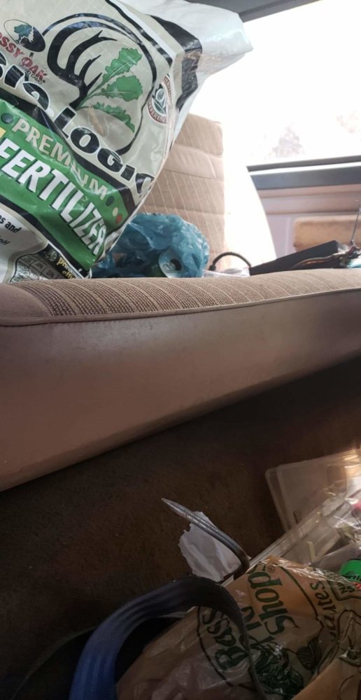

Cleaned the interior up a little today and washed the moss off of half of the truck. The engine turns over freely. Got it to cough a little on starting fluid but with the lift pump in the tank gone, the frame rail pump wasnt pulling much to pull fuel from a gas can. Also found the labels verifying a jasper rebuilt engine albeit however many years old it supposedly has 1k miles on it. Starting to spray on pb blaster on some of the bolts that will be coming off. Leaf springs, bumper, et . Found out the front of the frame (where the bumper mounts) was cut and raised 3 inches to match the body lidt to keep the bumper in line with the body. So that will be a fun process to correct if necessary.20190916_141700.jpg

I may have to get in touch with you. The frame is relatively rust free on this one but I just noticed (didnt think to check this before) that the previous owner raised the bumpers to match the body lift, by cutting the front and rear sections of the frame and raising them 3 inches and welding them back on. Might not have been a big issue if the sas swap kit I was looking to use and springs I was looking to use didnt put the spring perch in the spot that is now raised. I have to start thinking of options now. Whether to fix or find a donor frame.
Does anyone think cutting the raised section off and sleeving the frame with a 2x6 and leaving 6 inches or so sticking out would work? It's such an odd shaped frame and I would really like to avoid having to buy another frame but the 3 options I see myself having are, buy a new frame, try to sleeve this frame or switch to the desolate motorsports sas kit which involves new axles(05+ vs my 04) and a way more expensive kit. Opinions?

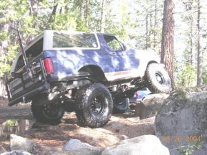

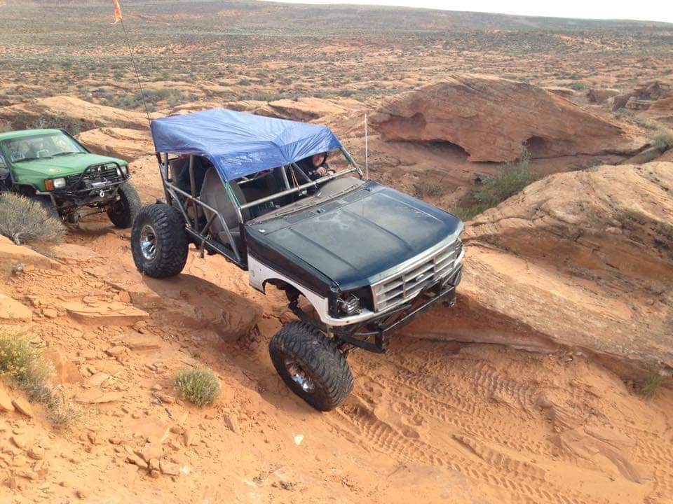

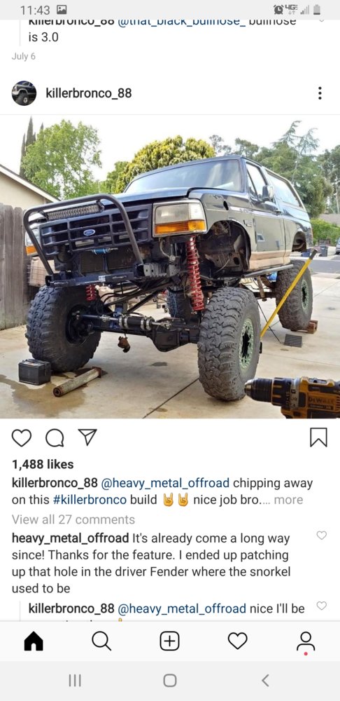

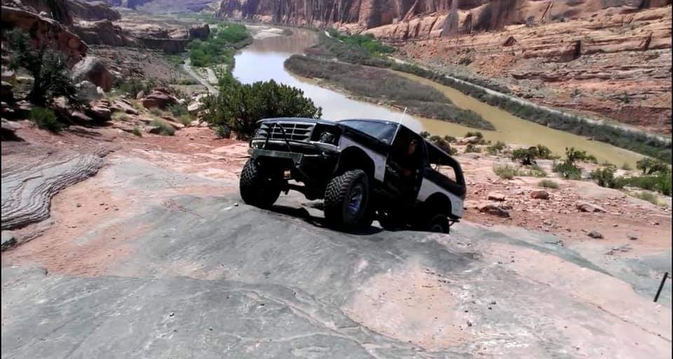

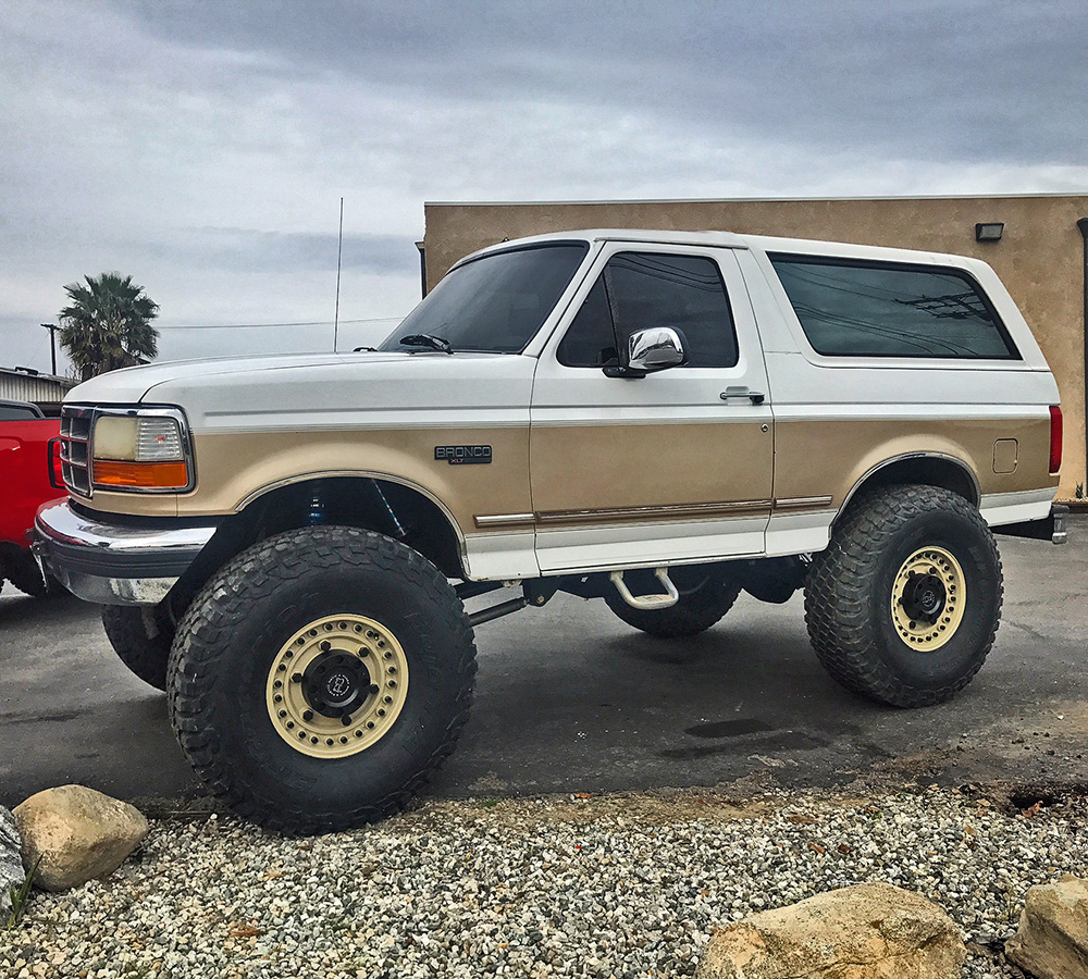

This bronco is running the leaf spring setup I was talking about. Sky offroad kit, excursion springs, 40 inch tires. Granted he wheels his hard and cut the body to lighten it all up and turn it to a full trail rig. Ultimately I think 4-5 inches of lift and 40s with the overfenders will be doable either way. But my biggest concern is just the fear of setting half the weight of the suspension on a 6 inch piece of frame and was reattached. If that makes sense. But if its doable and makes sense to cut the lift, clean it up plate it and burn it back in, I have no problem going that route. I was just worried I was making a mistake in thinking that way.

This bronco is on the desolate kit with 40s, but I haven't seen any real world reviews or installs of the kit. So it may not work well in the situations I want it to, theres no telling. Also. It's really hard to find bullnose examples of broncos, almost all of the ones I find that are wheeled are the 92-96 body style.
