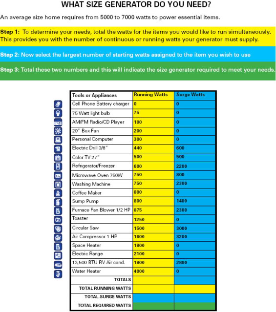

I'm lookin for a new(read quieter) genorater for our camper the 5000 watt one we have now is too loud and just want one that will pull the A/C.We have a Dometic model # 57915441 that as near as I can tell is a 13500 BTU unit.So who can tell me what size gen I need to buy.I know bigger is usually better but I cant afford a Honda that is as big as the one we have ($4K) and just want one that will lets us sleep while its running.I dont know the amperage or voltage of the a/c unit.I barely found the BTU size.
Buy 2 1000 watt hondas and parrell them u can get them at northern on sale from time to time for $899 ea and the kit is $50.....
Two 1k Hondas is going to be pushing it. That'll be all they can run. You'll have to kill the AC if you want to use the microwave or coffee pot, tv, etc.
13,500 BTU unit uses about 15 amps, or 1800 watts.
I'd shoot for a 4k as a minimum. Two 2k Hondas teamed up, maybe. I'm saving up for a new 6500.
I've got the same a/c I just put on my enclosed trailer. They tell you you need to have at least a 20 amp service (120v btw) and a minimum 2500 watt generator. I run mine on a 8k continuous /13.5 starting watt gen and it barely affects it. Kind of loud but I have a hard cover that's open on one end to deaden some of the noise which helps a lot. Not to mention a 30' main feed cord and another 30' extension RV cord to get it away from the trailer. I've tried running it on one of the outside outlets at the house and after a little while it'll trip the breaker since it's only a 15 amp breaker. I've seriously thought about taking it to the muffler shop and having them add a silencer in line to quieten down a bit. Don't know if that'll work but I've seen them put on 4 wheelers and they seem to work fine.

or, couldnt you just do a continuous load calculation of the the load youll have on it, and that should tell you what size you would need?

Let me throw this into the mix. When you are running a gen to supply power to a RV AC. you have to realize that the controls and the fans are 12volt, so to run the AC you must also charge the batteries at the same time and this is even more amps the gen has to supply. And even the fridge is on propane, the control's that tells the flame what to do are 12volts also. Water heater is also drawing 12volts even when turned to propane for the controls. Counting for parasitic loss due to wiring and connections, you are pulling more than just the AC. Turn on a few lights and water pump and a fan and the charger to charge the batteries and guess what, gen won't keep up especially on 50 or 60 feet of cord to be more tolerable. I have a digital meter built into mine and it pulls 3-6 amps with nothing on at all. TV's and DVD, VCR, Stereo's and such draws power ALL the time. Even the thermostat draws power. And when you "brown power" the system it's gets expensive eventually! Most campers come with at least 7K gen's, mine is a 10K and it pull's everything fine. When it's under full load it burns .6 gallons a hour which is very cheap. When traveling we run everything (including the roof AC's) and run the dash fan to save fuel.
