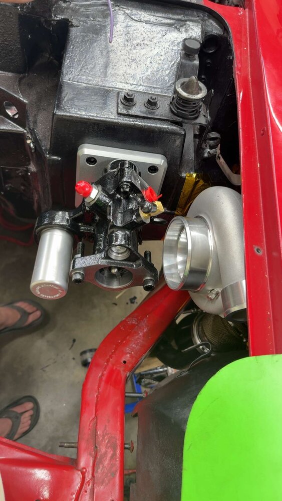

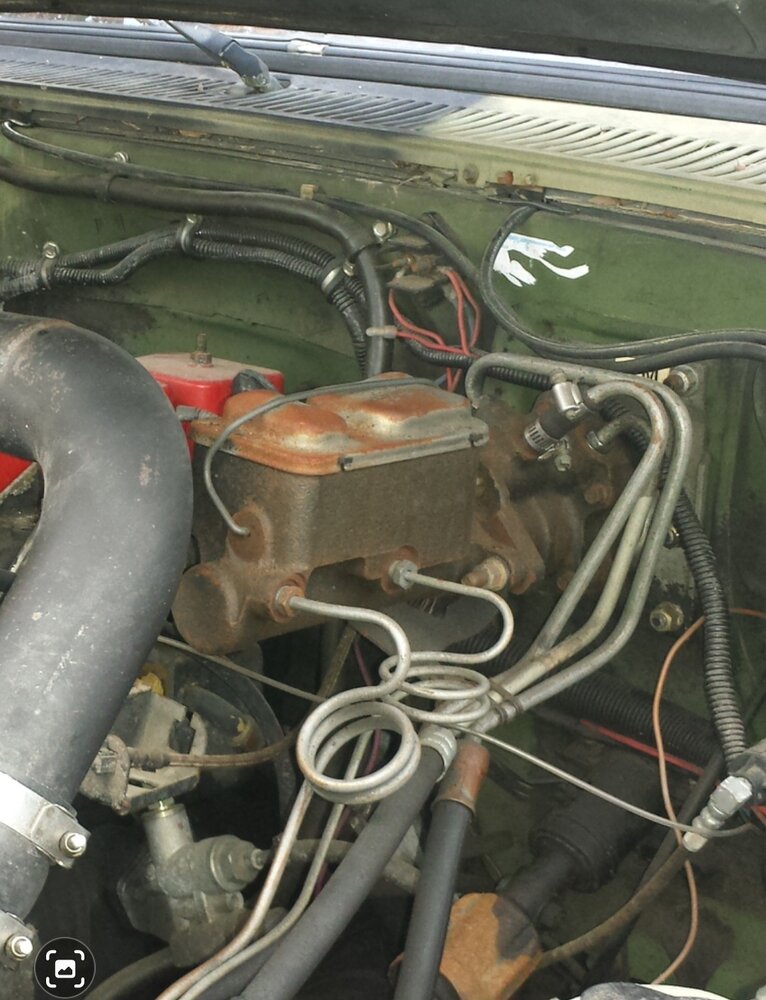

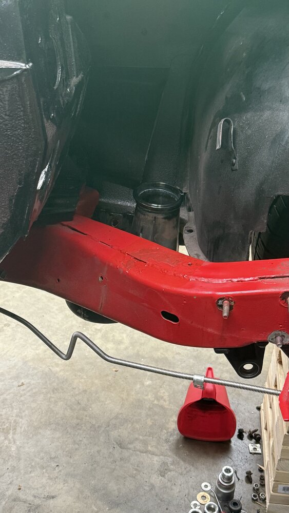

Finished removing the stock fuel lines. Took longer than expected due to the fact some clamp bolts were most definitely installed before the body was installed. So it took some unique finagle skills.

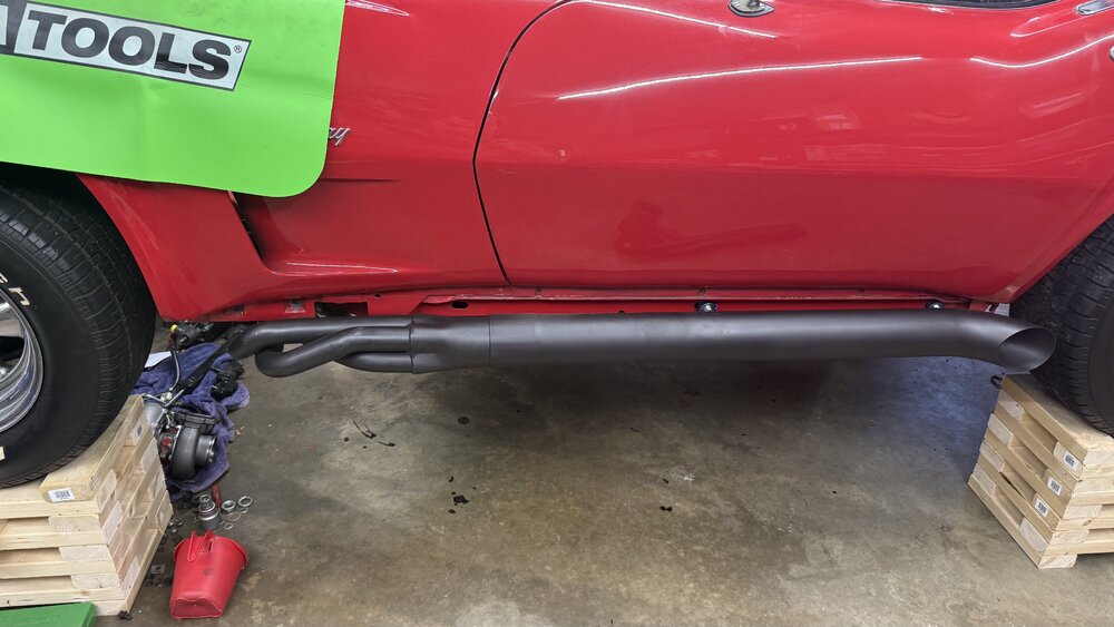

Got the side tubes mocked up. It installs with T bolts which were impossible to use without dropping inside the frame. After the 10th cuss session I tacked them in place.

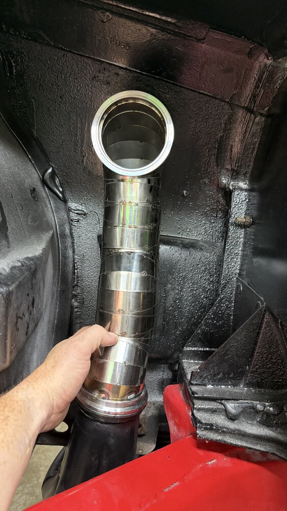

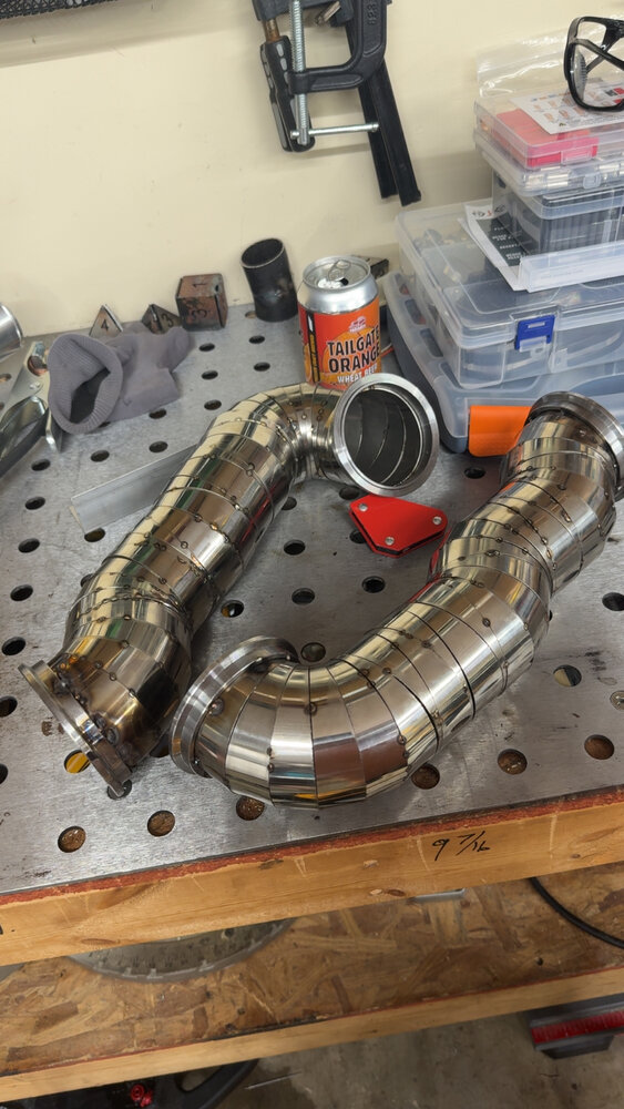

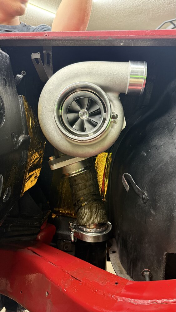

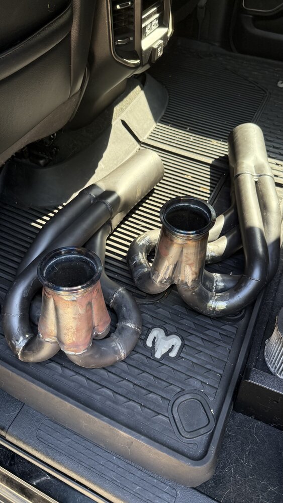

With the side tubes in places I can now cut up the primaries and reconfigure them into a 4in1 collector inside the fender to receive the 3in down pipe from the turbo
What's your plan for flex joints to go to the 1 into 4?
Why not carry the downpipe from the turbo directly out to the pipes and not use the 4 into 1?
Clearance issues, and appearance issues. Taking the 3in straight down and 90 into the 4 in side pipes would certainly be way easier. And its plan B. However doing that will make them the lowest point on the car, even the oil pan. Car sits very low.
The sidepipes have flex joints where mounted to the frame. Im also using a bushing from barnes and some dom to make a vertical turbo brace (assist with downward weight). The exhaust headers to t4 flange will have a downward then upward sweep along the firewall (ish). My plan is to put a flex joint between the header and the turbo flange.

Tomorrow if all goes well I will cut the primary tubes and start trying to make a 4-1 collector in the fender well at the frame rail. I plan to try and use the pipe from each header to make my 90s.

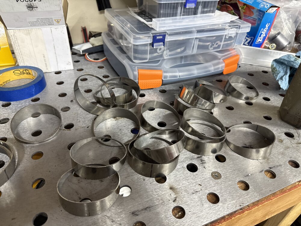

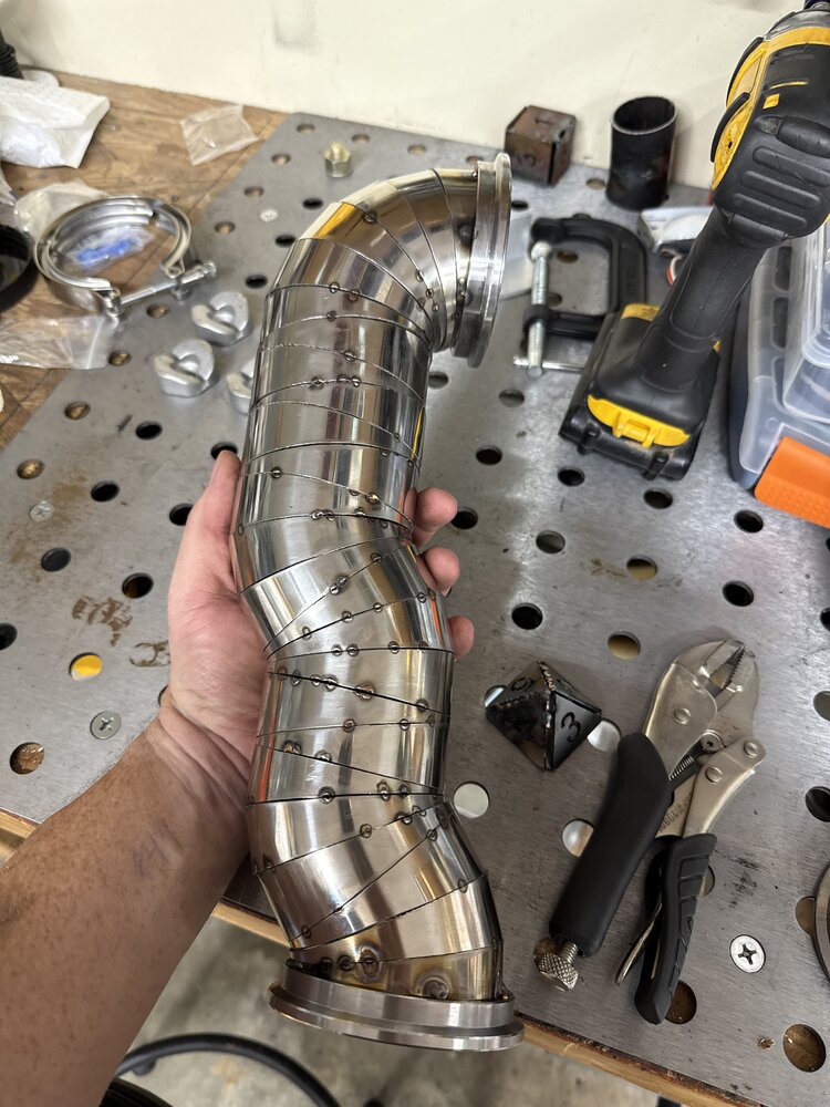

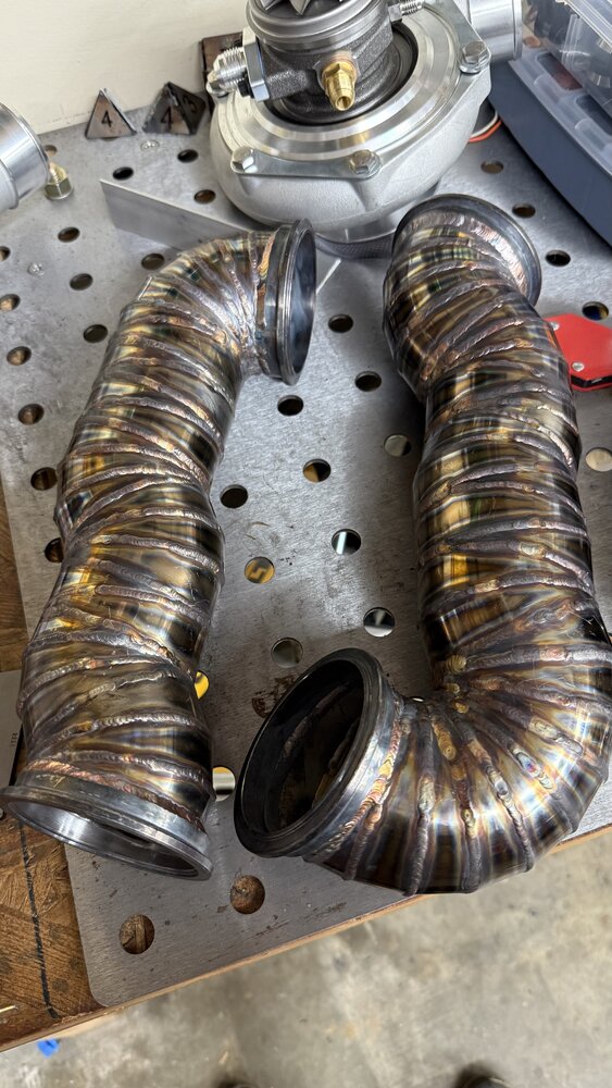

I think I’m going to spend this week refreshing every night before welding up the tubes as I only get one shot. Haha
14g steel. 3/32 lanth. 1/6 filler. 35amp pedal
