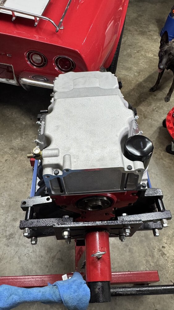

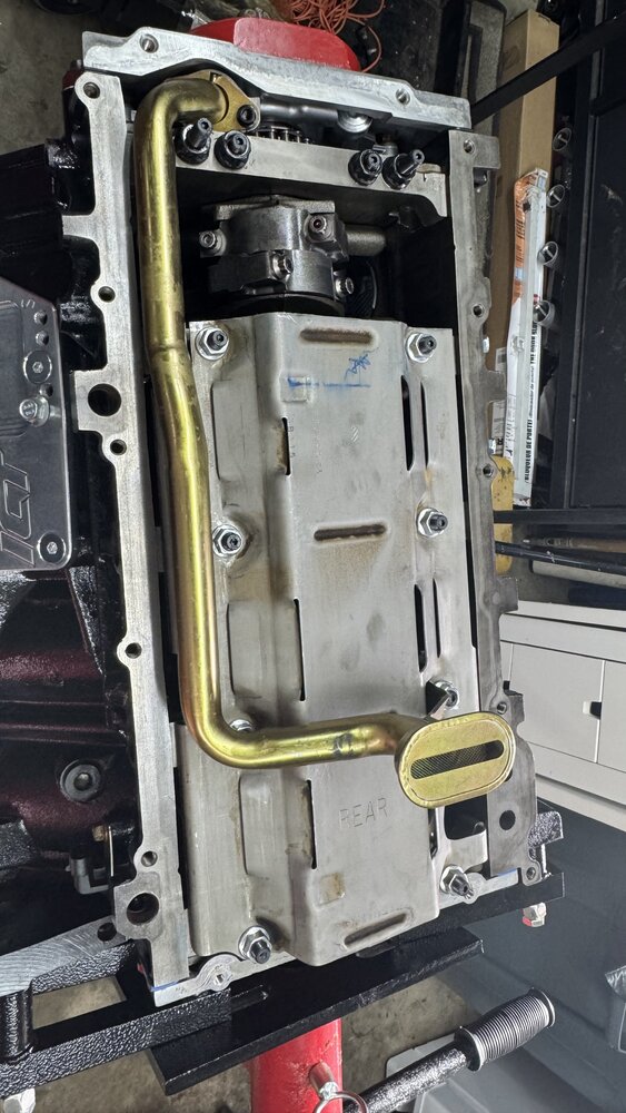

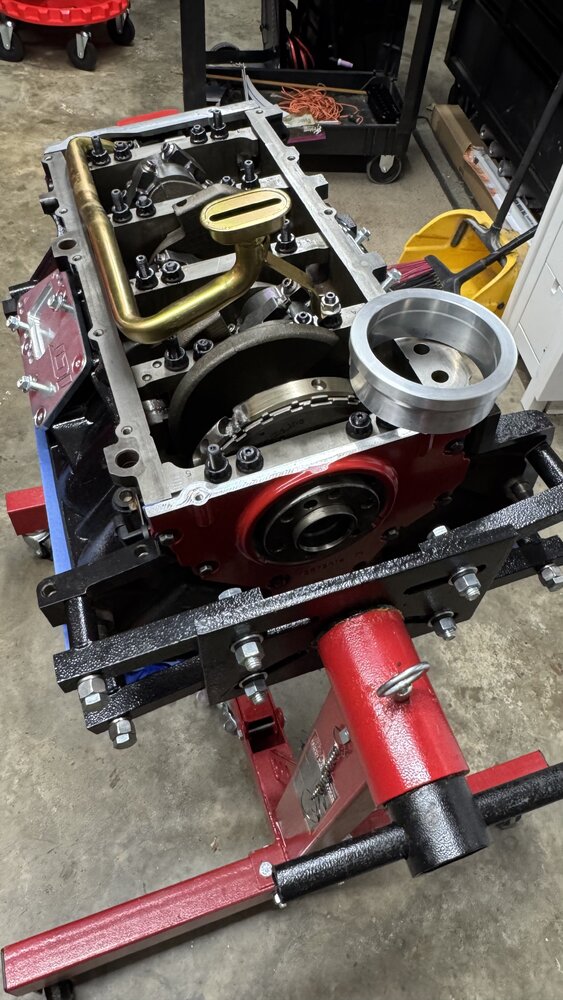

Pan on

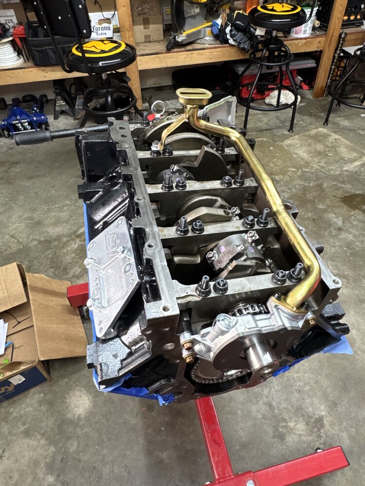

Struggled with pickup tube causing pan alignment issues. Hopefully good enough for bellhousing
Gunna pull the pan and do some clearancing

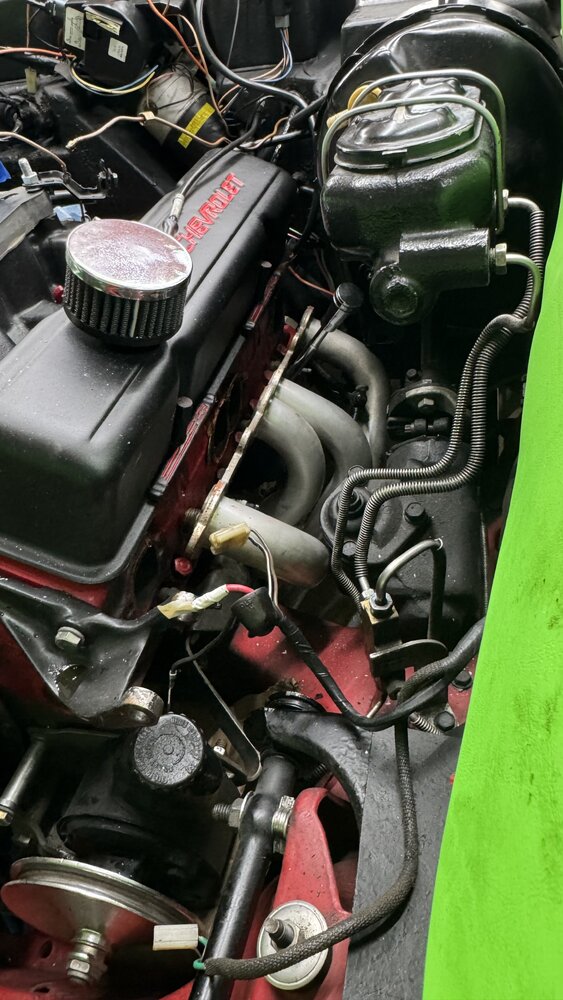

One header and the z bar removed. Lots of little other misc items as well
I gotta say
The header, zbar, power steer lines was a jungle gym. No one of them could be removed without the other being removed.
Had to jiggle my in there -thats what she said
Gunna have to pull oil dipstick tube to get the header out. It does *not* spark Joy

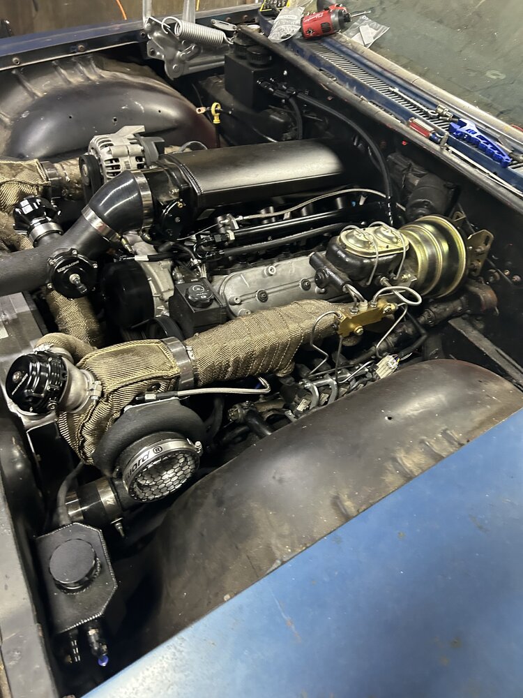

Already started mapping out turbo placement

Sidepipes (modify to receive 3in down pipe from turbos)
>-Going to cut the primaries and reroute them into a collector
Fuel system (radium surge, hellcat pump, walbro feeder, holley boost ref regulator)
Wastegates and Bov

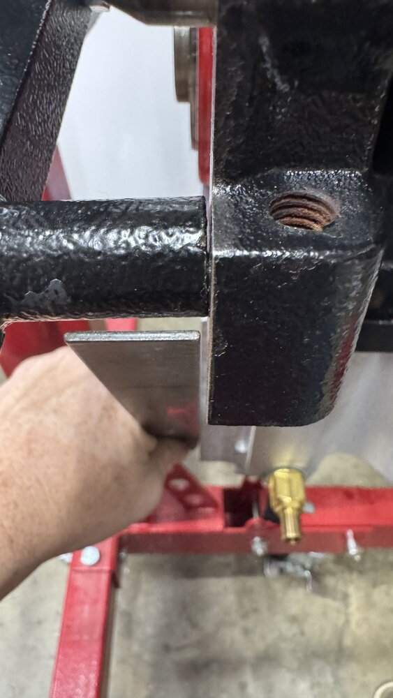

Took longer to get the Amazon cradle bolted to the engine then it did to pull it lmao

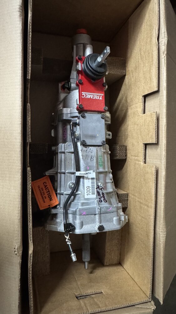

Went ahead and did a reverse lockout delete on the t56 after weighing all pros and cons. I did put a specific spring in it to help it work better with the short shift
