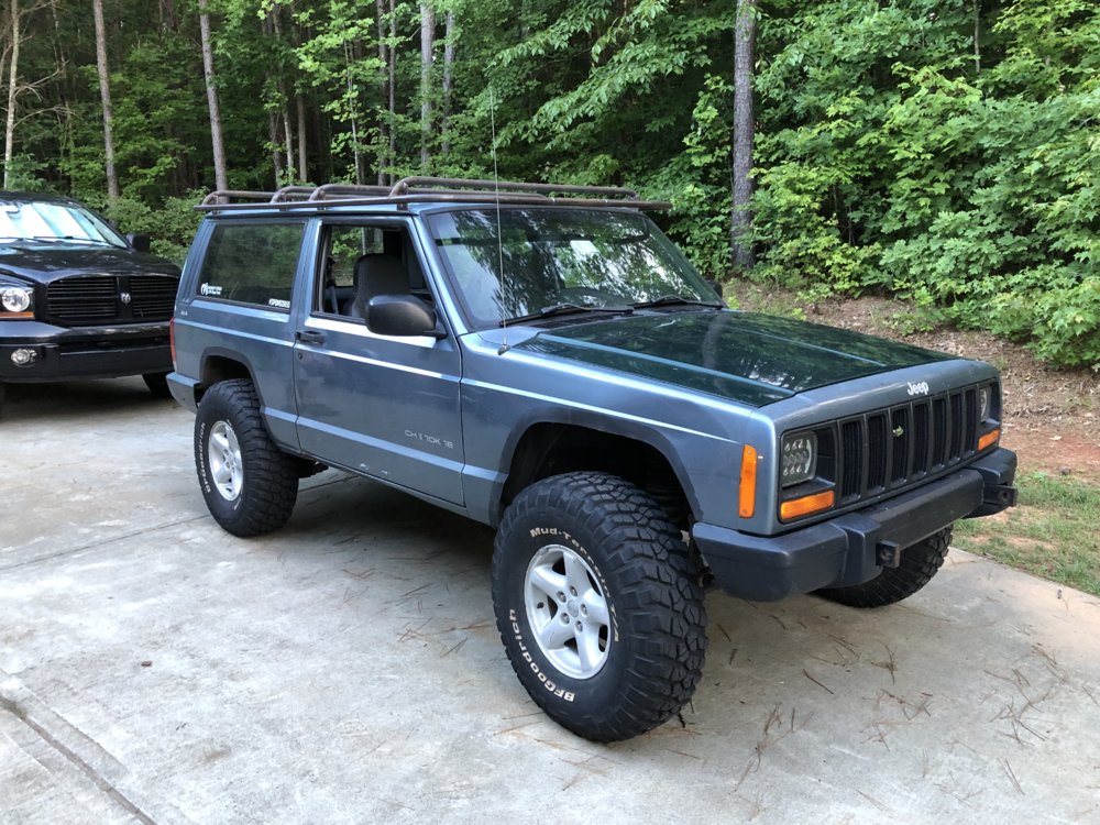

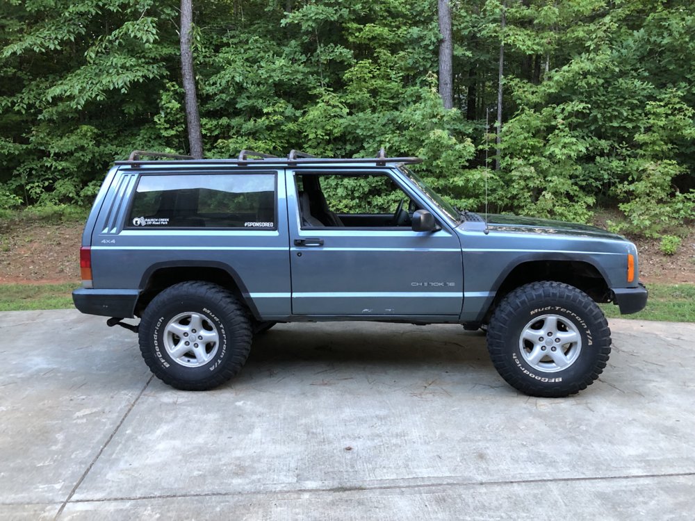

Pearl: The Oddball 2 Door XJ
Looks good.

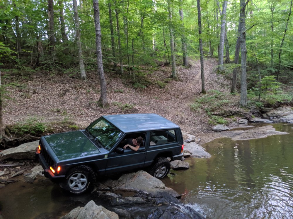

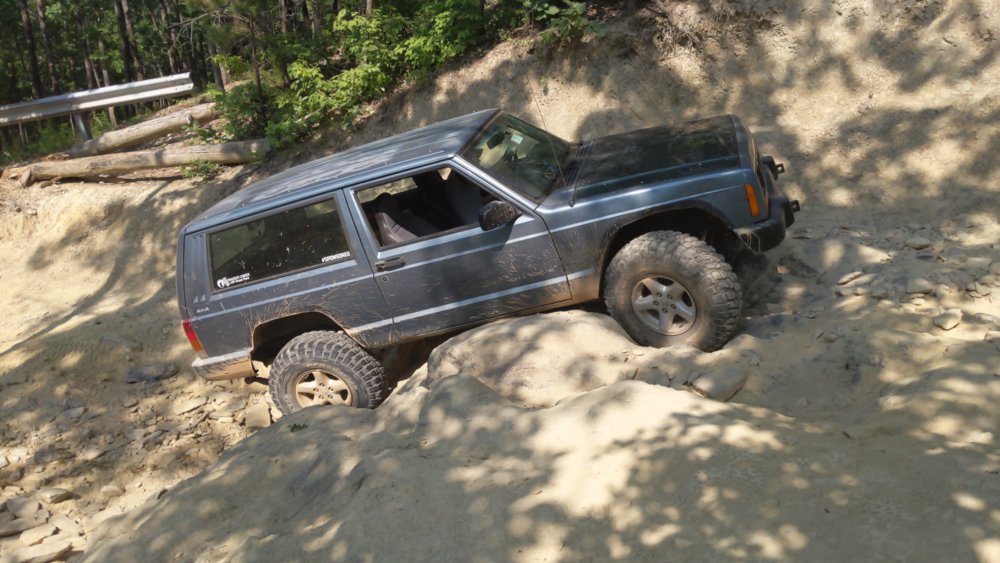

Where were you wheeling?\
Do you have rock guards for the rockers?

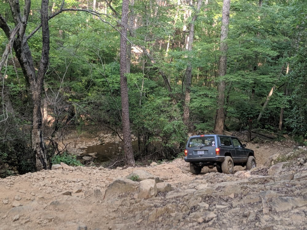

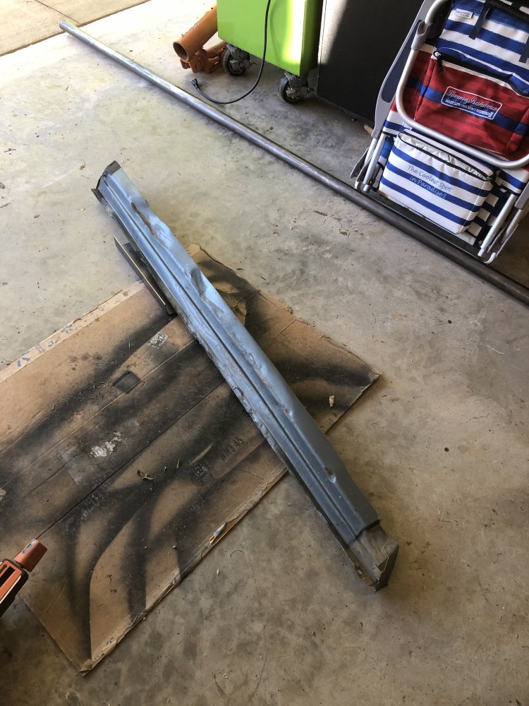

@sammi_davis has a friend with property that we are allowed to wheel on every once in a while. No rocker guards, and it shows :D The driver side has a couple rust pin holes, and I plan to cut them out and make my own mini boat sides or do 2x6 one day.
I still can't believe this Jeep has come this far from the dirty little blown up thing at the shop. Looks awesome man.
I still get surprised looking back at how much work I put into it. Really glad I made the flash decision to buy it from you. This Jeep means so much more to me than I ever thought it would.

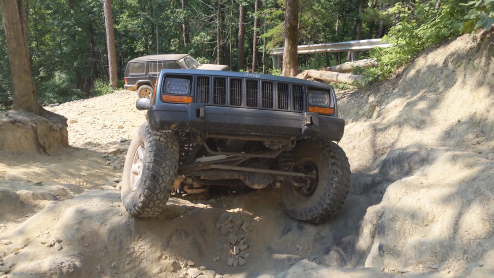

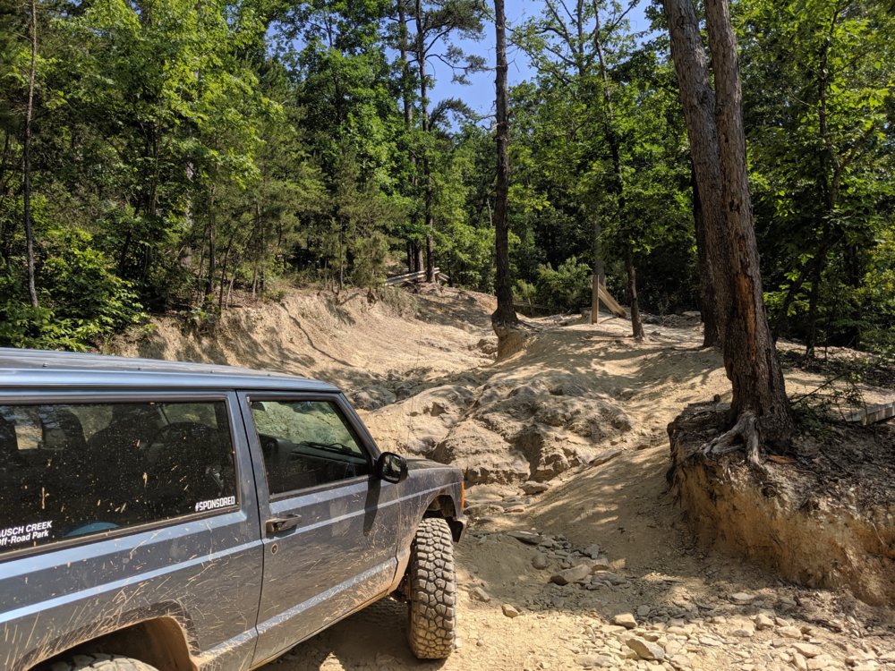

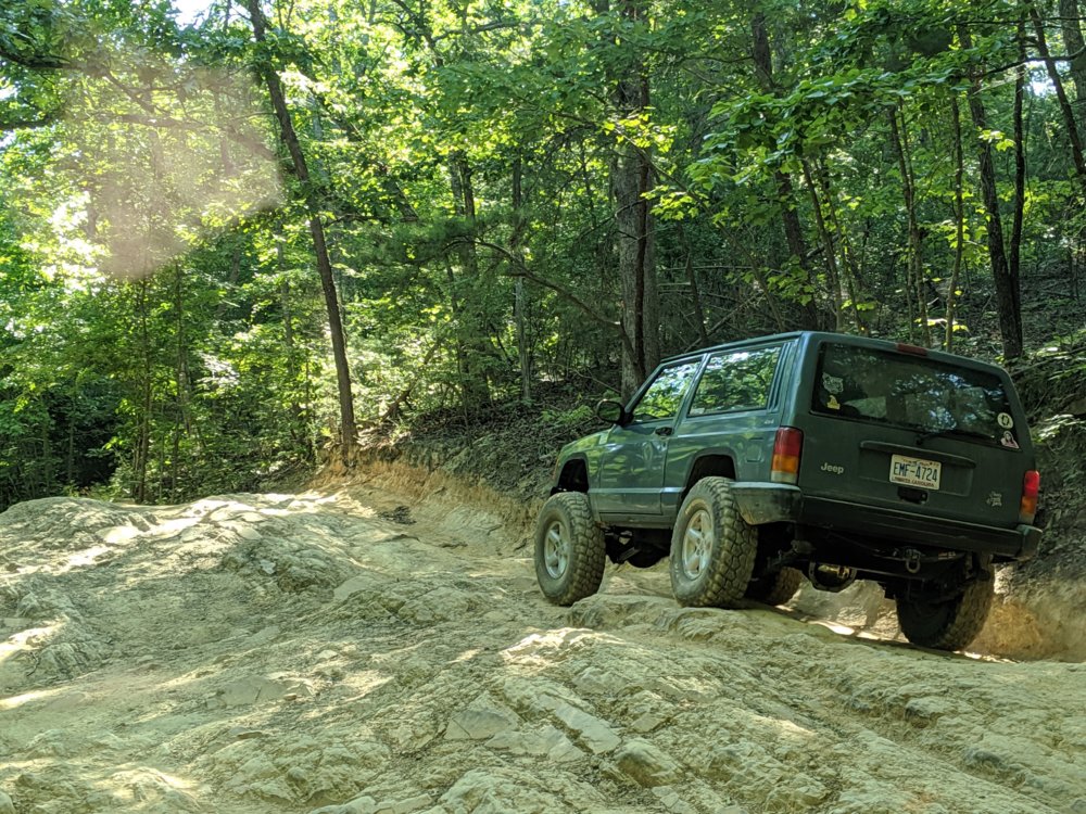

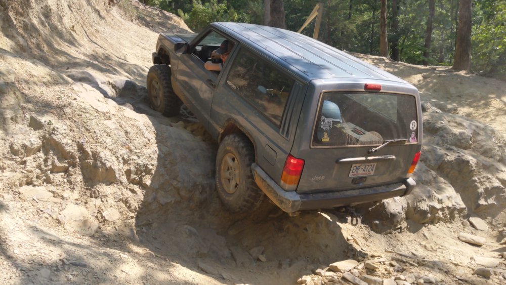

I forgot to post more pictures of our trip from a few weeks ago. I attempted Daniel and almost had it. It would have taken a pretty rowdy bump to get the rear up the ledge so I decided to put my pride away and back down before I broke a shaft. Ended up heading to the outer banks with @sammi_davis a week after uwharrie and drove on the beach for the first time. I’ll be back!

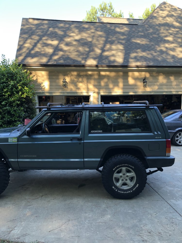

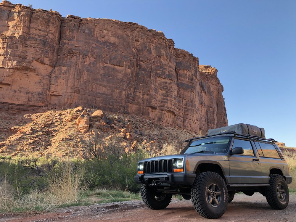

Colorado is a bust. The project got cancelled which is a very rare occurrence. I’m bummed, but now I have time to add more shit to the Jeep! Finished up my rack. I’m not 100% happy with it but I would rather it function and look a little tall than have it look cool and hit the doors. For the stuff I plan to add it needs to sit a hair high. Beefy as hell though. More parts coming tomorrow, pics when they show up.

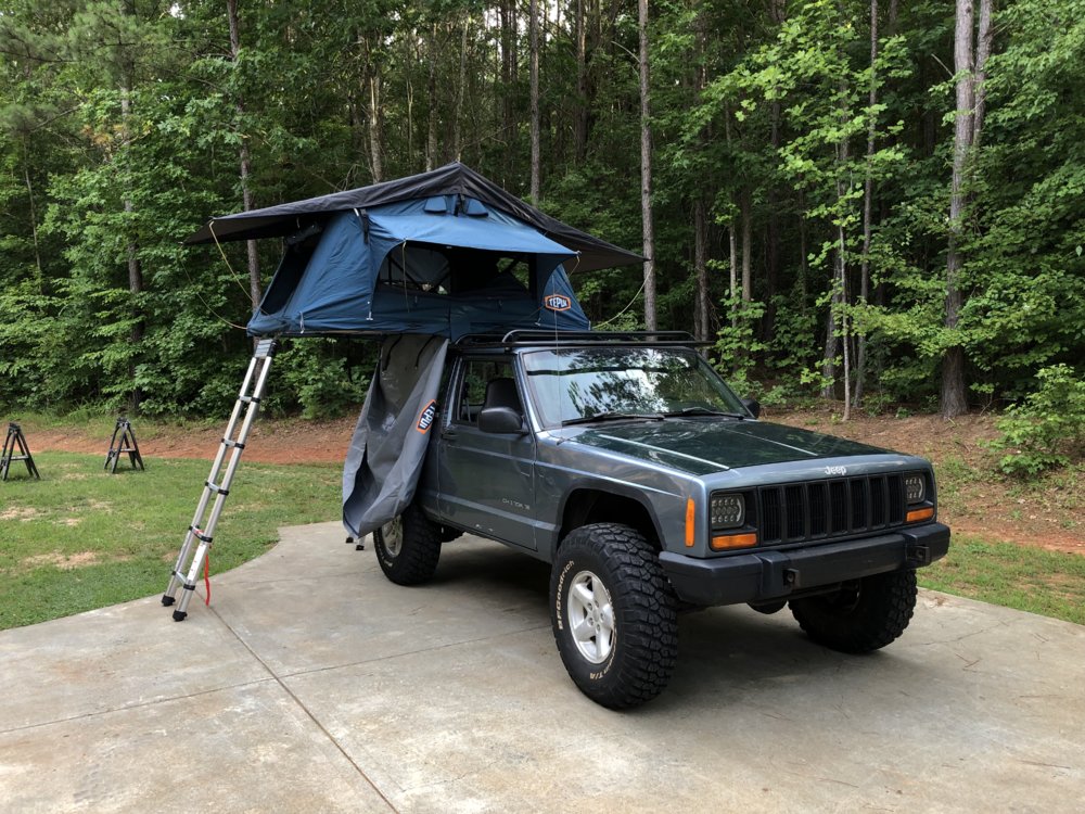

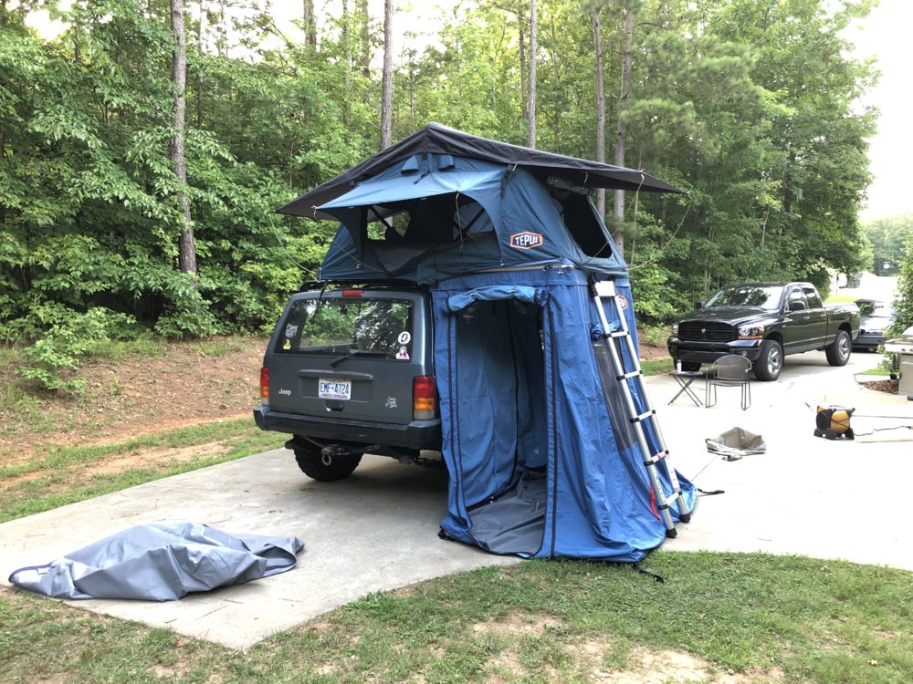

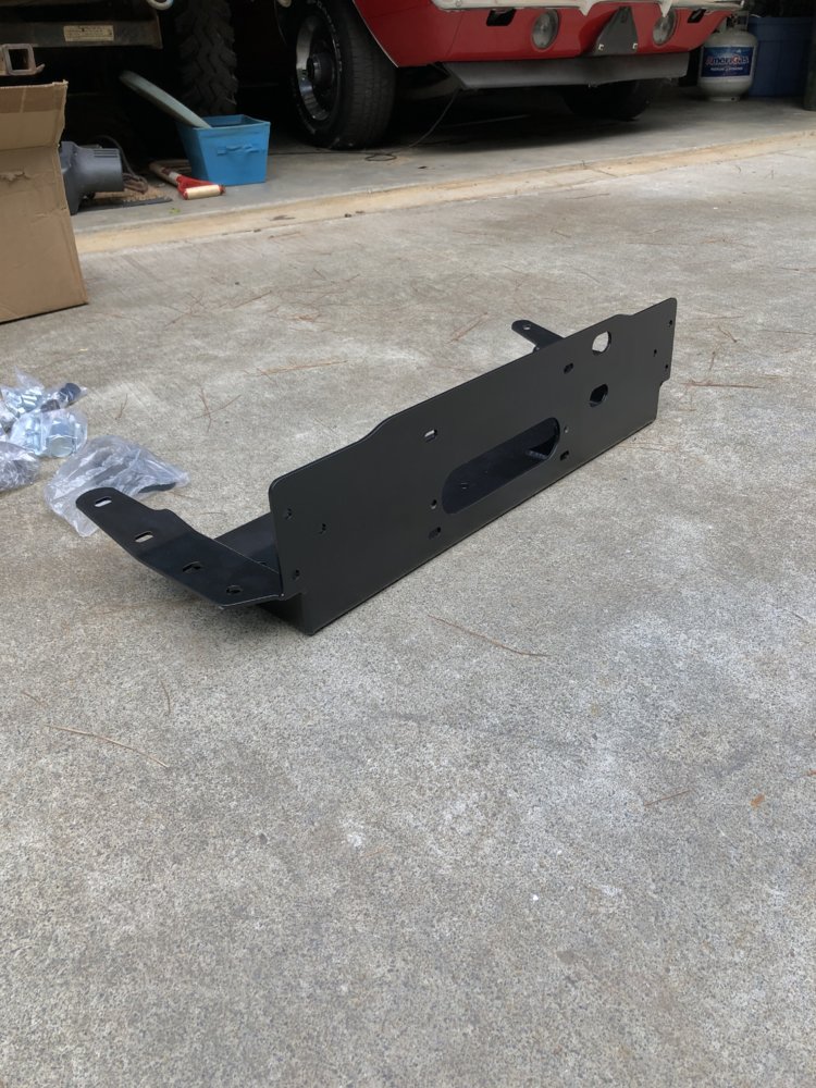

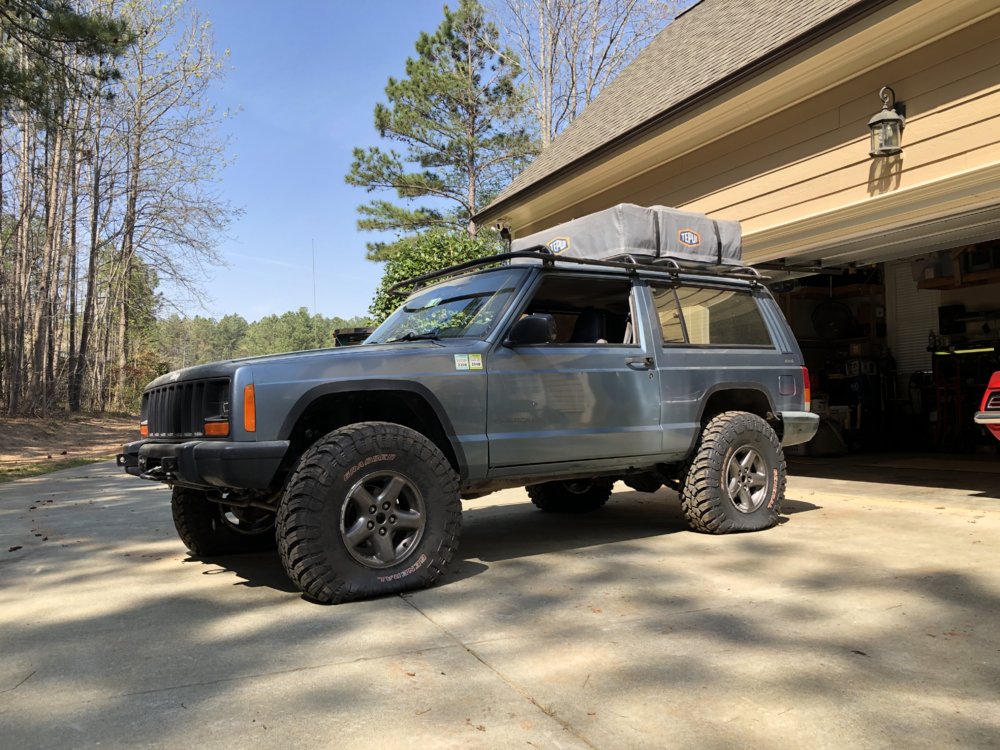

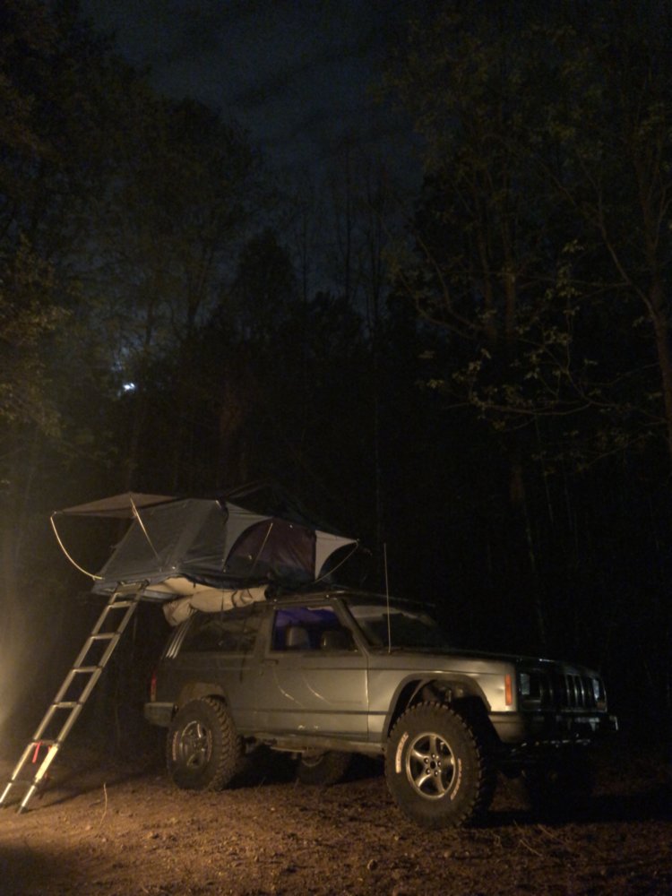

My mall cred just went through the roof. New rooftop tent, and my Boostwerks hidden winch mount showed up today as well. Gonna need some tweaking to get my cheap crappy winch to fit but it will be neato to disguise everything behind my stock bumper.
I bought this stuff in preparation for Colorado and just decided to keep it even though my trip got cancelled. The rack and tent are easily removed for when I feel like doing some more serious wheeling. I should be pretty close to being able to do whatever the hell I want with this Jeep now. I just wanna get out and make some memories.

View attachment 296669 View attachment 296670 View attachment 296671 View attachment 296672
Really want to hear how that winch mount will work. Did it come with tow hooks or d ring mounts?
BWE Comp Mount
No d ring mounts with it. I made my own a while ago that bolt to the side of the rails.
EDIT: I stand corrected, I never opened up the parts bags when I got the kit, it comes with recovery points. I don’t think the holes are large enough to fit a 3/4” d ring but I could be wrong.

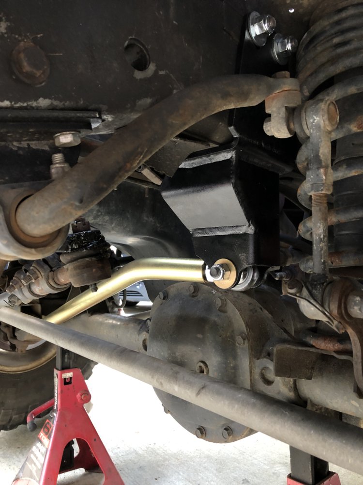

I’ve been driving the shit out of Pearl lately. Just rolled over 376,000. Last week I painted a spare set of eccos and had some 33x10.50 general grabber x3s mounted up. I also installed a metalcloak track bar with an RE double shear mount and a Barnes heim since the MC stock heims suck and don’t last very long. I’m giving the metalcloak rock sport shocks a try this time. I was still running on some used stock lj front shocks and rear stock replacement Sachs shocks. It seems to ride better now. Definitely more compression valving and a little slower rebound which makes it handle much better.

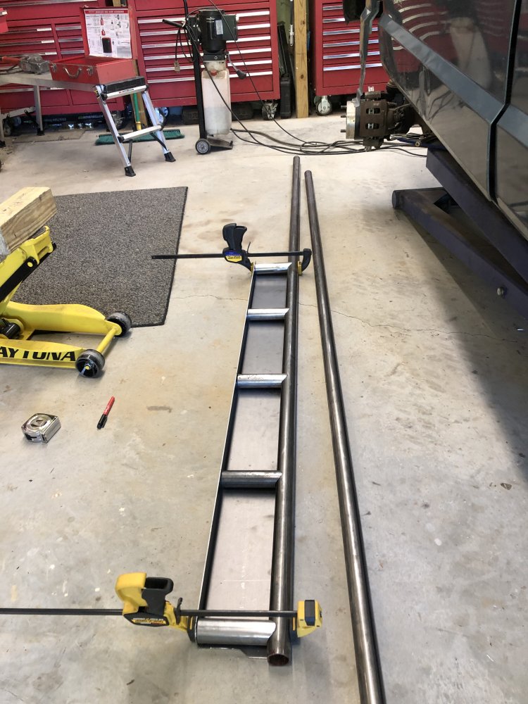

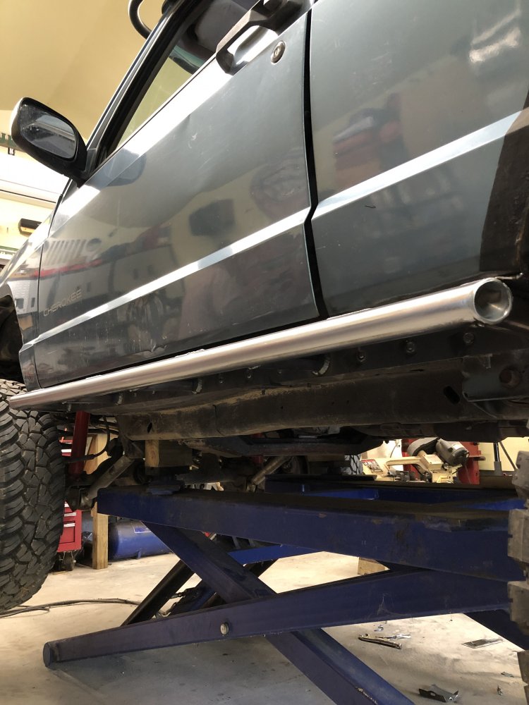

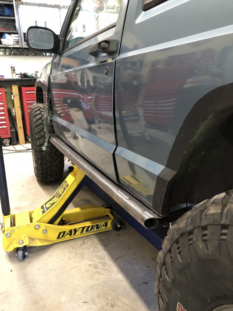

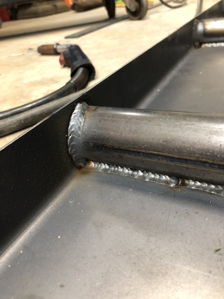

Well I guess it’s high time to post an update. Somehow I got the opportunity to travel to Moab for work for 4-5 weeks. I know, rough life, huh? There was no way I was gonna go to moab and not wheel so of course I took the Jeep. A few days before departure I went to defile @sammi_davis ’s shop and build a set of rockers. Of course nobody had 2x6 so I built my own out of some 1.75 hrew and broken 1/8” plate. Turned out super slick and I think stronger than 2x6 with the ability to plug weld it to the inner rockers. Not to mention a helluva lot lighter than 2x6 .250” wall.

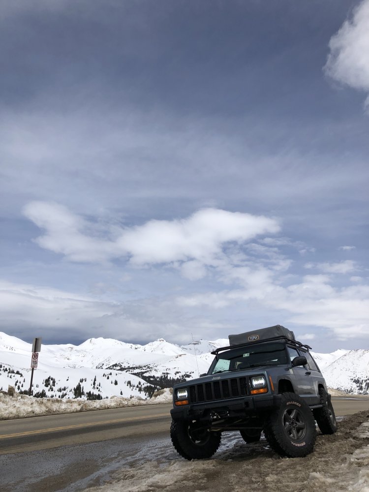

Sunday we woke up, ate breakfast and headed down I-70 out of Denver. Instead of taking the usual route through the Eisenhower tunnel we decided to go up Loveland pass. Completely worth it. After that we got back on the interstate and headed towards Utah. Glenwood Canyon is amazing too, and I’ve fallen in love with Glenwood Springs, CO where we stopped for lunch.

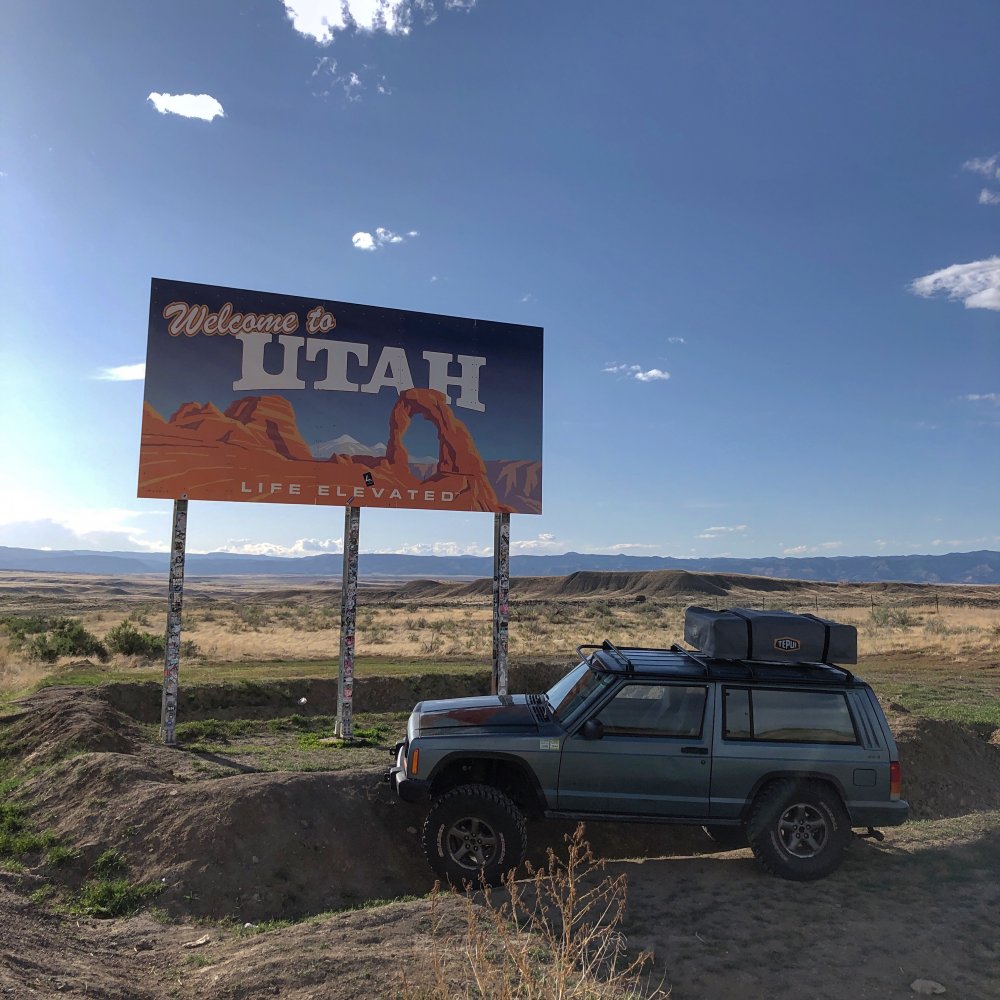

Made it into Utah!!!

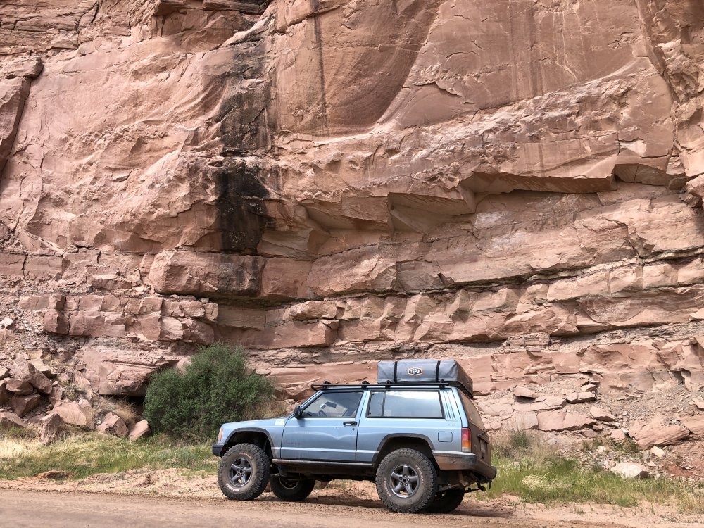

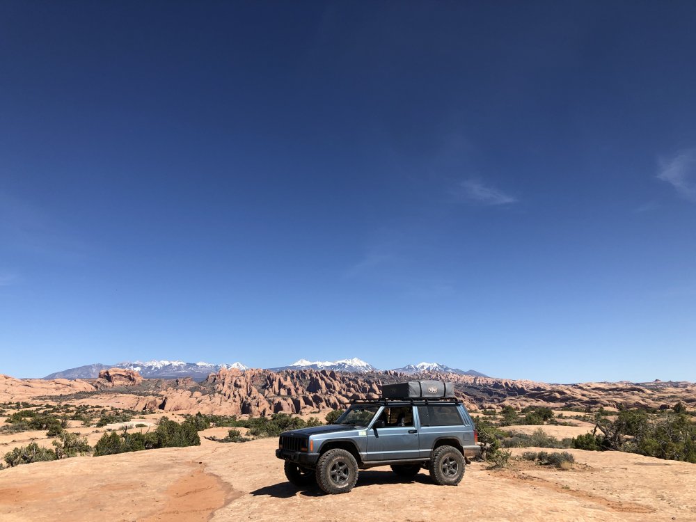

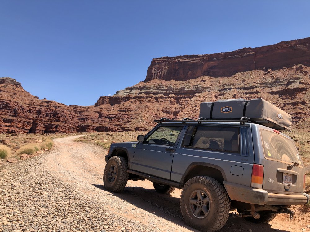

For the first day of wheeling I decided to take it easy and run Chicken Corners to get my feet wet. This was actually a good idea because I found out my front axle needed to be pushed forward a little. The bump stop tower kept hitting the coil after drooping and compressing. We got about 60 miles of trail in before we got back to town to fix the front axle. Definitely time for some mid arms when I get home. Possibly an antirock too. This thing is pretty tippy with the tent on top.

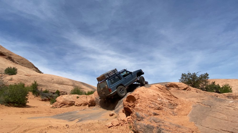

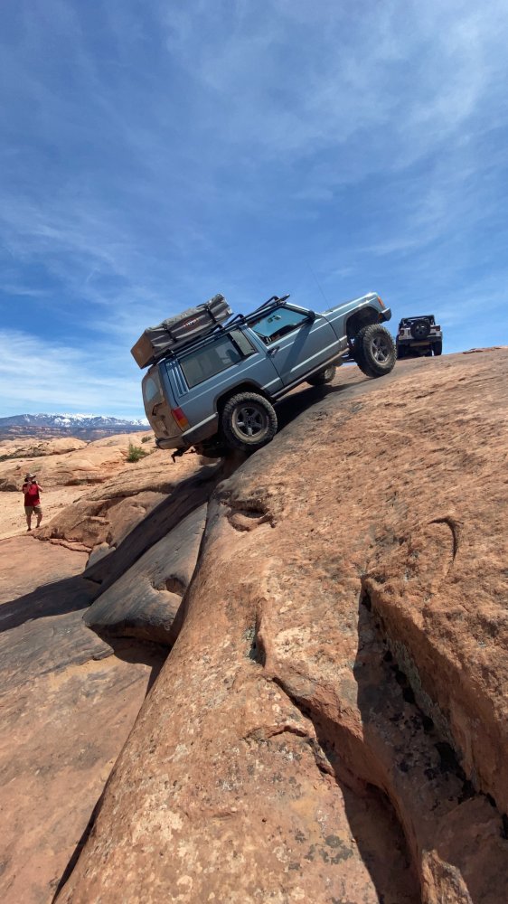

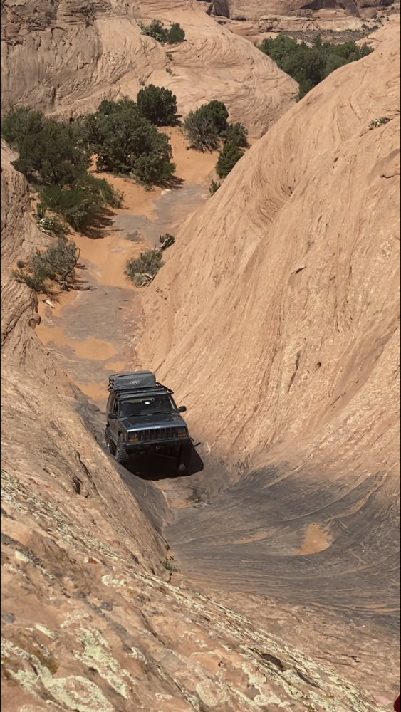

The next day we decided to run Fins and Things but stumbled across a local guiding a couple in a JKUR up Hell’s Revenge so we decided to tag along with them. Between the three vehicles I was the least equipped with open diffs and yet had the least amount of trouble. These tires hook up. I have videos I’ll upload later of Hell’s Gate and a few of the bigger ledges.

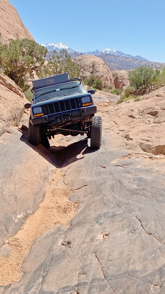

That night I drove pops back to grand junction so he could fly home. Next morning I tagged along with the same group on Poison Spider. Again the Jeep had the least amount of trouble on all the hard stuff than the other two. I don’t know how it works as well as it does. I ducked out about halfway through the trail to go back to the hotel since I had some school projects to finish up before the semester ended.

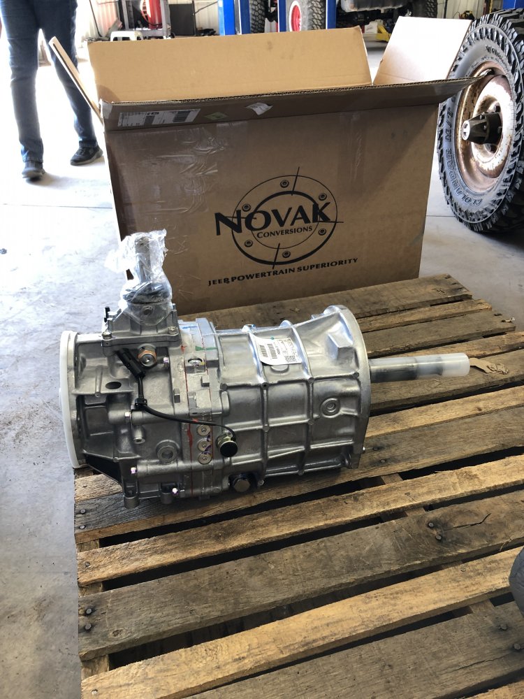

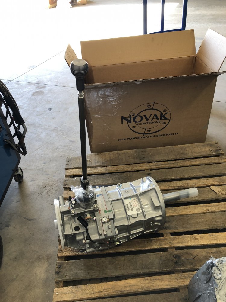

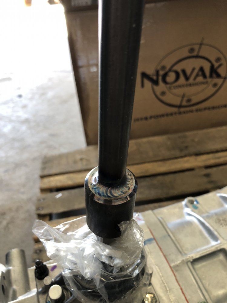

The drive to and from Grand Junction put a hurting on Pearl’s poor unknown mileage ax15 (>200k). I started hearing noises when we ran Poison Spider. I still don’t know exactly what parts are bad, but it sounds like the countershaft bearing is failing and causing things to not mesh tightly. Anyways, in fear of catastrophic failure I ordered a brand new ax15 from Novak since no rebuilder had one in stock. Can’t believe Aisin still makes these things. As much as I would love to swap the trans in the hotel parking lot for the sake of a good story I decided to pay a shop to swap it for me. Luckily Dixie 4wd is right down the road. I had the ax15 shipped there. It showed up a day late (thanks fedex) but they said they would thrash on it tonight to get it done by tomorrow. Awesome folks to deal with so far. The owner and his wife are running the Moab location right now while their son is home helping with his newborn. They seem like genuine Jeep nuts, and I actually trust them to work on my Jeep, which is rare for me after seeing the shit that some shops will do to customer vehicles. Hopefully all goes well. I’ll have a report on that when I get things back. Anyways, here’s some bling:
Novak sends the shifter unbent so the end user can set it up to their preference. It also uses a set screw to hold the shifter on the pivot instead of that stupid ass press fit design they used to have. Pretty cool. This thing shifts super tight. Can’t wait to test it out.
Nice rig! The rock sliders are definitely a good addition.
What’s funny is with all the wheeling I’ve done so far I haven’t even touched the rockers yet. But they help stiffen things up, so I’m not too upset about having them.
