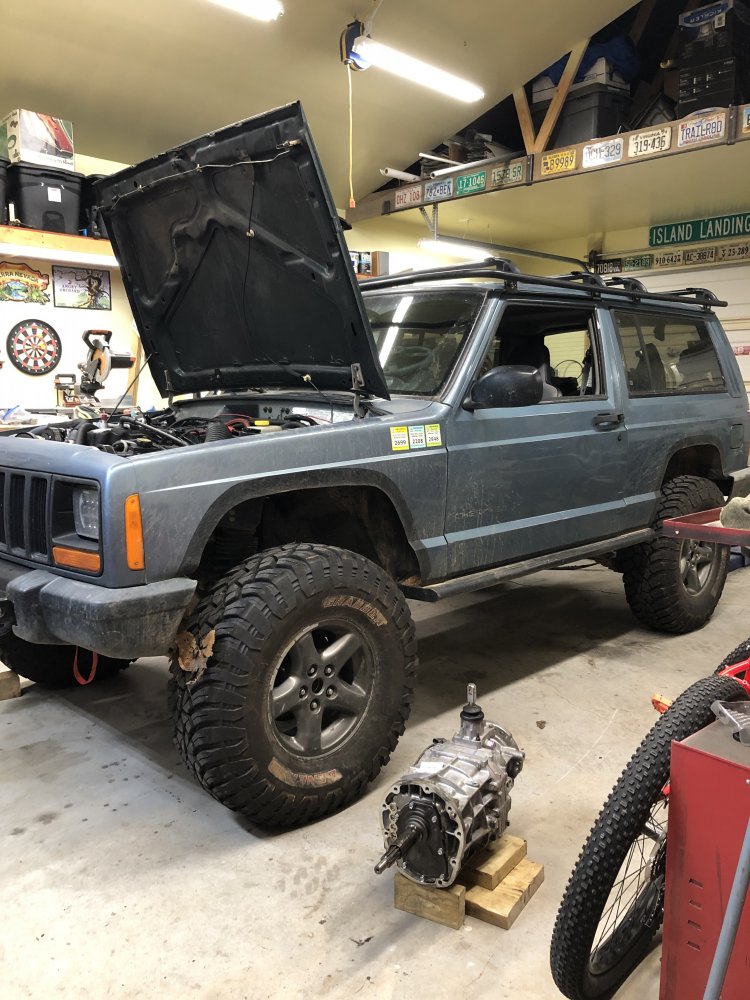

If there’s any good news in this, it would be that I broke my personal record for pulling a trans solo. 1 hour 40 minutes start to finish!
Novak got the trans and after a week of waiting they called to tell me they couldn’t find anything wrong with it. They spun it on their machine and didn’t hear anything, and they couldn’t find anything after tearing it all apart. Of course when they spun it they didn’t apply a load, which is when it made the noise.
After talking with them they reluctantly agreed to send me another transmission if I paid for shipping. I agreed and paid the $120 to fedex it to me and confirmed that they would send it to my bosses house in Eden, NC where I shipped the broken one from. I got a notification from fedex yesterday that said it was going to be delivered and then noticed it was being delivered to Delaware. Somewhere along the way they forgot to send it to North Carolina and used the address they had on file which was my grandfather’s house in Wilmington, DE. So now I have to drive 6 hours one way to Delaware to get my transmission
This is the first time I think I’ve felt guilty over a company taking care of me. I had a broken trans and somehow they made me feel like they did me a favor that they in no way were obligated to do.
At this point, and especially after hearing their transmission guy describe another customer who had the exact same issue as I did with my ax15, I don’t trust these units anymore and I don’t trust Novak to warranty another one since they specifically said they shouldn’t be sending me a replacement. I’m going to throw this replacement on a shelf and keep it for a rainy day and go find a 6 speed to put in the XJ instead. Already have one lined up, just waiting for the guy to get it pulled out for me. I’m also going to grab my old, only slightly broken ax15 from my friend in Utah while I’m on my way out to California. Worst case I’ll rebuild that and throw that in when I get home![]()
