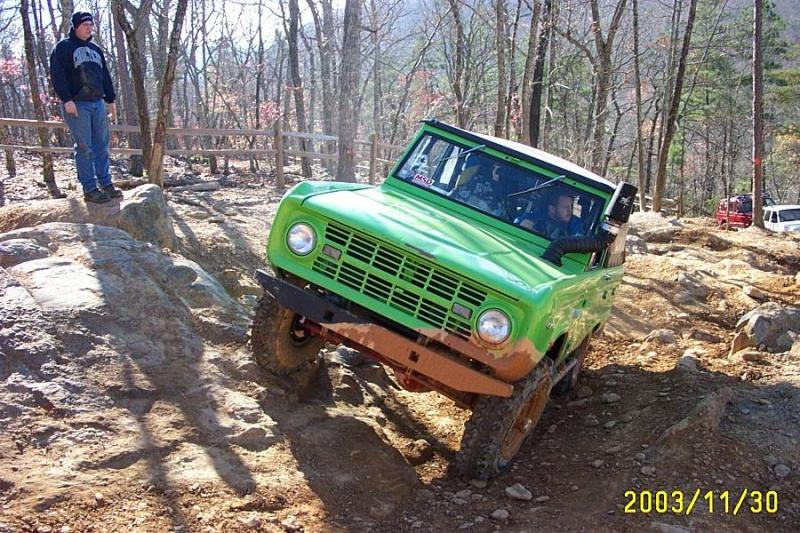

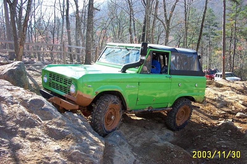

pics of 34x10.5 swampers ltb on a 10" wide wheel
you want them on NO wider than a 8" wheel, 7 would be even better...
Here are some 34x10.5 LTB's on 10" wide turbine wheels. I am going swap out the wheels this spring. The tires are way to stretched to fit these rims.
