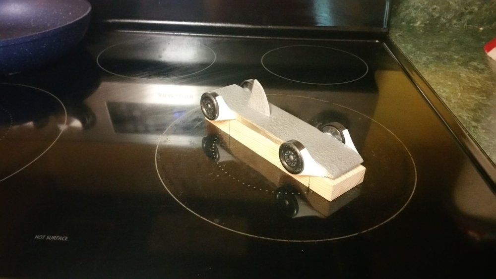

The basics are: thin wedge for aerodynamics. Make it light so you can pack tungsten in the rear...you want all the weight in the rear and low.
Rear axles canted at 3 degrees negative camber and perfectly aligned with each other.
Raise one front wheel so it doesn't touch if your rules allow.
Slightly bend the other one and give it some toe so it turns towards the center rail. 4" of turn in 4' is a good starting point.
Polish the axles, remove the burrs. Stock axles suck so buy a set of aftermarkets if you are allowed to.
Same with wheels...get a trued set if you can. Polish the inside of the wheel bores with Novus and a large fluffy pipe cleaner.
Burnish graphite into the bores with the stalk of a properly sized q-tip chucked in a drill....slowly. wal greens q tips usually are good sized. Too big will ruin the bore.
Rub some graphite on the body where the wheels will touch.
Clean the wheel treads. Do NOT put graphite on them. Some folks do and it slows them down. Can make the car wobble.

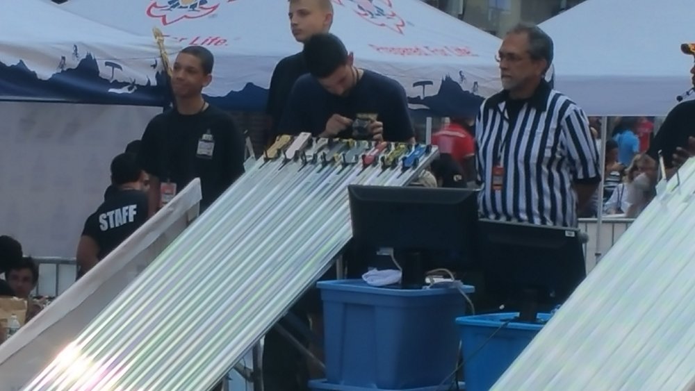

At the championship race in New York, you checked your car in and you did not touch it after that. They staged it for you and did all the racing of it. I did not like the way they handled them. They were very rough with them and they damaged some cars.
Their rules were a little different from our local rules in that you could have a three wheel touching car and they specifically stated you could buy aftermarket axles and have your wheels trued but not lightened.
Locally, they make you have all four wheels touching and they claim you're supposed to use the parts out of the box but not everybody does, I'm sure of that.
When we build a 4-wheel touching car, we build it the same way with one axle steering it and make the other front wheel just barely touch so it is not bearing any weight but it will roll if they check it. And we do Lube up the tread on that wheel so that if it does touch it slides.

Make sure the short end of the car where you have the least amount of space behind the axle is the back and the longest side is the front. That will give the wobbles also, if you build it backwards.
Burnishing graphite into the wheel board is probably the biggest gain of all of those steps. It makes a huge difference.
Clip both ends off a Q-tip. Chuck it up in your drill. Make sure the end isn't pointy where you clipped off the cotton part.
Might want to take a junk wheel and make sure it will fit into the bore...tightly but not so tight it tears it up inside.
Once you have the correct size, put some graphite in a paper towel. Hold the paper towel up to the Q-tip stem squeeze it and spin the drill. That will impregnate the stem with the graphite. Then take your wheel what you have previously published the bore on and then cleaned out and is nice and dry and slowly spin that drill and slide it through.....run it back and forth for about five to eight seconds it might even squeak a little bit. Do not spin it fast.
Will make a big difference and will also maintain the car's speed for more runs.
