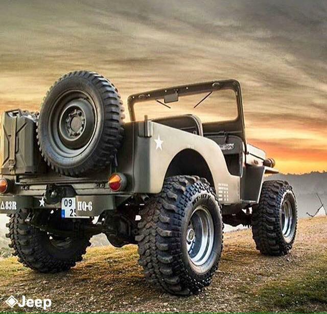

Interested in this as well. I am really wanting to do some pizza cutters on the Willys for the look/cool factor as long as it doesn't have to big of an impact on performance.

The only pro I have found with tall and skinny tires is the fact they clear stuff (frame, control arms, etc.) The major con I found was they are not stable at all when aired down. Not really a big fan of felling like my rig just wants to lay over and nap on minor off camber situations.

I use 7.50x16s old schools and do just fine. Don't waste time with the military style ndt's for performance. They suck off road.
