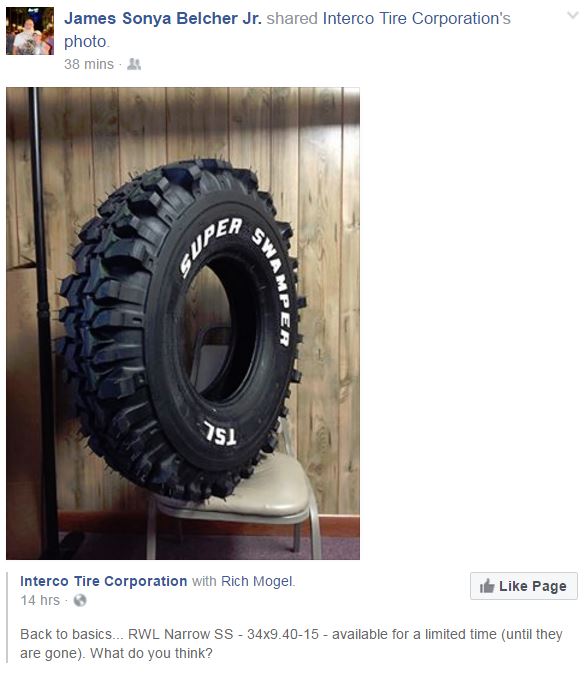

Here you go @YJJPWrangler
I've had a couple of buddies run those 34-9.5s and they could not keep the beads on the wheels at any kind of low pressure. They tried all kinds of wheels and nothing helped, something about the construction.

Were any of those wheels beadlocks?
Unless you have stauns, a beadlock is just going to make it worse.

I don't follow, how would a beadlock wheel make losing a bead that much worse? Are you talking about an inner bead?

Yes, you've got a tire that's only six or seven inches wide, and you're mounting it on a beadlock that's nine inches wide. It'll just pull the inner bead off.

8 inch max, run minimum 20 psi

Most beadlocks start at 8 and go up. The home made route lands 8 inch wheels well over this width.

And these are extremely stiff and were intended as a dual rear wheel application. They don't flex well even when flat. The side wall is taller than its width. I ran them for awhile and usually when one bead let go so did the other in short order. They look beastly and damn good on the right type of vehicles. But over all fail at a low pressure wheeling tire.
