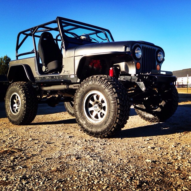

I have recently just powder coated my whole jeep cj7.
Looks great

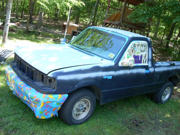

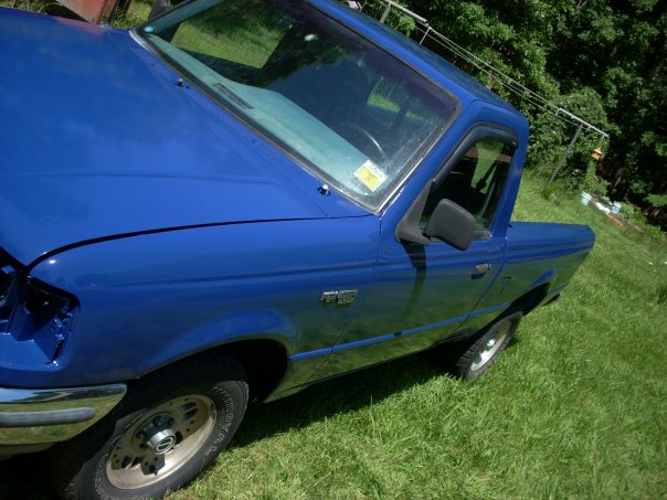

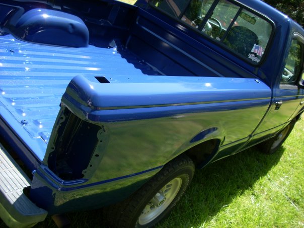

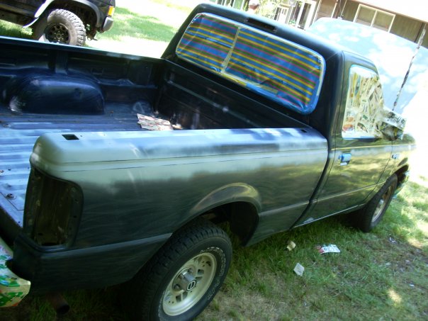

You can get tractor/implement paint at Tractor Supply cheaper than automotive paint, but its cheaper for a reason (doesn't look as good). Make sure you use hardener if you go that route and clear coat it if you don't want it to fade. I painted my old ranger for about $80, but I didn't opt for the clear coat and it faded after a few months (didn't bother me).
