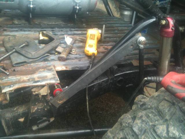

The one I made for the back of my old X Cab.
Toyota Torsion bar that I cut and sleeved to widen it a bit
Advance auto sway bar bushings
2" x 1/2" Cold rolled flat plate arms
Dirt track links and heims
Probably had $100 in the whole thing by the time it was all said and done. Worked pretty well for the short time it was done before I sold the rig.

How long did you make the arms?

Can't remember off the top of my head. I think the measurement is toward the end of my old build on NCTTORA under the "Boone Builds" thread. Could have been the measurement of the width of the bar...its been a few years.

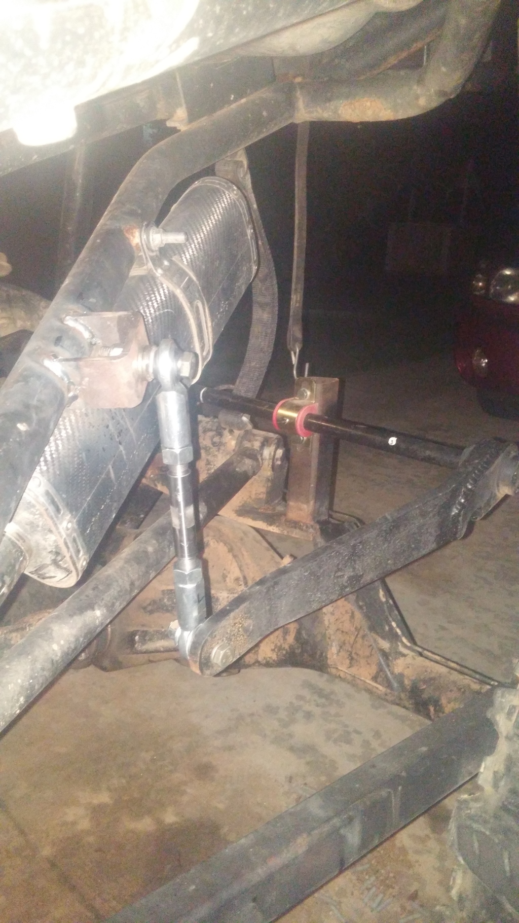

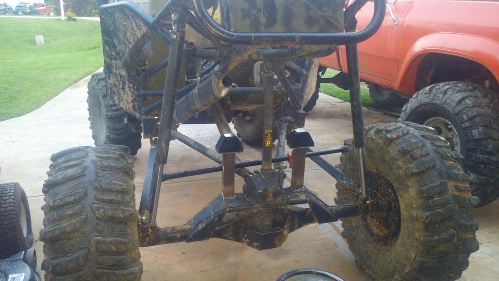

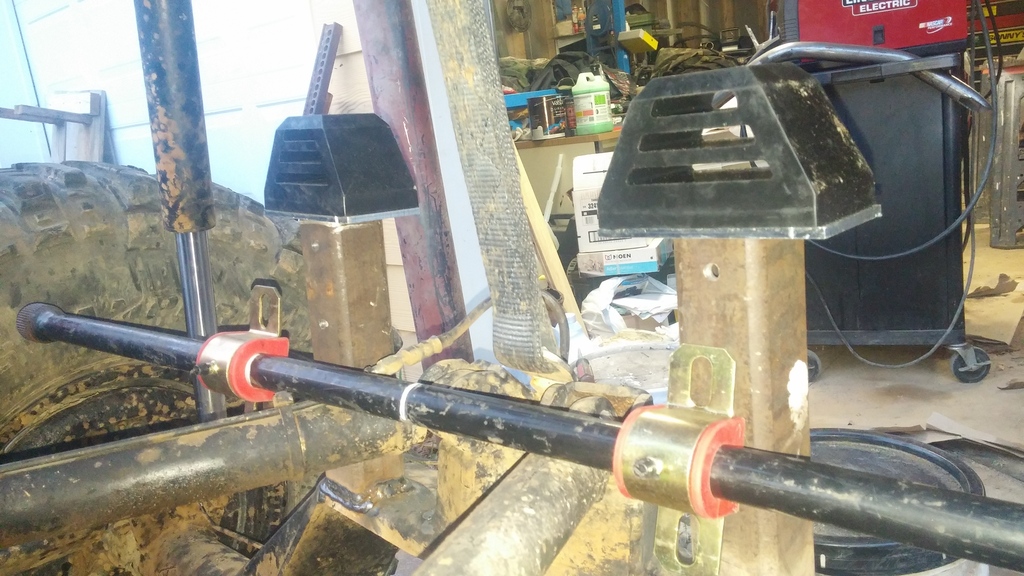

Got to work on my sway bar. Mounting it on my axle cause I have no room on my chassis. What cha think. Going to make bump stop pads at the top to kill 2 birds with one stone. Ugly but functional

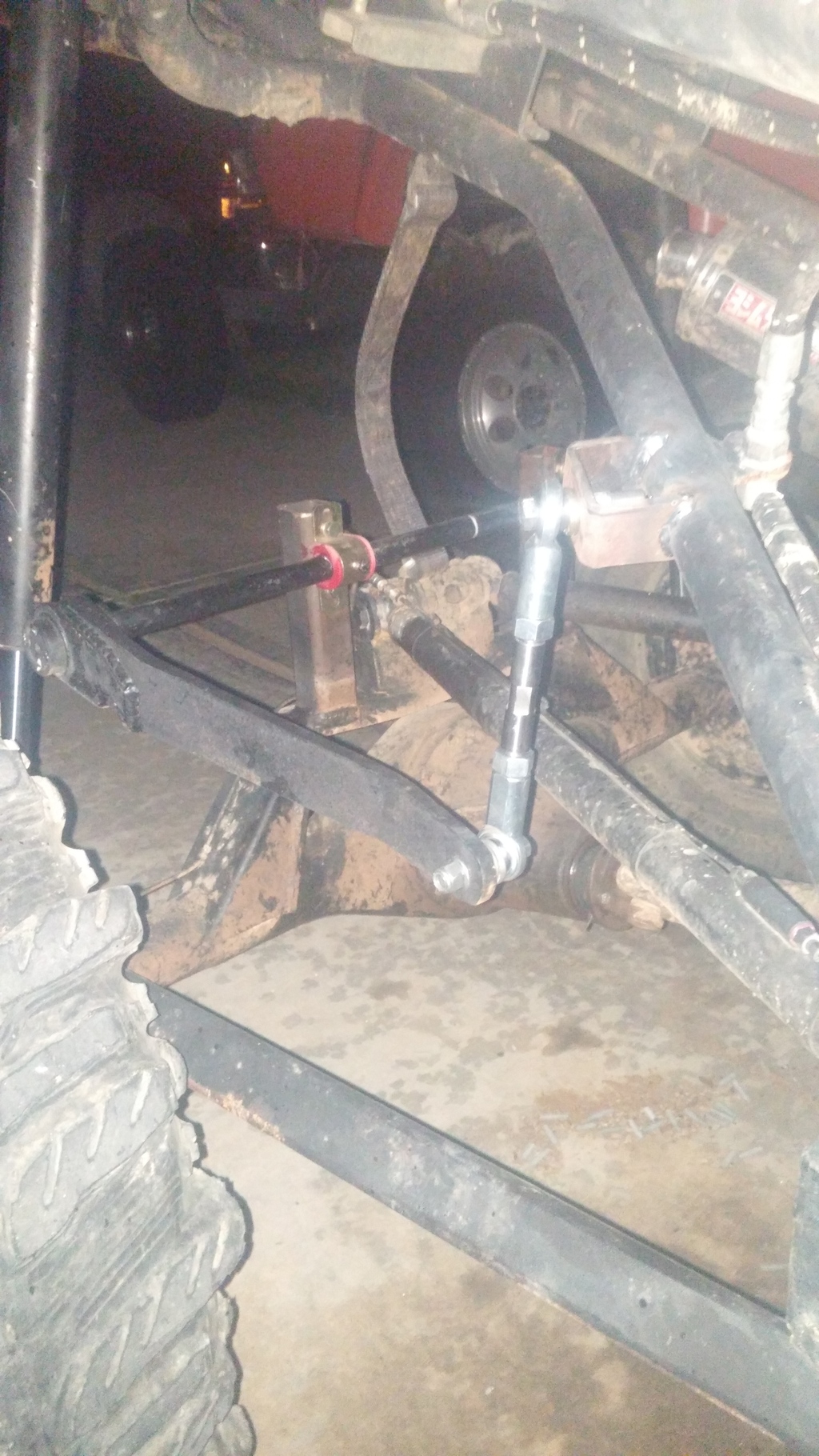

Making my arms with 16.5" from eye to eye and 15". So I can see which is going to work better. 1/2" plate and going to bend them inside to miss my lower links. Shouldn't have any problems. My issue is going to be making the brackets to the chassis. Not wanting something huge. So I'm going to go tractor supply and see if they have small heims to use.
Well I don't have the room...cause of the limited amount of rear chassis. So I thought to make it a lil shorter and mount the sway bar on the rear end and mount the links on the chassis and it'll serve its purpose, ...any experts out there?
Yea, I have been doing some sway bar research myself. I see where you are going with it. It just seams to me the other way would be easier. I am by no means an expert.

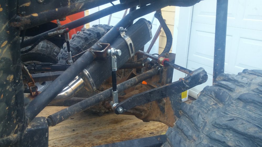

Not with my rear tubing, no space around the area that it would need to go to be at the axle, so I flipped it and put the sway bar on the axle and mounted the sway bar on the axle and connect the turnbuckel on the chassis.

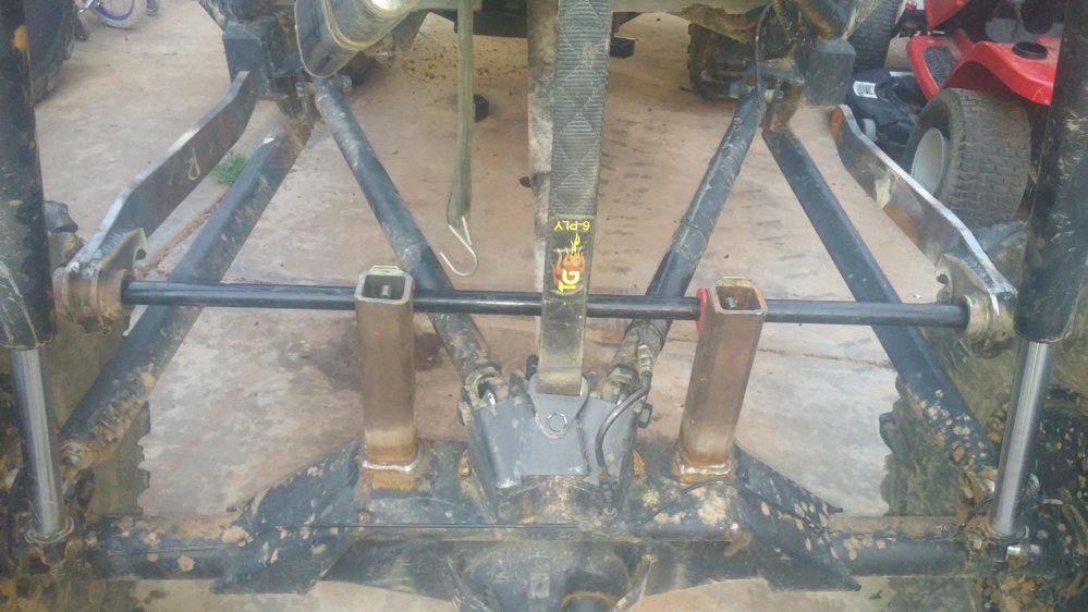

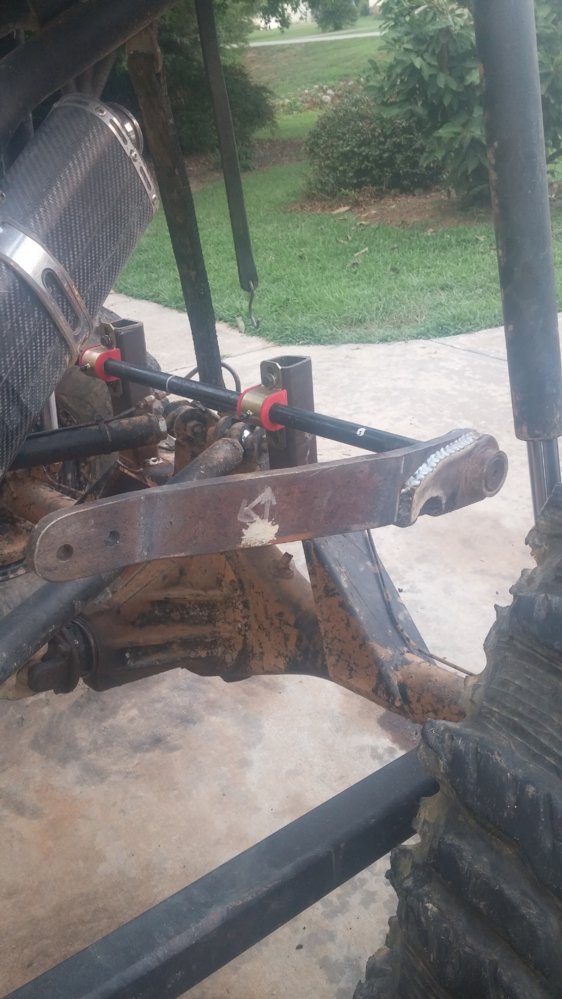

Got my sway bar Finished. Amazing how it limits sway but allows the suspension to flex. And my front leads actually work now, it'll change after I link the front but for now it is perfect. Super happy...and icing on the top is I have about $55 in it and some time.
