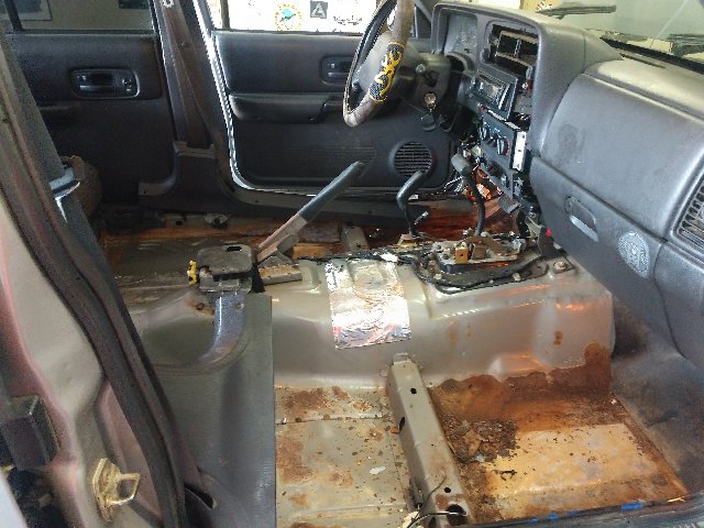

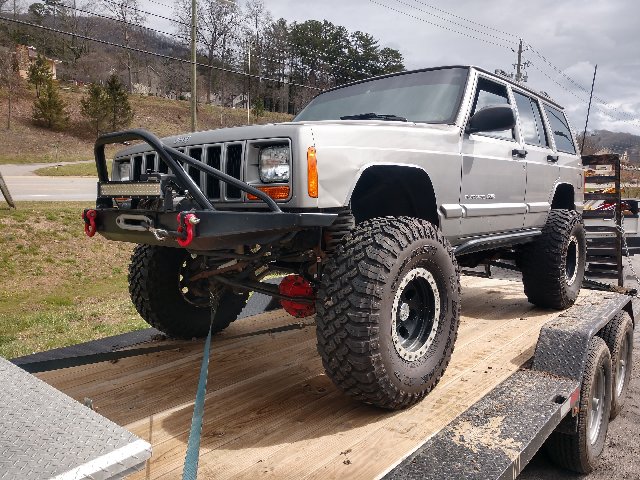

A killer deal popped up here locally and I jumped at it. 2001 XJ, pretty good list of mods, needs axle work. I got it cheap. Like embarrassingly cheap. Plans are to fix the obvious items and make it a DD for rmyself and a light to medium wheeler for my wife.
It has:
* 4.11 and ARBs front and rear. But, the front seal housing is broken and the rear crosspin came out and took out the R&P. Should be easy fixes as it needs lower gears anyway.
* Skids, SYE, armor, winch, rock rails, etc. I'll keep all of that as is.
* 4.5ish RE/JKS short arm lift on 35s. I'll likely build my own 3 link and crossmember but keep everything else. Rear lift is full leaf pack and SRB. All good there.

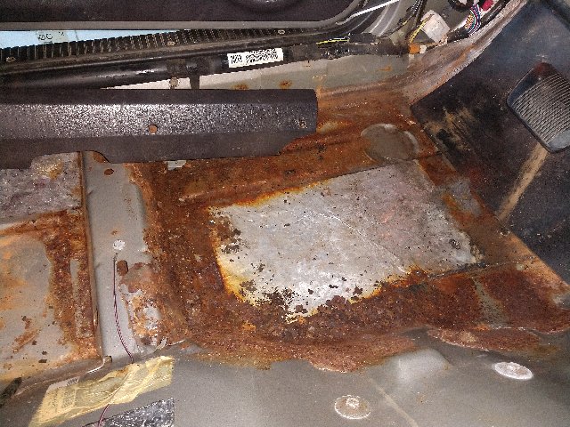

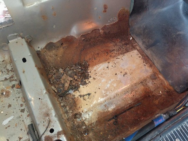

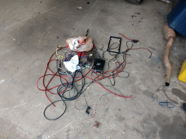

* Rusty floor pans up front. I was removing the stereo system and felt flakes under the carpet. Looks like the windshield is leaking and as a result, time for floor pans.
* Has a new engine and steering box/ZJ TR as of last year.
Plans are to 3 link it, install RCV front shafts, re-gear to 4.88 and hit the trail. Maiden voyage likely the Sweet Meet 2020
Build will begin when I finish a laundry list of gear installs I have lined up ahead of it.
Current pics as of last night.
