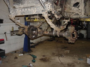

Without getting into all the physics and engineering crap (that I'm sure I don't FULLY understand), he's got what looks to be ~7-8" of separation at the axle, but maybe 3" at the frame. This causes anti-squat numbers to go up.. more separation at the frame will lower the number. The more the links look like a triangle from a side view, the more AS you'll have typically. (A very broad generalization)
Honestly, the best thing that I did was download the 4-link calc and play with the numbers, and see how it changes things.. There are some good books that can explain what alot of the terminology means, usually accompanied by a big equation, which the calc does for you.
[disclaimer]
I'm not trying to sound like I know all there is to know about linked suspension, far from it.. But I have learned a ton from researching my own future setup, and have re-designed it several times as I learn more..
As much of an asshole as I am, I really do like to offer help to people when I can..[/disclaimer]

The winch man, the winch...Don't know if you remember or not but I have a winch in the rear which pulls the axle up...without the winch this setup sucks as it throws my truck skyward on any move...but the winch...yeah...the winch...
These are the exact same links with the exact same measurements that were on my rear Toyota axle...and well...It works...I'm trying to remember what the exact explination of my geometry was when I built it but all I can remember now is that I indeed did have a worked out design and did spend some time on it before I slapped it together...
That's right, I forgot about the winch..
That's why I said "not necessarily a bad thing".. If it works for YOU and your style & rig, (like a bunch of the comp-buggies I've looked at), then go for it!
I didn't certainly wasn't implying that it wasn't thought out... don't get me wrong. :)
I run a center limiting strap for the same reason, because of the high AS in my current setup.
I still think that upper link setup is cool, I must have never noticed it before... dirt & mud tend to make everything blend in together!

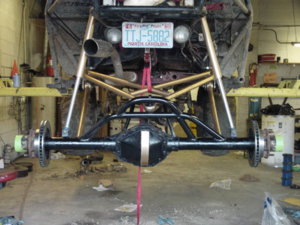

now it's beautiful...

Not the gold again! Oh wait its bronze right? :lol:
That upper link is sick, you think you could do something like that with my RE LG system? I was going to do there tri-link, but I hate RE now and refuse to buy anything else from them. Let me know an approximate cost on it using my joints if you can.
Thanks Russ(orange Rubi)
Well...the scheme was inspired by a little ricer car riding around town...all black car and bronze wheels...but you can't argue the color on the can (gold)...so yeah...we'll call it black and gold...

Looks like its coming together. I also think the links are freakin SAWEET, and I'm digging the gold. I drove by earlier and saw you wrenching, any more progress on the 60??

PIMP project. i saw your rig work at the playground, and now it is only going to be better. NICE.
