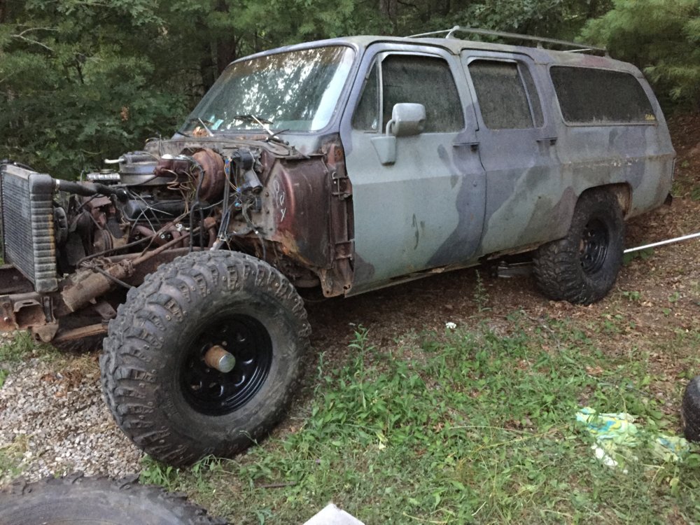

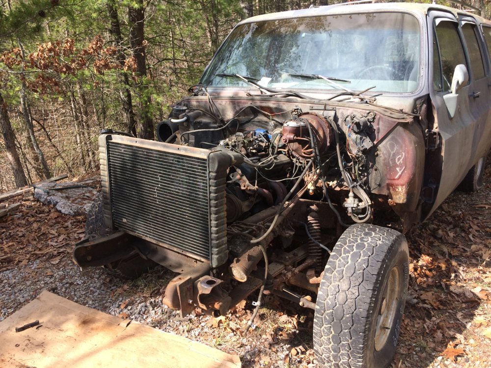

Had a few hours this morn to finish front rear down not cutting clip gonna tube and bolt outer fenders back to that pulling axle sat out of front and cutting frame back to engine mounts gonna tube from there forward! Really wanna link it but after I get the 52 up front and it moves axle forward I may be happier we'll see!

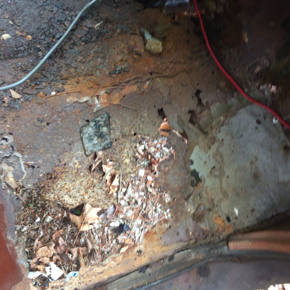

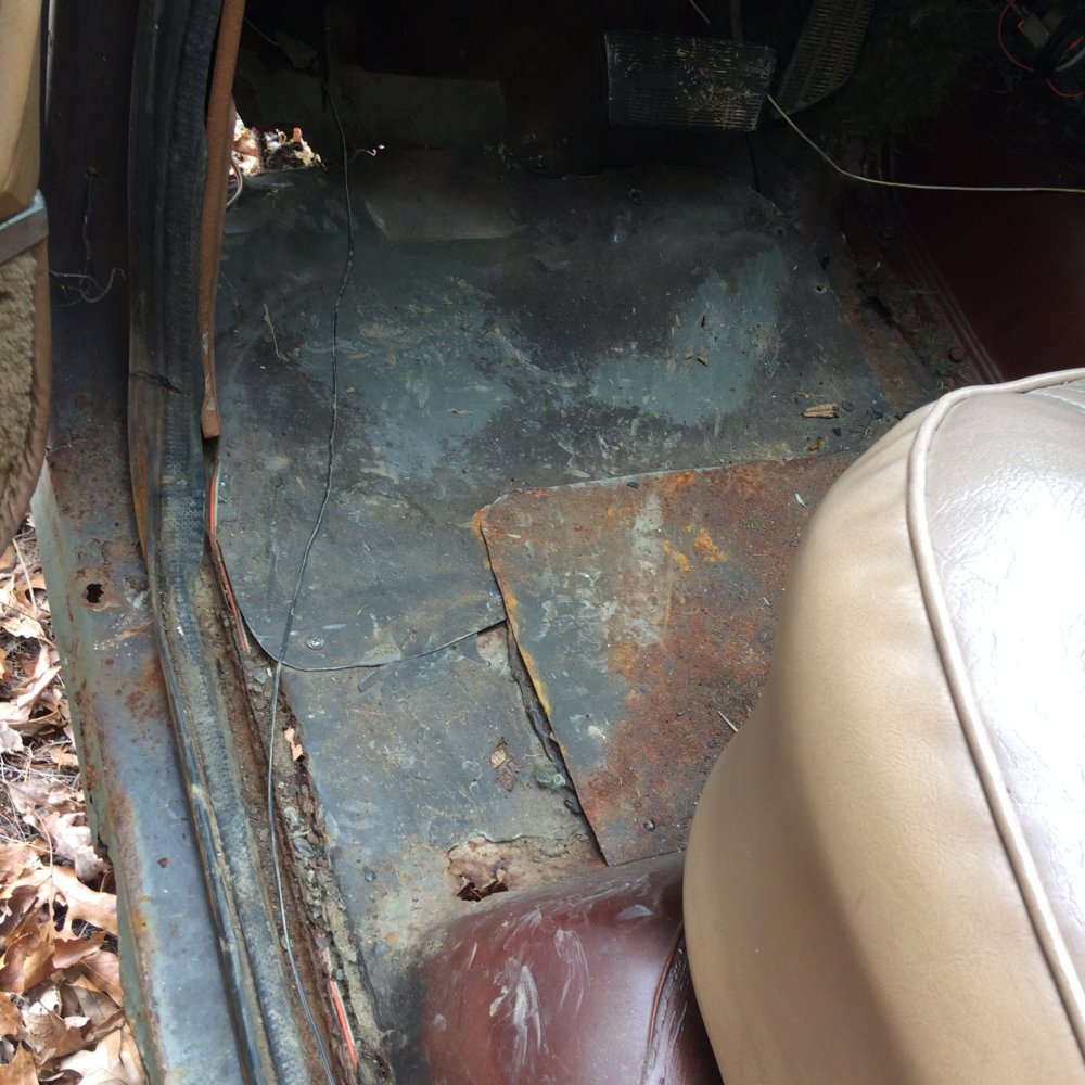

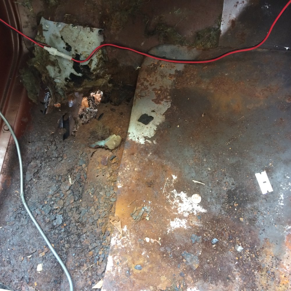

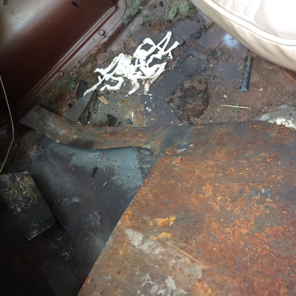

Here's these amazing floorboards... smdh
Pass side

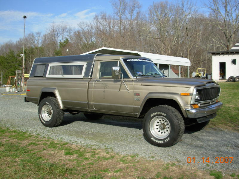

Oh wow yeah that's sexy for sure!! I'd have that as a daily driver without a doubt!
I did until 2007.....then gas shot thru the roof. It was hell filling the 41 gallon tank when it got to be $3.70 a gallon, especially when she struggled to get 8mpg with my lead foot...so I sold it :mad::(
