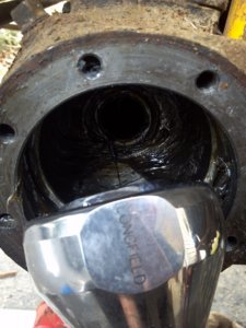

I got drivers side Long and hub gear installed yesterday. Doing the passenger tomorrow. GOODBYE FACTORY BIRFIELDS!!!

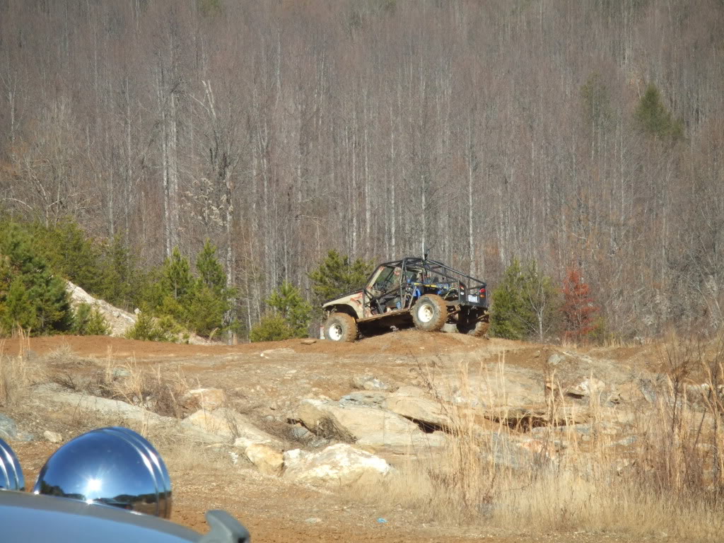

Thanks for the pic Shaggy! I would have said hello if I knew you were there. I work in Candler. Its nice to put a face to a name.
I beat that thing pretty hard, its nice to have Longs! A few times I slid off a rock and slammed the front so hard it made me cringe. A few times I got out and checked for damage and all I had was rock dust everywhere! And for a stock belly skid, it has held up beyond expectations.
Not having any suspension lift has my driveshafts up out of the way!
