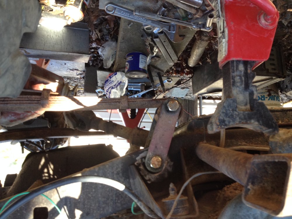

Got some spring hangers I am working on that are 3/8" worth if beef! With any luck I hope to hang the springs next weekend.

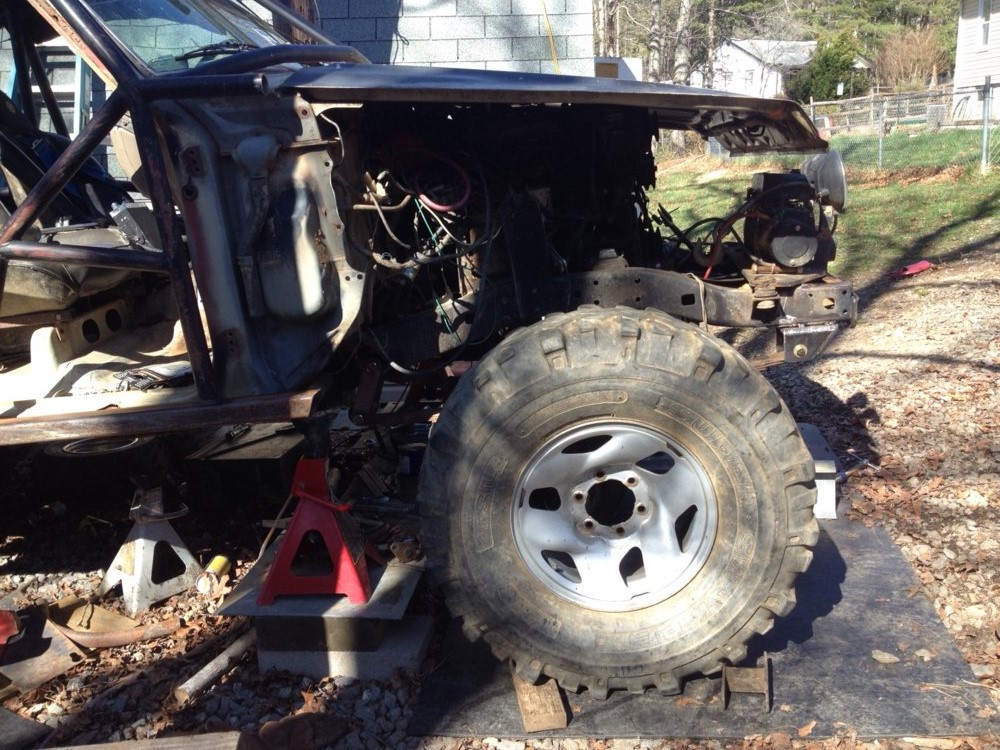

Just about the time you question your sanity for undertaking a project like this outside on jackstands in the dirt you get enough progress to gain some motivation and push forward.

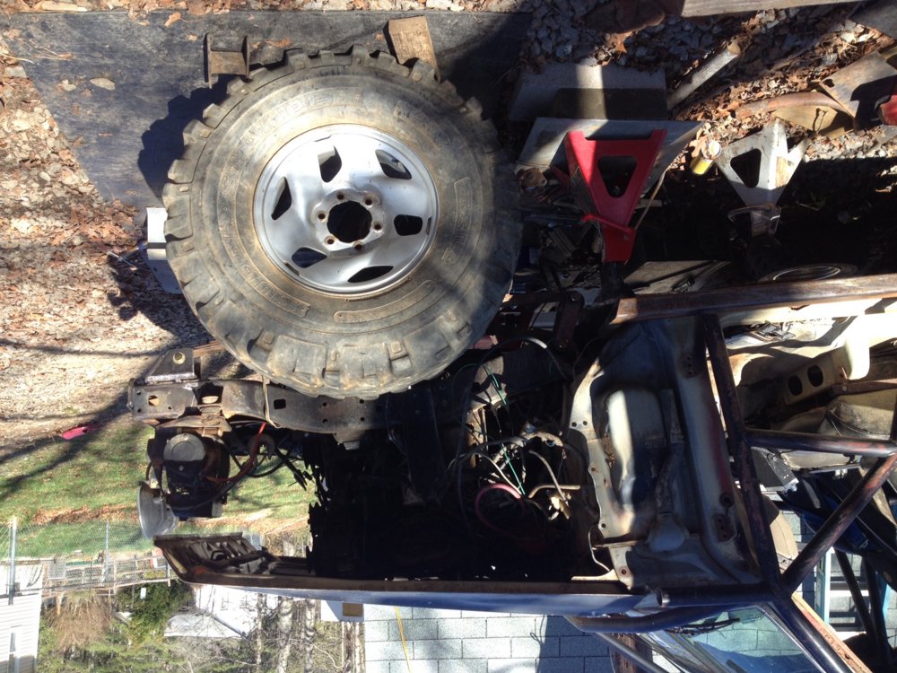

Front springs are hung. All of this stuff will get tacked in before I set pinion angles and such. I figure it is less work to cut a few tack welds loose than it is to completely cut something off to move it (or smash it and throw away).

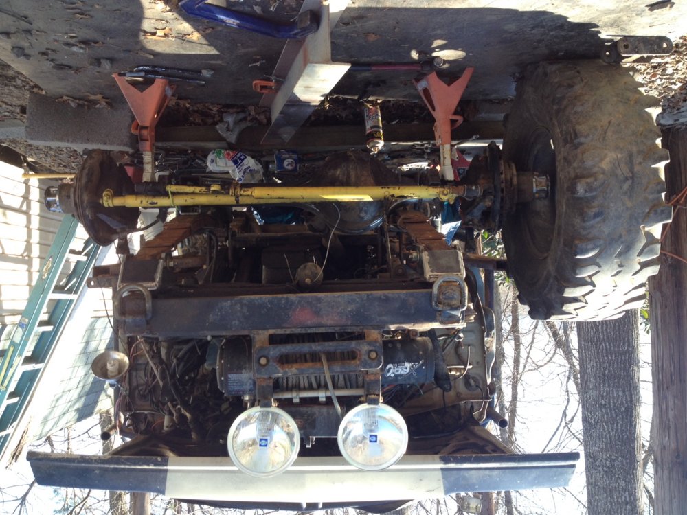

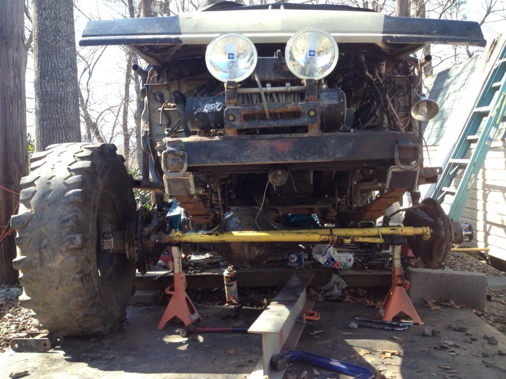

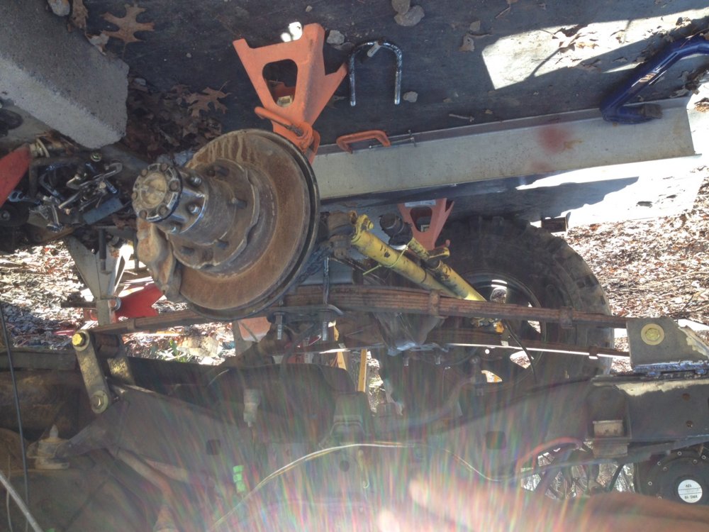

This is about 1.5" low from ride height. I have the rim rolled forward about where the mount will be when I flip the springs. I think it should work with the steering. It has the Cali look with the rear riding low. Time to hack all of the rear mounts up now and mount my E350 springs.

Got the rear leaves dropped and brakets removed from the frame. Hoping to set it back on all fours this weekend and set pinion angle on the rear. Have to wait till the rear is set so I can put in a modified rear spring pack in the front flipped around to stretch the front.

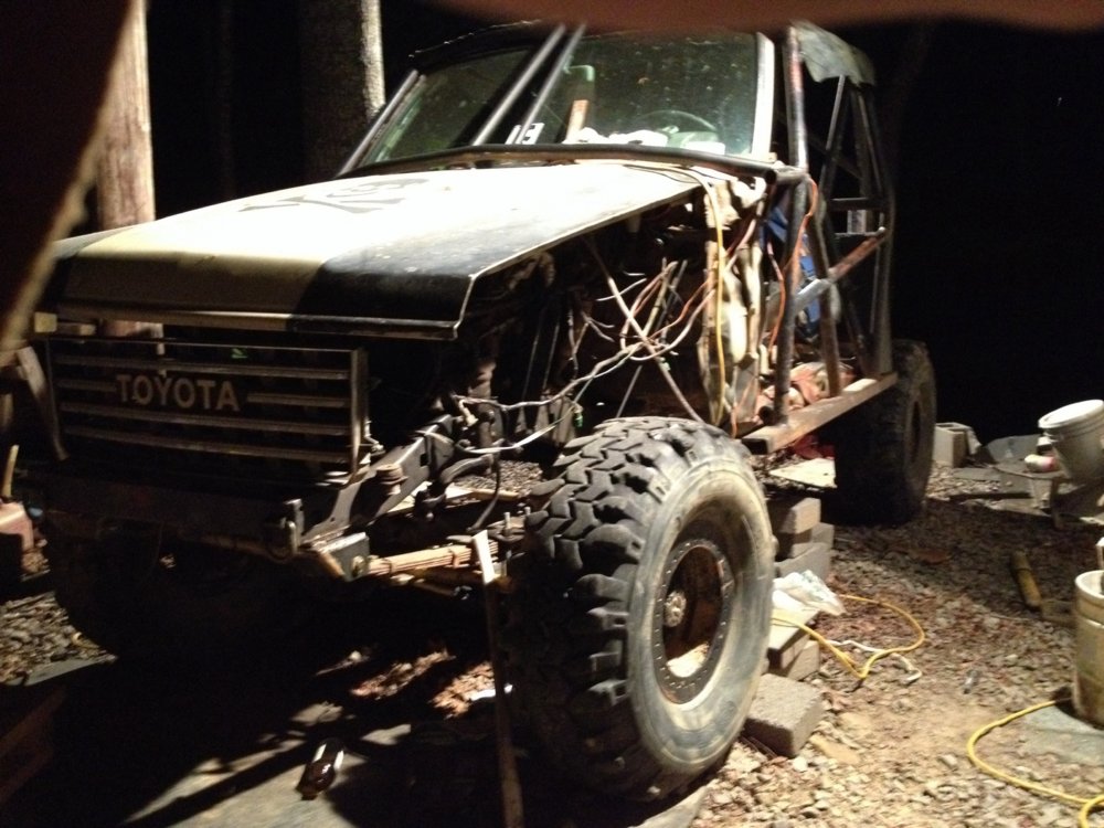

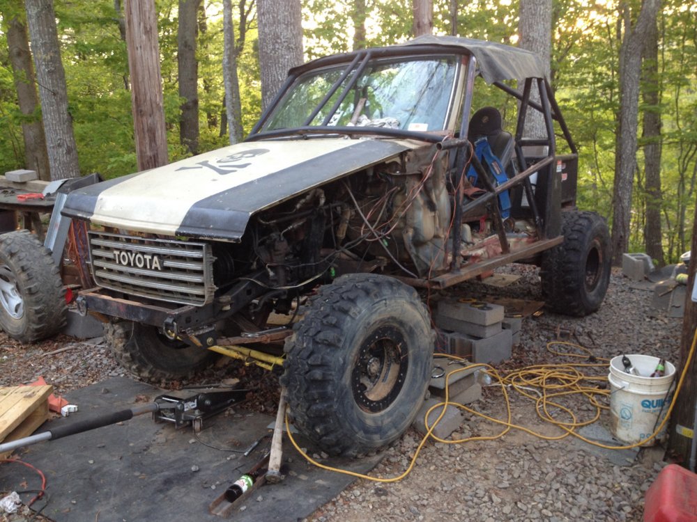

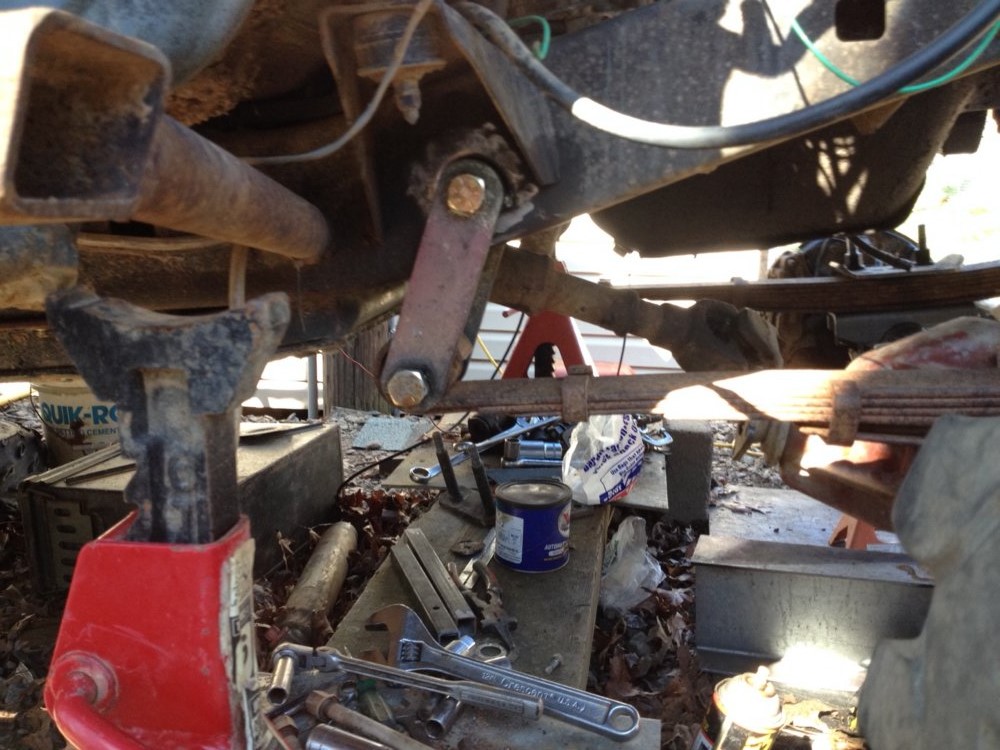

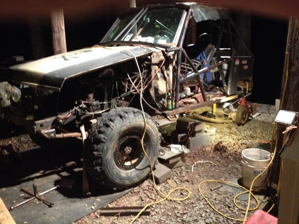

Well after several months of this thing being on jack stands, I finally got it sat back down on the tires sprung over. Modified rear cruiser leaves with shackle reversal in front and E250/350 with overload leaf removed on the rear.
Initial 11:30pm measurements are 24" to frame and 22 1/2" to belly skid on 36s
Going to try and set pinion angles today.

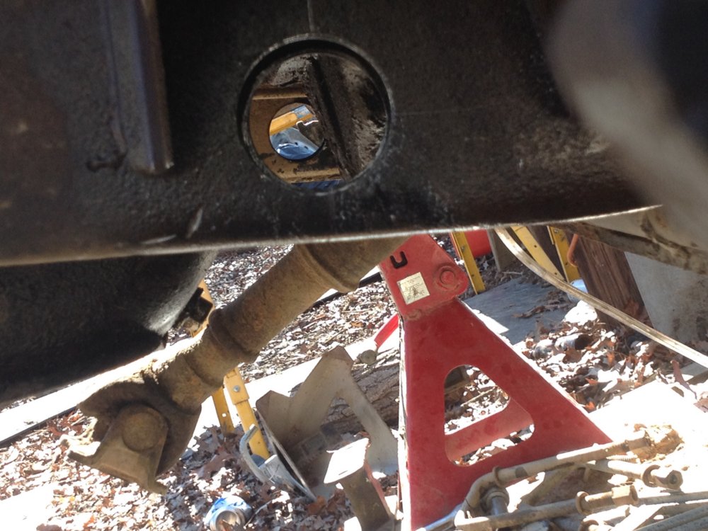

I cut the spring hangers in the rear off and adjusted them for a better shackle angle at ride height. Bolted up the rear and clocked the pinion to take a look. Ended up using f250 spring plates with reused cruiser u bolts.

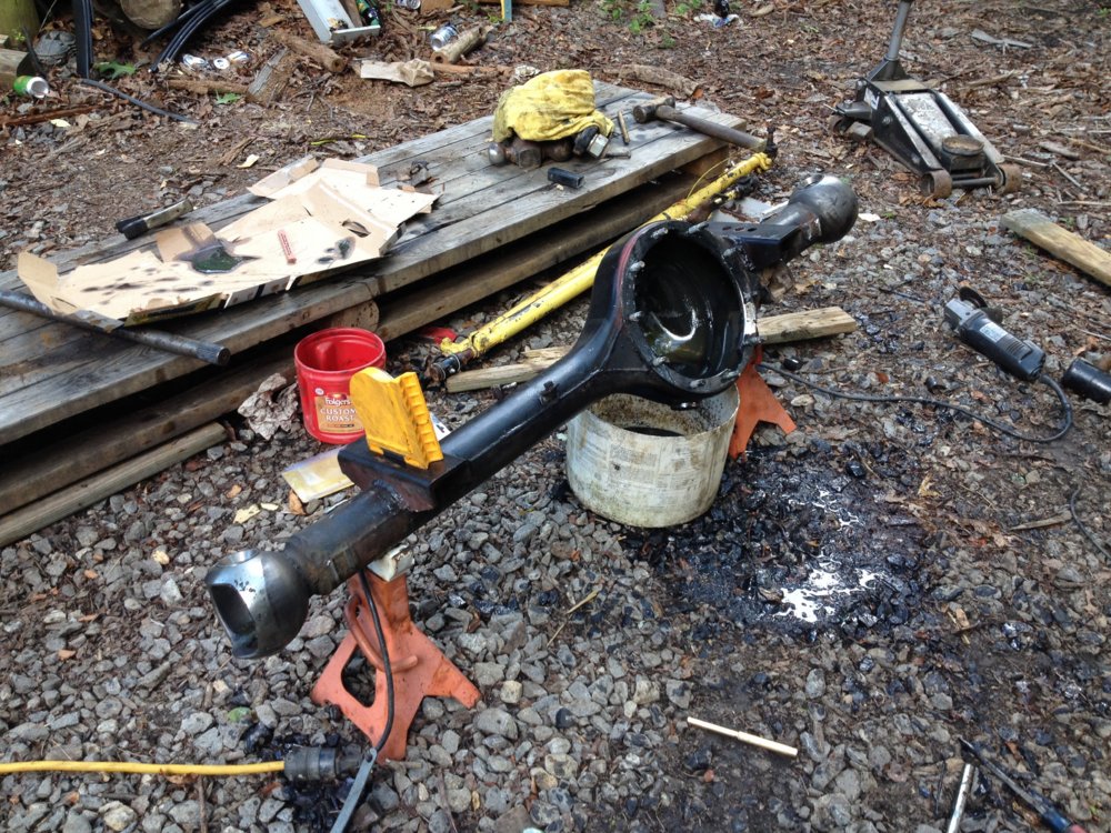

A couple weeks ago I told myself "The heck with a cut and turn if stuff clears". Well it did not.
I've been pushing hard this week with about an hour each night. 9-10. To get the front axle torn down. With any luck and some time I will turn the knuckles this weekend. One side is torn down and ready for the grinder.

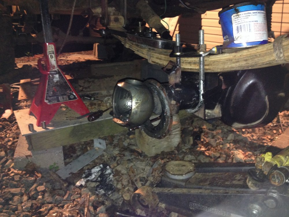

Between mowing, Daddy daycare, and a pool party w a 3 yr old in the front yard but I did get some progress. Got all of the complicated maffises figured on. Factory is set a 4 degrees. I'm thinking that I may be at 6. I'm worried that at full droop my springs may contact the drag link. Will probably go 6 with just a tack and assemble one side to check clearance. I've already installed and remove the axle 15 times... Why on one more to make sure it's right?!?
