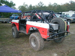

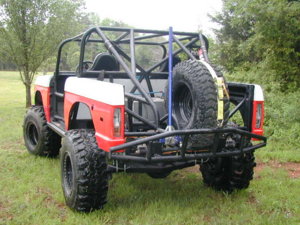

i like it. we painted the bronco to match the old days of Bill Stroppe's machines, when he and Parnelli dominated Baja. I am only running 1 tire on the back and a jack. Don't really have room for 2, but don't think I'd run to anyway. You can mount your tool box in the back. That is what I did...
First pic is w/out the tool box in yet. 2nd pic is at the race. I was working non-stop on it to have it ready... I used a metal tool box that I had laying around and tech-screwed it to the metal base I made for it. The jack goes underneath of the box.
