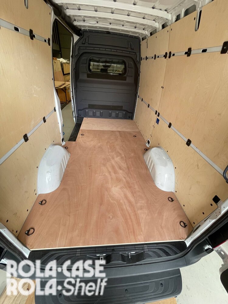

You could also cut a 6mm luan plywood the size of the cargo area and stick evs foam on top for a flat removable cargo floor, kilmat on the floor under it. Pretty common practice in cargo vans
