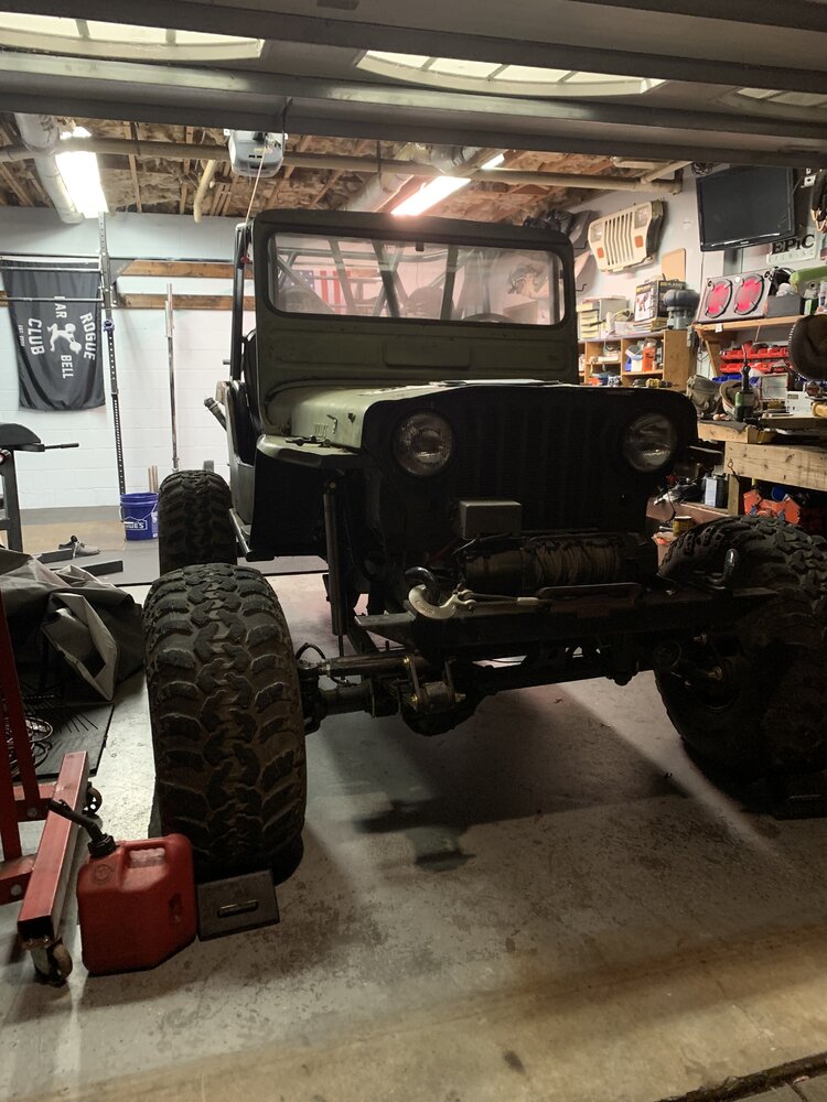

Some progress... Pulled the jeep forward a few feet with the truck so my welder could reach. I've had a battery disconnect sitting in the box for close to a year and finally got around to installing it. All new 1/0 battery cables and lugs. I still need to order a bus bar to power ignition/accessories etc. The kill switch has 1 input/2 outputs so I can kill power to the winch as well.

Planning on pulling some leafs out of the front and rear this week. Still need to hook up cable shifters and then fix the brakes/bleed but a few steps closer.
With @getstucksome help, we got the front lowered a few inches by pulling two leafs out. Much better shackle angle now. Sitting a lot nicer and a lot more level now. Ordered a marine bus bar to finalize electrical system and give me a convenient space to add more items later. With it sitting lower, I was able to flip the draglink from the bottom of the pitman arm to the top of the arm for more clearance. Cleaned up some other electrical stuff in preparation for parts arriving. I need to revisit my Tcase shifter linkage and start prepping a plan for the brake system.

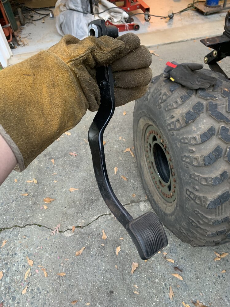

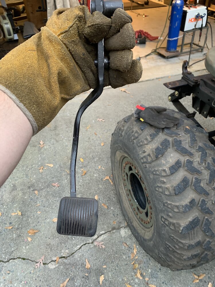

As evidenced by my other thread in 'General Tech', I was having issues with the brake/pedal assembly and the cheese-cloth thin firewall. I added a piece of 1/4" plate to the firewall and incorporated some more bolts. No more issues with the firewall flexing. However, I was still having issues with the pedal assembly, especially the clutch. The assembly came out of a cherokee and the the clutch pedal was offset about 1.5" from the arm for the pushrod for the slave. During operation, instead of acting in a linear motion, it was operating in an arc pushing down and into the brake pedal. Even pushing by hand, you could visually see the assembly flexing.
Ordered a new wilwood clutch pedal that bolted directly in line with the slave cylinder. I now can operate the clutch with my foot instead of my whole leg. Clutch feel is night and day difference now. I have also reworked the brake pedal a bit and it should clear the steering column brace etc. Just need to bleed the brakes and it should be good to go.

Willys is back in the garage. Brake pedal got rebuilt and is a mix of brake/clutch pedal. I get full travel out of the pedal with no binding. With both pedals depressed, there is no movement in the firewall. I’m very happy :driver:

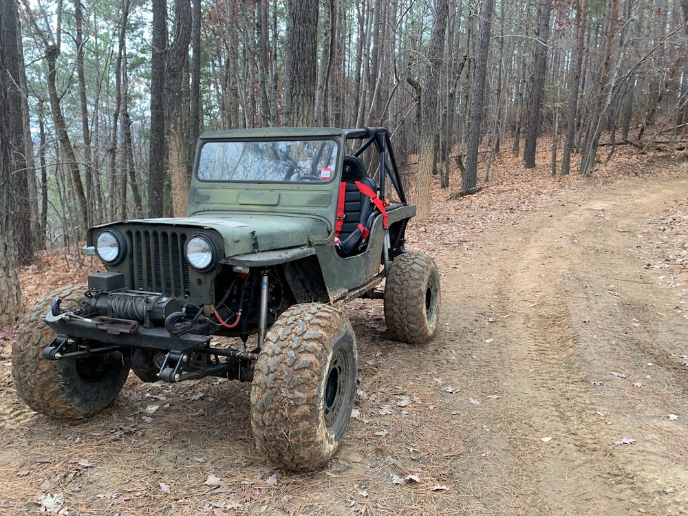

Pros - The jeep drove great. It got hot once during a lowspeed 1st gear pull but quickly dropped down to normal levels. Oil pressure was great all day long. It was a pretty comfortable ride with no hard jolts etc. With the exception of the slab pile, it was point and shoot for the most part.
Cons - I really should have done a nut/bolt check before riding, that would have saved a lot of time/headaches. Fortunately, all the "breaks" were easy fixes and I had the tools with me. I have to fix the charging system. I'm planning on adding a higher output alternator/going to a 1 wire and putting in a new starter to fix this issue. I also apparently bent the right rear leaf on the slab pile by sliding back into a rock. It's not terrible and I do have another set of leafs. There was a lot of popping/clicking from the suspension/axles. I'm assuming that it was the Spartans engaging/disengaging. First rig with lockers so it was a new sound for me. I also need to build a trans tunnel as the heat coming out of that was pretty hot. There's also a million small things that I want to add into the interior like lights, speaker etc. I also need to rebleed the brakes and/or switch to a bigger master. I had brakes and had no issues stopping but want a firmer pedal feel.
All in all, I was very happy/pleased with the first run. It was comfortable to drive and aside from the issues, it was a great day on the trail. There was a LOT of people out and there was numerous jams but everyone was great about getting in/around vehicles. The Tundra pulled it well, I'm planning on adding a brake controller for the trailer brakes in the very near future. Can't do anything about the gas mileage, I think I averaged around 8.5mpg :laughing:
