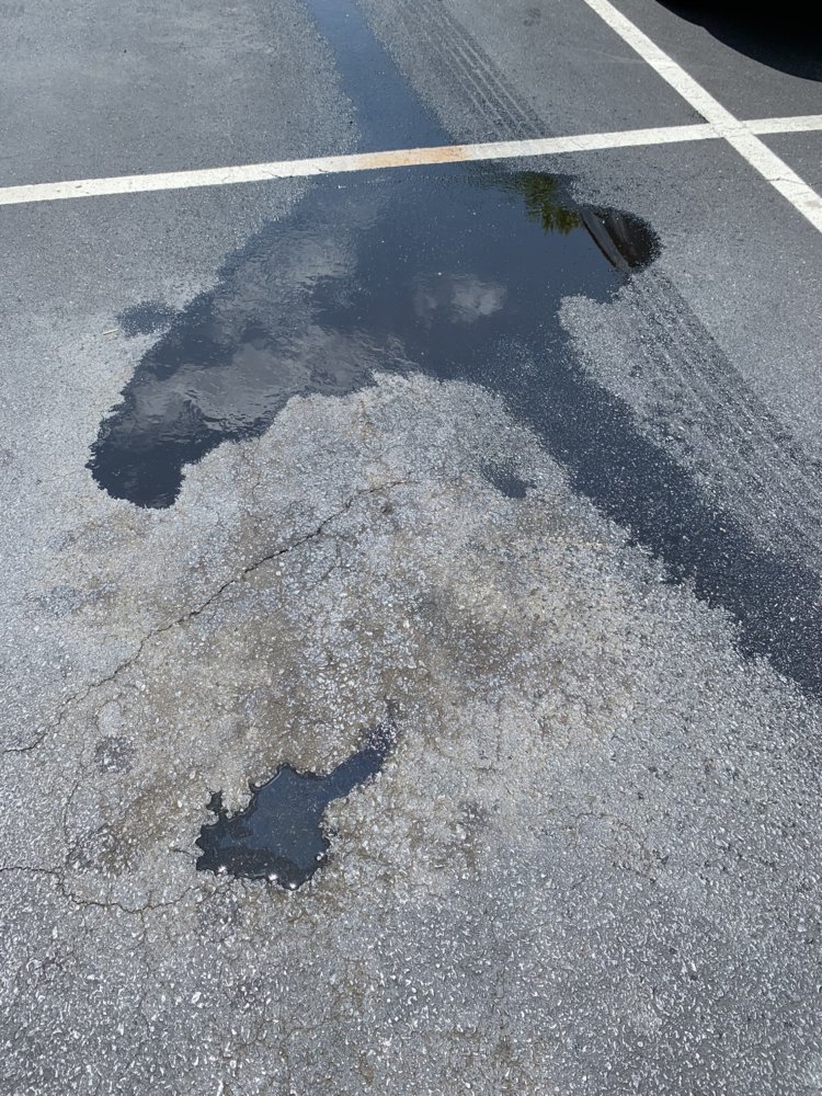

so I was walking out of the grocery store, seen what appeared to be wet tire tracks running through the parking lot, but as I stepped in it I slipped as if I had stepped in oil, then noticed a burning oil smell in the air and came across this.....It appears someone has lost a great amount of oil but decided to drive away anyhow :confused:

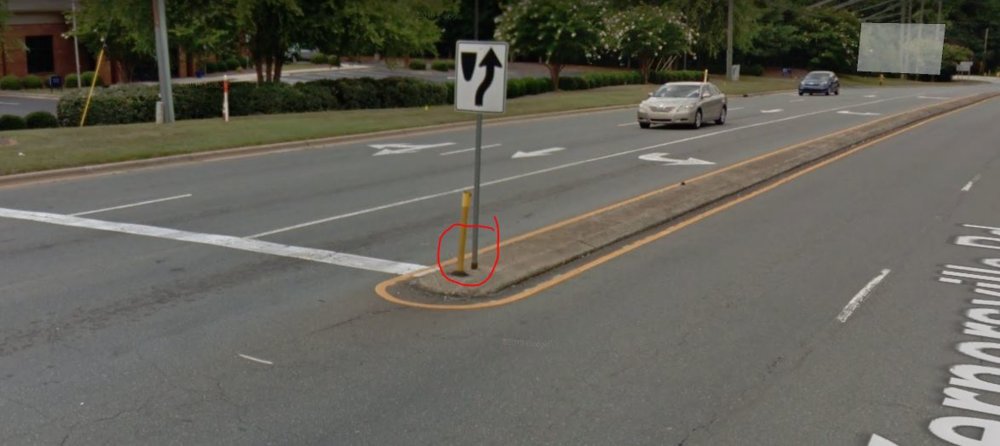

I was going down 150 years ago leaving Kernersville in the evening into direct sunlight following a late 90's taurus. He couldn't see anything apparently and centered the concrete divider. Apparently the sign was sheared off from a truck cutting that corner too tight, but left a short jagged post about 3" above the concrete.
Anyway, it ripped his oil pan nearly off. I saw the deluge of black fluid covering the road, and backed off as he continued to drive. The oil stopped flowing about 100 yards past where he clipped the stub, but he kept driving for almost a mile before I assume the engine shut off, because he came to quite an abrupt stop.

When I worked at the hobby shop on base, guys would sometimes double gasket their oil filters. It looks pretty much exactly like that. Naturally, they would immediately back out of the shop and leave several quarts of oil on the concrete and asphalt.
I didn't even know you could leave the old gasket on the block until I worked there.
I actually did that by accident once on Jeep I was changing the oil in, didn’t realize it, the old rubber gasket stayed on the block when I removed the filter, put the new filter on, cranked Jeep, poured oil all on the ground. :rolleyes:
Double gasket? Yea, me too, before I learned to Check! That's what I got to thinking, if the oil had just been changed. Leave the Plug out, & all the oil would have been where it was filled. Double gasket, might get across the parking lot, before it blows out.
My BIL did his own oil change on a ZJ 4.0 and didn't check for the old gasket. He drives like an old lady with nowhere to be. Actually made it almost to work the next morning, about 10 miles before it let loose. Called me tripping out, thought he blew the motor. I show up with 6qts and removed the extra gasket, still alive today!
