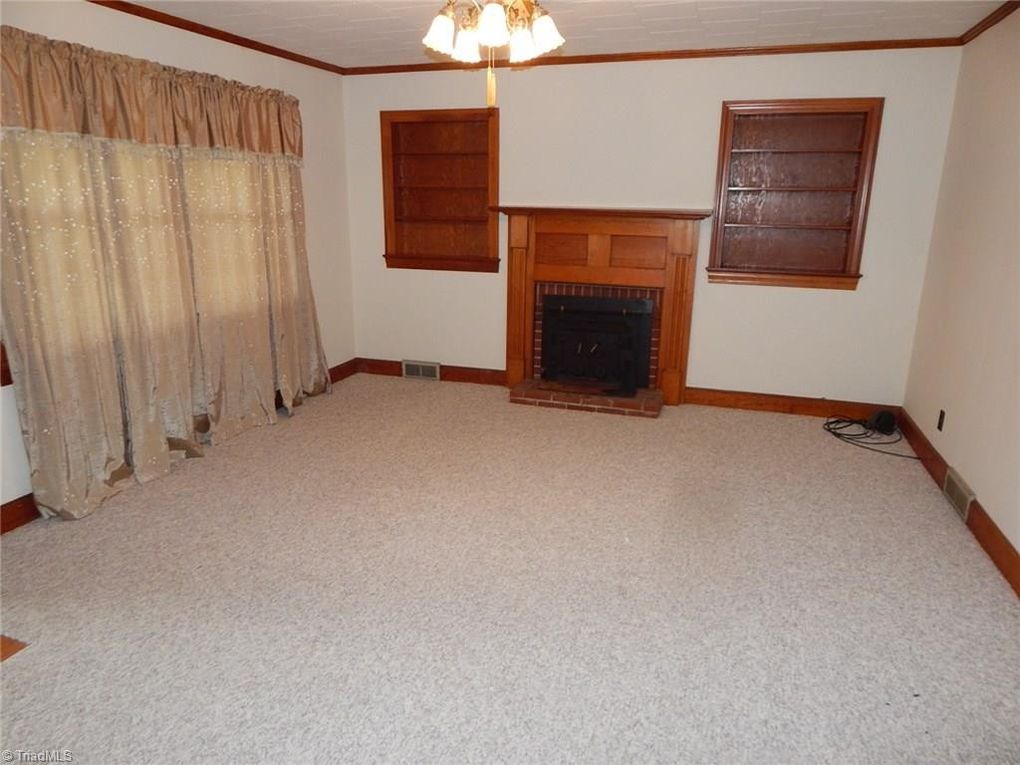

When we bought our house it came with nice thick fluffy carpet. But it was white. Between me and the dog, its no longer white. We have planned to pull it since we bought the house since it has beautiful hardwood underneath. Was put down because the 80 y/o lady didnt like cold floors.
Anyone have any good tips for pulling up carpet and cleaning the underlying hardwood? Hoping not to have to refinish, but we will if needed.
@GotWood
This is the carpet when we bought the house.

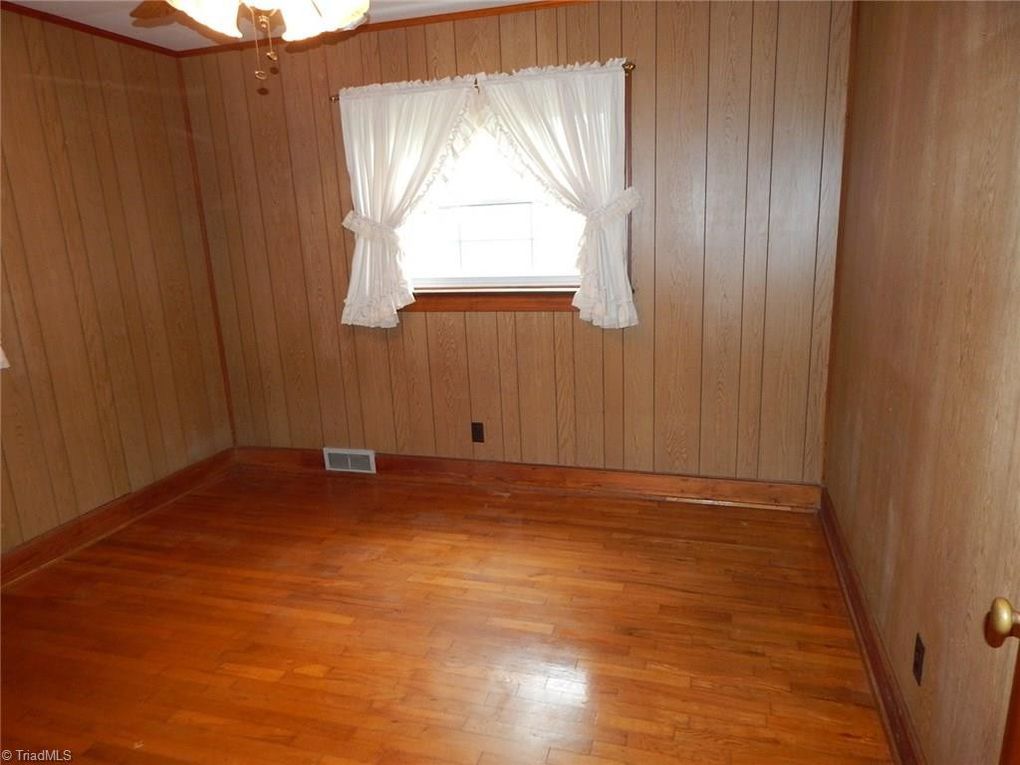

Here is what the hardwood looks like throughout the house.
Our game plan is just to clean it and shine it up.

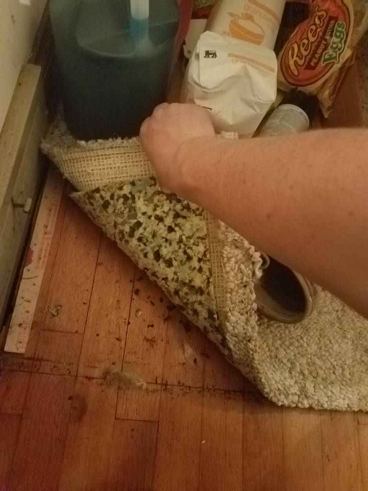

We pulled a corner up last night. It has nice thick padding under it. The carpet was in great shape when we moved in. But our puppy has peed in a few places. We cleaned them up quickly and they arent old, so hopefully no damage there.
The padding is brownish with black spots in it and the residue seemed to wipe off where we pulled it up at.
The floors in the other room look good to me. Supposedly that is what they look like throughout.

Here's what I'm working with. The little black pieces wipe away.
Carpet was put down in 08. House was empty sin 2012.

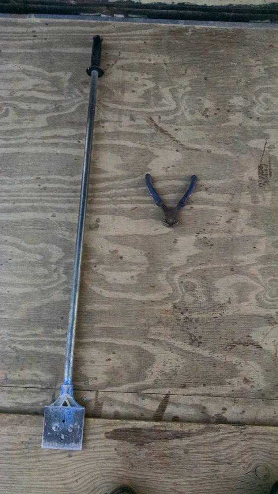

Here's the system to use.
Start by pulling the carpet, leave the pad on the floor. Now start pulling the "tackless" carpet strip (yes that is technically what it's called) and place it neatly on the pad .Now you can roll up the pad with the tack strip inside and avoid all of the puncture wounds .
Now you have the floor uncovered and can decide on how to remove the staples. If your going to save the floor and not refinish get down on the floor with you newly purchased roll back pliers and a screwdriver and get to work .
If you decide to have the floor refinished (looks like it will need to be) skip the pliers method .Go to Lowe's and buy a scraper like the one in the picture . They are in the paint department for about $25. This will be the best investment you'll make .When you get your scraper home, beat it up on the concrete so it's not sharp, you don't want it to cut into the floor as your scraping. Dull blade slides over the floor and scratches but doesn't dig into the floor .
As far as cost goes, that's like asking "how much does a car cost?" . It will depend on many factors but expect anywhere between $2.50-$5.00. I know that's a broad range but many factors are involved like are the old floors waxed, are you staining, water vs oil finish etc.
