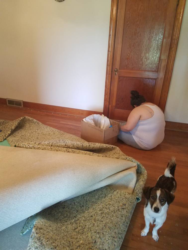

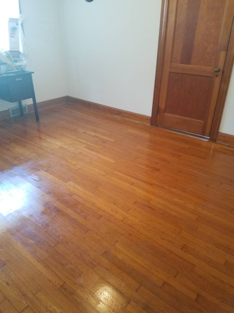

The fun has begun. After an hour, we have one room done.
Sent from my SM-G930T using Tapatalk
2 rooms down
Gettin r done
Looking great!
I might should have mentioned that if you cut a room of carpet into 3 strips, it'll be a lot easier to handle as you haul it away.
Full size people don't have that problem:flipoff2:
Floors look good. Looks like you got lucky in the black funk stuck to the floors .
Looking great!
Once it was just me and the wife I cut them in half. My FIL helped us for a couple hours on the first room.
Yea, we are happy with it. Will might get it refinished down the road, but for a days work, I'm tickled.

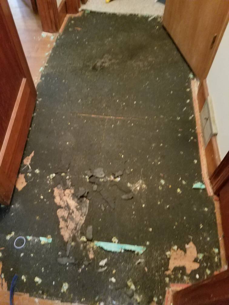

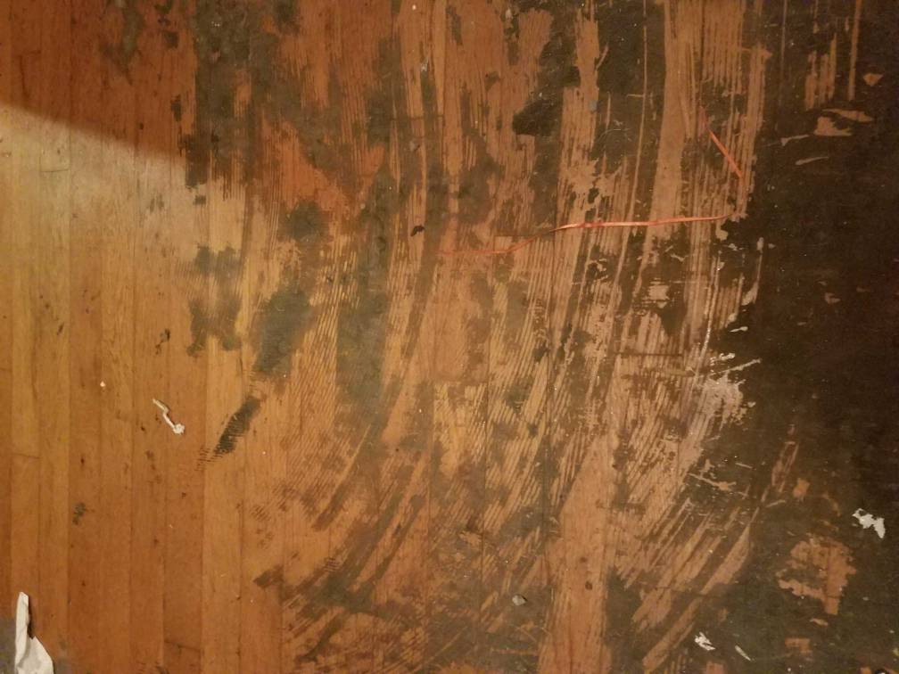

Crap! What's the best way to get this Off? I guess we might refinish after all...
P
Sander when you refinish that section. Had something similar in my house. I spent a week after work with a wide wood chisel, putty knife, and a six pack of beer and still didn’t get all of it. I had to get that room refinished
So... #1 WTF was that? Looks like roofing felt... or shingles? :D
#2 What did you do in that space? Re-finish or?
It's an adhesive backed foam, with added glue.
The only way I've been able to get it all off is soapy water and a brillo pad. What I've scrubbed looks great, but most of it still has some foam. It takes about 30 mins to clean roughly a square foot. Our master bedroom has that under the carpet, I haven't had the heart or the time to do it yet.

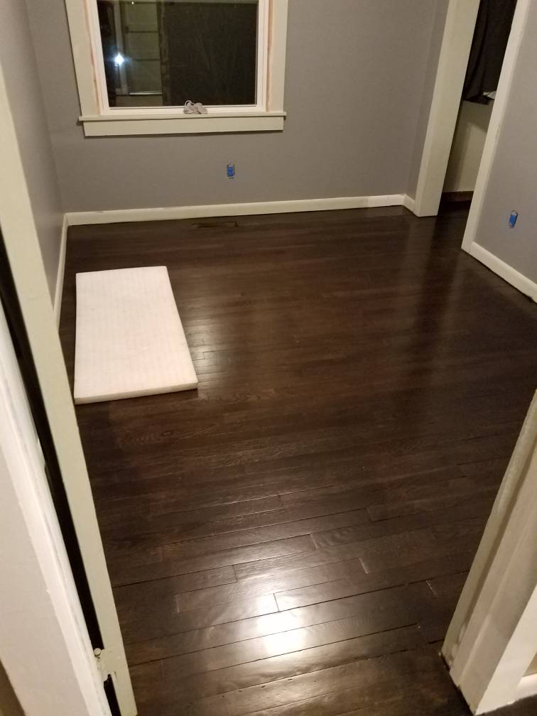

Current situation.
