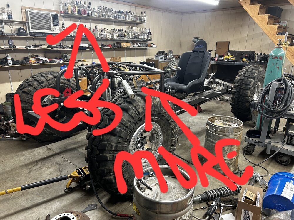

Be careful that the geometry of my buggy, although it works really well in this application, could lead to some negative effects for you.
Really low anti-dive for example, which is very much not what you want in a high CG, somewhat slow, car.

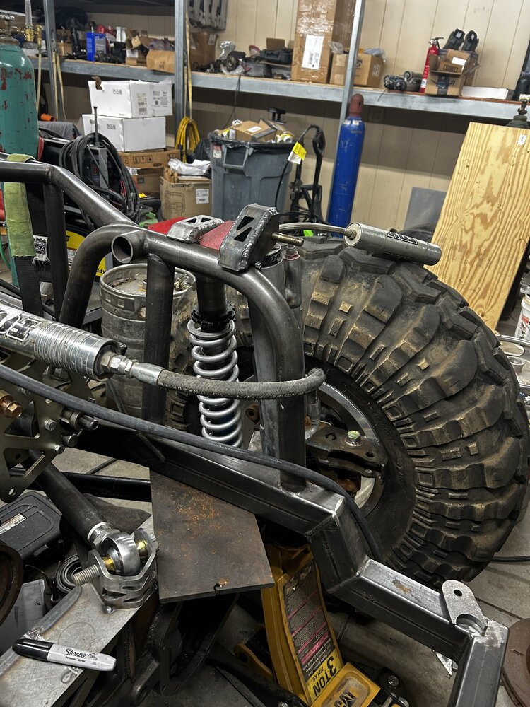

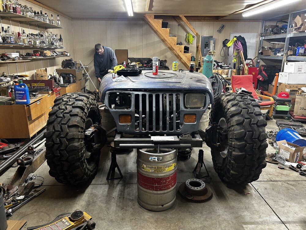

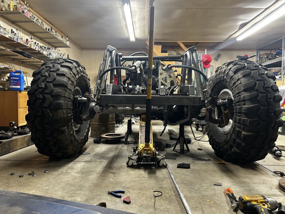

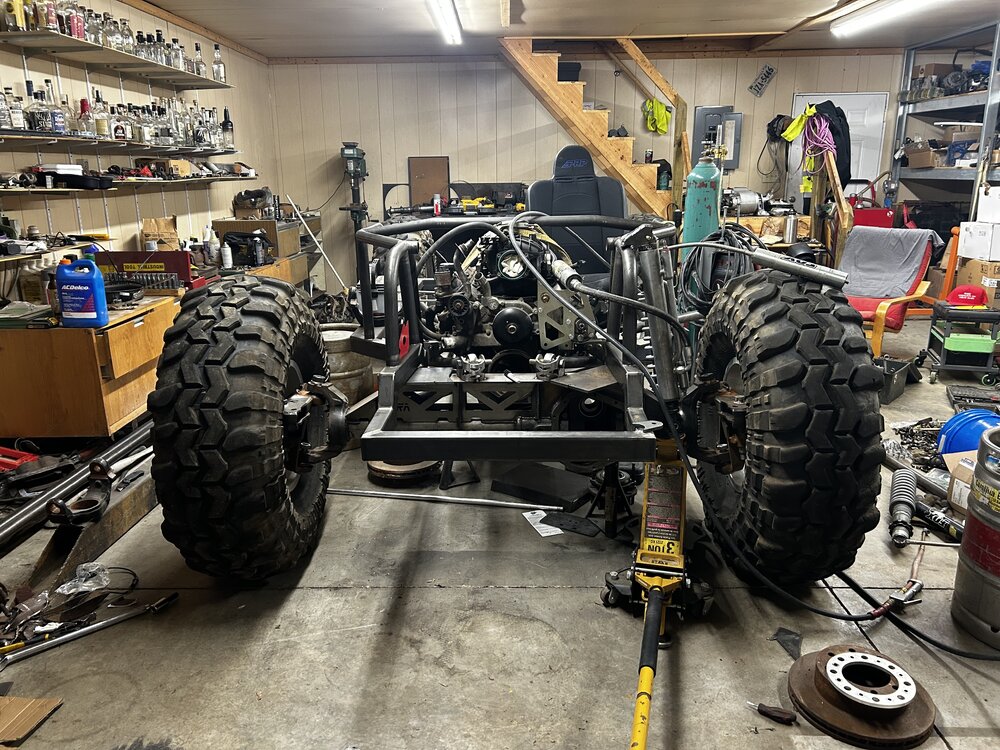

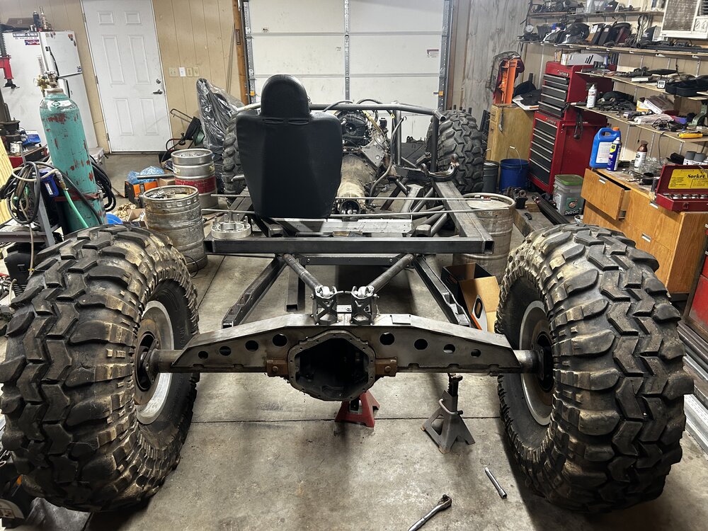

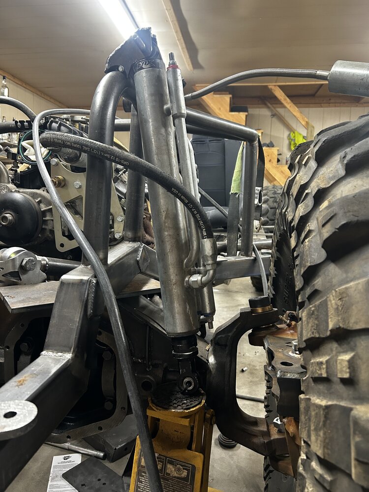

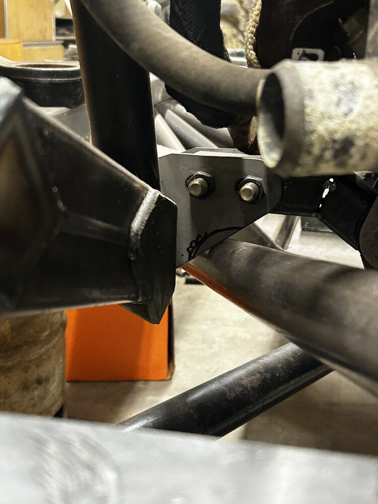

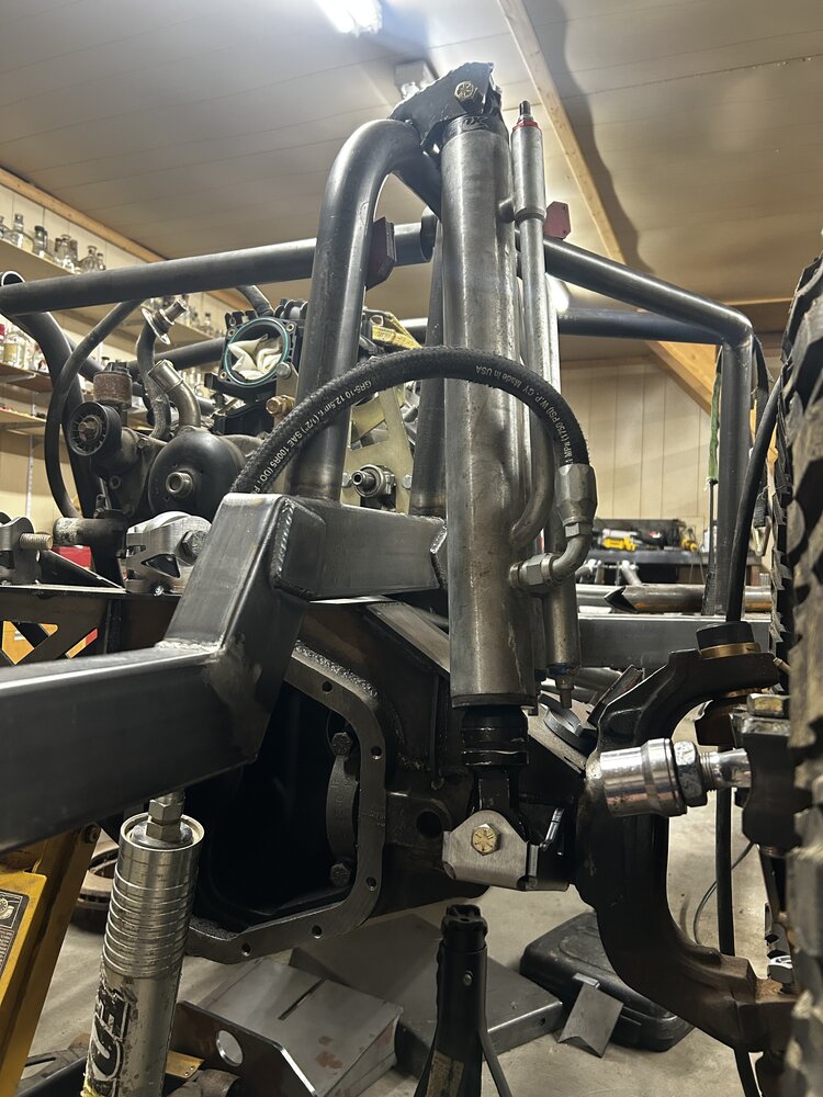

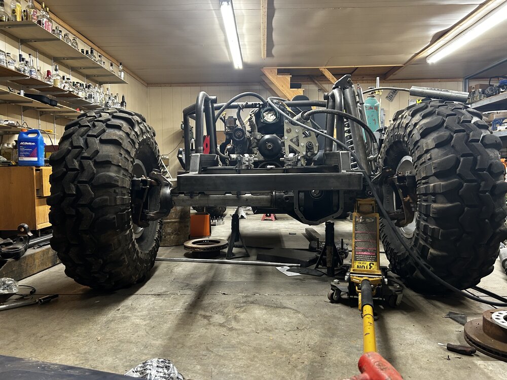

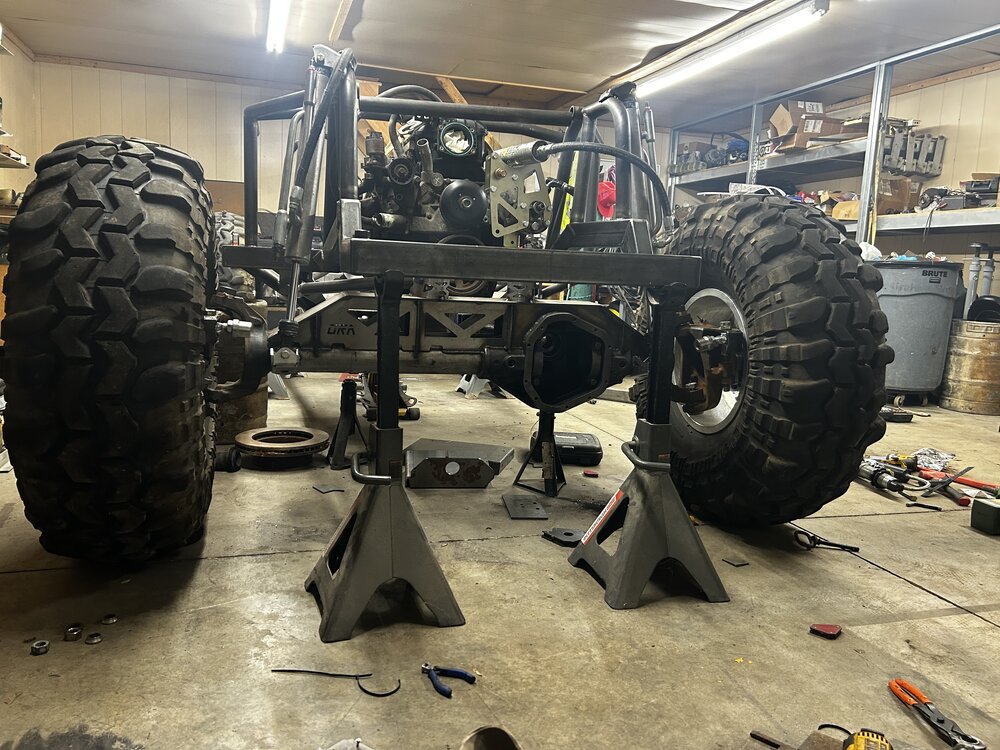

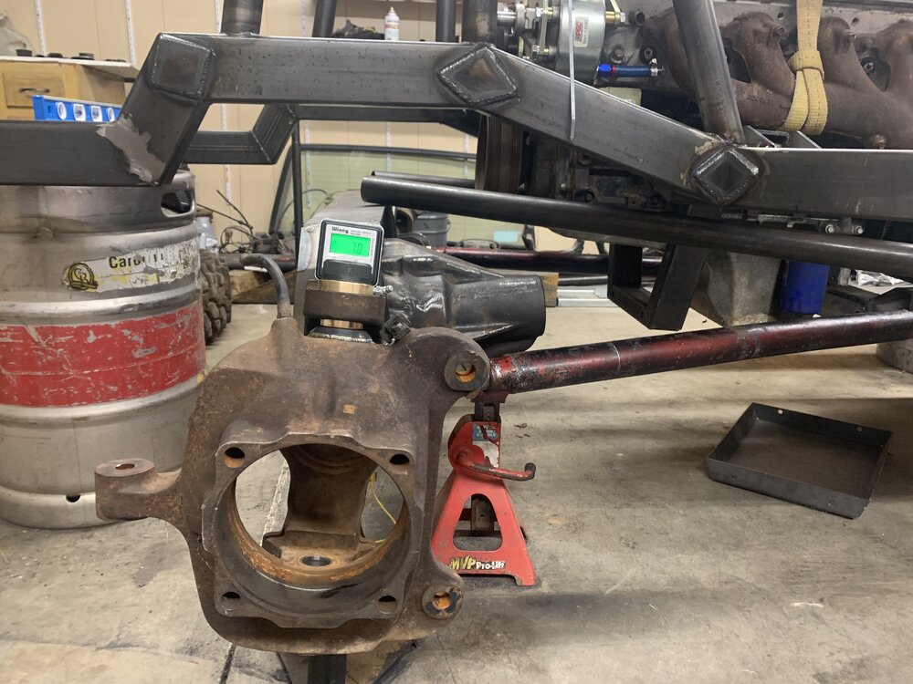

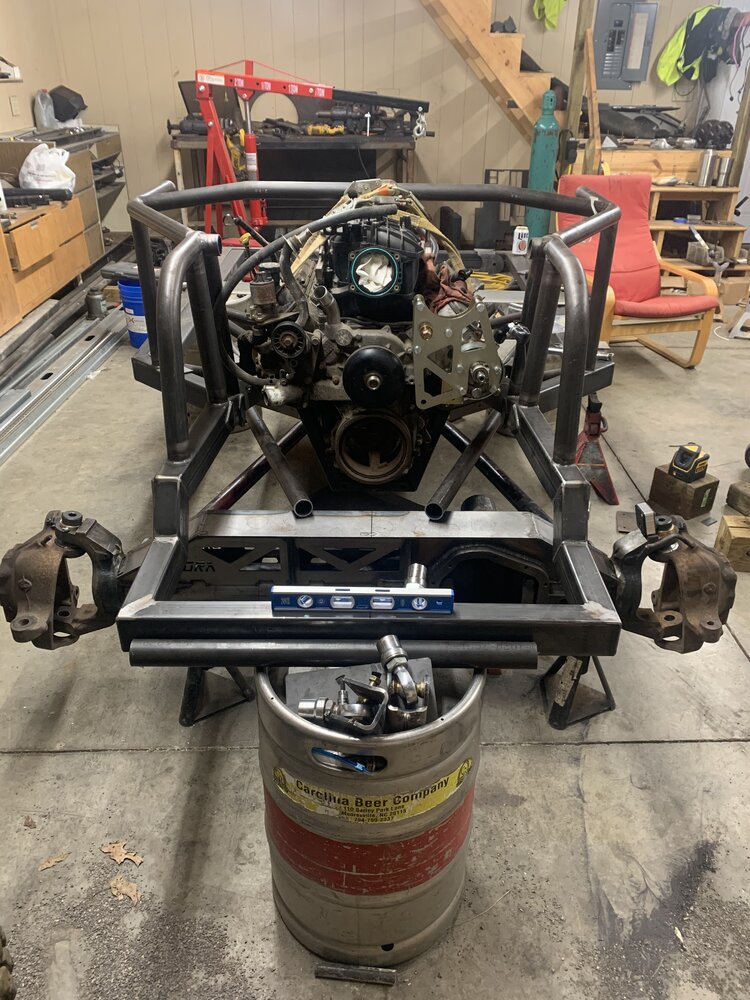

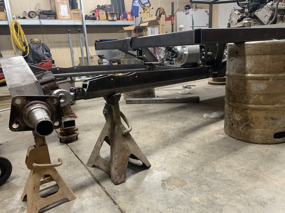

Been crunching numbers on the link calculator. Getting close to having the front to a workable spot. Ordering or making some new upper axle link mounts now…

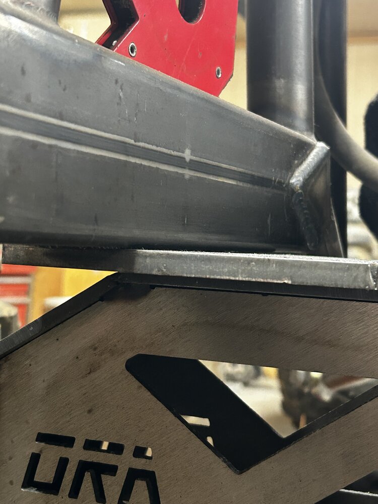

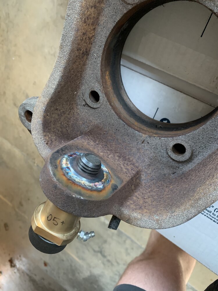

BJE welded in. Thanks @hurt4x4

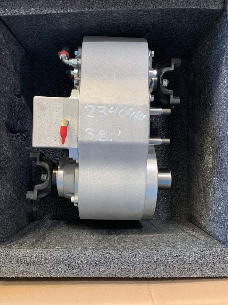

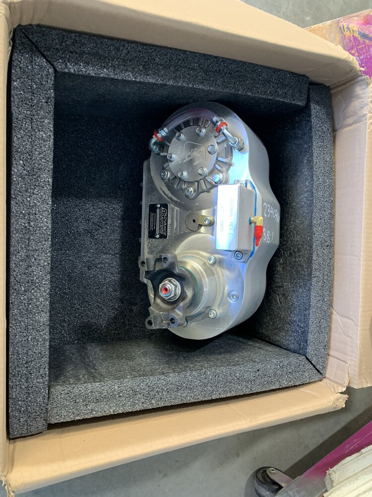

And Atlas ordered in April finally showed up.

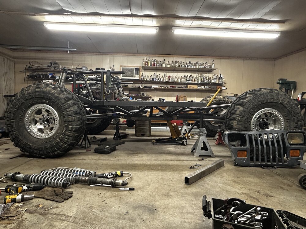

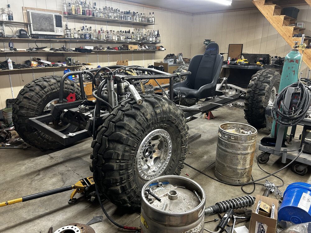

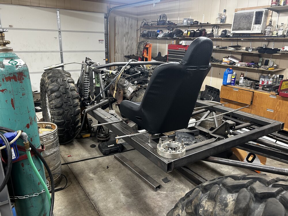

Any recommendations for a fab shop or someone to finish out the tube work/suspension set up for me?
Had another kid back in December and been dealing with some other family issues.
I've realized that this stage of life does not allow for much time in the shop so I'm ready to take this somewhere to get things rolling again.

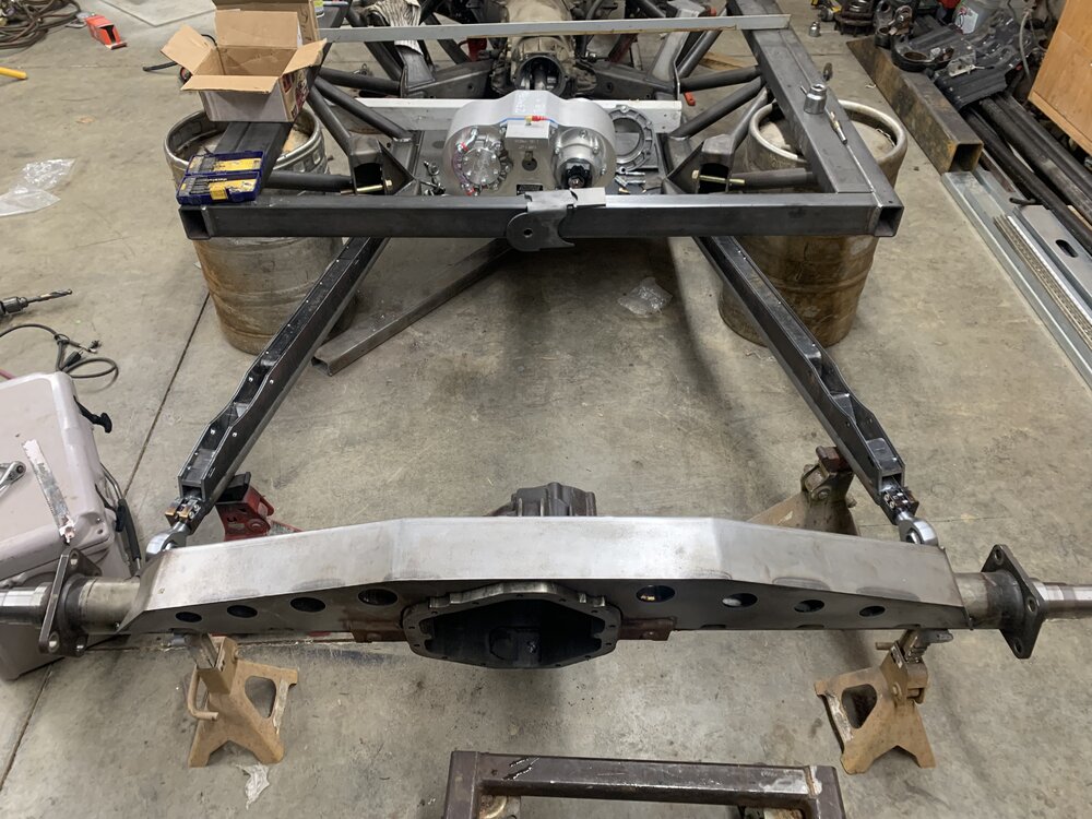

I will get the axles under it ( tacked on brackets for links)
Roll it on trailer with tubing, coil carriers, bypasses, etc. and hopefully pick it up as a roller with suspension and back half/cage done.
