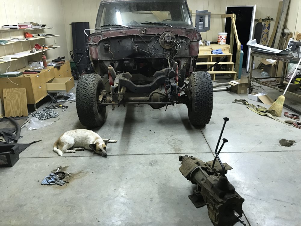

I am going to build another YJ on tons.
I want it to be different than anything that I've seen.
I'm thinking YJ truck cab, bed, chop top Low COG, about 118 wheel base.
Specs for now:
'79 Ford Dana 60 front
'78 14 bolt rear
Granny 4 speed/205 combo
5.3ls engine
43-44 inch tire

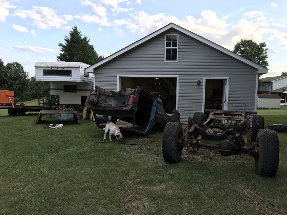

What I'm starting with.
I'm trying to do this build with next to no money out of pocket, while building a pretty stout rig that will get it done on the trails.
I'm getting married in 2 months and just bought a house, so that's that.
Any advice is appreciated! Thanks and hope y'all don't get too bored waiting on me to finish.

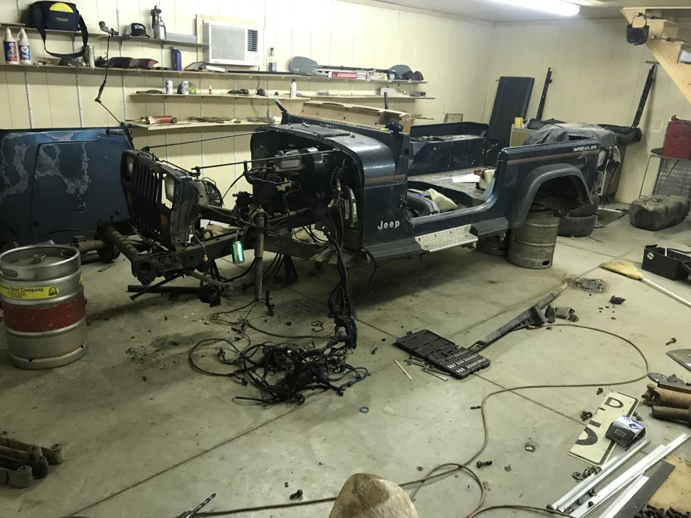

So I'll be keeping track of what I'm spending on this build to show that you can build a decent rig on a budget if you take your time.
I picked the jeep up off Craigslist for pretty cheap and parted it out.
I doubled my money on it.

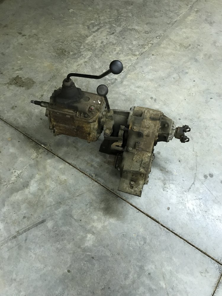

I had parted out a bronco this last summer that was on a 79 F350 frame.
Came out ahead on that $ wise and got a 79 kingpin 60, a t18 4 speed, and a 205 out of it.

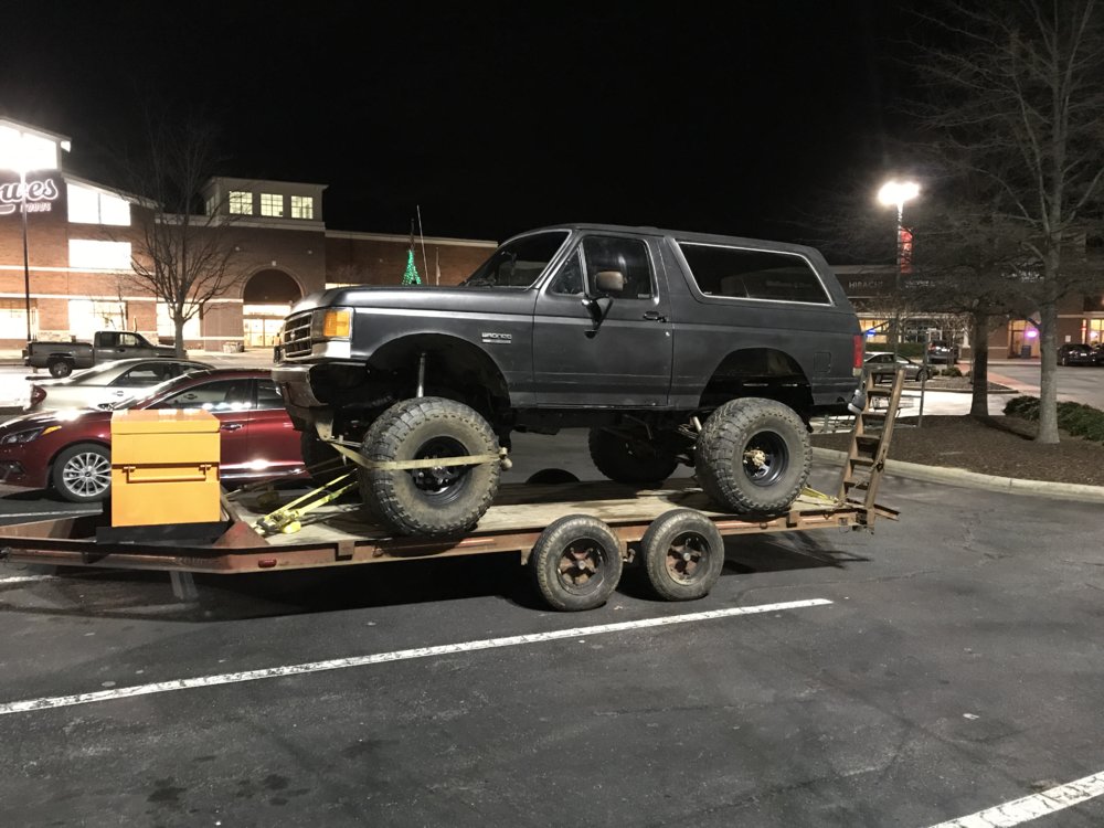

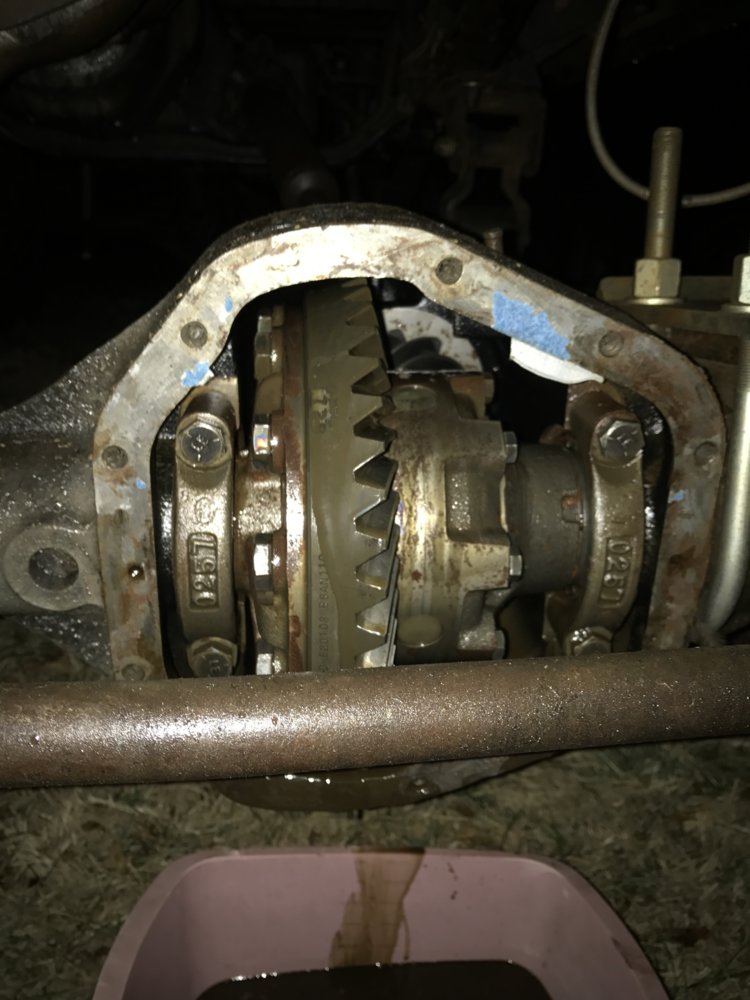

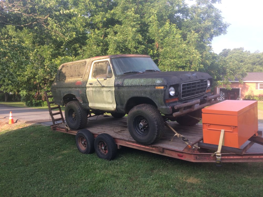

I recently picked up an '88 bronco on tons with the profit from the jeep part out.
Guy I stole it from didn't know how to fix anything... the spindle nuts had come off the driver front and the wheel almost flew off.
Ad said it had a Dana 70 rear with a spool. And 3/4 ton front with a "locker"
Well, the 302 runs good and it turned out to have a kingpin 60 front with a special present inside.
I guess I'll swap the Detroit into my '79 kingpin.

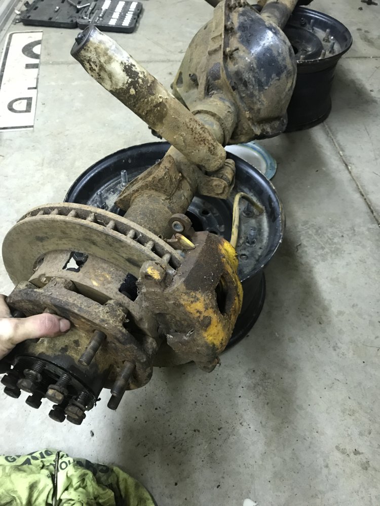

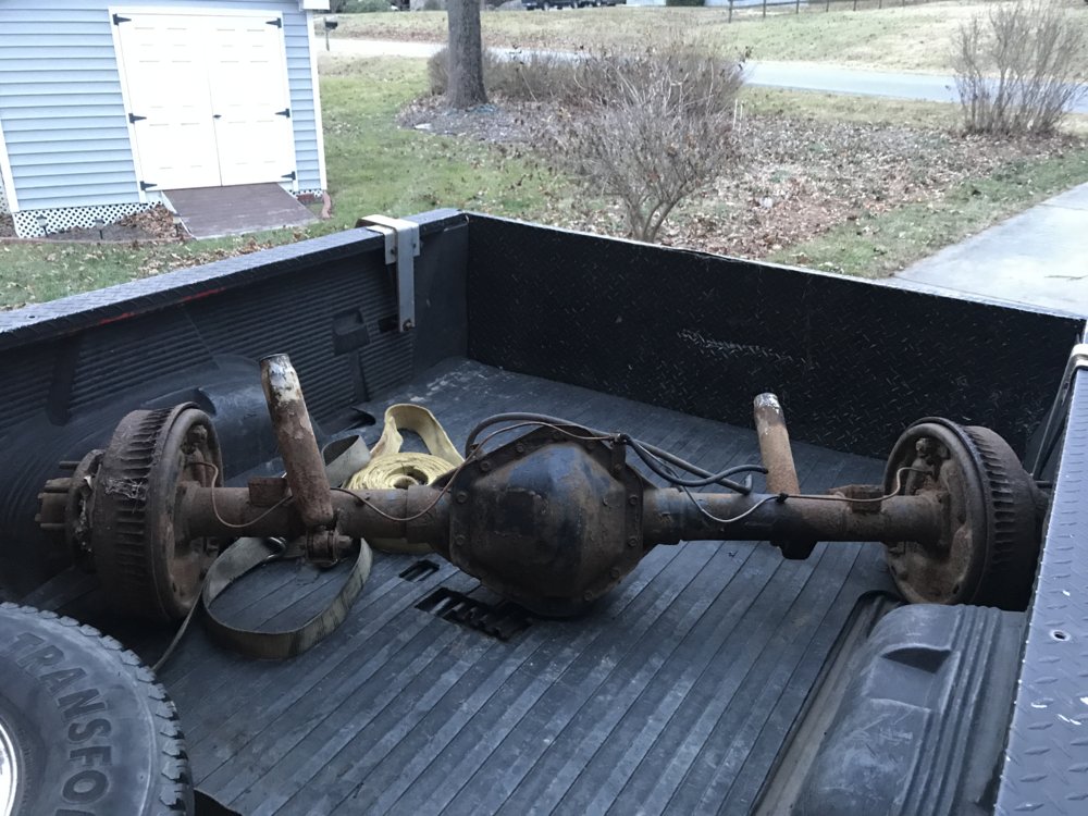

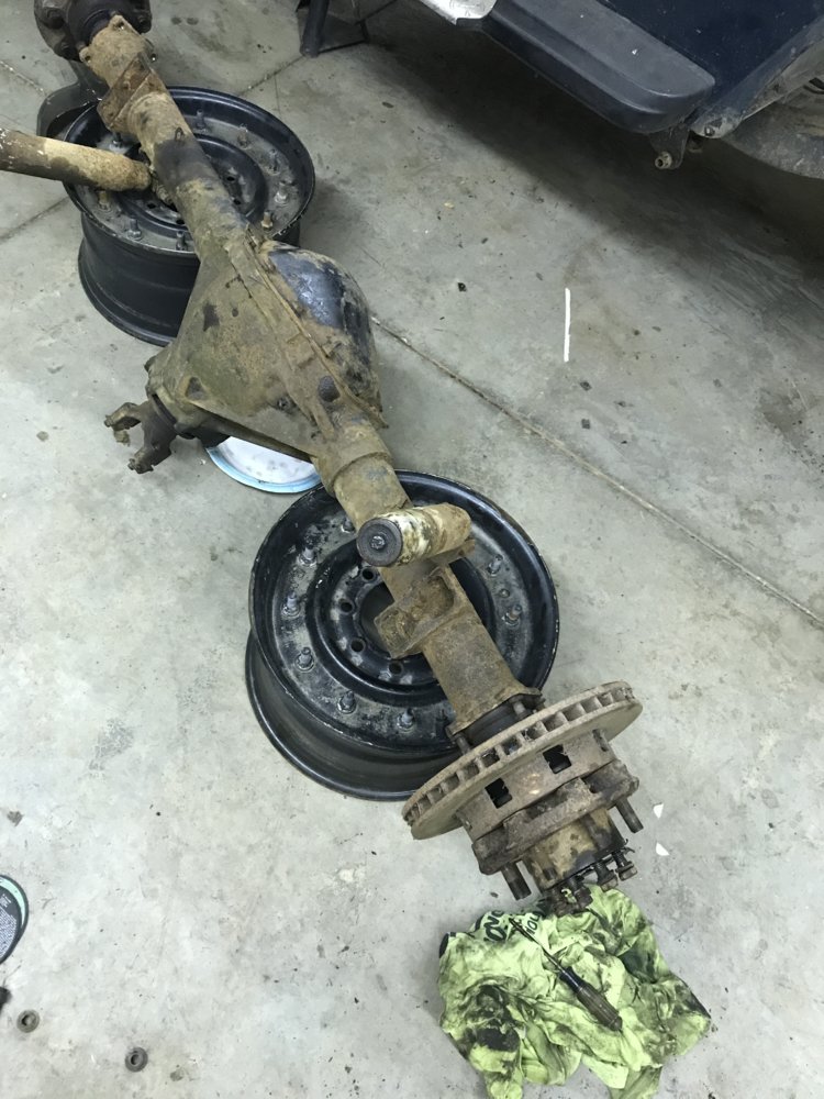

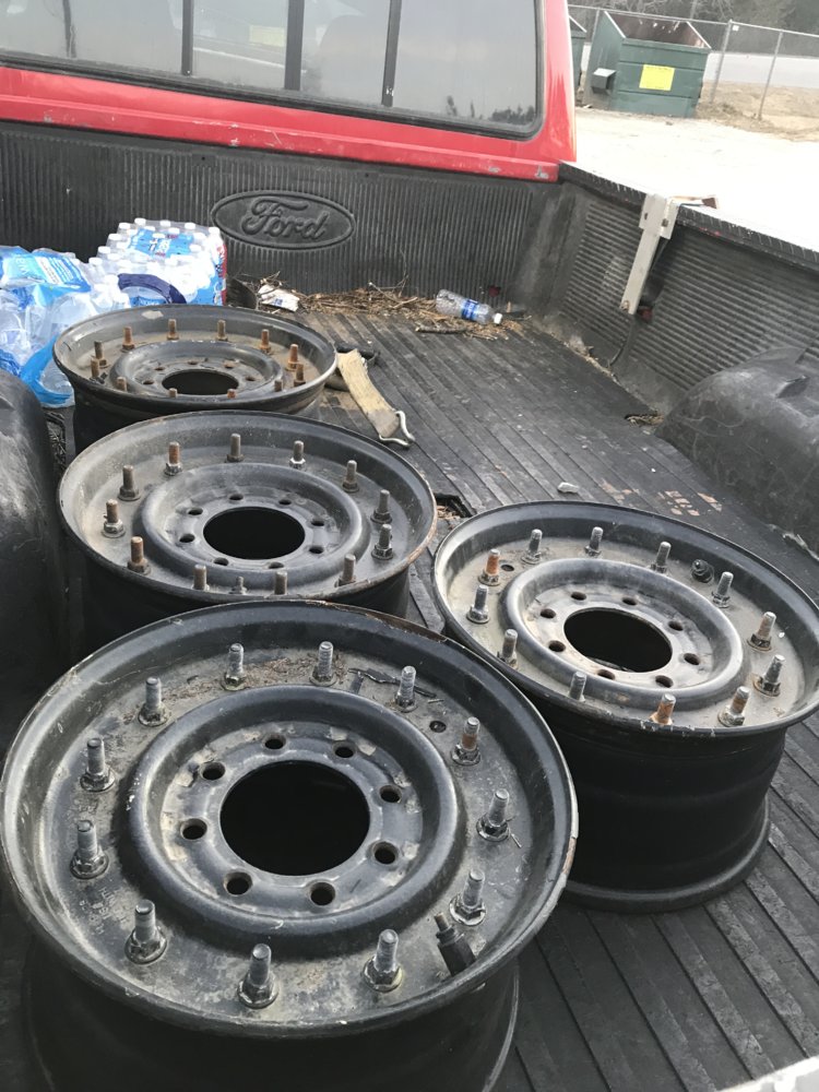

I picked a 14 bolt up the other day and got the brakes off from 40 years of corrosion.
I had some almost new rotors/calipers that sat outside for a while laying around from an old 44.

I love my 12 bolts on my current YJ. They have never leaked and I have had 0 issues with any of them.
I plan to run another set on this build. I'll have to recenter them, but got them at a great price

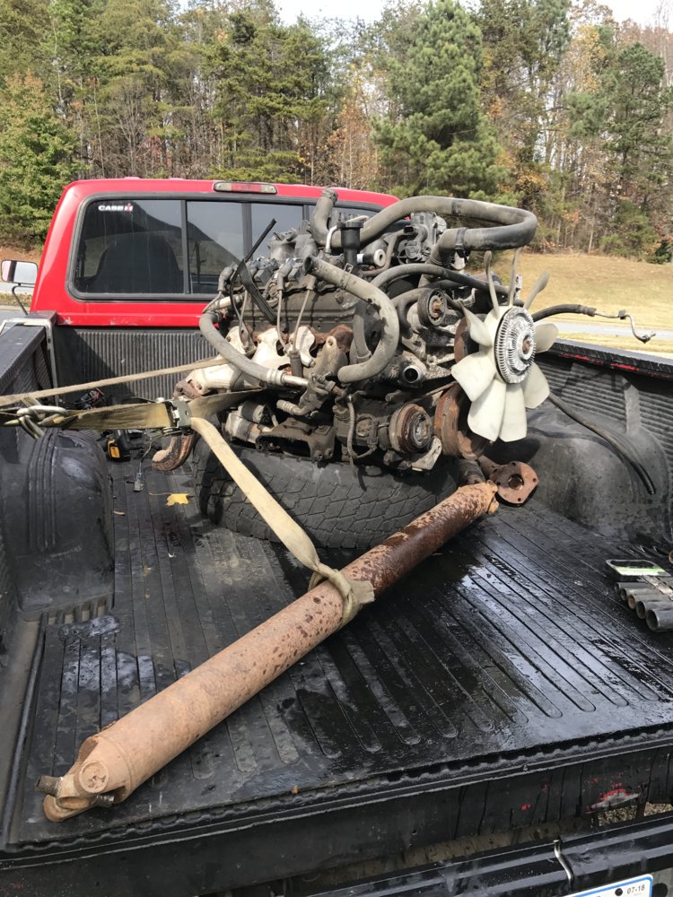

Pulled a 5.3 from an '04 Yukon for cheap.
It has unknown miles, but the pedals were not very worn and it was in an accident where it was rolled over so I assume that it ran before it was rolled.
It was from New York so the motor and everything has a lot of corrosion on it.
I'll eventually tear it down and inspect the internals to see if it's what I want to run.

I wouldn’t worry about it we put a motor in my buddies c10 that when we turned it over and the cylinders were 1/2 full of water spun it over to get water out and put 15lbs of boost to it for 4 years now

It does have the 706 heads on it though… I hear a lot of different things about them, but a few people say that they only had issues in 2006. We will see.

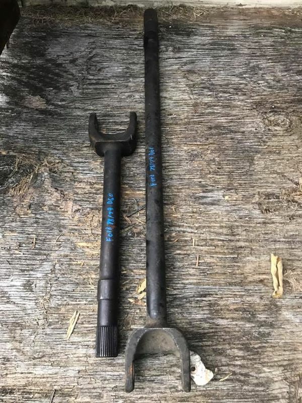

Picked up some brand new G2 inner chromoly shafts for the front off Facebook.
$200 shipped to my door.
Now I need to find a deal on 35 spline outers, U joints, and slugs.

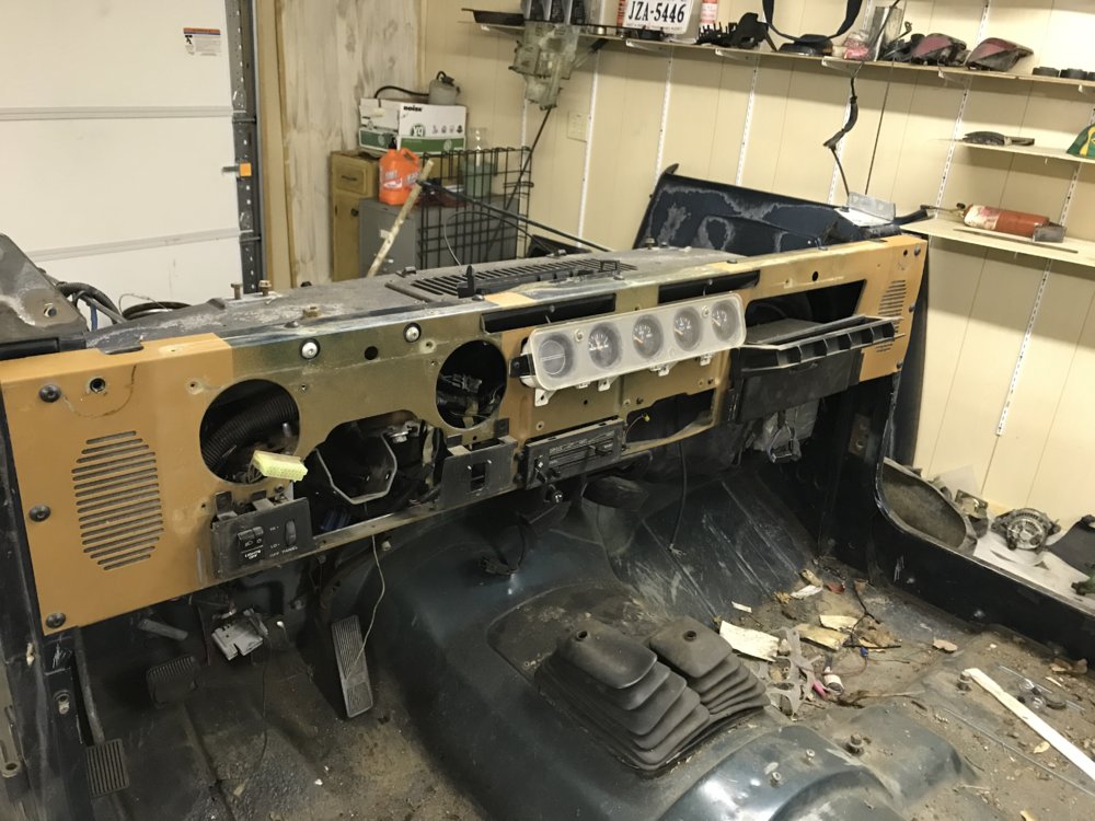

Since I want to keep the top low, I will need to make my own dash.
Wish I wouldn't have sold the steering column looking back.

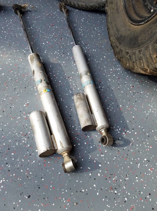

what are your plans for suspension?
Shackle reversal with leafs (probably some waggy leafs) up front.
4 link rear, coil springs and 14 inch shocks. Have these laying around..
