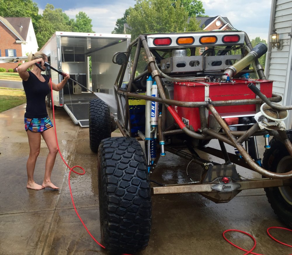

Hey guys- the U4 Badlands water and mud got ahead of me on the race car. I've cleaned all of the mud and grit, but could use some help brillow padding the surface rust. Any high school or college kids looking to make some quick cash? Or board members just bored and want to crawl around the 4410?
Ideally I like to have 2 or 3 guys over and knock this thing out in an hour ($40 each in that hour). I've got cleaning supplies, just need a few extra hands.

Will everything in that pic get hosed down?

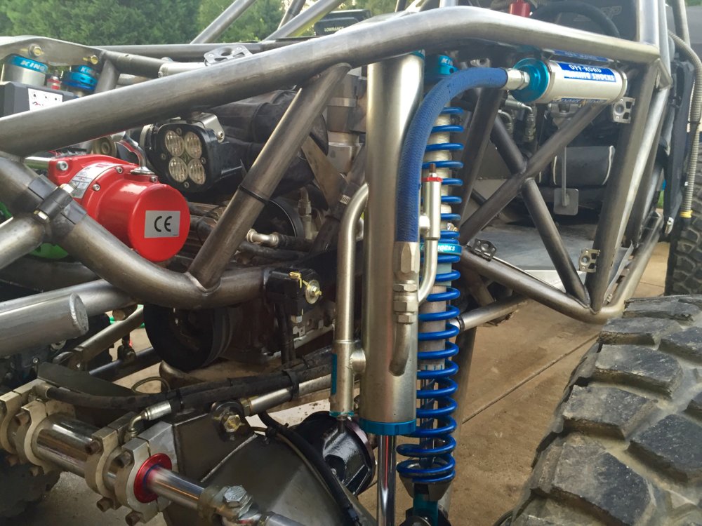

Seems like some rustoleum paint would cost less than $120? I guess the bare metal thing is the cool think nowadays, not sure I understand why though?
The value on the time to disassemble all that just to paint it would be way more than $120...

I always thought they did not paint it so it is easier to check the chassis after each race for cracks, damage, etc..

That's why you paint race cars chassis instead of powdercoating. Paint is easy to repair and touchup. The durability that makes powdercoat so attractive is also what makes it really hard to touch up.
Crack detection is easy with paint if it's thin. Thin layers will telegraph the cracks right to the surface generally, as opposed to thicker layers (or powdercoat usually) that can be more plastic and will bridge a crack if it's small and has little relative motion.
I know a lot of people that use the Rustoleum Industrial gray for roll cages and parts, because it's a good neutral color and very durable. A lot of people bake it after spraying for extra durability. Comes in spray cans.
I've already caused, found, and had welded several cracks. As much as a sun burst orange powder coat would raise my mall cred, it would be much more difficult to see those with it (in my opinion).
Every time I take it out I spend over an hour pressure washing, air gun drying, towel drying, then Wd40'ing it down. It would be nice to throw some gun metal grey krylon on it, but taking the whole thing apart and putting back together is something I don't have the time or resources to complete. Plus, I would still do the same clean up each time I took it out (minus wd40 step).
