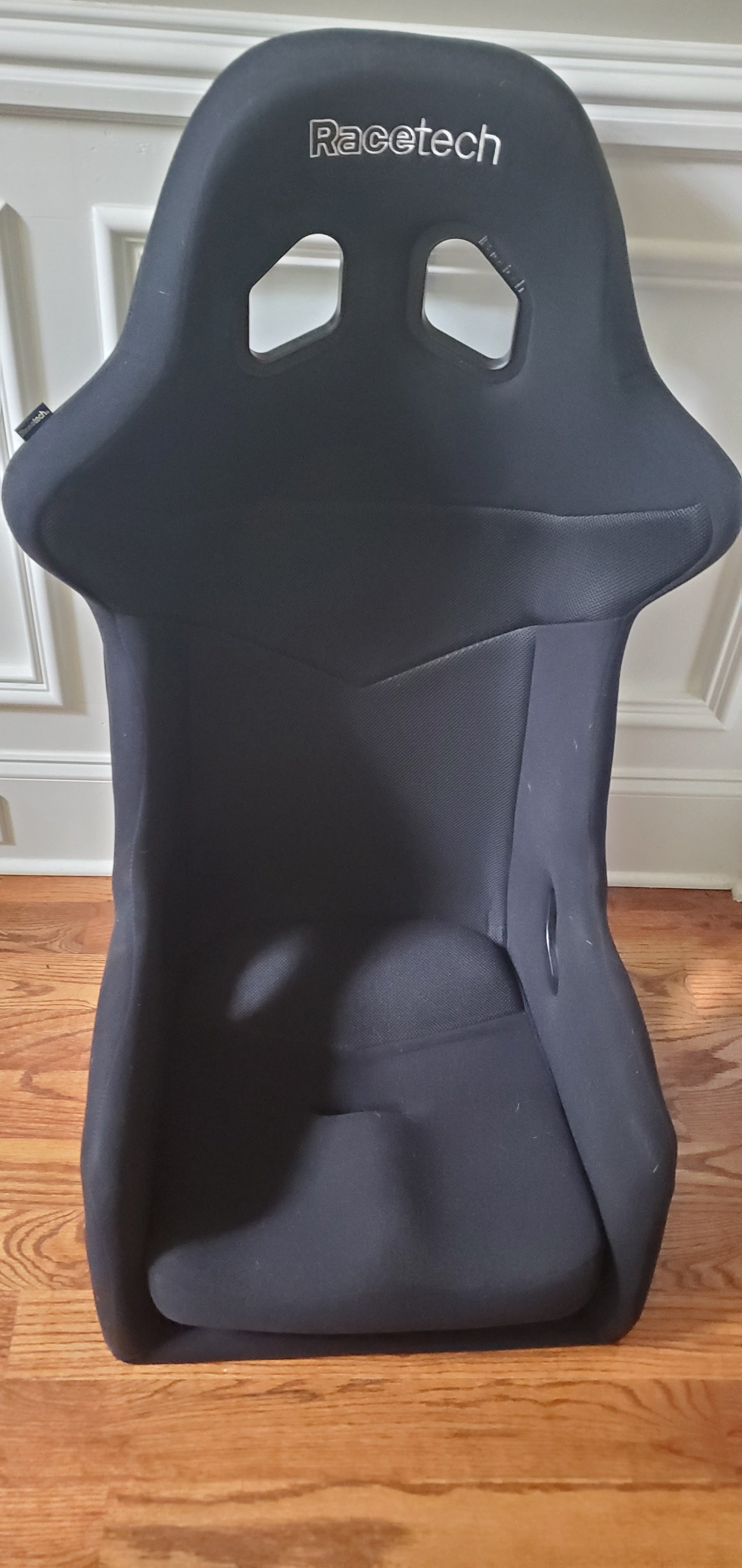

So I've been on the hunt for a fiberglass 1-piece (non-suspension) racing seat to fit my 6'6" 270lb frame and seem to be coming up empty. It would be going in a custom chassis to run in Ultra4 so needs accommodations for a 5-point harness and HANS compatible. Now I've been at my share of races and on the Lakebed at KOH and while I'm big.......I'm certainly not the.........let's just say the widest guy I've seen in a race rig. The two areas that seem to be causing the issues is the width at the hips, most seats even claiming to be Wide and Tall versions seem to be measuring 15"-16" and I just don't fit. The other issue is that a lot of my height comes in my torso so having the highest possible openings for the shoulder harness is key somewhere in the 29" height range from seat to top of opening.
I've looked at MOMO, Corbeau, Sparco, PRP, RaceTech (there's an outside change they might have one version that might could work). Any other players I'm missing? I've searched the web and continue to come up empty which is leaving me perplexed? What are other big guys using?? are they going with a non-racing style seat? maybe a suspension seat without the side-hip bolsters that would otherwise cause fitment issues? IDK so if anyone has some wisdom on the topic I would appreciate it.
