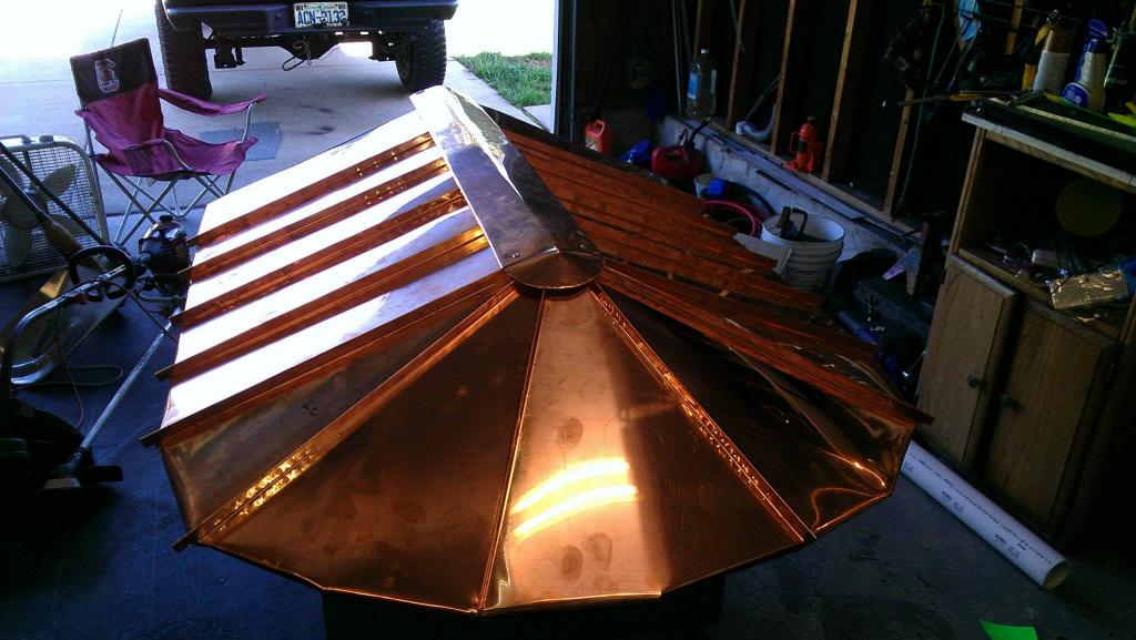

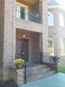

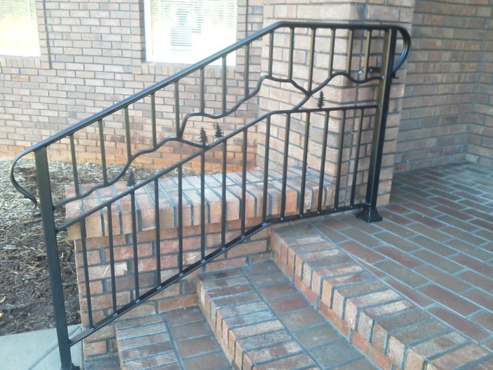

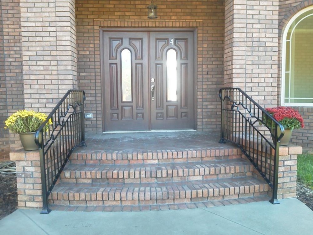

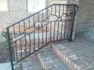

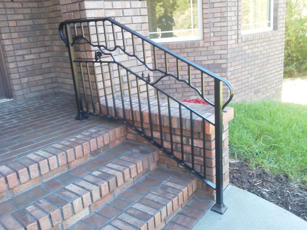

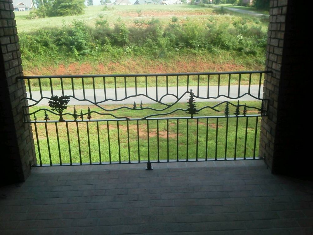

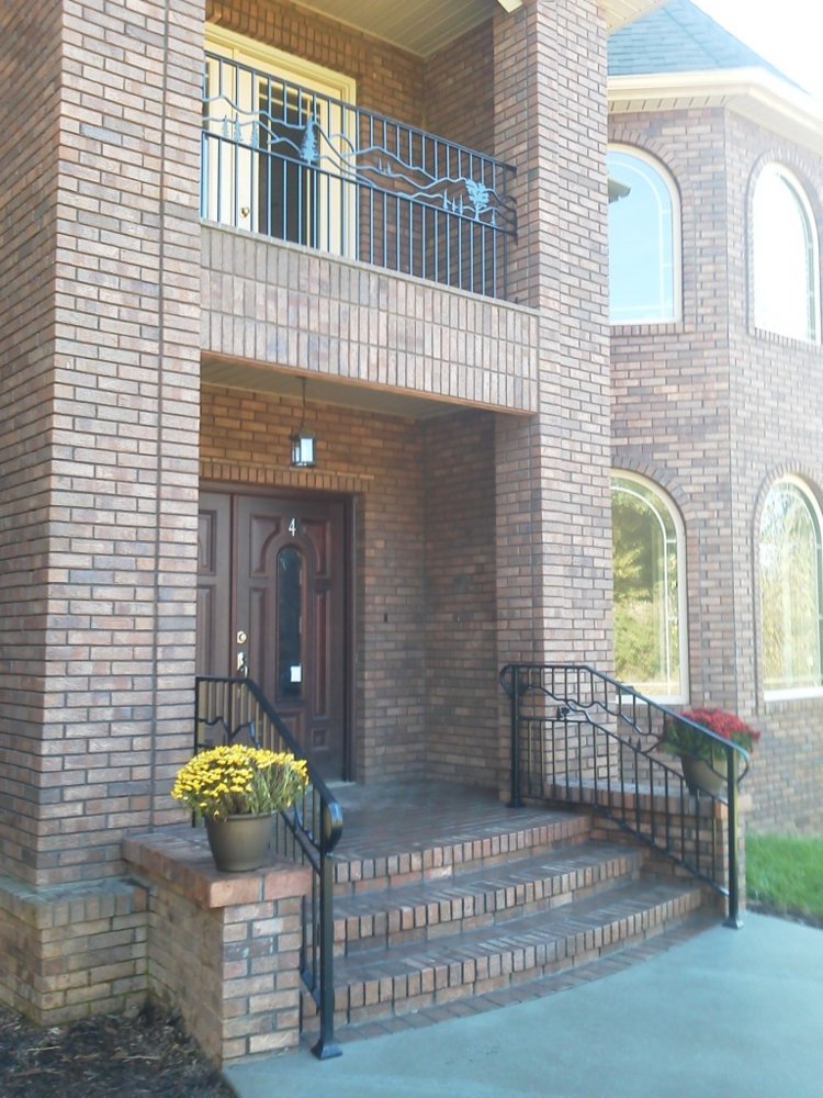

love the railing and the copper fire pit cover.

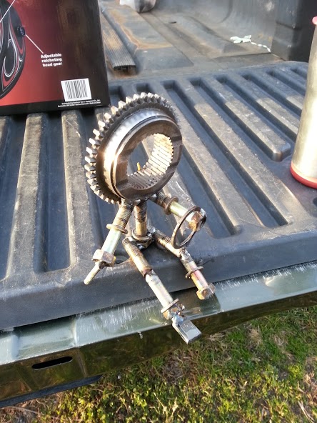

A little "riding buddy" I made with some left over junk.
alh3_googleusercontent_com__S4_LhrckyVo_ULkgsDn8apI_AAAAAAAAA1Y_ZEFZ5NzMGeA_w444_h592_no_12___1_.jpg
I like it, especially that he's got the pedal to the metal and grabbing gears.

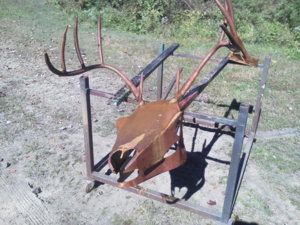

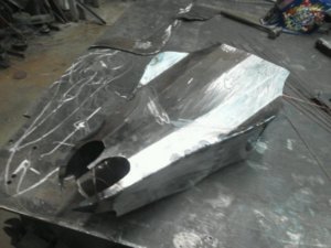

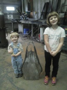

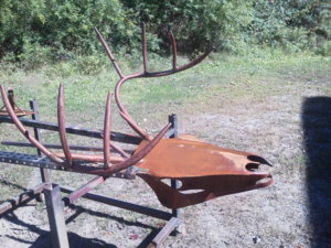

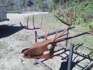

Here's deer head no. 2, in progress.
No. 1 is life size, 21" spread, no. 2 is going to have a 53" spread.
That's one hell of a house! Btw, there's some creepy dude in that window taking pics of your work.

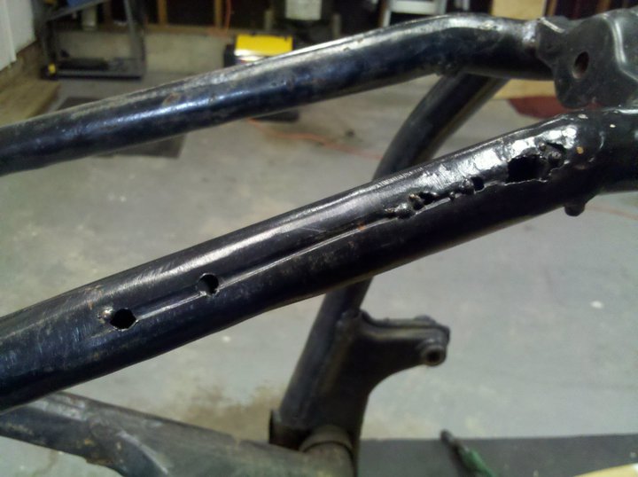

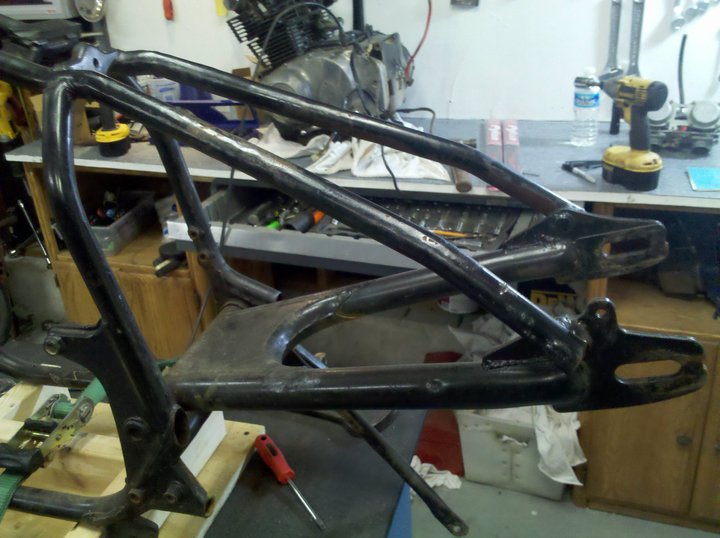

PO's version of hardtail.... :shaking:
ai248.photobucket.com_albums_gg196_mcbeerob_Bobber_20Build_1680de1002683079952c1af856dad6e6932.jpg
.... yes that's electrical conduit...

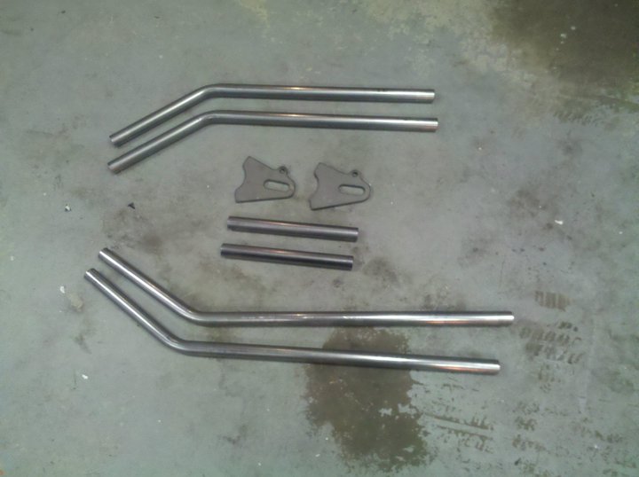

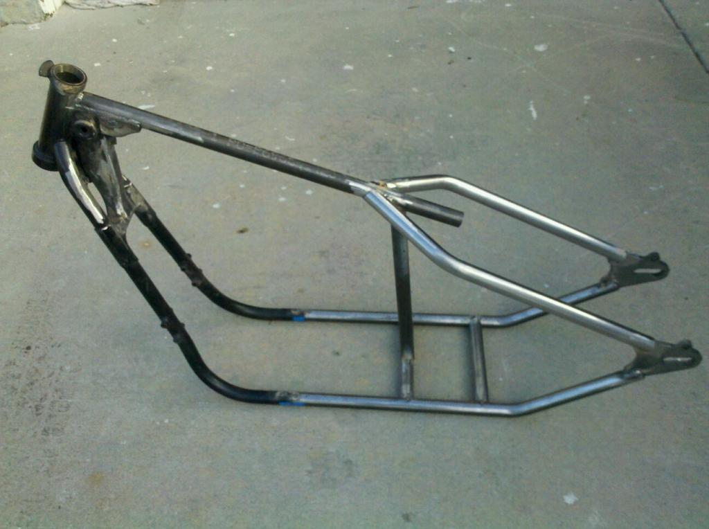

http://www.tcbroschoppers.com/ hard tail kit....
ai248.photobucket.com_albums_gg196_mcbeerob_Bobber_20Build_168c4b8755aad0e519162c649dcb062bd02.jpg

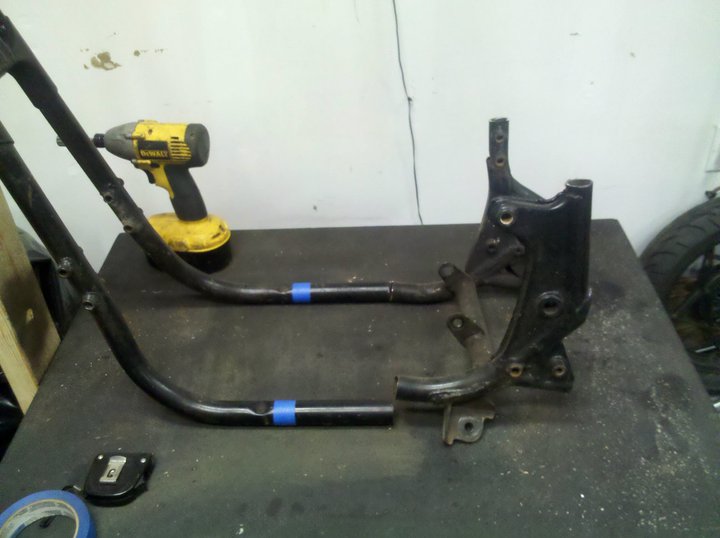

got rid of all the junk...
ai248.photobucket.com_albums_gg196_mcbeerob_Bobber_20Build_1818bc473da43deae327d2c63ba04958865.jpg
tacked up

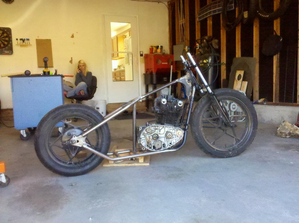

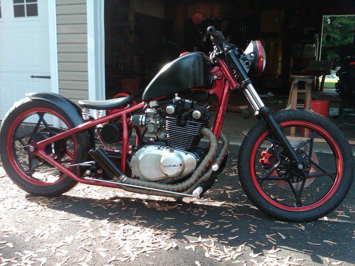

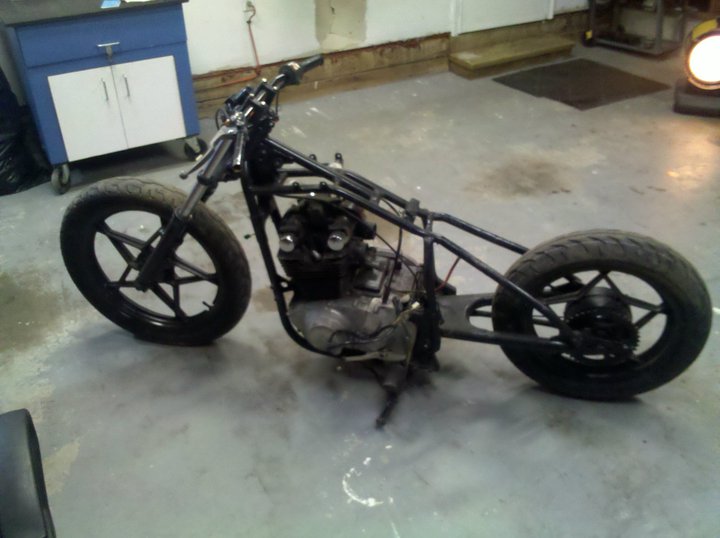

how it sits now....

still got a looooooong way to go... but I'm in no hurry. Like I said this gets tinkered with when theres nothing else going on...
That bike is nice. It'd be killin' me not to ride it. Hurry up.

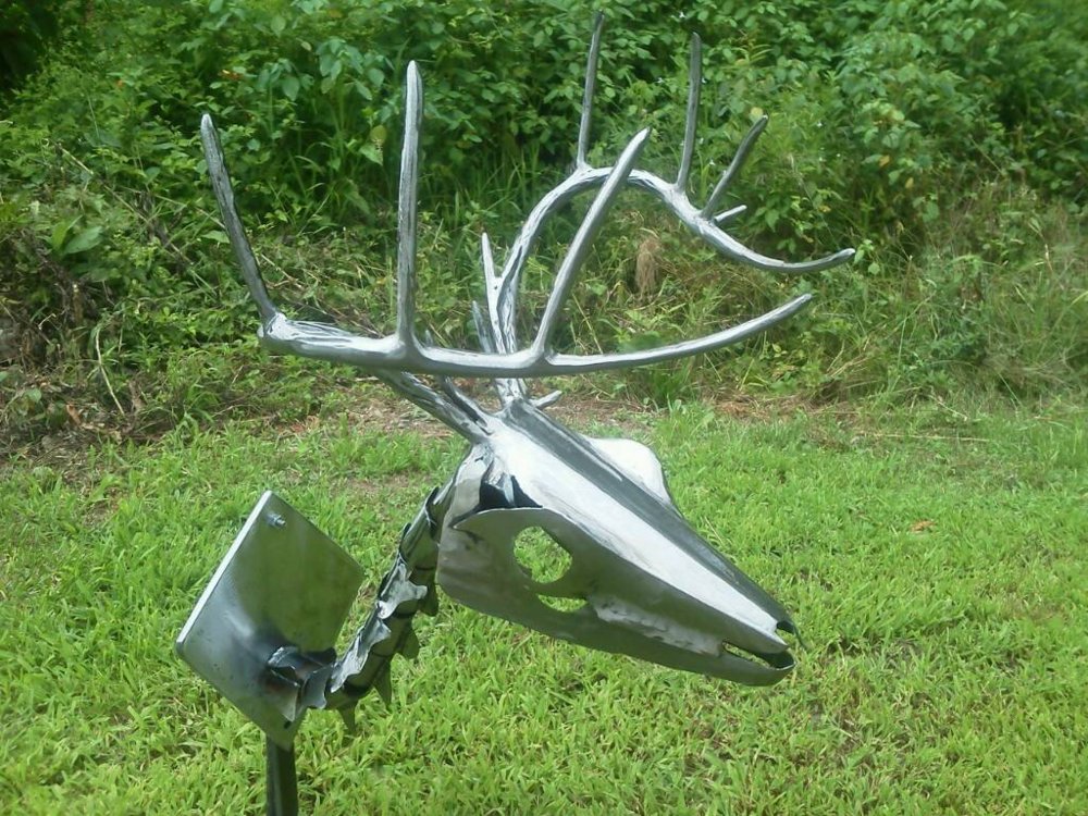

Here's another deer head. This one doesn't get a neck, and gets a rust finish under clear coat. the spread is almost 4' and from the tip of the nose to the farthest antler tip is 5'. It will get installed over a big fireplace, in a big living room in a big house.

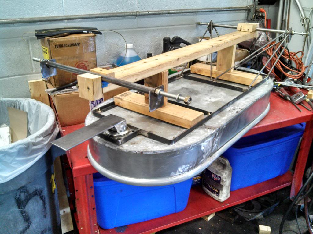

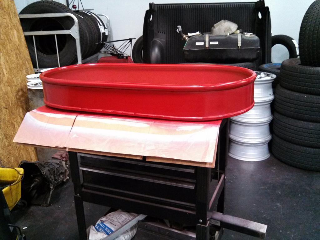

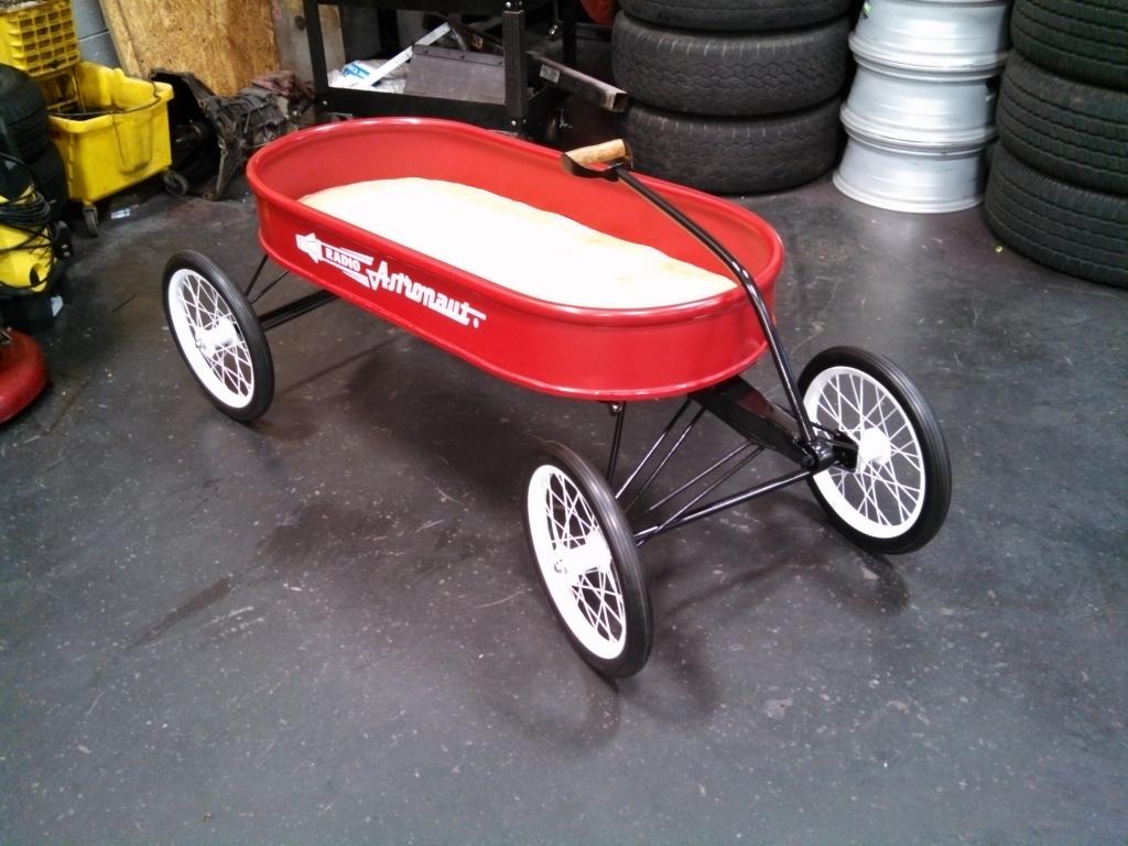

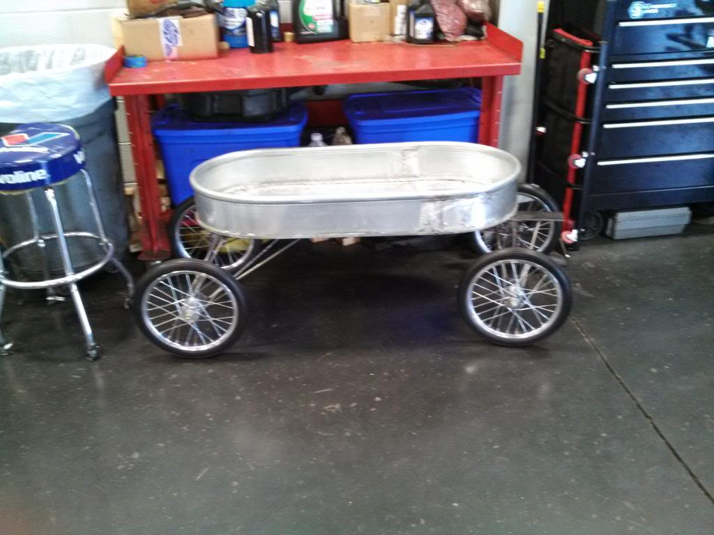

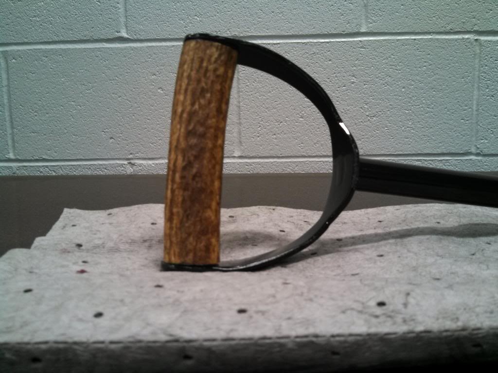

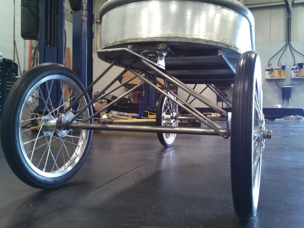

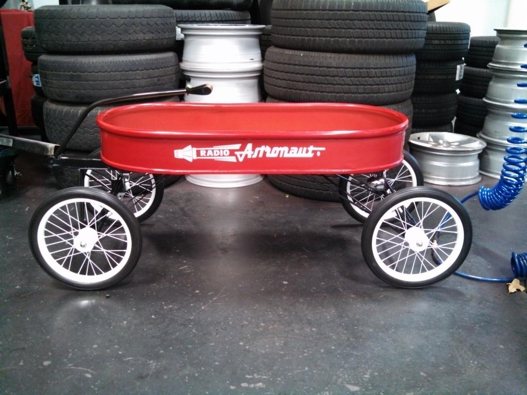

Built this wagon for my daughters 5th birthday last weekend. The tub started out as a livestock trough. I cut it down heightwise and lengthwise to the size I wanted and welded it all back up and bodyworked it smooth. I made the frame from 3/4" angle iron, built the axles and made a jig to hold them while I welded in the struts. The steering head is a 1000 lb caster with the wheel removed. The hand grip is elk antler that is drilled throuh and has a rod through welded on each end. I found the decals online and had them made to size. The tub, the wheels and most of the metal are all from Tractor Supply. I have WAY too much money into this thing. Maybe $500-600 just in parts. It should last forever though, heavy as it is!
