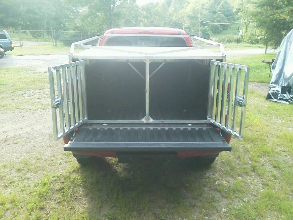

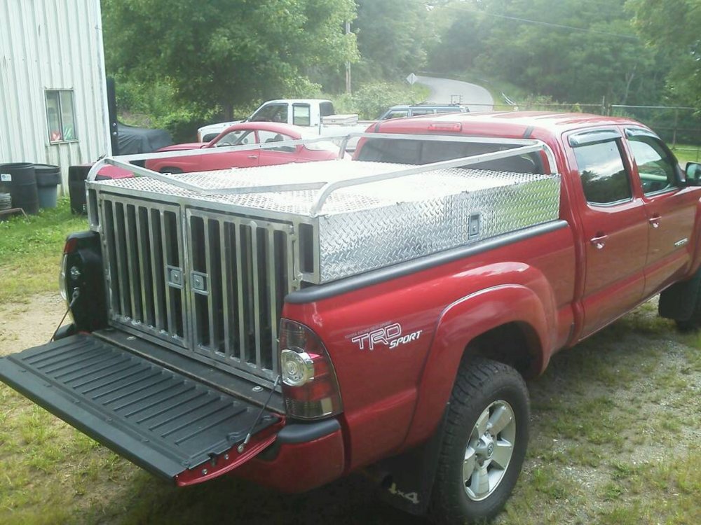

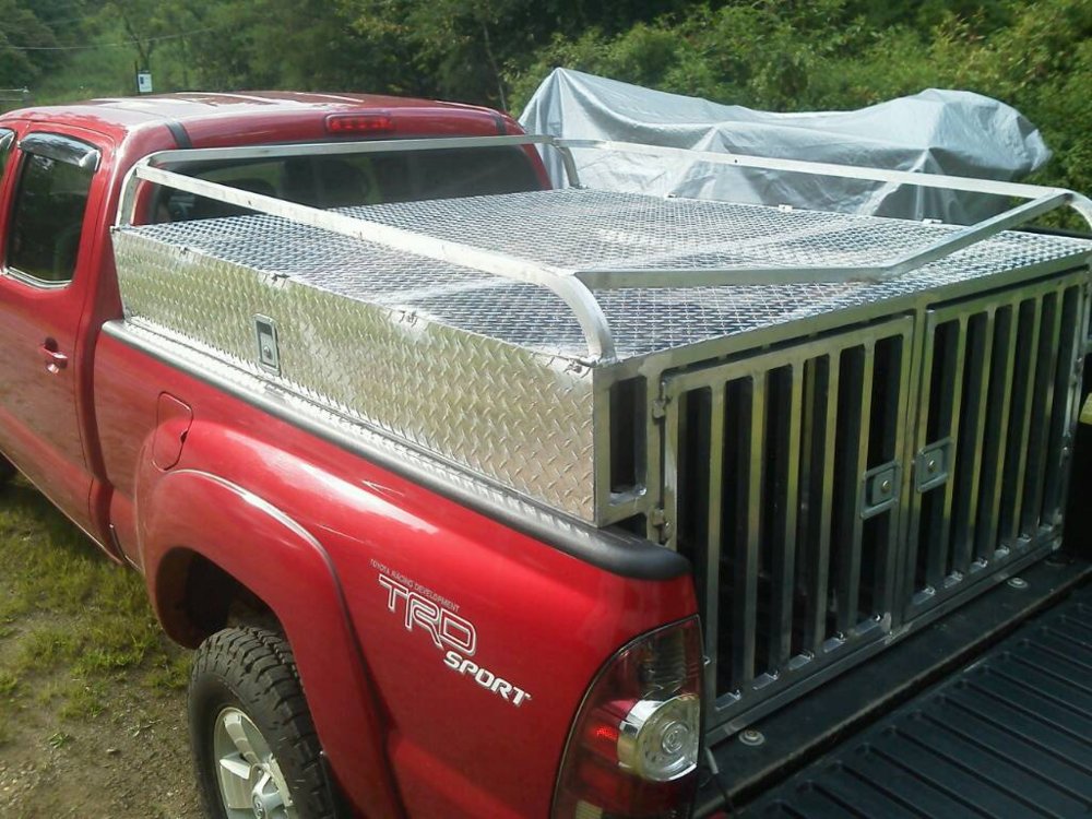

Sort of non 4x4, even though it goes in one. Dog box for bear dogs.
I like the use of the bed instead of a drop in full box, lots more space.

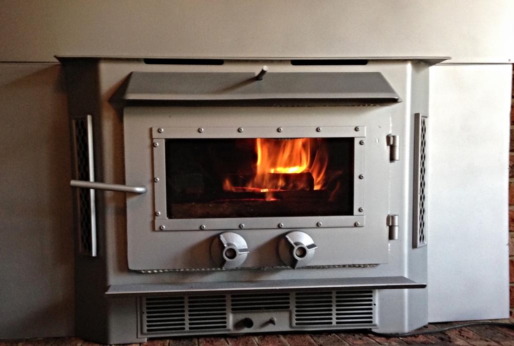

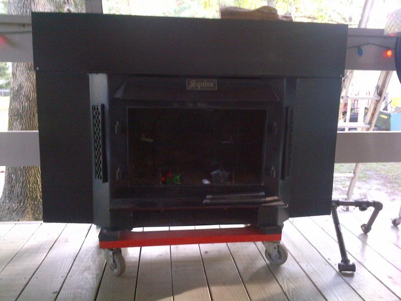

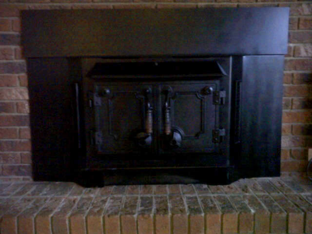

I have heated with wood for several years with my second hand Squire woodstove. We heated with wood when I was a kid and it just feels "right" to me. I love the stove, b ut I wanted to make a few changes to make it look a little more modern. It was the classic Squire with 2 cast doors, 70's chic.
Out on the back porch on my dolly

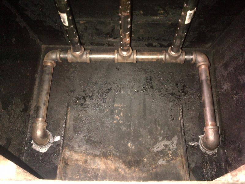

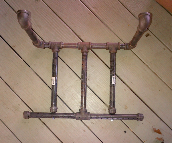

I started with a plan to add secondary air tubes to make it more efficient. I used steel threaded pipe and pulled the air from the inside of the double wall.

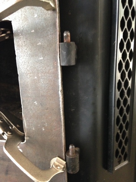

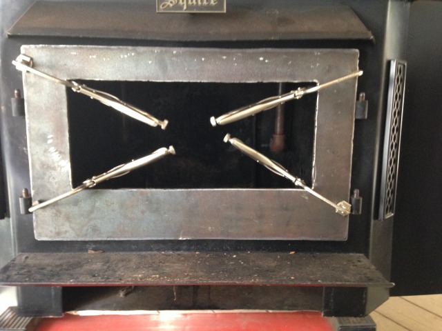

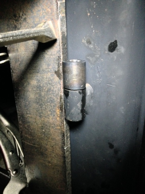

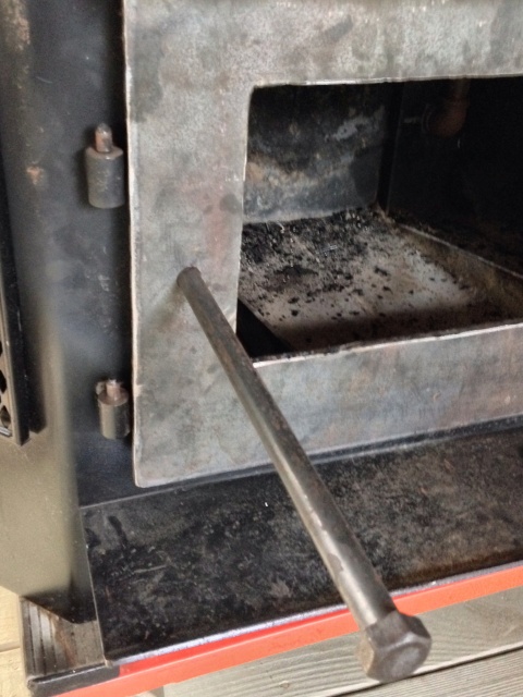

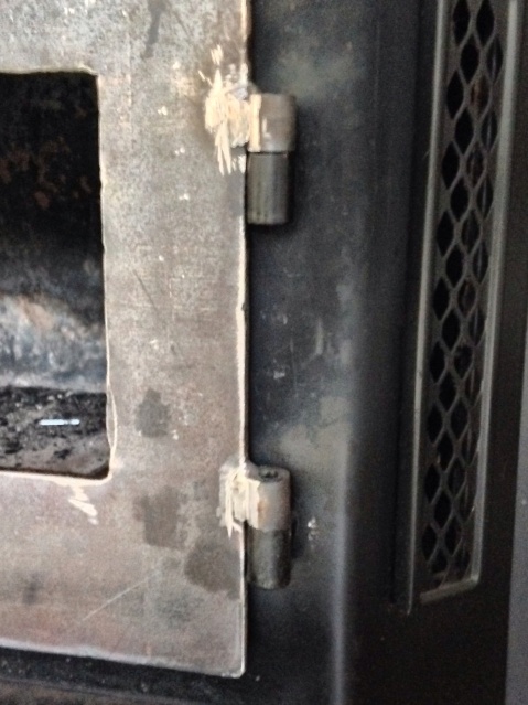

Once I had that done, I started on a new door with ceramic glass so we could see the flames. I used 3/8 plate for the door. I added the sill for the glass to sit in and used fiberglass fireplace gasket to seal it. It bolts in so if I ever need to replace the glass or gasket it will be easy. I made the latch with a long 5/8 bolt that pivots in a nut welded to the door. Air tight and nothing to wear out. I had to cut the hinge off of the left side and had to fab up hinges to line up with the hinge on the right. I used my draft knobs from the old doors and I think it looks great. The stove works wonderful and with the new pewter paint job it has a steam punk feel. We are very happy with it and it was a fun project.
Clamped in position to make the hinges.
Drilling for the hinge pin.
Ready to weld.
Welded up.

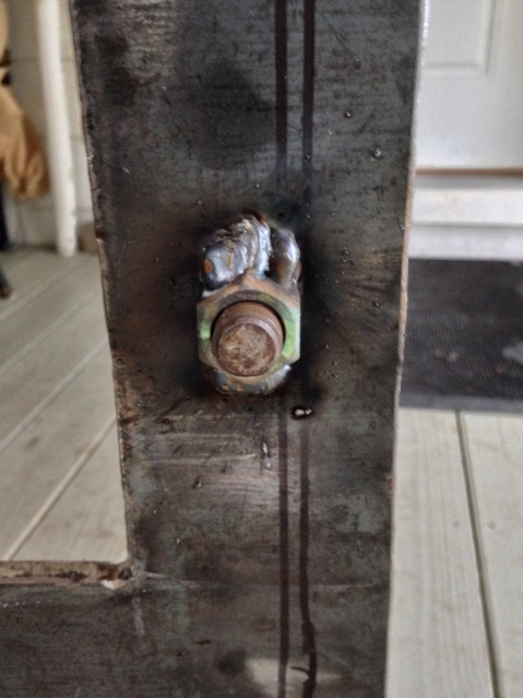

Latch pivot.

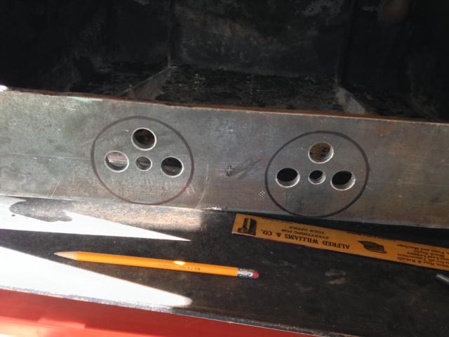

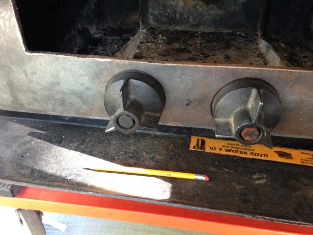

Draft holes and controls

For some reason, I did not take pics of the sill for the glass. It is 1-1/2 x 1/8 flat bar welded around the inside perimeter of the hole. The front is 1 x 1/8 flat bar and it bolts over the glass and gasket. This leaves 3/8" (thickness of the door) for the 3/16 ceramic glass and 1/8 x 1 fiberglass gasket that wraps around the glass.
I love the look and it looks like a modern stove instead of a throwback to the Carter administration.

Hard to believe that this thread is from last year! My wood stove is still performing great and looks like something I bought.
When I pulled it this summer to brush out the chimney, I improved the airwash for the glass door to keep it cleaner.
Still untested, but I think it will work better.

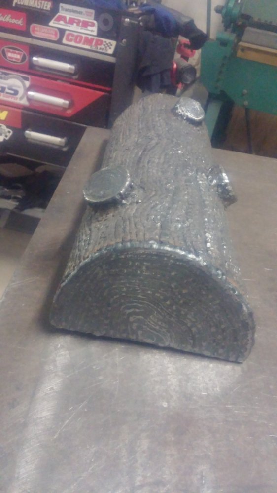

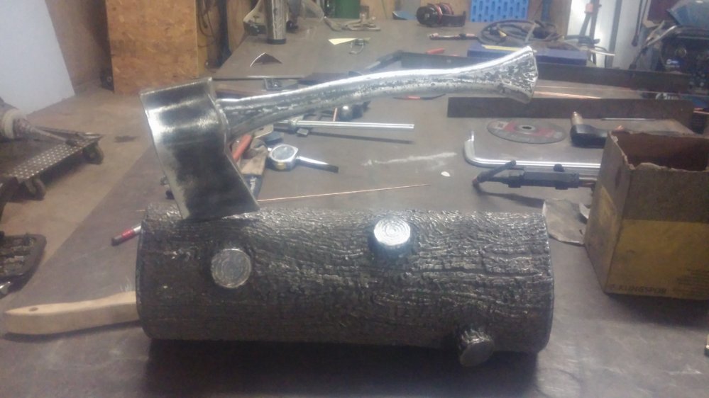

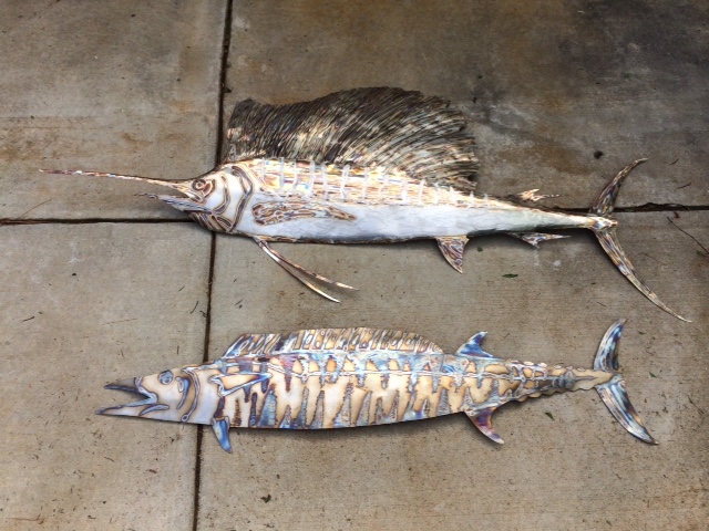

All thin gauge sheet metal. Used GTAW, SMAW to get effects I wanted. The log was 6 inches od and the handle started as 3/4 thin wall tube. The stubby branches started as header tubing drops.
Awesome. How many hours do you have into that?
Around 16. Thanks guys. It is for a customer. They are also great friends. It is a Christmas present for their father. The families last name is Hatchett.

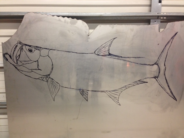

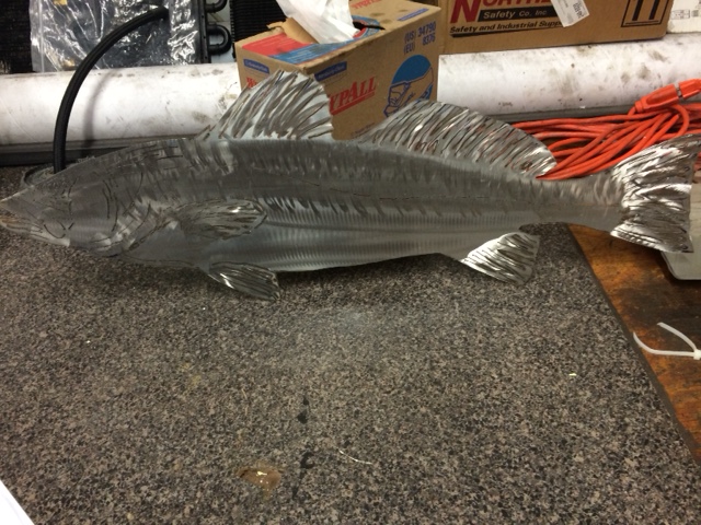

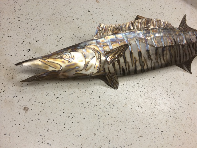

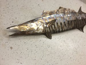

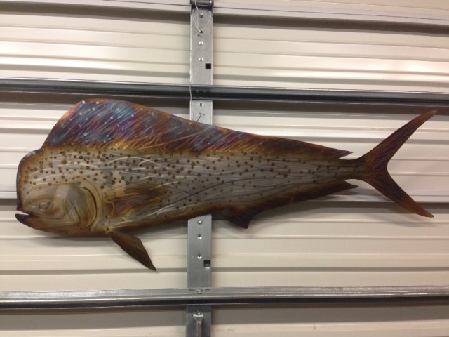

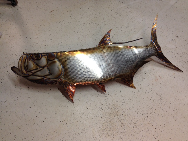

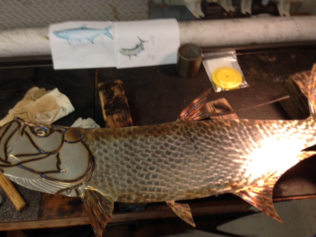

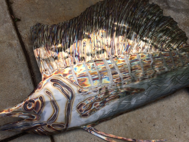

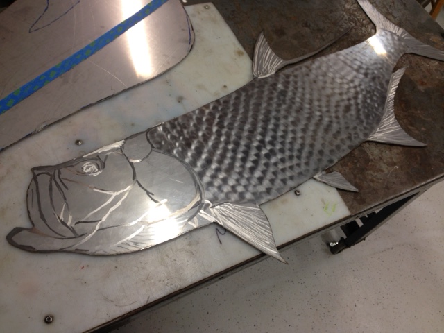

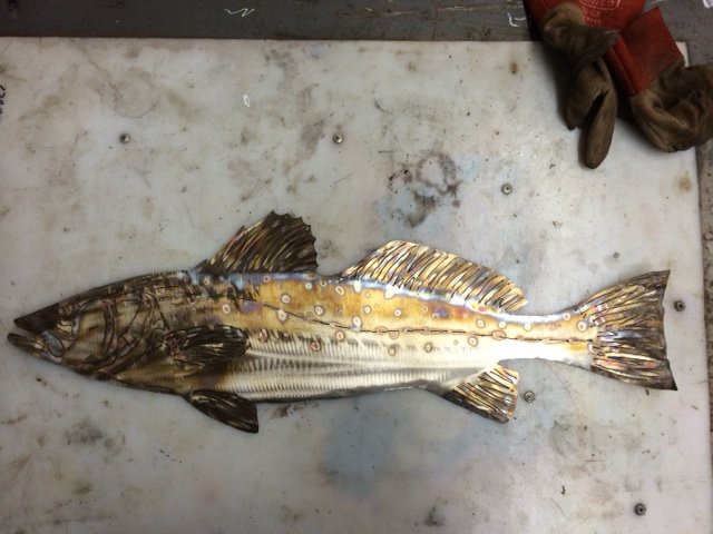

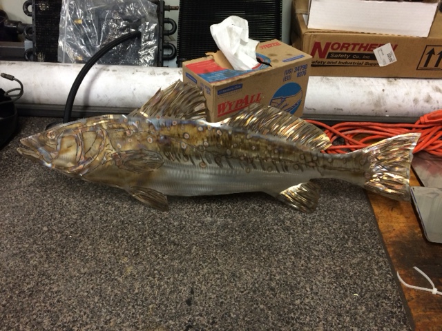

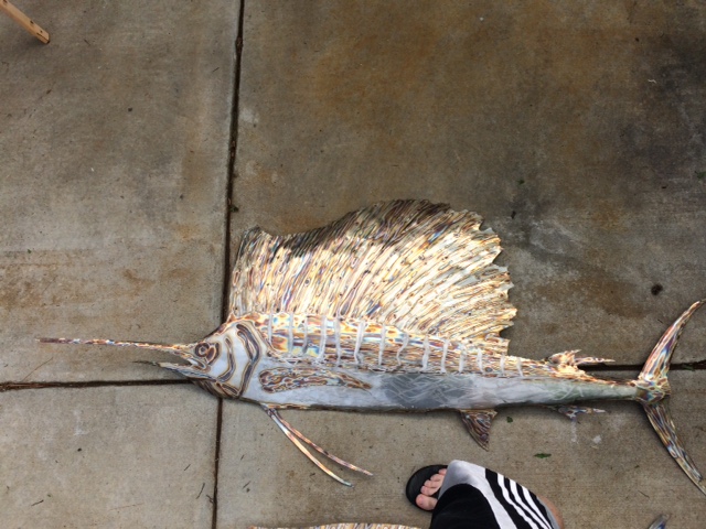

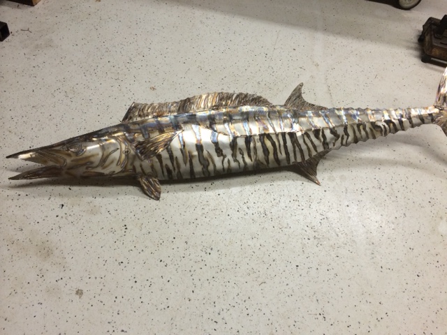

Here are a few things I've made out of scrap stainless in the past year or two

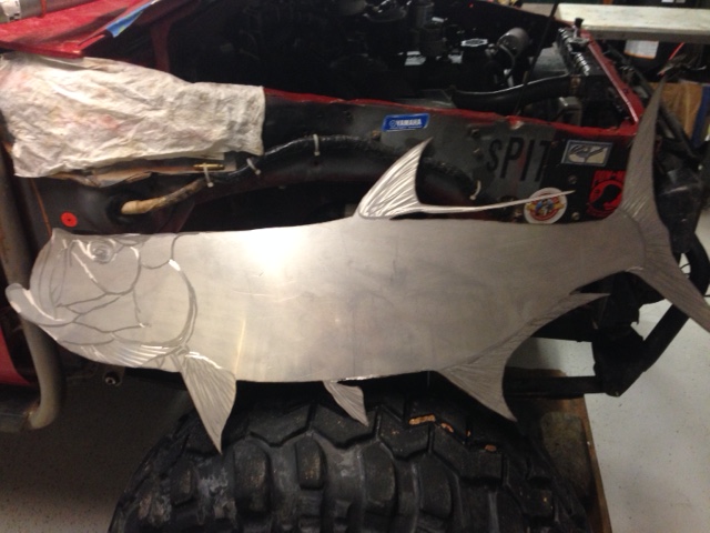

The fish are awsome. Do you vary welding tip sizes or use a standard cutting head or rosebud? Looks like you have mastered control ing the heat. P an O sheets or any of it SS?
