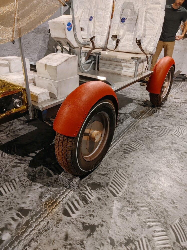

Speaking of: I built these fenders last week to go on the Moon river exhibit at the SC state museum. .188 Al, rolled and press formed in house and powder coated wrinkle red. This was a brutal task, but they love em. No, they're not perfect and that bugs me as a fabricator. But again, these were brutal. Building these did earn me free admission passes for life, so no complaints from me.
