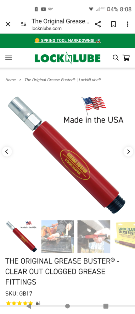

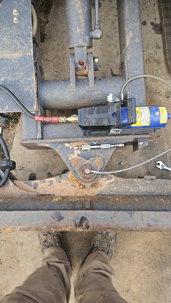

So you shot the AW32 into the pin to get it to accept grease? I have a frozen joint on a machine that I cannot get grease to accept. I've removed the fitting and dripped penetrating oil and actually brake fluid into and I get nothing. I've used heat, hammers, and it will not take grease. It's older and frozen up but for the life of me it won't take grease.
Yeah I made a hose with a jic 6 fitting to 1/4" npt and threaded it into the zerk hole then just pressurized it and moved the blade around until hydraulic fluid came out. I've got a grease buster you can see laying there in the picture where you hammer kroil into the zerk but it wasn't working.

Here is a version that you can take your frustration out on.

@braxton357 you beat me to it.....so @R Q what he said...
I've thought about something like that but not that elaborate. Maybe I'll get me a grease buster. Thanks
I will tell you what will get that working in about a min. When i worked as a repairman for a coal company we use blasting caps they will fit perfect in the grease fitting hole wire and pop it and it would take grease like a new one. Done hundreds of them over the years when i worked there. I used to keep several boxes of caps in me service truck to have them on hand when i needed one. Man would get put away just for having blasting caps now. Ps. they work great for fishing in creeks you don't even need as fishing pole just a 9 volt battery. That was the good old days..

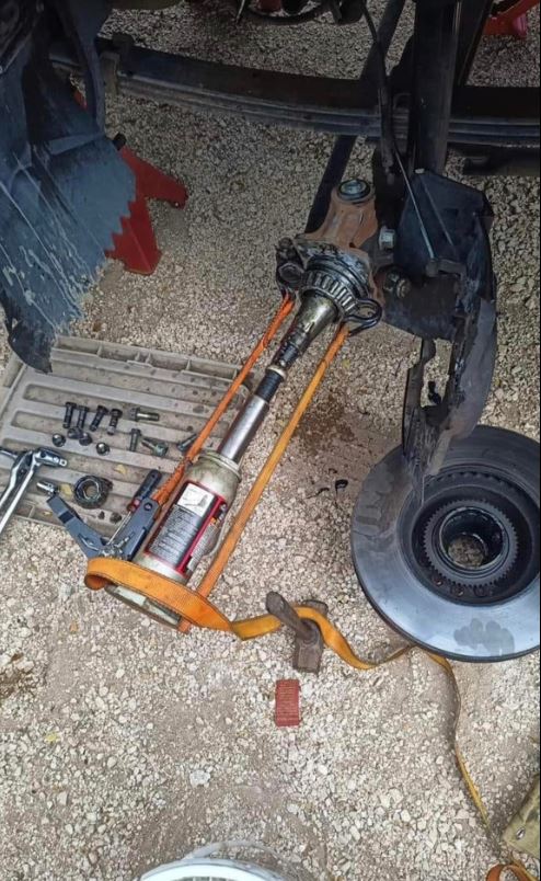

Did it work? I guess we'll never know...
Especially since the person who tried it may no longer be with us and that's the last pic from their phone!
