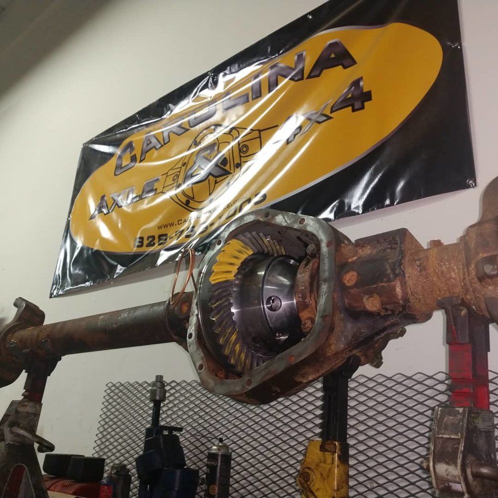

Question for you, since you have way more experience setting up axles than I do..
The pattern on that looks good, but I always have tried to get it more centered, slightly further away from the carrier.
Is that necessary?
Guess what that pattern will do as it breaks in over time?
It'll settle right smack dab in the middle as the backlash opens up a hair when the bearings fully break in and the gear set does the same.
IMO a well centered pattern crown to root is more important than heel to toe. This is assuming backlash is in spec and you have an acceptable pattern crown to root.
An increase in backlash (as carrier bearings wear and gears wear in too) will move the pattern a little. Not much, but a littleI didn't think the pattern would move that much with break in.
Thanks for the info.
Good to learn something new every day!
