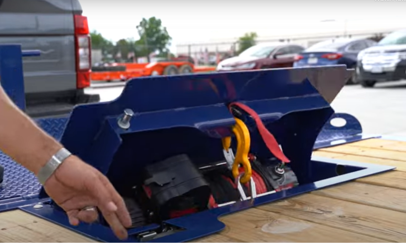

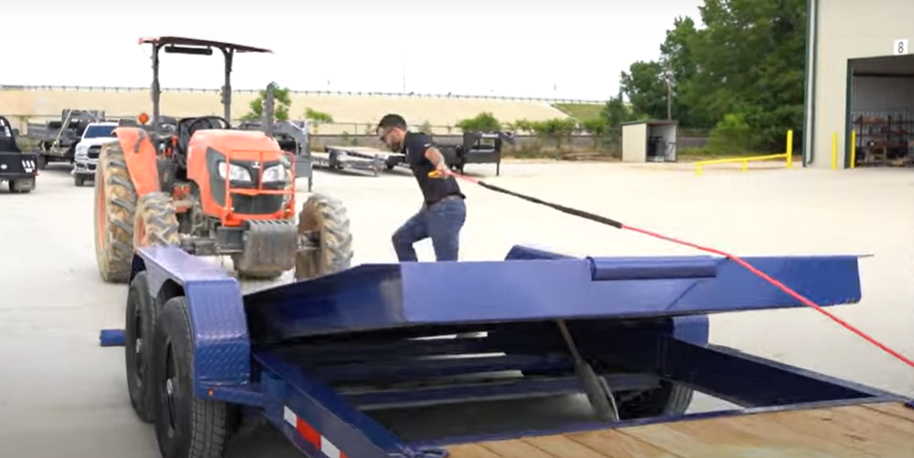

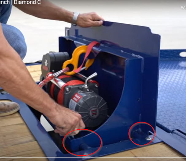

Has anyone found the pop up winch plate that Diamond C uses? I wonder if it's their design. I have not had any luck while snooping the net.
it is pretty neat, but I bet it is heavy. From the claims, it is a full box, and I would think that maybe it is welded to the frame? I cant believe that those 2 carriage bolts are all that is holding it down. It doesnt look to be that complicated to replicate with a plasma table. @jeepinmatt built a similar setup without the fancy box.
I'm sure it is heavy, but sort-of enclosed would keep it cleaner. You can see in the pic that there are welds to the front of the frame right behind the carriage bolts. I would imagine they are just for the wood.

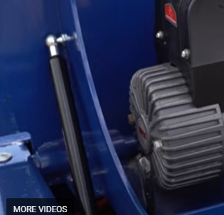

I also like what they did, and it's pretty simple. The plate and boxed in mount gives strength for the deck. The gas shock is a nice touch, and just a matter of spacing and shock force.
It's a pretty conventional striker and latch:
Pivot pins are at the back, and latch pins with a simple hand slider at the front:
Really wouldn't take much to replicate, just the tedium of finding the parts and figuring out how to lay it all out. I'm guessing the wires come in from the bottom in the deployed position.
A couple of criticisms:
I'd use a bar for the winch plate pivot pin instead of 2 stubby pins for more strength and double shear properties.
I'd inset the latch striker within the rectangle, and move the release handle so it didn't have a funky shape (more of a cosmetic thing than functional, but also less material/weight)

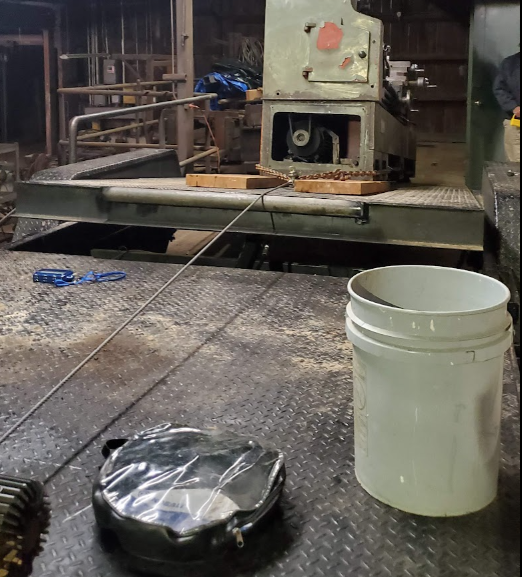

The tilt edge roller is way too narrow. I think mine is about 4ft wide. I'm pretty sure I drew a line from the winch to the back corners of the trailer and decided it needed to be at least that wide.

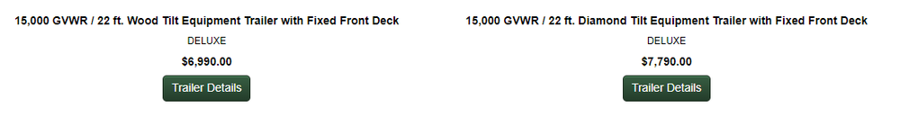

Also, FWIW, you can get a 22' tilt on 17.5s, direct from Kaufman, for 8190. They have a nice website that lays out all the specs, options, and prices. If nothing else, it's a good way to figure out what you want and what comes on them.

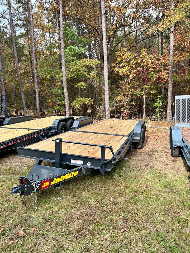

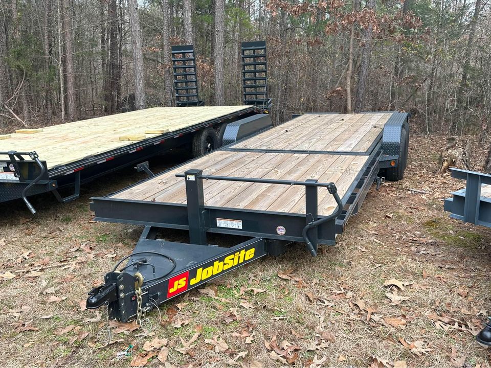

7x22 gravity tilt trailer. 7k axles each so 14k trailer. Has tool box on front. Has adjustable coupler on front. Comes with title and bill of sale. We do offer rent to own.
So I didn't think until now to google them. Lexington, NC too.
If those aren't built by Kaufman, then they are built by people who worked for Kaufman and are knocking off the design.
