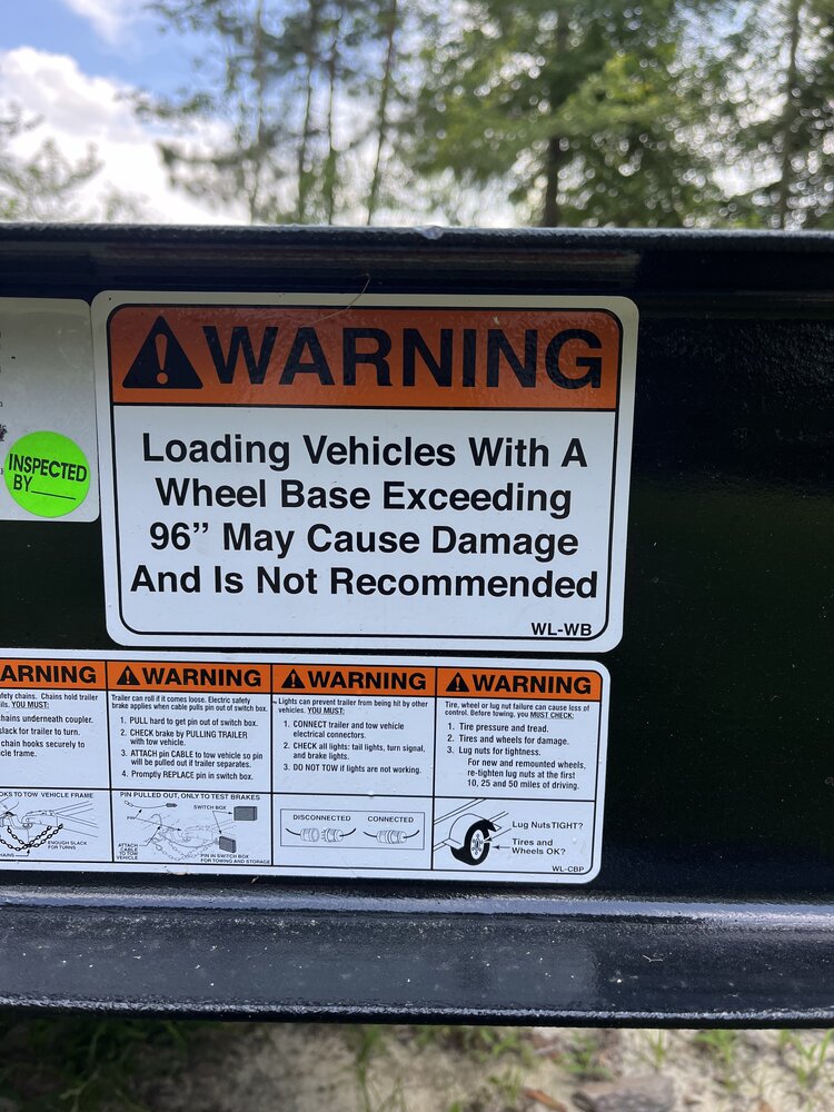

It's referring to the possibility of the tilt portion dropping back down before the rear tires are on the trailer.I saw this and was wondering what it’s about. Didn’t notice it until after we left. I’ll email the salesman but thought one of you might know. The wheelbase on my Jeep is more than 96”.
Ah. That makes sense.It's referring to the possibility of the tilt portion dropping back down before the rear tires are on the trailer.
Yup, did you get power tilt? Or atleast able to lock it out so it stays up?Ah. That makes sense.
No just the standard that they make.Yup, did you get power tilt? Or atleast able to lock it out so it stays up?
Bigger head ache is when backing off and the deck drops before the front is on it …Your tires and ground clearance are both big enough that it won’t be an issue. As you pull on, when your front axle goes past the pivot point for the tilt, the tilt section will tilt forward, causing the rear to hit whatever it lines up with. Probably your tires, possibly your control arms/leafs or skid plate.
Also true. Difference is you can leave it locked until the front wheels are on the tilt.Bigger head ache is when backing off and the deck drops before the front is on it …
As long as you remember or plan …or so I heardAlso true. Difference is you can leave it locked until the front wheels are on the tilt.

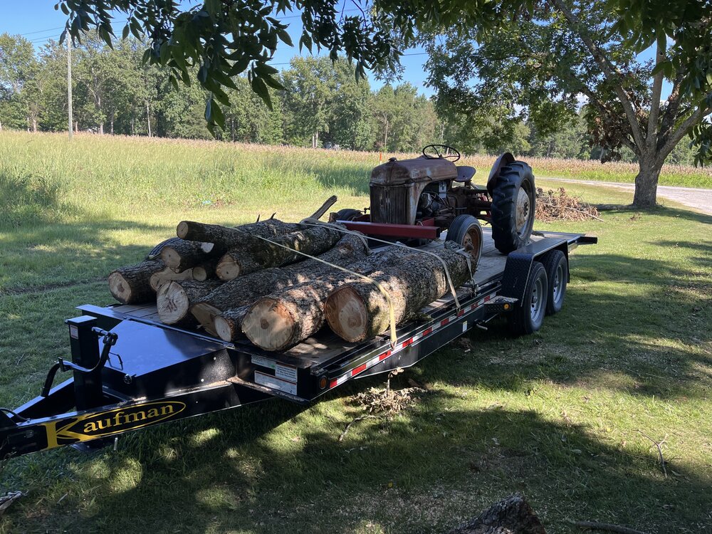

Still in the box waiting for you lolLoving the trailer. Put 6 - 8 pecan logs on the nose today. View attachment 423598 I need to just make a road trip to meet @Noel for that winch it’s still an option.
